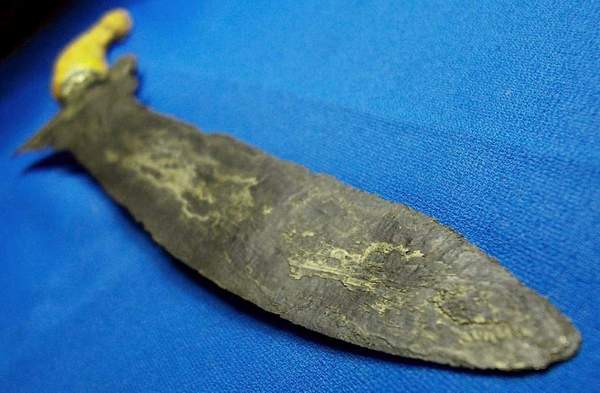

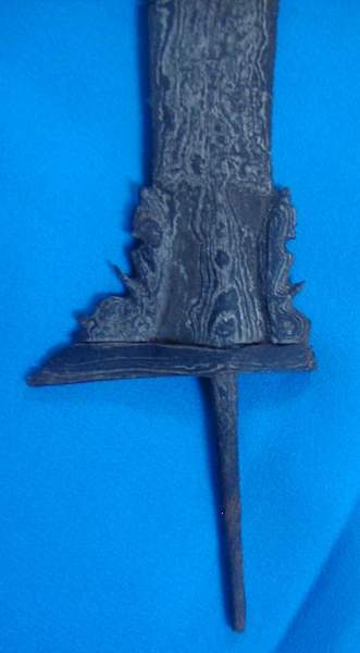

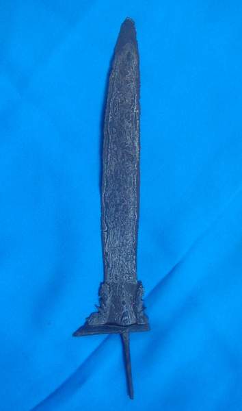

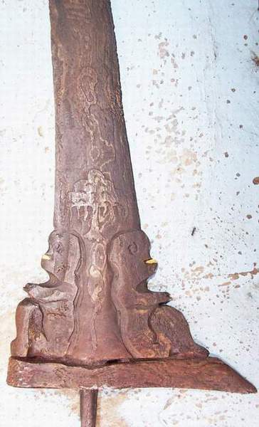

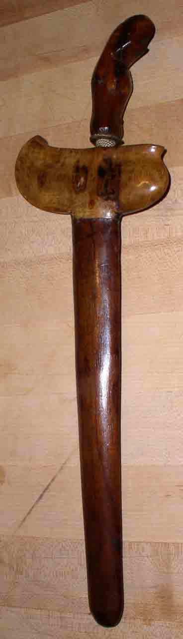

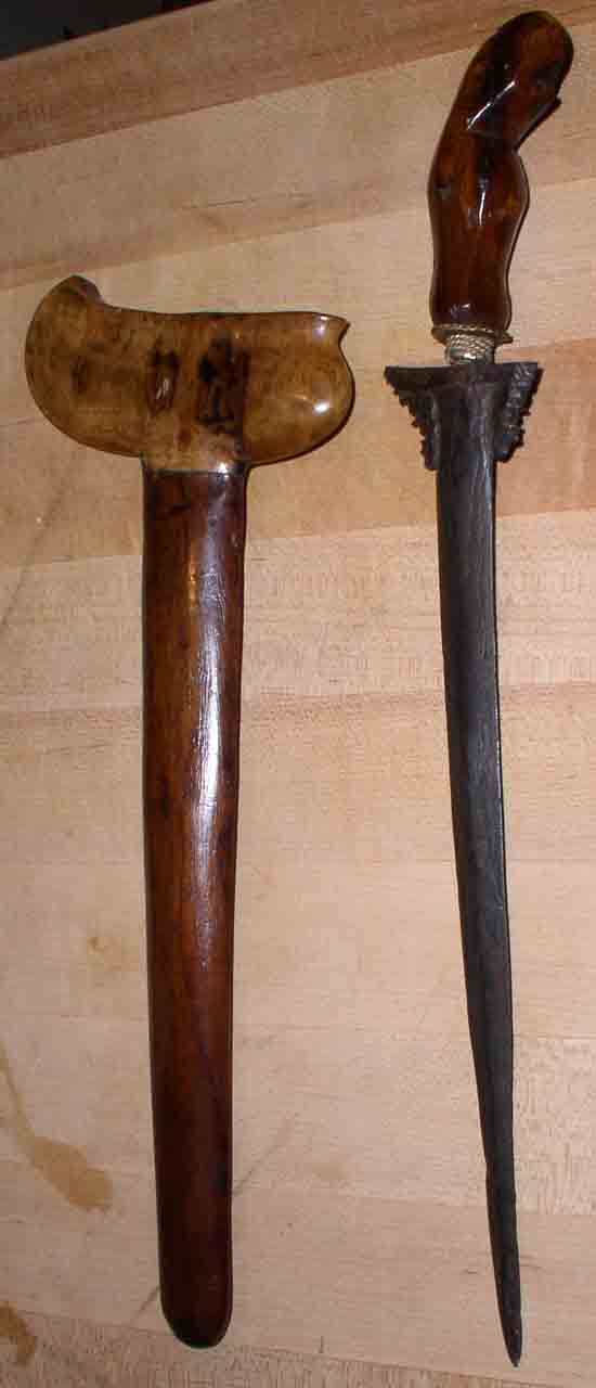

I would love to hear some opinions on this keris.

Hi montino,
I'm quite sure that this is an old piece. The dapur also is rare. I've never seen a putut kembar (the dapur) with a long narrow blade like a malay anak alang. from what i can see, the pamor on this keris is only pamor wengkon (protective pamor).
rasdan is offline   Reply With Quote
Old 27th January 2005, 06:45 PM   #3
Henk
Henk's Avatar
Posts: 1,209
This is a keris putut with praying ancestors on each side. Java Solo.
I would try to get another mendak. The one that is now on the keris is a very cheap one.

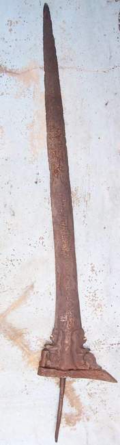

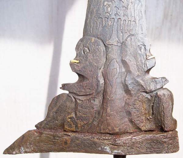

Here's a better photo of one of the praying men; a few more opinions and I'll tell you the story!
Old 27th January 2005, 07:42 PM   #5
Montino Bourbon
Montino Bourbon's Avatar
Posts: 301
Sorry, I forgot; total length 15 1/2 inches, blade length 10 1/2 inches, a small keris.

hmm... looks somtehing worng with this keris
i don't really think this one is an old keris
.. but.. it just my opinion...............

I think i'll have to agree with Sang Keris, it's dapur Putut Kembar...however
the gandik looks as though it's a different piece joined together, rather than shaped from the same bilah.

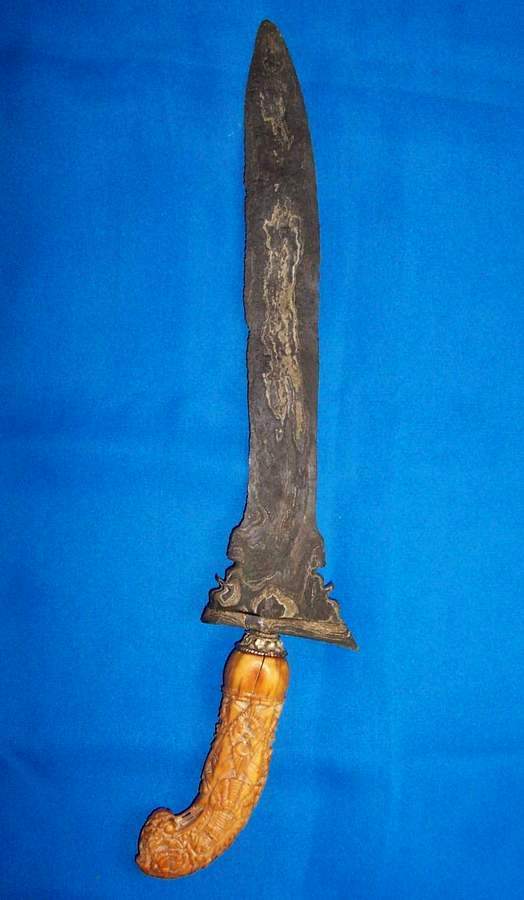

Default Puthut Kembar (Pandita Semedi)

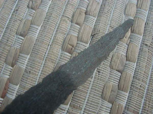

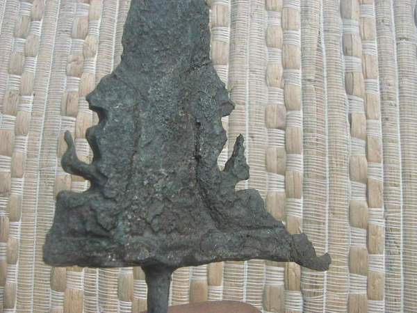

Hi dear all,
I Agree with Henk and Sang Keris about the Dapor.
But.... Sang Keris said, "hmm... looks somtehing worng with this keris. I don't really think this one is an old keris." .... whats wrong
... But ...... I think so.
If I look closer, the blade can be made from old keris, but it like modificated be came a puthut kembar.
In Indonesia, specificaly Jawa, keris with dapor like this have a deep mystical side, so that many people who can making a keris made a dapor like this......
hope that they can selling with high price to some people whose believe the story or legend.
I have it too..., but I still confused.., it is real or not

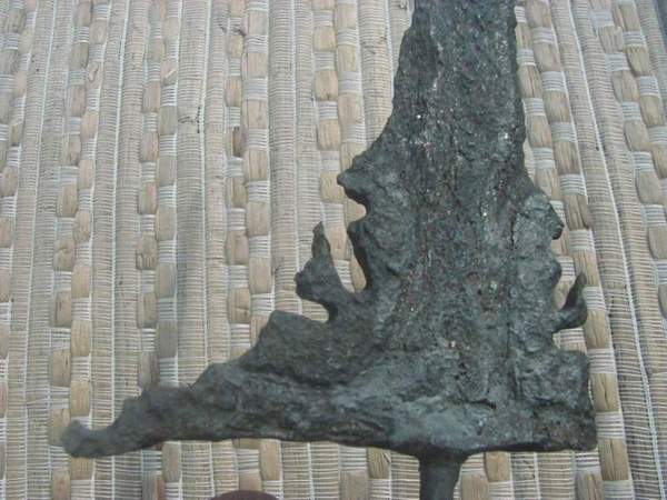

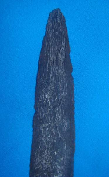

huh? whats the iron colour , sepang ?? is it green ??
looks like singosari keris....

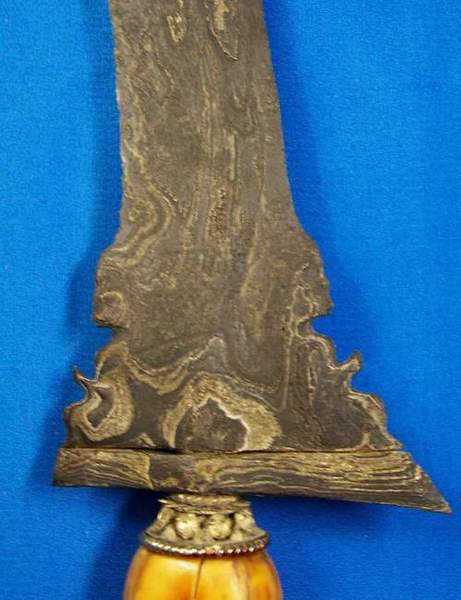

normally putut kembar is a medium size keris , and wide blade...
and.hmm.. still don't think this keris is old.........

Also, thank you for posting pictures of another keris putut kembar!
please keep it coming.

Sang Keris, your identification is so clear . My keris made from a green (or blue) iron. If you said it is tangguh Singosari, it could be, 'cause I got it from Malang, the place near from Singosari. TQ
Montino, be careful if you slept with your keris. It can be hurt you
Although we just seen kerisses from photographs, but we can look an iron and the curve and other thing we can.
Same if we seen your keris, the curve with puthut model, indeed a modificated from keris with dapor Brojol (common keris) in order to give a more value.
The curve look so sharp and like a new made. Not appropriate with the old blade..

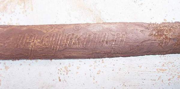

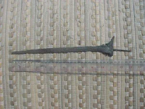

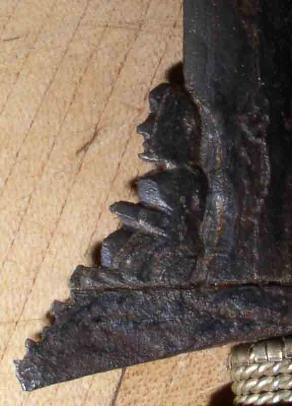

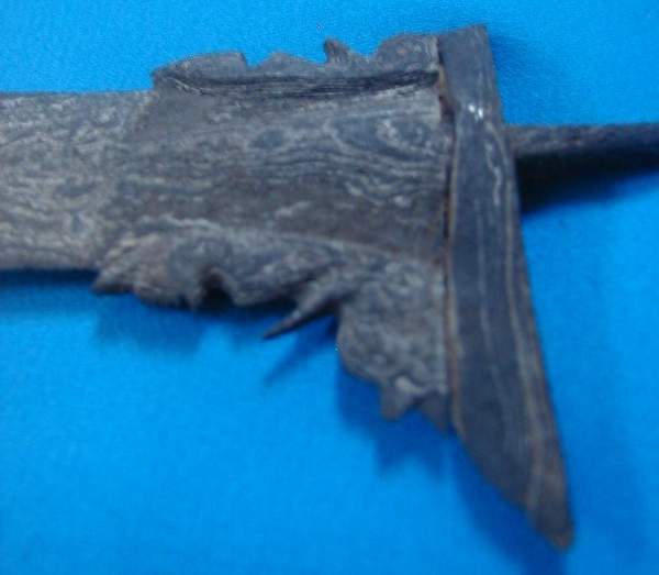

I try to post my kerisses with the same dapur (I have four).
Maybe other forumities have anather opinion about mine.

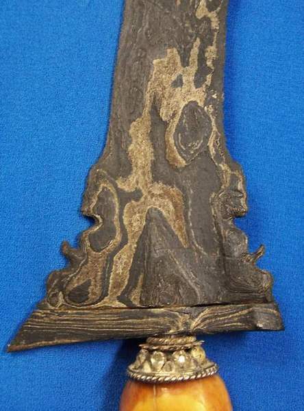

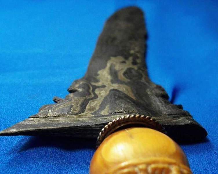

my another Puthut Kembar

ho..hoo..hoo.. is that baby pandita ,sepang ???
its looks like twin baby eating chocolate under the big tree

btw , i don't think any of sepang's "pendita kembar " made in 1900...
they're much older than that..... singosari ..and the other one could be tuban or majapahit..
except for that "twin Giant baby".....that one could be not too old ..

Shakti, my Puthut Kembar kerisses, except "twin Giant baby" (like Sang Keris said ) ), are an old kerisses. But... which of my kerisses can be called fake or real ?
It is so difficult, 'cause we dont know with clear... was it made by Mpu or just modificated by now

Sakhti, i am curious about how you manage to read chi from an internet photo. You must be powerful indeed. I have been doing energy work for years, but i always feel more comfortable actual holding a piece before proclaiming it's level of energy.
Sepang, you have shown us some interesting examples. The first one, which Sang Keris calls "green iron" is very interesting, but i wonder about it's condition. It certainly appears old. I have keris in my collection that are nearly 500 yrs. old that don't look like this. This one appears to have been excavated from the ground. I wonder why a keris of this powerful mystical type would have fallen into such bad care or been buried under ground. Do you know the history of where it was found.
You "baby tree" example appears to me to be an older blade that was altered with these carvings at a later date, but the examples you show in the middle may well be authentic. I am afraid i lack Sakhti's skills to be able to determine this from your photos.
