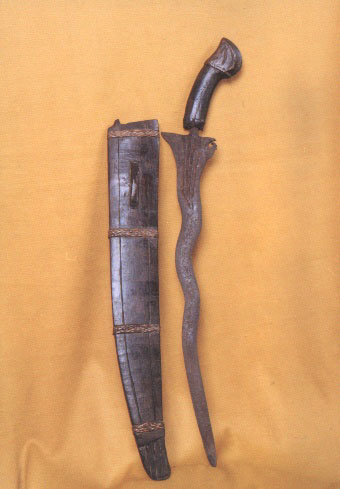

Back to the dating question, in early Spanish chronicles during the conquest for Luzon it was written that the bladed weapons used in Manila were small and ineffective, could they have meant the early kris? Supposedly the kris and kampilan were known thoughout the islands. Northern Luzon actually has legends about the kampilan written in epics. Also of note during the time of PI revolution the Katipunan among the educated elite began adapting the kris of old into their weaponry.
I'll let my theory rest at this point until I can get an alien to slingshot me back in time to validate my hunches...
At that, here is an odd keris/kris small in size and weight compared to the archaic kris but the same form blade with flat rounded almost oval tang, latter misfitted with a Visayan hilt...could this have been the type made prior to the archaic kris? I could use the archaic kris effectively as a sword but this one is too light and dagger like. I found it online from the PI and thought it was worth examining and studying.

Is the sheath made for it, or is that a garab sheath? The hilt is markedly similar (though not identical) to one I recently acquired, which seems to have had a full-length wrapping on the grip part in the fashion usually associated with Moro work. Yours?
Old 6th February 2005, 04:16 PM   #18
MABAGANI
MABAGANI's Avatar
Posts: 221
No, the sheath does not fit and not particularly garab in form, the hilt is actually similar to one of Vandoo's and Labantayo's Visayan kris from old threads, but with this keris/kris the hilt nor the scabbard fit, they look like they were just matched at a later point. Strange about the "dagger", the thickness of its tang does not leave room for the guard which looks like its missing in form but may have been intentionally made that way. IMHO, the type seems Brunei to me which makes sense if they were introducing them into Sulu, Mindanao, the Visayas and Luzon, noting Brunei's early connection to the Moros of Manila and the Brunei's later alliances with the Mindanao and Sulu sultanates in their struggle to control the Visayas. "If" this is in fact an early prototype keris/kris it would be safe to push the origin dates to around early/mid 16th century, where written accounts can be found about Brunei and their native dagger/keris?, this leaves approximately a century to the era of Buisan and Kudrat, for the keris to kris to develop into a sword or what we call the archaic type kris, when convergence in faith and kris type can be found among the Moro regions.
Again if this doesn't fly, we could always fall back on an alien origin...
