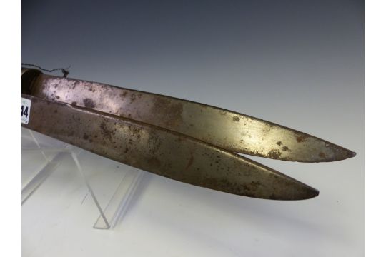

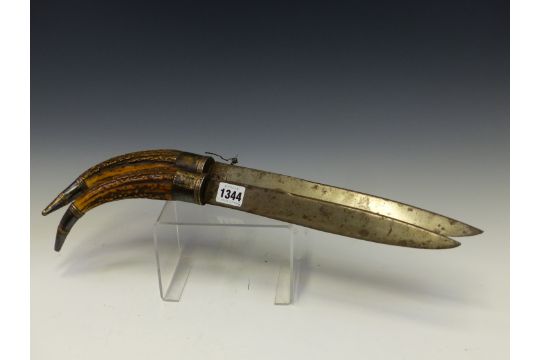

Here are the unusual and large paired antler hilt and silver ferule knives that came with the pair of swords, they are 48 cm long from tip of blade to tip of the hilt in a straight line and have 5 mm thick spines at the hilt, also very unusual for the south east Asian regions, one cleaned here the other not, I will when both are cleaned etch with lime juice to bring out the hamon's clearly.
These are for me a pistol grip type like a Badek - Badik, which are seen coming from southern Thailand and in the BKK armoury museum in many numbers, so maybe they had the same in southern Cambodia which is my suggestion, still no actual proof that they are though.
The silver ferrules though look pretty bog standard for dha and daab right across the region, even into Burma, so these to are a hard one to pinpoint, definitely unusual and all coming from the same estate in eastern Uk.
Any ideas would be interesting to hear.

I've looked at these several times trying to think where in mainland SE Asia they may have been made. It's as though they are from everywhere and nowhere.
I'm inclined to think they are composites with a heavy influence from a European. First, the blades look to me as though the tips have been reworked. The thin fullers run through the end of the blade, which suggests that the spear point was not the original form. The thin fuller running just beneath the spine reminds me of some northern Thai/Lao/Southern Yunan daab, and these might have come from our old friends the Achang from HuSa in southern Yunan. The hilts look standard Thai/Lao to me, and perhaps not very old.
The two long knives are interesting. The large stag hilts look too big to be from the small deer in mainland SE Asia. Hence I think another source such as Europe or the U.S. The fittings are standard Thai/Burmese/Shan ... The down curved hilts are reminiscent of some ivory-hilted Burmese examples. The reasonably heavy blade is also consistent with some Burmese examples, but other areas of the region also had similar heavy-bladed knives.
Although the knives and swords came from the same collection, they don't necessarily have to be from the same region. Pushed to identify the origins of these interesting pieces, I would say they each have mixed parentage with evidence of newer hilts added to older blades. Given that they came from a British collection, I would say a recent owner had modified them and replaced the hilts. Some of the reworking of these pieces was likely done in mainland SE Asia.

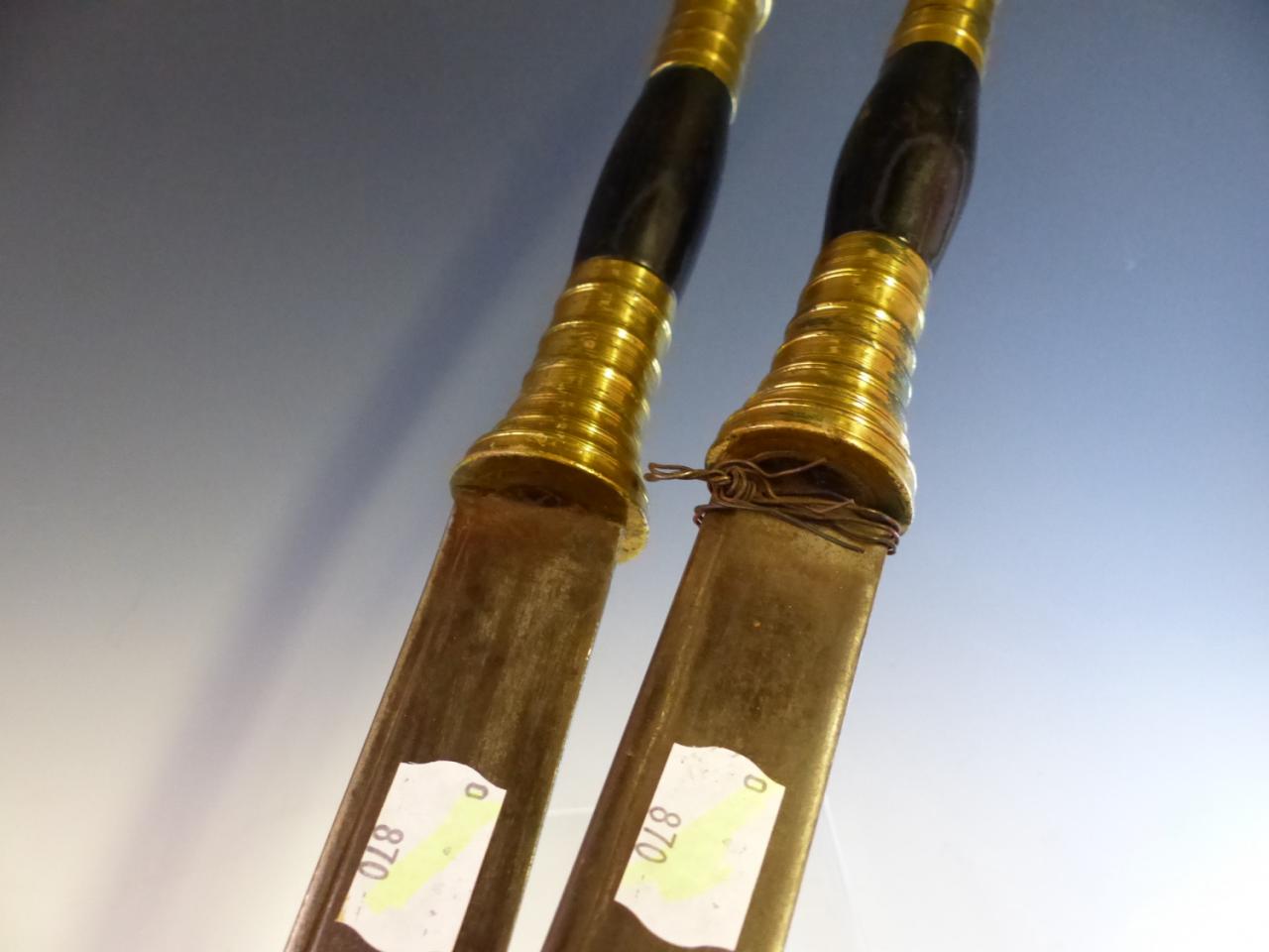

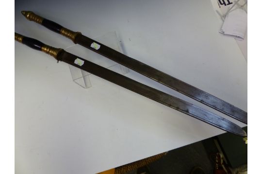

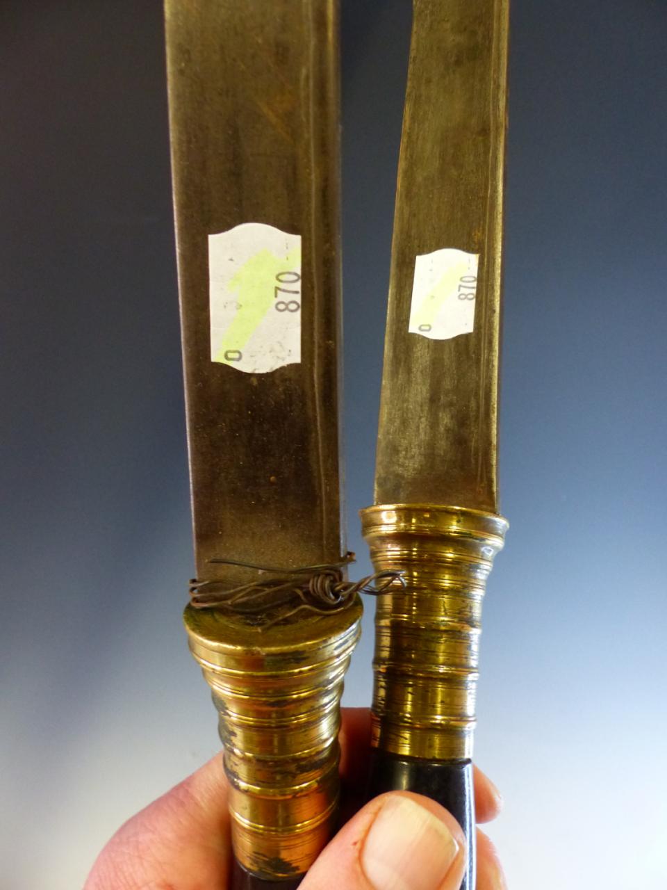

Default original auction pics of my 2 pairs.
Obviously Ian you can see that these are not old and have been doctored up just by these original auction pics, which quite clearly show both pairs to have considerable age and the swords even have the original wall hanger wire on them to from when they were displayed, if you can not see age here then you must need better glasses, I think my point is proven, ''ANY IDEAS ON THESE'' if not insults would be gratefully received, oddball's like this that do not conform to regular pattern's or types - styles do often turn up and with good age to, which is why I am still interested in antique edged weapons after many year's in the game, oddball pieces prove that nothing was set in stone and especially from south east Asian regions where in most cases the swords and other weapons we see from the region are as unique as the people who used them, I have an open mind and it is for me and many others like me the oddball pieces and non bog standard pieces that show us the great variety to be had from the region that were collected in colonial times. Snody

Just to throw another opinion in the mix... I see nothing with either the swords or the knives that seems 'off' for the region.
Antler is commonly used across Thailand, Laos, Cambodia and Vietnam for knives. While perhaps not the most common hilt material it is certainly not unusual.
The swords are certainly unusual, but the tip profile, fullering and hilts all conform to other styles we know. I think the barge idea is probably spot on, although its difficult to pin down an exact attribution.

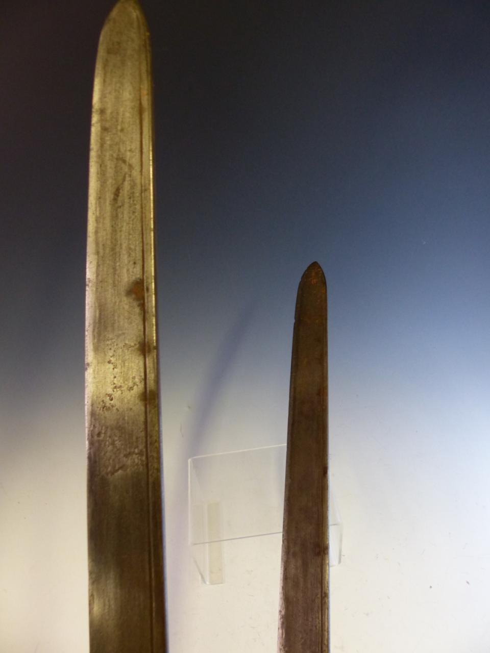

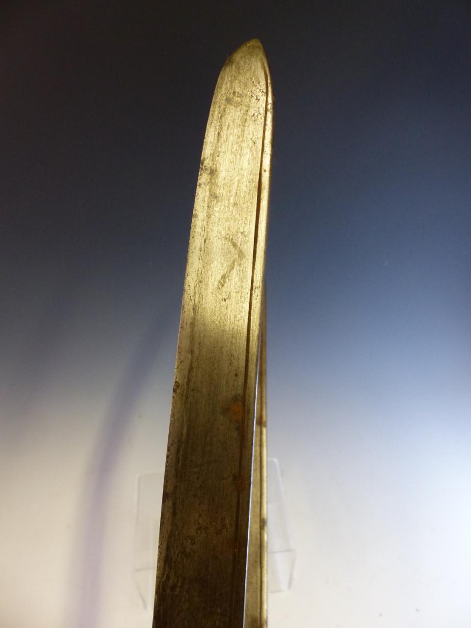

Default sword blade tips !! as originally made.
From the original auction pics, just to make sure that no one thinks these swords are as suggested altered in any way, HERE IS A CLOSE UP OF THE BLADE TIP !.
They are both as purchased and original. Snody.

Sorry to upset you. The later pictures certainly show the swords to be older weapons and not reworked. As far as stag horn on knives, it has been my experience that this is uncommon on mainland SE Asian knives, especially the size of stag on these two. Perhaps you have other examples to show that you could post to a new thread.
