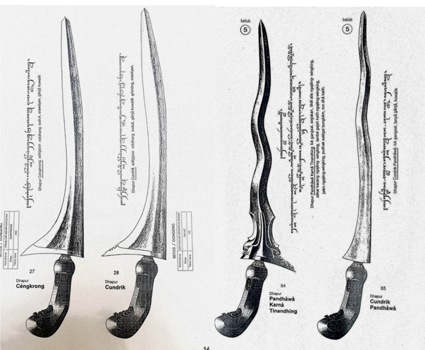

For Cengkrong and Cundrik the normal position in the sheath is reversed, because reversed is the Gonjo, not the hilt.
The general problem is, as I understand it, that Marco's Keris isn't Cundrik or Cengkrong.
Well, one of Pusaka of the Empu lineage from Magetan is a Pedang-like Keris, which isn't Cundrik or Cengkrong, because it has completely different Ricikan, with reversed, quite unconventional Gonjo. So the position of it in the sheath is reversed. It is traditionally dated back to the first Empu in Magetan lineage.
What I also understand is, that Marco's Keris is a more like a Dhapur, which normally sits in the sheath the common way.

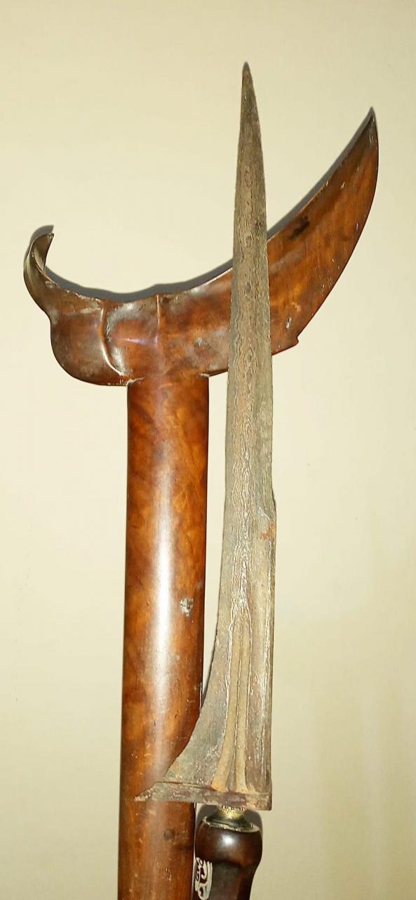

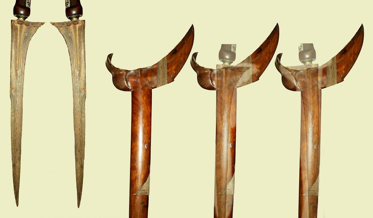

Marco, I doubt that anybody here, or elsewhere, has any problem at all with a reversed hilt, this is not infrequent, it does occur.
The problem arises with a reverse mount to the wrongko.
In normal dress situations, and for several other reasons, this reverse mount to wrongko is simply impractical.
I do believe that there would be a reason for this reverse mount to wrongko, but whatever that reason might be, it falls outside of my experience & knowledge.

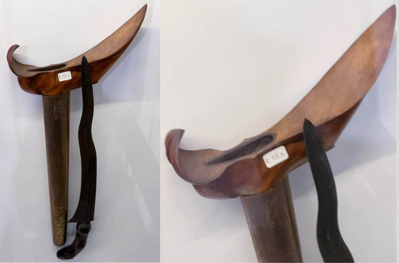

Sorry Alan, another ulterior example (image taken from the net)
1. Sheath and the keris resting over the ladrang (first pic)
2. then I ask myself the question: but how is the blade inserted?
3: I take the blade and turn it upside down
4. I take a second blade, turn it upside down and mirror it
4: I approach the two blades to the ladrang as if they were inserted and this is the result (second pic):

With cundrik & cengkrong, the hilt position is sometimes reversed, in my experience, the position of the blade in the wrongko is not.
The picture posted with the blade over the wrongko shows an incorrectly mounted blade in both positions, if the blade is original to the wrongko we will find that the top of the gonjo sits with the sirah cecak & the buntut urang both sitting within the top line of the atasan, it is permissible for a small part of the gonjo to rise above the top line of the gambar at its center, it is not permissible for the gonjo to sit as depicted.

excuse me all, and I appeal to anyone who reads this topic. Please make the effort to enter my way of thinking for a moment...I promise you won't go crazy:
1. I posted a kris (a kris of mine) reversed in the scabbard
2. I was immediately told that a kris had never been seen in that position. I was alone
3. I posted an old example, an example taken from vkf. Now I was no longer the only one but there were two of us
4. I posted other examples... now we were no longer two but 2%
5. I hypothesized the idea, I think with an unsubstantiated image, that the walikat could be the suitable scabbard for those types of kris if you want an insertion according to tradition
6. Finally, I reiterated my thoughts with a last image. That is, it could also be according to tradition that those dhapurs need a rotated head-to-tail insertion

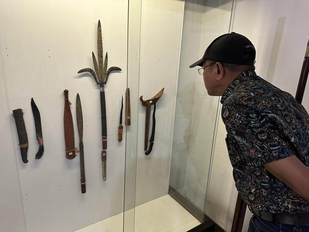

Last Thursday (01/06/2023) I went to the Radyapustaka Museum in Solo. In a museum showcase, I saw a keris quite similar to Marco's keris – not precisely similar, but it had three curves or luks. It is a Cengkrong Jangkung, if Marco's keris luk five, it is a Cengkrong Pandawa.
The Cengkrong Jangkung keris is on the far right in the showcase in front of me.

The cengkrong dhapur on the Javanese keris, is the only dhapur that is a panjingan (omah-omahan, keris hole) in its special position. Unlike the other dhapur kerises. Keris hole in its sheath, is reversed. The front becomes the back, the back becomes the front of the sheath.
As photographed (01/06/2023)in this keris belonging to the Radyapustaka Museum in Solo, Central Java, Indonesia...

Radyapustaka sounds pretty authoritative, but it still gets down to the opinion of one man.
Here is re-posting of an earlier post of mine:-

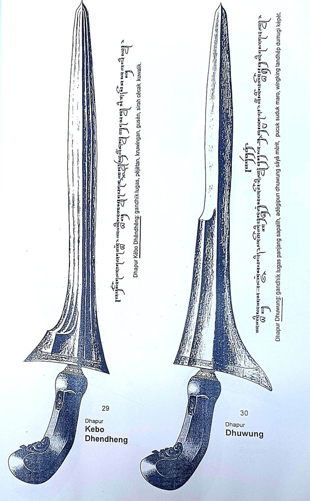

The SKA pakem cengkrong lacks kruwingan, whilst the SKA pakem dhuwung does have kruwingan, also a cengkrong does not need to have the back edge sharp, whereas the dhuwung does.
The subject keris has a sharp back edge and kruwingan.
Using the SKA pakem it cannot be anything other than dhuwung luk lima, but I have no idea at all what it might have been called at the time & in the place where it was made.
I do not think this is a Central Javanese keris, more likely East Jawa, and over there it could have a half dozen other names.
Actually, if we did allow that it was a cengkrong with 5 luk, in spite of the fact that it does not quite satisfy the requirements for a cengkrong, it would then be a Pandowo Cengkrong, not a Cengkrong Luk Lima.
I don't think I have a firm opinion in respect of dhapur, but its nice to see another genuine old example.
However, it is difficult to see detail of your example , I also have some photos of this display case, but my pics are maybe more indistinct than yours.
For me, it gets down to only one thing:- what does the SKA pakem say?
We can have 50 people look at the same thing and all come up with maybe 50 or more different opinions, it is always nice to be able to back up an opinion with some sort of authority.
Marco's keris (post #17) shows a back that in English we would call a pipe back, in the keris this pipe back blade is found in dhapur dhuwung, it is not found in any other dhapur.
Does the Radyapustaka example have a pipe back blade?
If so it is similar to Marco's blade and according to the SKA pakem it qualifies as dhuwung.
If it does not have a pipe back blade then it is not similar to Marco's keris and cengkrong might well apply, in which case the reverse mount is correct in the RP example, the comment in the SKA pakem is "--- ganja kuwalik".

I tried to open the book "Dhapur" (Damartaji, 1998) which was copied from the original manuscript "Buku Gambar Dhapuripun Dhuwung saha Waos" (Picture Book of Keris and Tombak Dhapurs, 1920) which was in the hands of the late Kanjeng Gusti Prince Harya (KGPH) Hadiwijaya son King of Surakarta Paku Buwana X (1866-1937).
The book contains drawings of the Surakarta version of the Javanese keris (SKA) collected from palace manuscripts by Gusti Hadiwijaya, the son of the Surakarta king. I tried to open an image of Cengkrong's dhapur lined up with Cundrik's dhapur. And Cundrik Pandawa in the form of Cundrik's dhapur with five curves.
The picture is as follows:

Default DHAPUR DHUWUNG
The Dhuwung dhapur is different from the Cengkrong dhapur. Cengkrong's gandhik is at the back, while the gandhik of Dhuwung dhapur is normal at the front position.
I took an example of the picture in the same book from Gusti Hadiwijaya, son of the King of Surakarta Paku Buwana X

Yes, that is the reference I mentioned.
I actually had the original of that in my possession for a few days back in the 1980's, it was offered to me but I could not afford the price tag, I photographed all the pages though. A very big hand drawn book. I had those photos printed professionally as large hardcopy photos, these are what I used to use before the commercial blue cover ripoff became available.
The book I use now is the blue cover one that you mention.
We are both using the same reference, and that reference shows a Cundrik Pandowo as picture #85.
Now, if we look at picture #27 what we see is a Cengkrong, on the Cengkrong, the hilt has been reversed, next to the Cengkrong at pic #28 we have Cundrik, and the hilt on that has been reversed also.
On all three blades, the hilts have been reversed, ie, the batuk of the jejeran sits above the buntut urang of the gonjo, it does not sit above the sirah cecak of the gonjo as is the case in a normal mounting of the jejeran. Of course, the Cundrik Pandowo does not have a gonjo, so in this case the batuk sits above the wadidang, which in a normal keris is directly below the buntut urang.
It is the hilt that is reversed, nothing else.
Neither the Cengkrong nor the Cundrik keris form has a pipe back, however, the Dhuwung form does have a pipe back, see picture #30.
Marco's keris has a blade back that is compatible with the dhuwung classification, not with Cengkrong & not with Cundrik.
In accordance with the guidance of this reference that we are both using, Marco's keris is a Dhuwung classification, not Cundrik, not Cengkrong.
