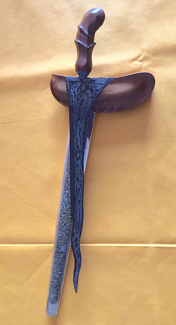

Marcokeris
Marcokeris's Avatar
Location: Italy
Posts: 928

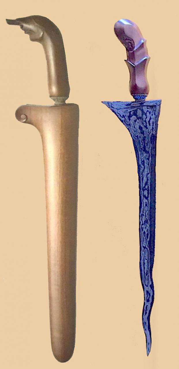

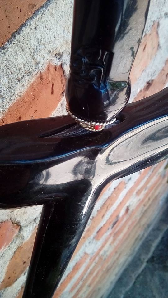

Hello Marco,
Maybe the given pictures of three from my keris are helpful!
I feel the sarung for your keris is wrong, sorry.

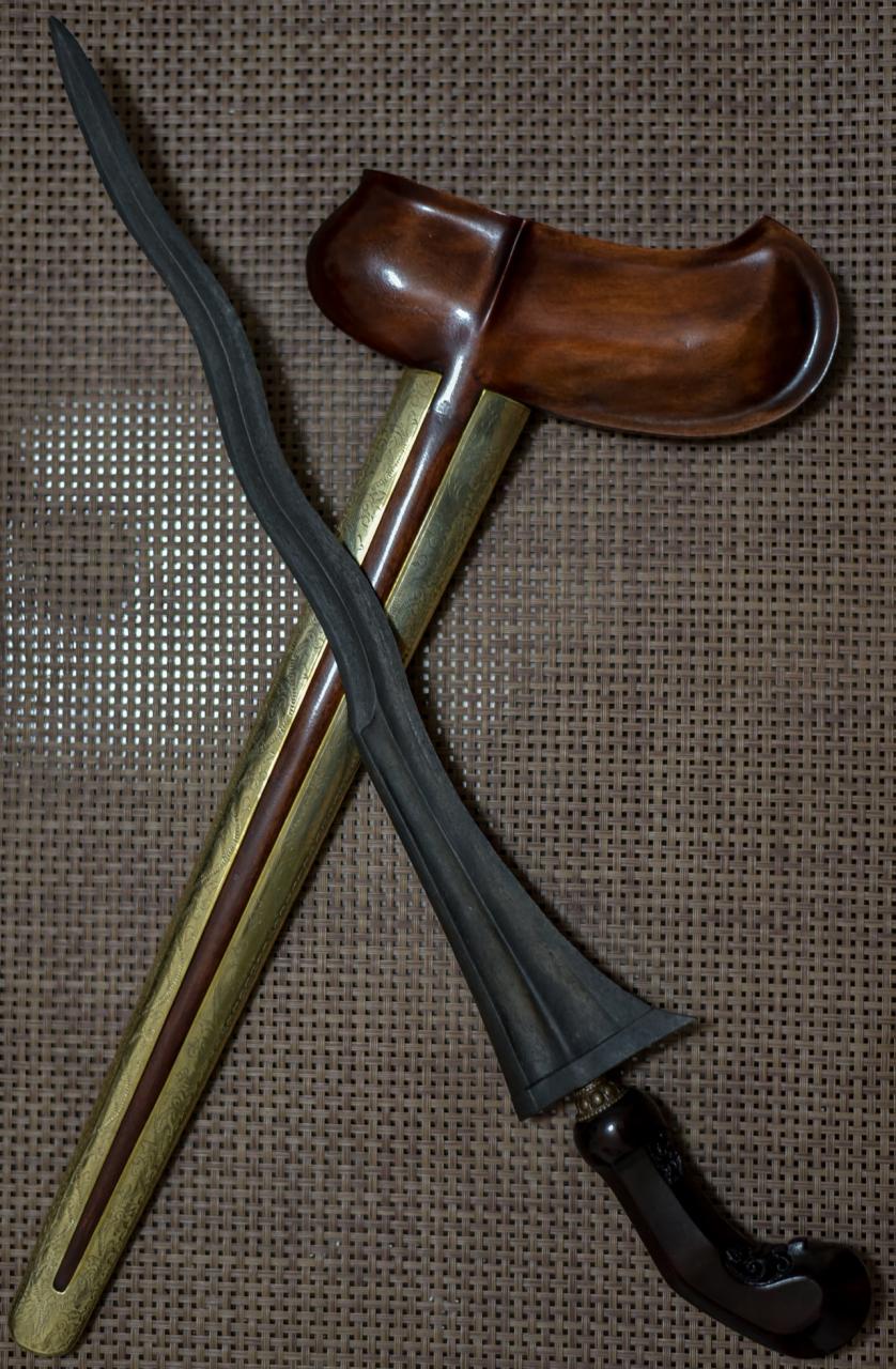

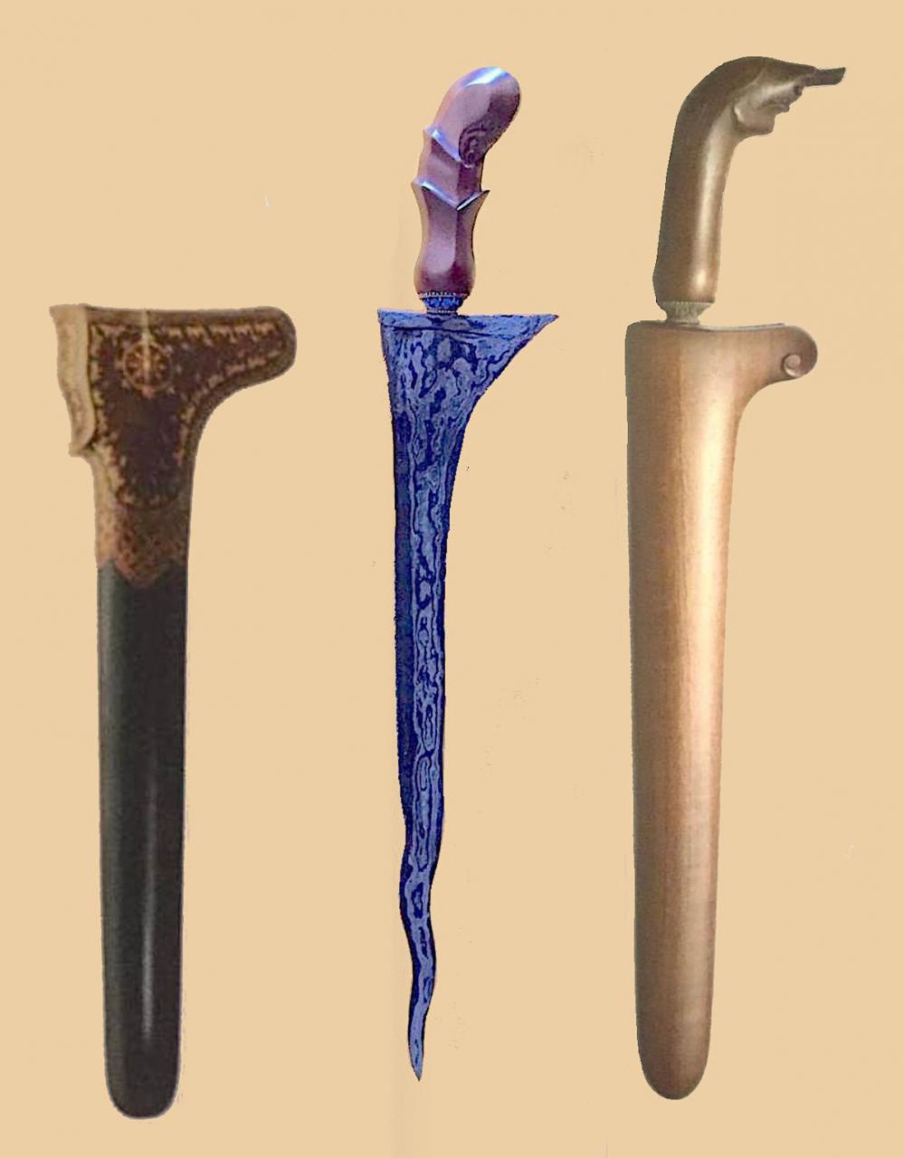

Hello Detlef
my keris is like this
Old 19th April 2023, 06:50 PM   #63
Posts: 7,297
Originally Posted by Marcokeris View Post
Hello Detlef
Sorry Marco, but i must point out that your keris is not like this. The keris in the image above is indeed properly oriented in the sheath. It is only the hilt that is oriented in reverse.
Old 20th April 2023, 05:58 AM   #64
Agree with David, sorry Marco.
Old 20th April 2023, 06:44 AM   #65
Marcokeris
Marcokeris's Avatar
Location: Italy
Posts: 928
there is only one small detail: the scabbard in the photo does not have a pendok and has the same painting on both sides. so by turning the scabbard 180 degrees when I extract the kris I have the handle in the right position to be held correctly in the hand. With a pendok scabbard this rotation to properly extract the kris would be an eyesore.
I'm not sure what you are trying to say here. The hilt on the keris in the photo simply needs to be rotated 180 degrees. Problem solved.

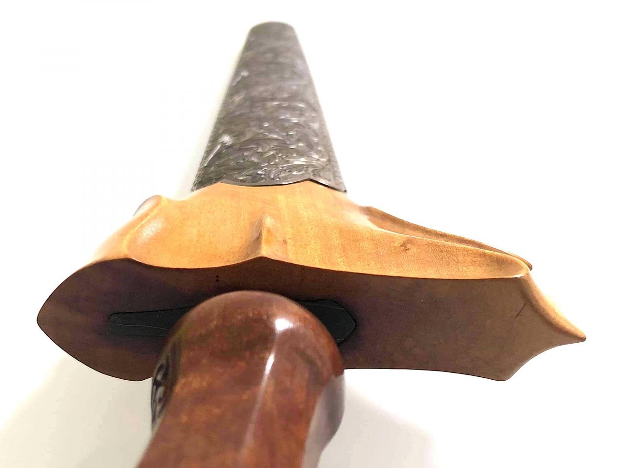

Dear Marco,
You can turn the keris with the painted scabbard completely when inside the scabbard or just the handle as you like and as many times as you like, it doesn't change the fact that the front of the blade points to the front of the scabbard. In the shown picture the handle simple shows to the wrong side.

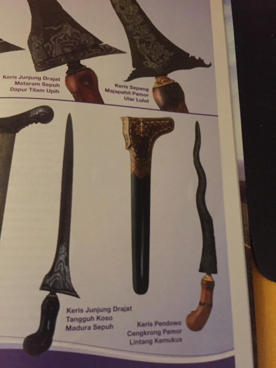

I apologize to you David but I find it correct to post this ... and then I shut up
http://www.vikingsword.com/vb/showth...eris+Cengkrong

Old 25th April 2023, 06:41 PM   #73
Marcos blade isn't a cengkrong blade!

Old 25th April 2023, 06:51 PM   #75
Posts: 7,297

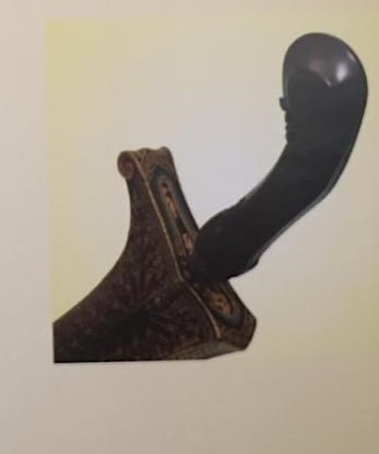

Well, "no doubt"? I couldn't say. Because those photos do not show us what it looks like from the top of the wrongko. Usually these hilts are not fixed in place so the hilt could have quite easily been turned around for the photo of when the blade is in the sheath. Not saying this is what was done. Only that there is certainly a possibility for doubt until a revealing photograph can be shown.
Now if indeed this is another example of a blade that actually is mounted in reverse position in the sheath then that make TWO. Two examples like this in all my years of looking at keris and all of Alan's years of looking at keris and all of Detlef's years, etc. etc. So if indeed you did find one other example (and i still have not seen the photograph that will prove that), then we still have an anomaly working here. Something far outside the norm. If the intention is to show that this reversal of position in the sheath is the accepted norm for keris of this type i believe we are a long way from that being shown.
So my only question here is why? Not why was it done, by why is it so important to establish this as being within the norms of Javanese keris culture. For myself, i have always appreciated the occasional oddity. And i am afraid that for the time being this remains an oddity. If it was mine i would simply enjoy it.

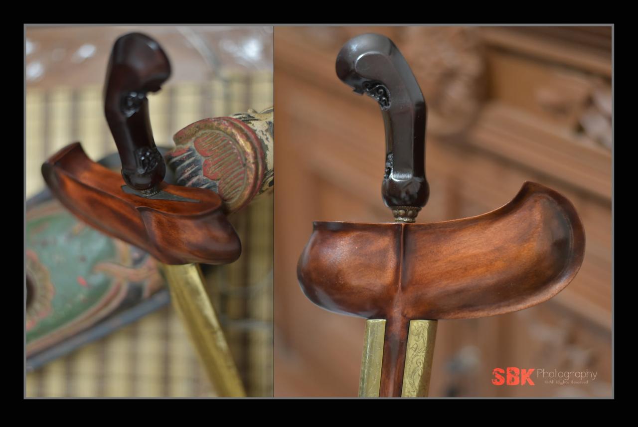

some pics
Old 1st May 2023, 05:23 PM   #77
Posts: 7,297
Good detective work coming up with a few more examples of this odd positioning. But i would say that now the real detective work begins. Because surely the overwhelming evidence points to the fact that this is well outside the norm. Certainly the amount of keris oriented this way in the wrongko is far less than 1%. So the question here is not IF such orientation exists, however slight, but rather WHY this has been done in these rare cases.

Sorry David, but there must be a reason why these types of dhapur are depicted in old texts with the hilt pointing in the opposite side! ....If we agree with our geometry, the reason is extremely simple: as I have already written in many previous posts: the keris could not enter, into the sheath, correctly.

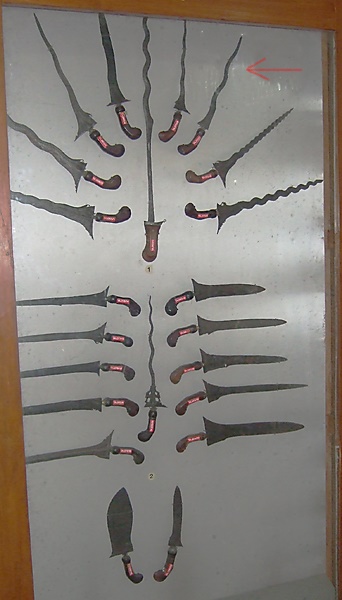

Radya Pustaka Museum

reverse mounting of a hilt is not really uncommon, the uncommon thing with Marco's keris is that it has been mounted back to front in the wrongko.
Yes Gustav, the red signed keris has the inverted hilt in according with tradition.
It's a pity that in the Radia Pustaka Museum’s pic we cannot see not only the corresponding sheath (if it's a walikat, or a gayaman or a ladrang) but also how the keris is housed inside.
I am however more and more convinced that with a gayman or, even worse, with a ladrang, the insertion in the regular way would be very, but very problematic.
I say this because from the images found on texts, in this forum, in FB groups, or also on You Tube I only find post that confirm what I think and have written and I have yet to see a concrete, real evidence that proves otherwise
