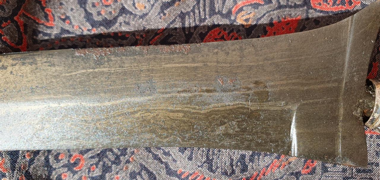

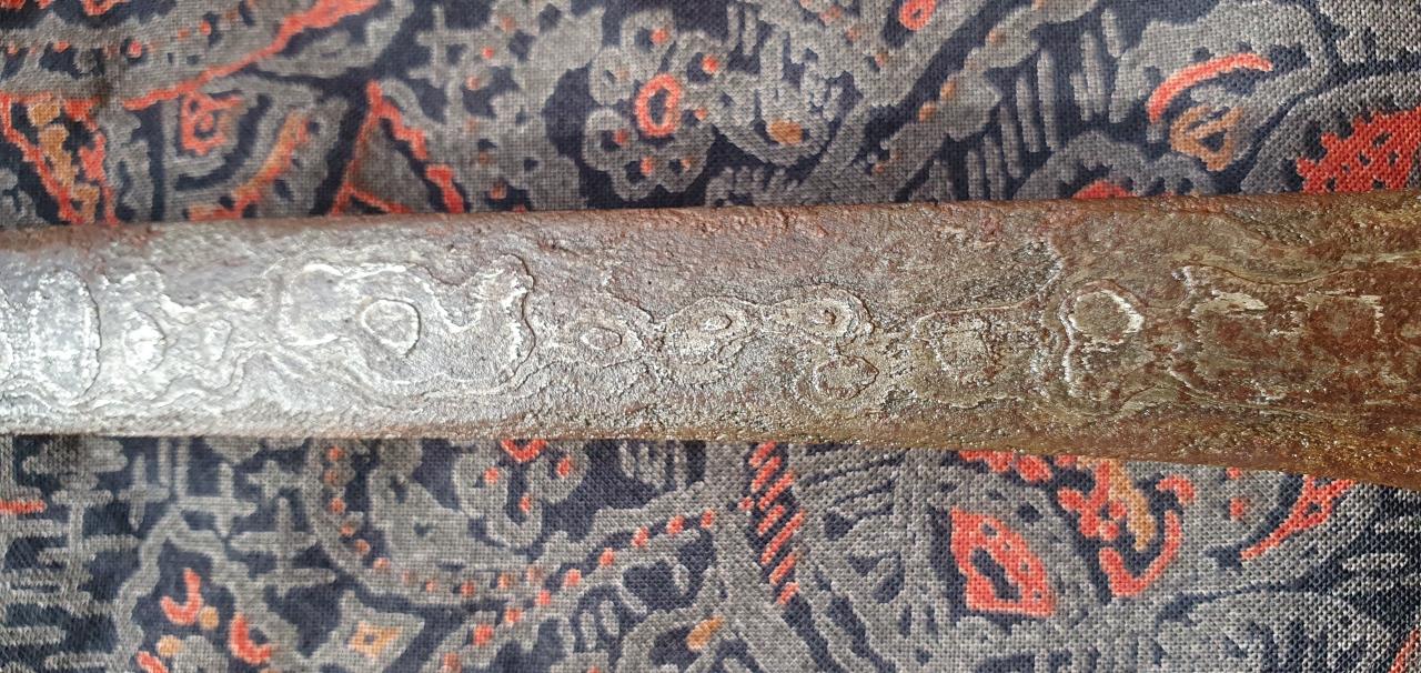

Last Tuesday I received an open message on facebook, it is still there, that after his mother past away, she was Indonesian, Lampung, his father was Dutch, they found a box with 11 pusakas. They all forgot about the coffin after decades and found it on the top of the house. Opening the coffin, the gentleman suddenly remembered that strange things indeed happened in his youth, such as his father who got a deep cutting on a keris, and when one of the keris inexplicably fell off the wall, ending up right between his fathers toes, the father decided to lock up the kerisses, and it stayed there for 70 years... The gentleman did not dare to remove the plastic from the kerisses, of what he remembered of the keris and I smelled the camphor smell of my youth!!! Opening it was even for me like going back in time...
It is very interesting to see how keris look like from the time when my parents left Indonesia.
I could identify almost everything, indeed as the gentleman told me all Lampung: 3 Rudus, 1 Sewar, 2 Badek, 1 Baladau, 4 Lampung keris with Putri Malu grip. A coulpe with Sepukal keleng blade, One with a Lampung blade and one i can not identify!

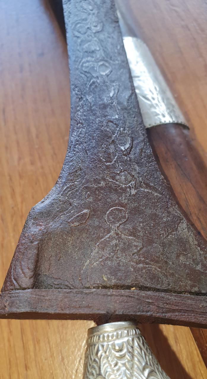

It is the last blade of the last picture, that is reshaped, they even made a strange gonjo with pamor, but also the point looks reshaped, i don`t know... The blade looks a bit like the Banten blades from the 17th century, but i am not sure.
Does anny body has an idea???Name:  20230322_115006.jpg

Nice to see these blades but I agree I don't think that the blades or the dress were very old when they arrived in the NL.
The last blade that you say may be a Banten blade may have started its life as a tombak , the Ganja is certainly a later and not too good an addition

I agree with Gavin and Milandro that the last blade is not an old Banten keris.

Dear all,
I'd guess that the keris on the right never was a tombak but started its life similar as the 2 on the left side. This is a known style from southern Sumatra that seems to have developed during the late colonial period - not sure when the first example got documented. Good to have additional evidence - thanks for posting, David!
The second keris from the right looks like a genuine antique blade with also old fittings (except for the scabbard stem and its silver bands which seem to be a later restoration.
As mentioned, the 3 swords are typical examples from southern Sumatra. David, can you confirm if the name rudus has also been in use in Lampung? I'm only aware of its use considerably further North (for a different type of blade).
I'd like to see the blades of the 4 additional pieces, too. As mentioned, posting these on the main forum would be much preferred.

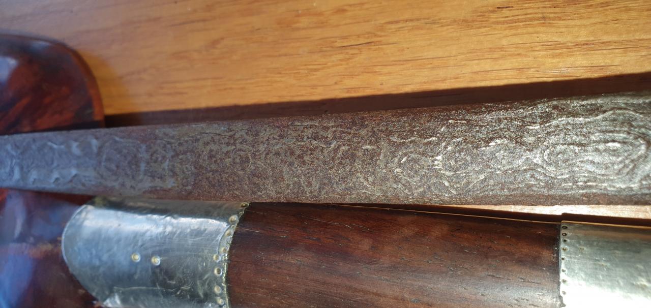

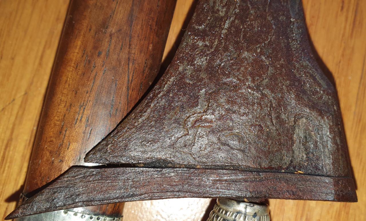

I tried to make some better pictures of the first 3 keris

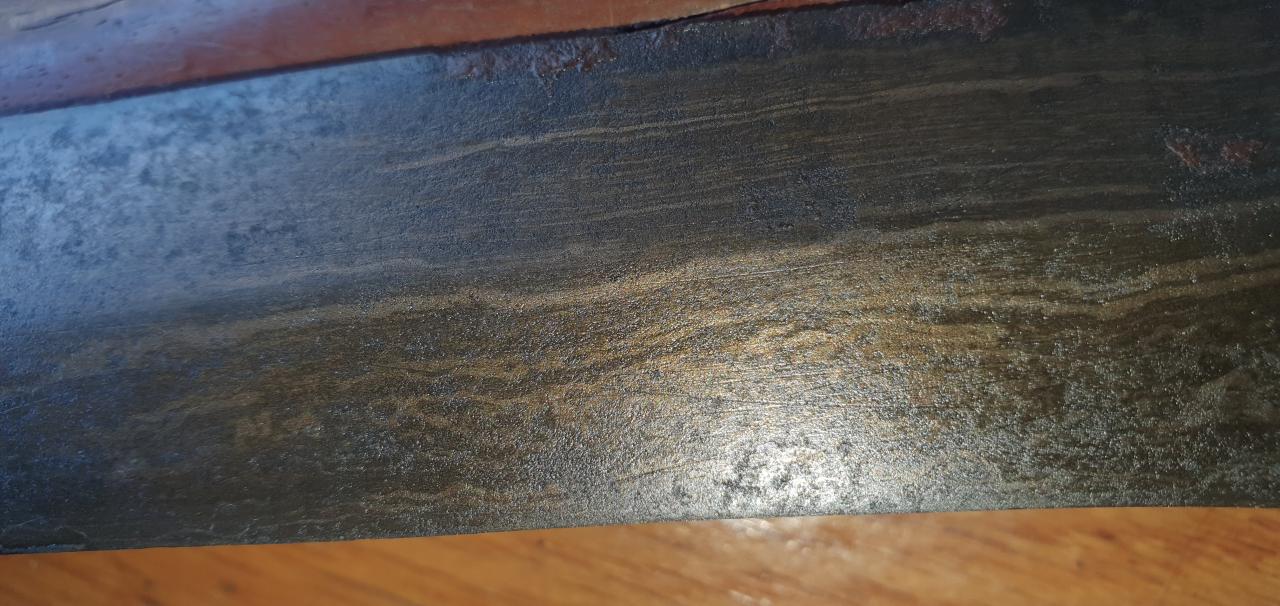

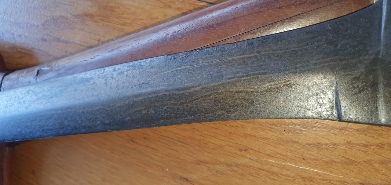

Aha, the sun starts shining in Belgium, now i have some good light.

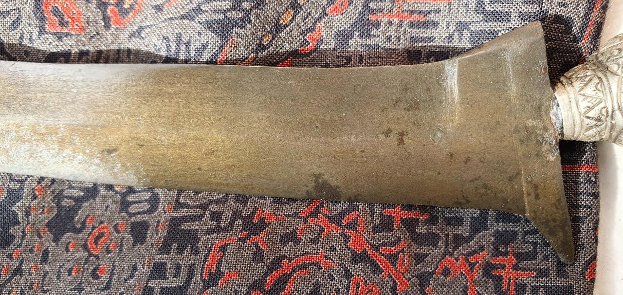

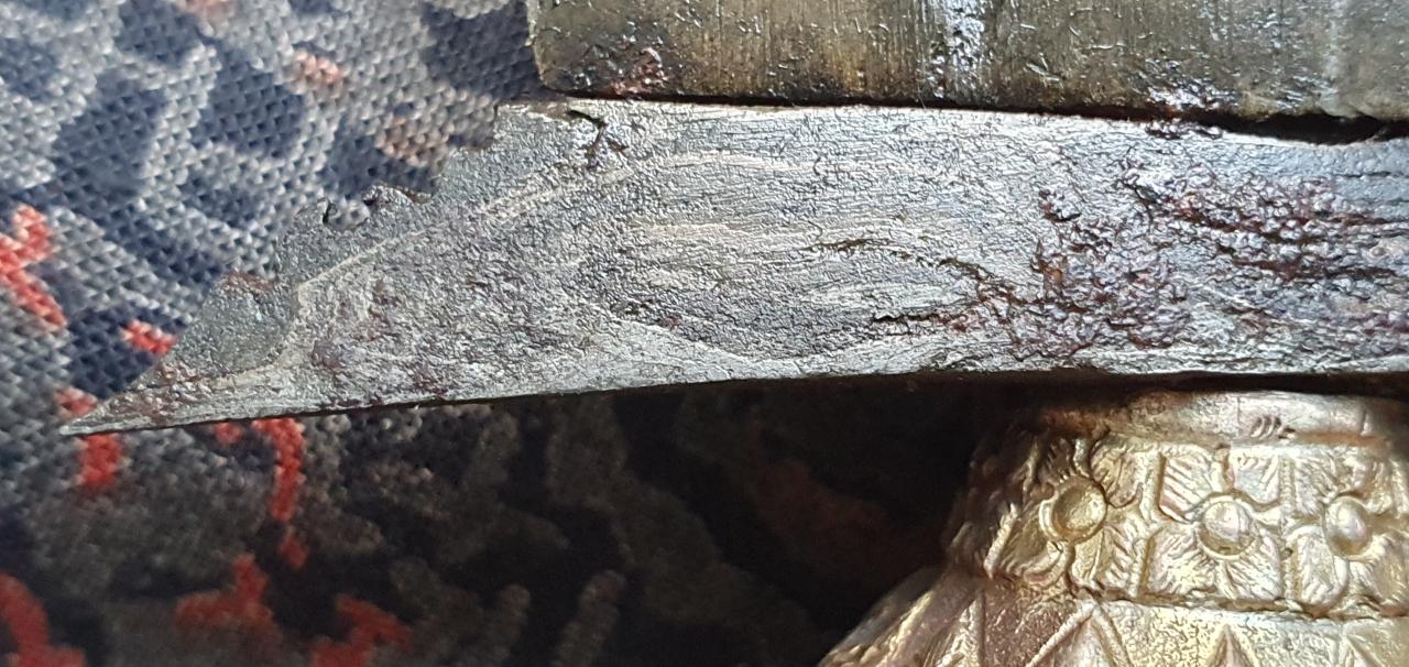

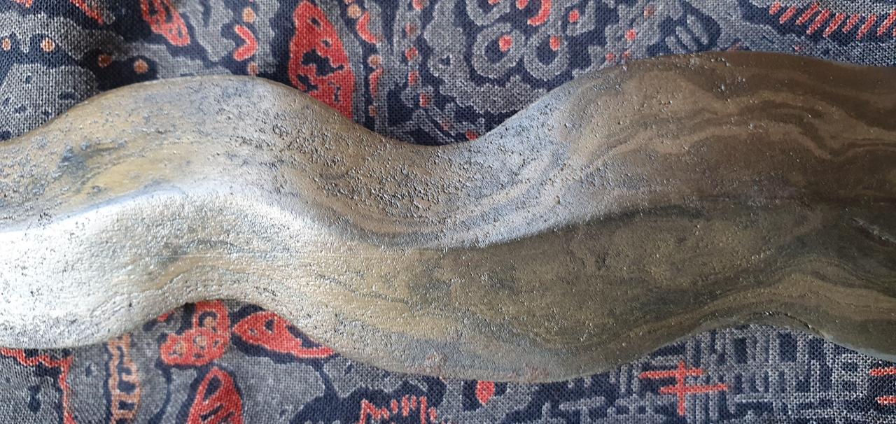

The first picture is from the Patrem Sepukal blade, the second also from the Sepukal blade but the large keris, but i see that it has some kind of pamor patern in the blade. The 3rd pictrue is from their family pusaka. And the last picture is from the keris i do not realy understand what it is and an extra picture of the gonjo. It is a realy big and heavy blade.

Thanks for the additional pics, David!
Ok, let's stick with the keris here only:
As mentioned, I feel all 3 examples coming from a similar environment, possibly made by village bladesmiths. It is interesting to note the strong differences in the laminations (pamor). The separate gonjo of the one on the right does seem to be made from very different stock than the blade, indeed. Unless there are any clear signs of later replacement, it still might be original; at least I'm having a hard time why anyone would fiddle around with such a blade, especially since it apparently left Indonesia only a few decades after its manufacture. (This type of pamor is not what we see on well-preserved early keris, even if repolished.)
I still like the keris second from right; it's an old blade in reasonable condition that should restore well. I'd posit it originally came from Madura as a trade blade.
