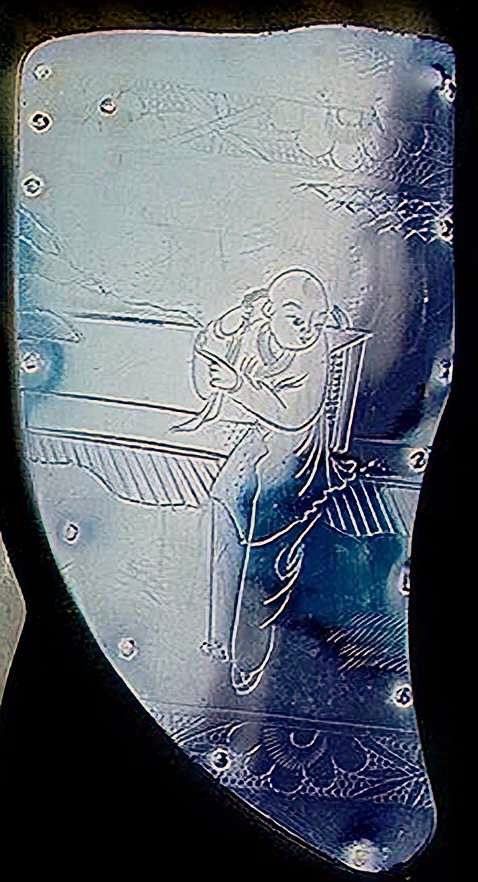

Does the engraving on the sheath offer any insights? The man appears to be doing something.

he has a bag full of misty knives thrown over his shoulder

I enlarged and inverted the scabbard bit. Makes it easier to see the figure. Still have no idea what he is doing...

Posts: 2,833
To me it looks as if he is walking along with a basket over his shoulder. From what I can see it looks very like baskets used for tea/tobacco picking so maybe the original idea that the knife is used for that purpose could be correct. The dress of the man looks Chinese to me.

Join Date: Oct 2010
Posts: 452
Maybe a puer tea cake knife. It is used to break up puer tea cakes or bricks since they may be pressed tightly.

Posts: 4,747
Ed,
Thank you so much!!! I think you have solved my riddle. The Oriental figure (a woman I believe) on the sheath could easily be Chinese, and pu-ehr tea, which is manufactured in bricks, is peculiar to Yunnan and neighboring northern Thailand, Laos and Vietnam. There is a nice online explanation of pu-ehr tea and pu-ehr cakes here.
My knife is clearly decorative in its sheath, and would fit well a tea service. As to its origin, I think we need to look to where pu-ehr tea is popular in southern China and neighboring SE Asia. The hilt is carved horn, with what I have called a dog-head pommel, but could be a cat. The horn type is consistent with water buffalo and it has some slight beetle damage consistent with horn damage on other hilts, etc. The brass sheath has a plain rear side and the engraved front as shown above and in more detail in Wayne's post.
Wayne, thanks for enlarging the picture of the front of the sheath. Thanks also to Stu who raised the idea the figure could be collecting tea. I had not thought of tea when I first saw it.
I'm fairly sure that Ed has nailed this one, and I thank him for finding the closely matching blade profile.
For our archives, here are pictures from the site Ed referenced:
Hi Ian,
I think more likely a man as a bald head with a Que (pigtail) was common in early China. Just a thought.............
Stu
