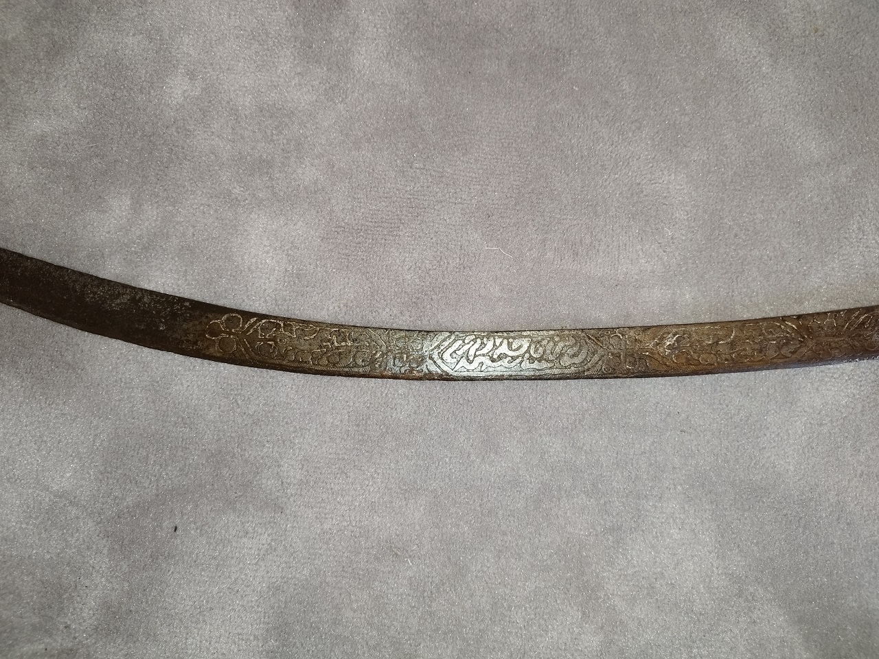

Dear All,
I inhereted this Tulwar from my dad. He did a roadtrip to Afghanistan and India in the early 70ies and brought this Tulwar, together with a Khyber-knife and an afghan muzzle-loader back home.

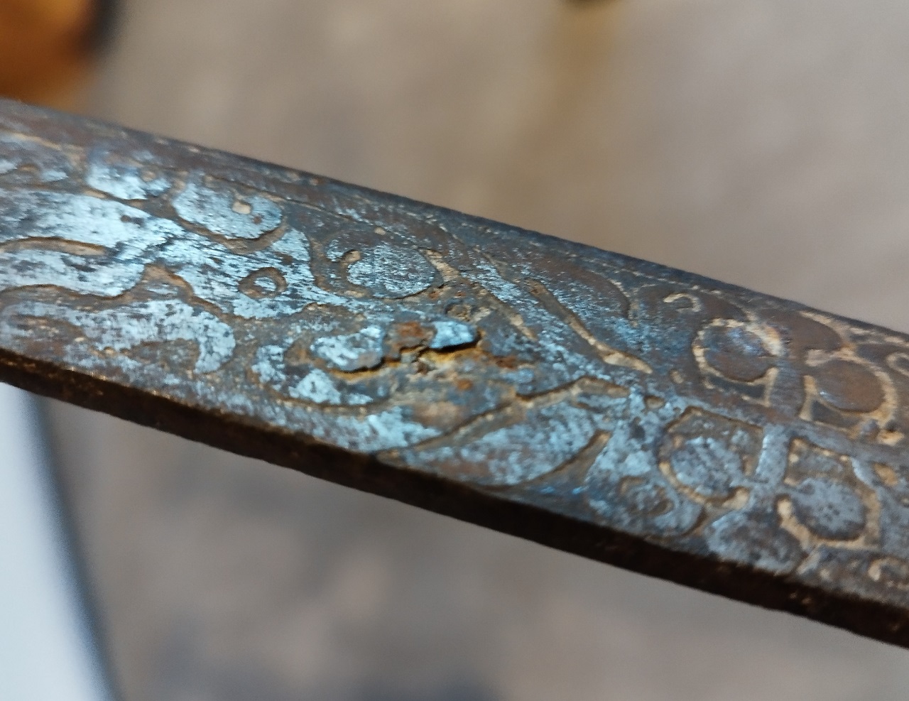

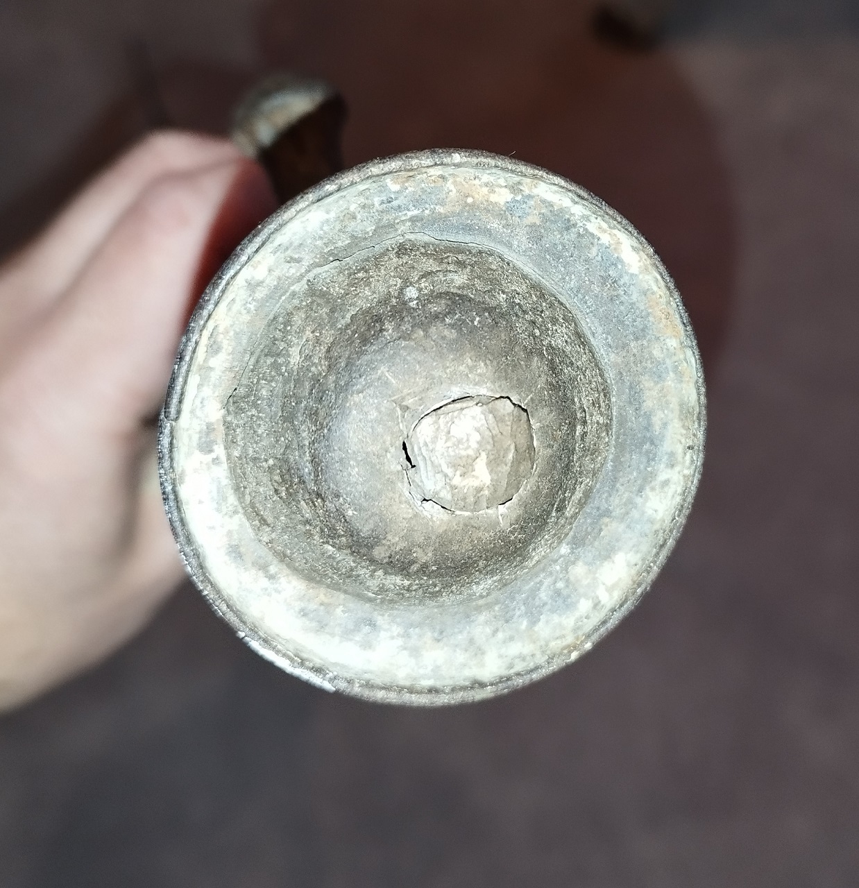

I think the Tulwar was in use for a long time, as the blade is narrowed by sharpening many times. The rivet seems to be maltreated. It seems that the inscription consists of a seperate layer of metal, as in a few regions it is delaminating (s. corresponding last image).
I would love to know more about this weapon, especially the meaning of the inscription and its age as well as geographic origin.

More images of the inscription for completion:

This is one of the most extraordinary tulwars I have seen in a very long time!
I dont recall ever seeing this kind of blade motif, in which there are panels of what recalls the acid etched 'thuluth' inscriptions on North African kaskara in Sudan in late 19th c.
While the panels might contain Islamic characters, they seem applied in the manner of thuluth, in repetitive manner in a decorative sense. The other motif is decorative but perhaps with traditional symbolism within.
This is indeed very old, likely 18th into 19th c. and of the general type of tulwars well known in the Northwest Frontier of India, and into Punjab.
The blade is with what is known as 'the Indian ricasso' (Rawson, 1967) and these were used by Sikhs, Rajputs and Mughals, so it is hard to say which entity might apply here.
The thuluth inscriptions as seen in Africa seem to have been influenced by Mamluk, as well as Sufi metal work, and while Mamluks are not directly associated with India, there is an early tradition there is Delhi regions. Along with this is the Sufi influence which also prevailed in Mughal courts, especially through Jahangir in the 17th c.
These suggestions are purely speculative and only toward possible further input on this intriguing tulwar, which I hope will be forthcoming.

There are 2 interesting features that may be informative:
1. Pin in the center of the quillon block : usually a feature of Afghani or NW Indian sabers.
2. Downturned quillons: traditionally dating the handle to 17th century.
The validity of either of the above is not absolute, but quite suggestive.

As Ariel has well observed those downward angled quillons suggest much earlier hilts, and this example seems almost stylistically aligned with the distinct 'paluoar' of Afghanistan. In the 19th century these regions were regarded as 'India' and as seen in Egerton (1885) these paluoars were included the the tulwar spectrum as far as type.
While in the linked thread some of the examples had what appeared to be machine etched copies of this blade motif, but yours as I noted seems (visually) to resemble acid etched character, and the corrosive activity seems to support that.

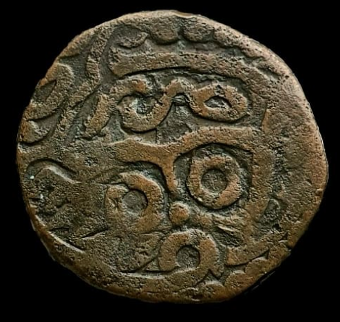

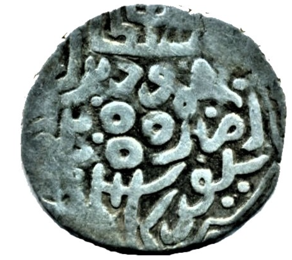

1. Up until 1948 NW India included both current India and Pakistan. Till now, the westernmost Pakistan contains the so-called Pakhtunkhwa district that is populated by the same Pashtuns as Afghanistan. The current border follows the Durand line, and successive Afghani governments tried in vain( and still do) absorb the Pakhtunkhwa district. Thus, Afganistan controls the eastern entry , and Pakistan the western entry into the Khyber Pass. Realistically it was a wise decision from the British point of view since it theoretically prevented any invasion.
2. I fully agree. The decorator used very strong acid and exposed the blade to it for a long time. As a result there was a lot of corrosion and the bottom part of some channels got eaten away laterally, underneath the surface.
3. I am in favor of a "Tamerlane" version rather than of " Indian Trimurti". The inscription is Islamic, and Babur, the conqueror of NW India, claimed his descent from both Chingiz Khan and Tamerlane.
Here are two Tamerlane coins with classic round ring symbols arranged in a triangle. Later Tamerlane descendants proudly kept this tamga .

once I had a Pulwar/Pulowar with a very similar blade and I have seen further blades like this on some other Tulwars. The eched motifs were of poor quality (like in this case) and also the blade itself was not high end.
So I think the blade is an old touristic piece (maybe early 20th c., maybe later) and the handle was added in the regional taste.
All sabers with this etched blade I have seen were of low quality and in my opinion old wall hangers.
