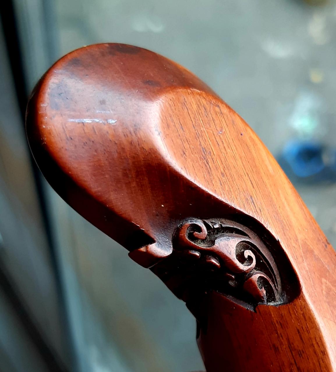

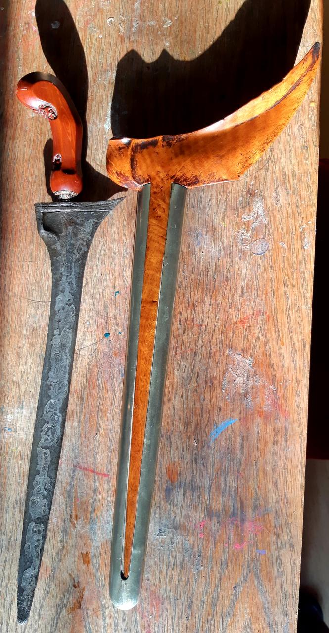

Hi
This keris came.my way. Any thoughts on the pamor and age? The blade rings like a bell when tapped. The dress seems quite good as is the mendak.

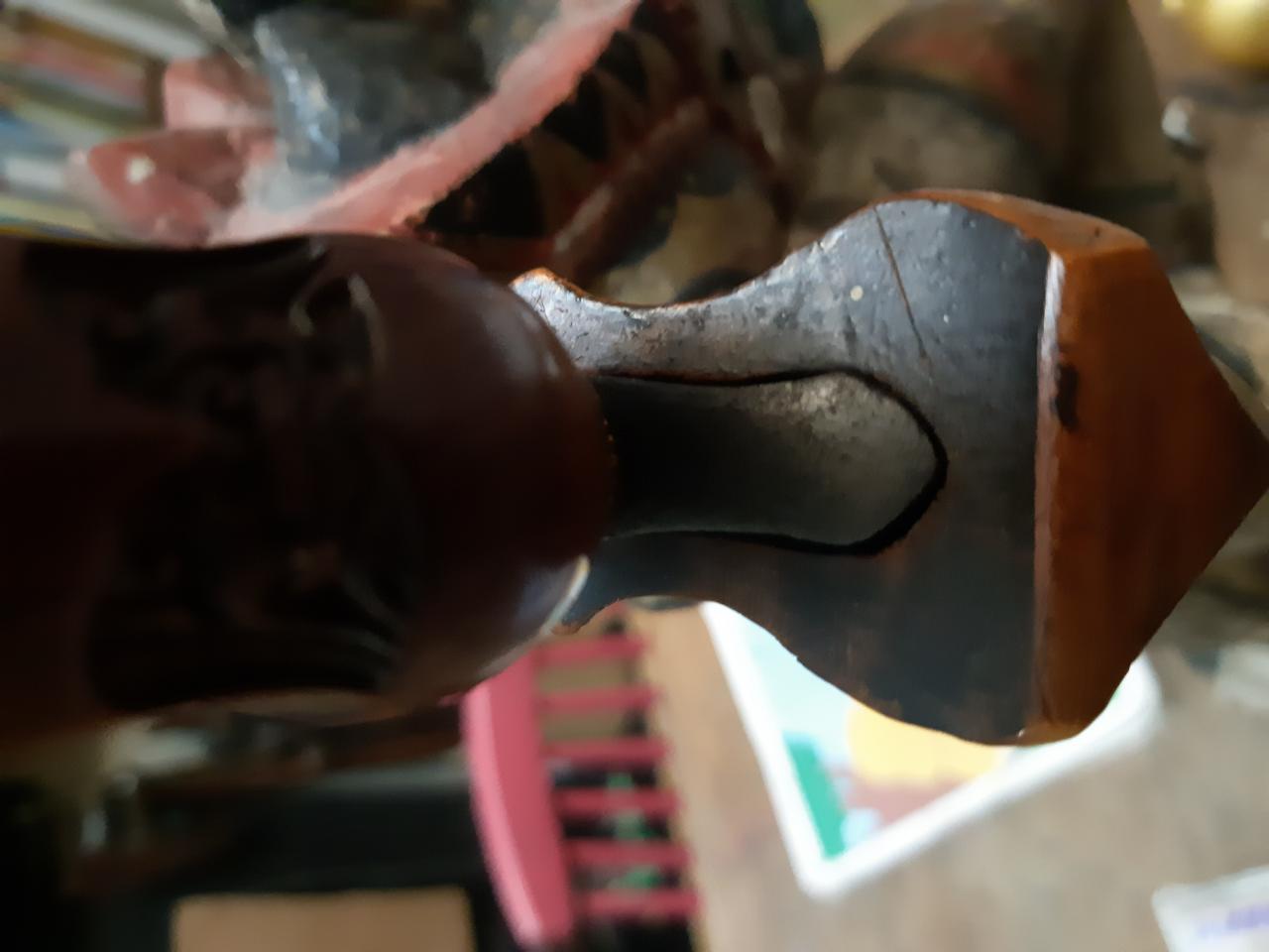

I have not much to say about the blade but the front part of the atasan (top part of the warangka) seems to have been cut so it looks odd.
Old 21st January 2023, 02:23 PM   #3
SidJ
Join Date: Apr 2020
Posts: 244
Yes that part broke off and it has been cut and flattened. It is an old repair and a fairly typical way of dealing with this as I understand it.

While i agree that i have seen breaks "repaired" in this manner before i am not sure that this would be considered to be an appropriate way of dealing with such a problem in cultural usage. I have always understood the ladrang form as "formal dress" and it seems to me that within Javanese society such dress would more typically be replaced for use at formal occasions. I do realize that the owner may not have necessarily had the funds for such a replacement, but question if they would still wear this dress as is. Does anyone know?

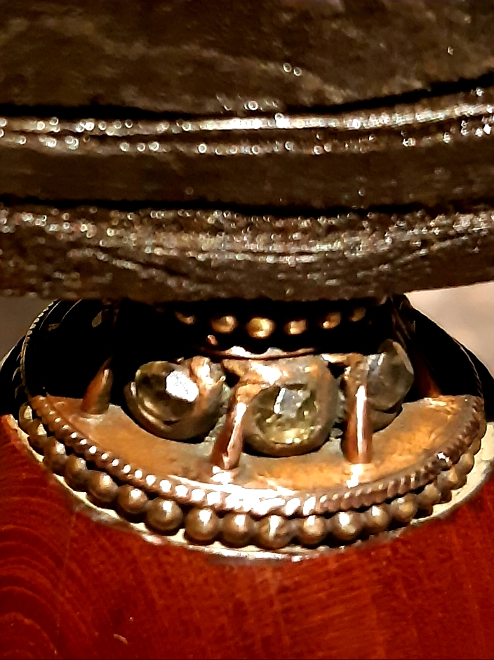

The mendak on this keris is gold with a setting of stones or glass. Does this add anything to the appraisal?

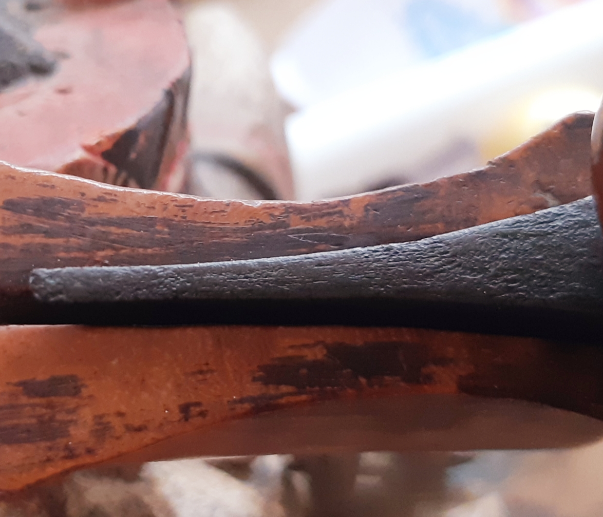

Posts: 244

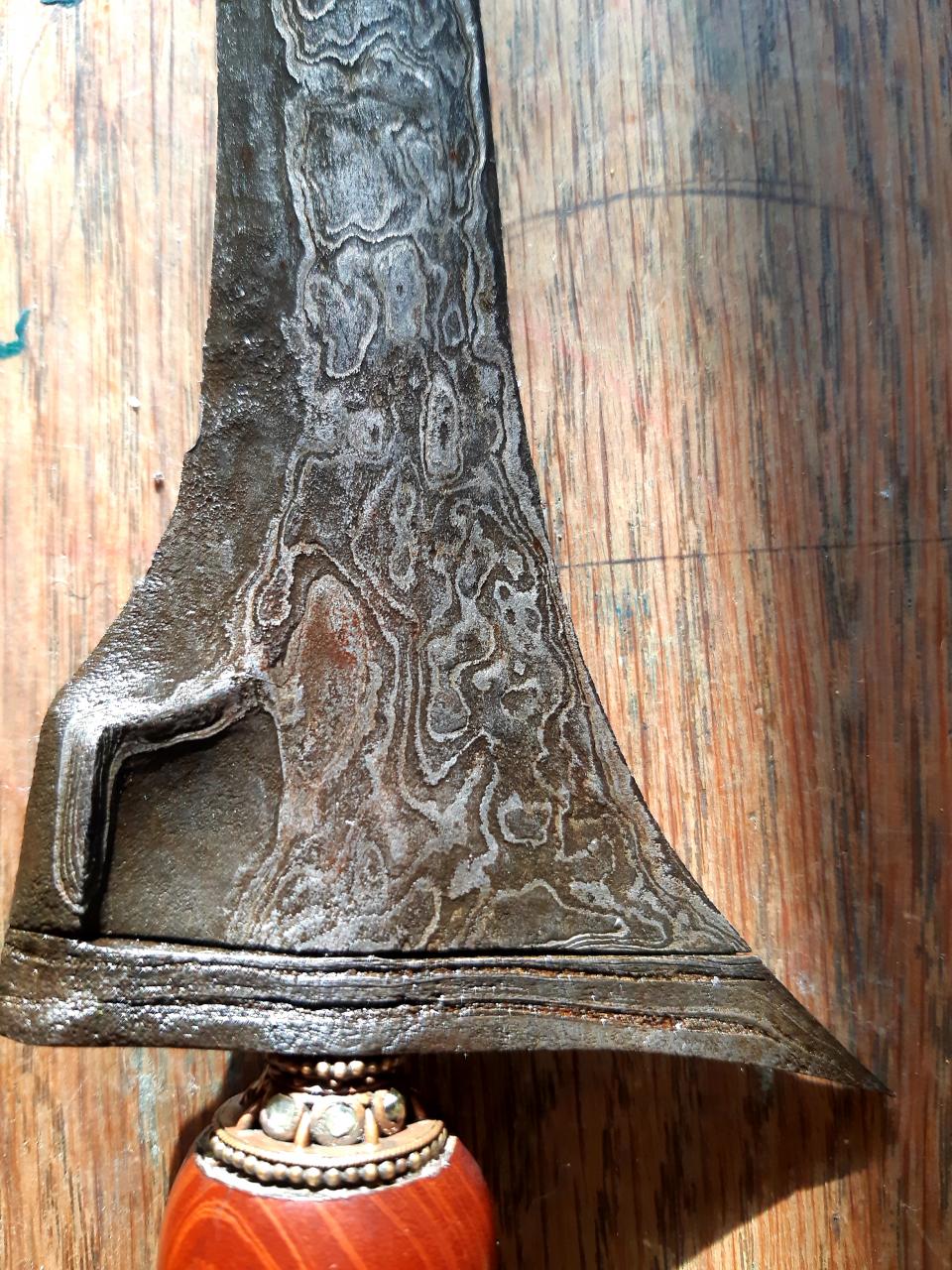

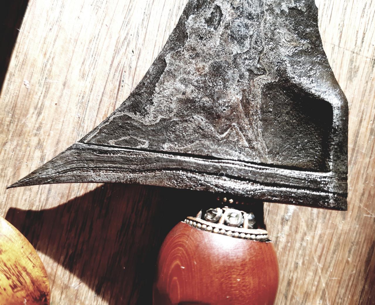

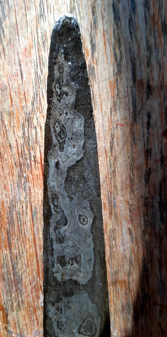

Bottom of ganja
SidJ is offline   Reply With Quote
Old 22nd January 2023, 12:13 AM   #7
Posts: 7,228

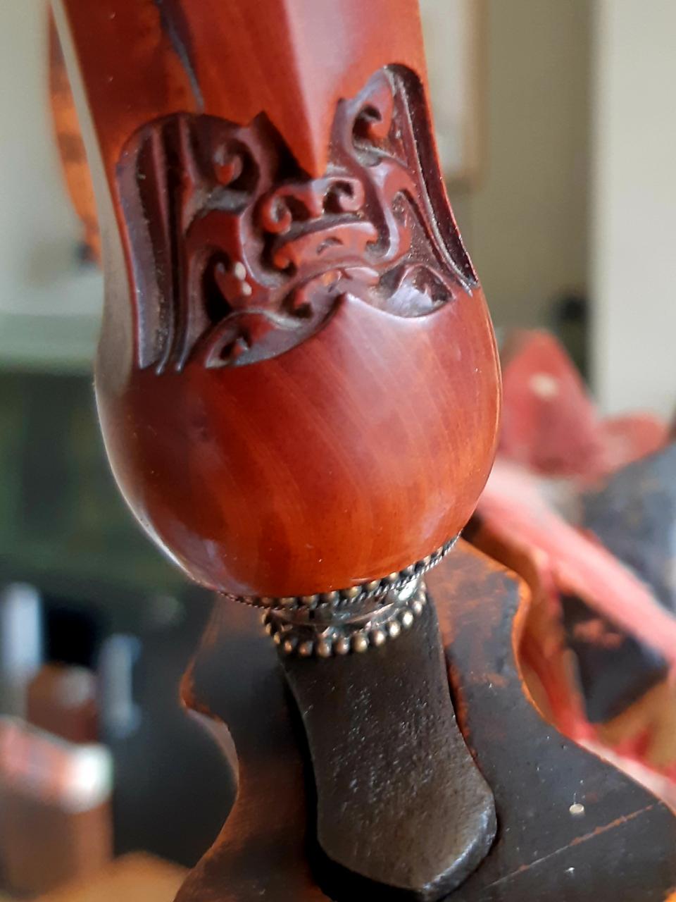

Sid, the sirah cecak (lizard head, front part of gonjo), can be classified as Tuban, if the back part has the right shape it can be confirmed as Tuban, so please, back of gonjo pic.
This is obviously old, it is probably Tuban, very conservative age estimate:- pre-1850.
The loss of the front of the wrongko atasan disqualifies this wrongko from use as a dress keris. The other ways of attending to this break are to adhere a new piece of wood & re-carve, or to reshape the entire wrongko into a "kacir" form.
The mendak looks more like gold over brass, to confirm that it is in fact gold you need to demount it & and test scrapings from the inside of large ring, ie, the ring that contacts the hilt.
Actual gold mendaks are very scarce, they are normally set with true precious stones, usually diamonds or rubies, but not of high quality, they are normally of very fine workmanship.

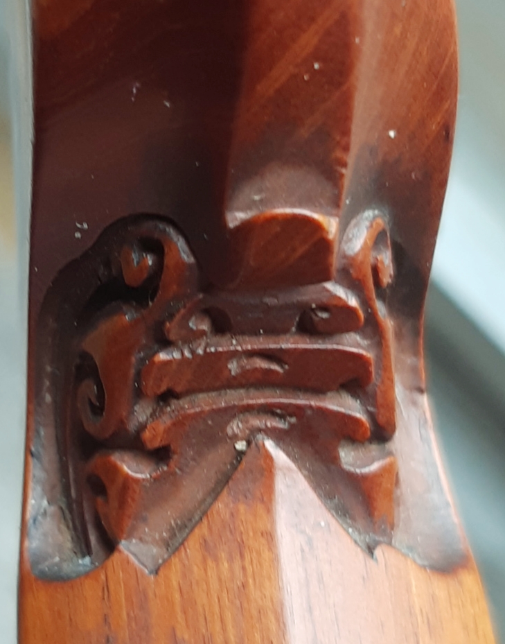

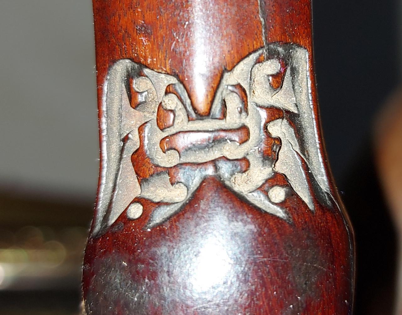

Hi Sid.

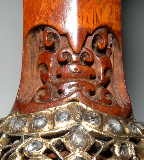

I am not a Javanese keris hilt connoisseur or specialist, but I must say, the hilt looks quite nice. Probably you can share the straight on photo of the cecakan (the stylised face carving) too?
Usually good handles will have a dudukan i.e the recessed base of the hilt for the mendak but this one does not have it. (Good Solo handles most of the time will have a recessed base, but not all hilt with recessed base are good handles - this is my impression at the current time) Probably somebody flatten it off to fit in a different mendak.
In fact, the entire setup of this keris is quite good if part of the warangka was not broken off. Somebody probably loved this keris very much at some point of its existence.

Ganja pic No 2.

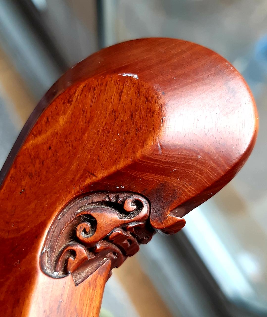

Default Further hilt pics
Further pics.

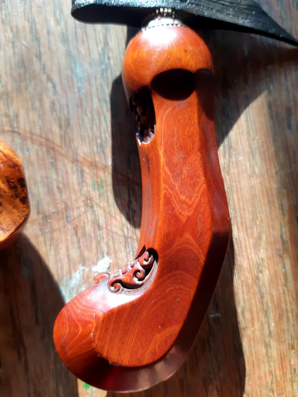

Further pictures attached

Thanks Sid. It is a very nice hilt IMHO. If the carvings are symmetric, this is not not something we encounter too often. Most hilts are village quality. I think this one is not.

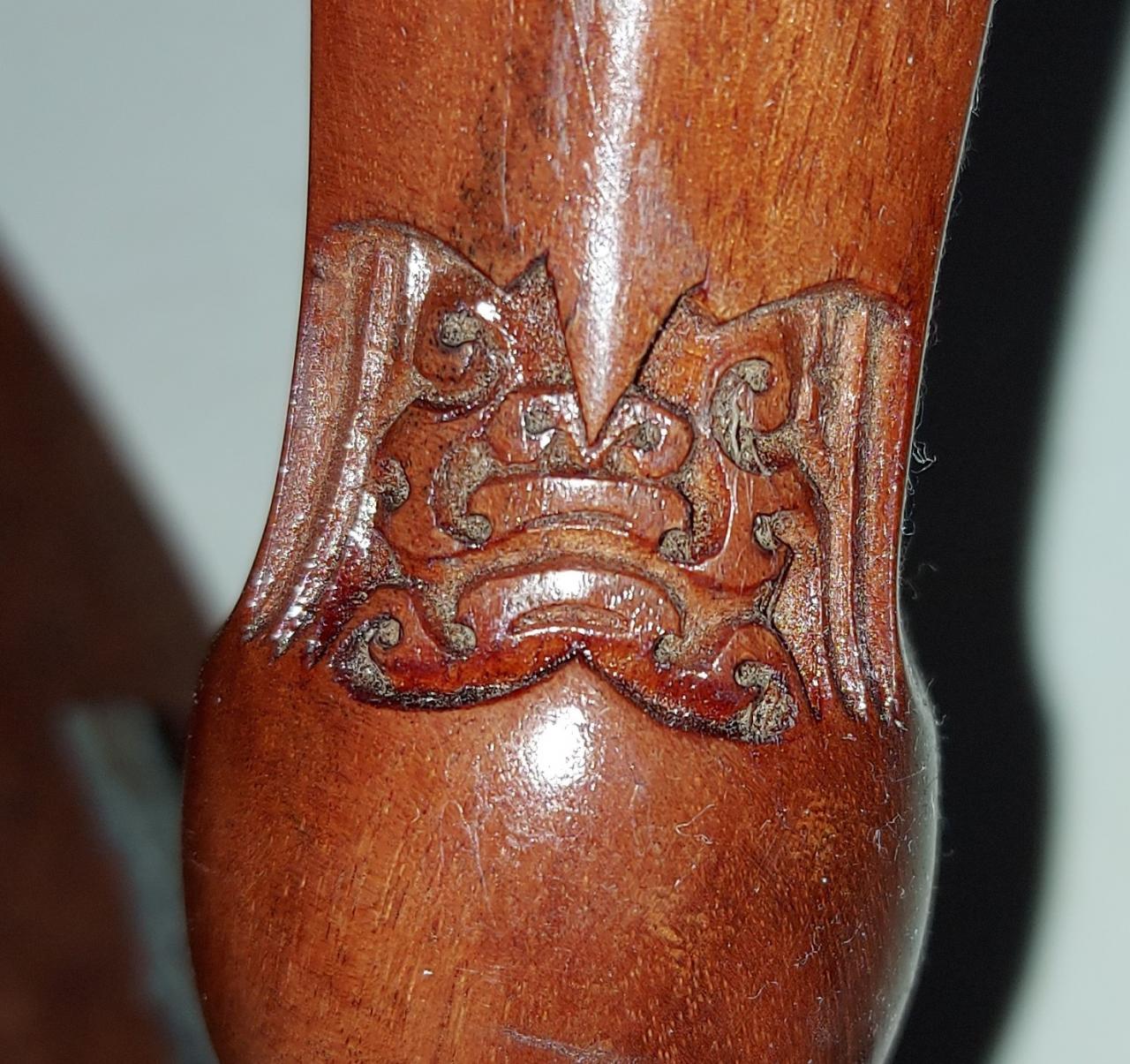

Hi Rasdan
Thanks. Ive had a look at some other keris I have and they all have similar symmetrical faces on the hilts. I dont know what to make of this.

Hi Sid, It depends on the level of symmetry, the flow of the curves and the cleanliness of the carving. The photo you provide does not give that view, but I think it is nice enough to be above average.
Now I don't know what real high level kraton carving should like, this is my impression what is nice. Below are 3 cecekan. 1 is new, common and OK and one is village quality, the one with selut is a nicer one - to my eyes. Of course we need to see the hilt as a whole too, but this is just regarding the cecekan carving.

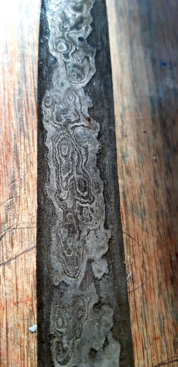

Posts: 7,228
Sid, I think I'd go with a Tuban-Mataram classification, ie, tangguh.
The overall form fits, the pamor fits, the gonjo sort of fits.
When we classify with blades that are not really intended to be classified, it always becomes an opinion based on the balance of indicators, in this case, I think Tuban-Mataram fits pretty OK.
