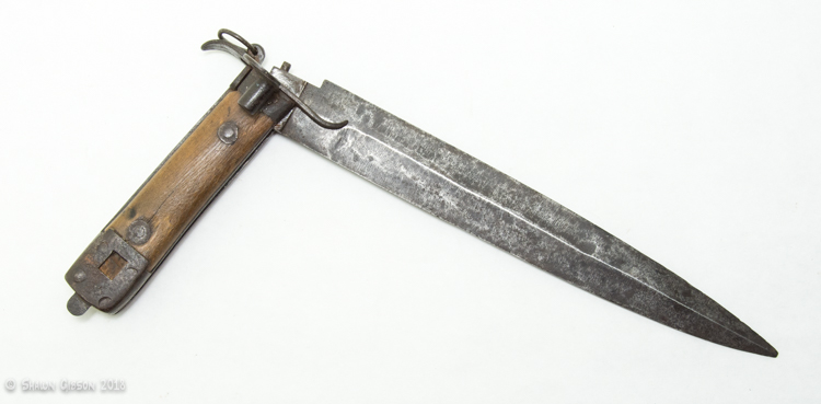

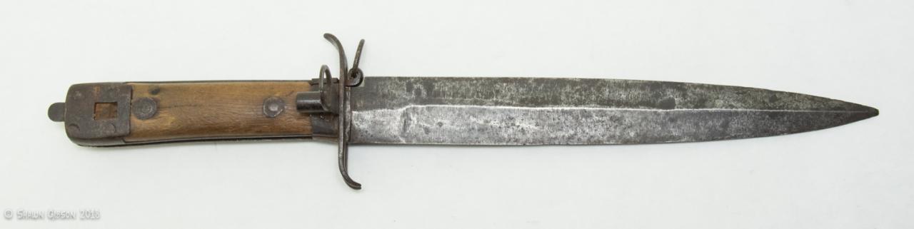

I didn't want to clutter up Fernando's thread on Navalhas. So started another thread for this. Can anyone tell the country of origin for this folding knife? Is it a Navaja, Navalhas, or perhaps from Italy? It has the ring for assistance in releasing the lock, but not ratchet. Oddly, it seems to be made or modified to fit to a hunting rifle as a bayonet.

What a rather interesting piece, Shawn; one i would like to own for sure .
Could it be that this is not a 'one of many' unit but the 'one and only' creation of some ingenious author for personal use ?

The knife appears to have been made with the muzzle ring and plug.
You cannot fire the firearm with it attached unless you want a burst barrel.
I suppose many years ago you did not wish to expend more ammunition than necessary on your downed prey so just give him a good jab to finish him off..

I am not sure it works that way; if the ring is to encircle the muzzle, there is no way that cylindrical device may work as a plug. Am i correct ? .
Yes I'm wrong on that, I was thinking of a particular rifle in the back of my mind.

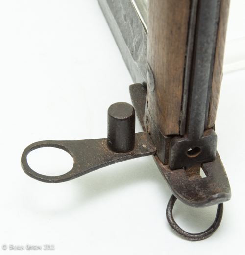

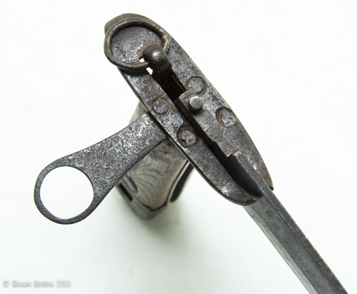

I'm sure it is a one off hunting piece. Certainly not military. I was hoping the characteristics of the folding knife might point to the country of origin.
The plug might be designed to fit into the ramrod channel, helping to stablize the muzzle end. The pommel has a catch for a lug to fasten the bayonet.

Exactly what i was coming at... to be honest. For the folding catch, it could be that it doesn't define the origin of the knife but that the inventor was inspired by seeing these systems out there. Note that he only went for a locking round pin; no ratchets nor single grooves.

My mention of Italy was not because Italy made some folding bayonets many years later. Several countries experimented with folding bayonets. But the similarity to some Italian folding knives. This bayonet has much more in common with the various cultural folding knives than any military bayonet.

It is an interesting and apparently well item from the photographs. That said I am curious about a few things concerning this piece.
1)I find the round pin odd. Why not a deep, square cut notch like on many navajas? To me they seem stronger than the narrower round shape. Is the round pin an integral piece forged and shaped with the blade and then rounded or, I believe, more likely a pin that was soldered into a drilled hole?
2) No one has commented that this bayonet mounts with the axis of the blade 90° different than most modern bayonets. attaching to the barrel through a side ring not the proximal quillon.
3) Concerning the other examples shown what is the advantage of a folding bayonet for a military weapon? To my understanding this style of knife originated as a way to skirt regulations on the possession and carry of weapons. A military naturally isn't confined by there. Yes, it would take up less space on the belt, but the tradeoff is a slower drawing weapon that has a natural tendency to fold on the hand using it, or at the end of the barrel just when you really do not have time to fiddle with a gunked up locking mechanism. These are long blades that theoretically have large amounts of leverage placed on them (I have seen a lock fail on a friend's knife with only a 3-4" blade, and it wasn't pretty). Even for a civilian weapon a folding mechanism seems dodgy for dispatching large game such as boar if you have a better legal option.
Old 11th January 2023, 01:41 PM   #17

2) No one has commented that this bayonet mounts with the axis of the blade 90° different than most modern bayonets. attaching to the barrel through a side ring not the proximal quillon...
The way fits on the firearm, to the right of the barrel or underneath would depend on where the bayonet lug for the pommel was mounted. It could fit either underneath or to the right. However, I believe the round stud on the muzzle ring is designed to go into the ramrod channel. If so, that would make it fit underneath the barrel.
Both fittings are quite common. Generally, bayonets fit to the side until the era of breech loading and then began to shift to underneath.
If you were meaning the position of the blade to the barrel being horizontal or vertical? Both are common until the modern era.
