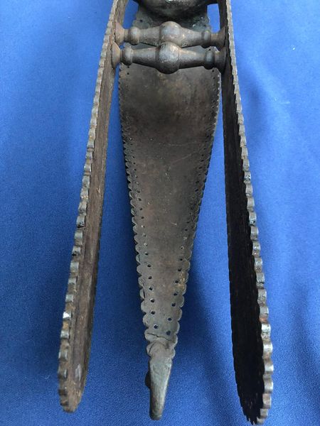

I would like to publish my last purchase here in the forum for discussion. i hope that the collectors of indian weapons will write me their opinion and that there will be a good discussion about it. for me it is interesting to know what you think about the age of this piece, what you think about the state of preservation. he was given to me as a katar from 18.19.th.ct. offered and sold. i remembered seeing a katar like this before looking at the photos the seller had sent me... so i looked in my library for a comparative piece and i also found it in the 1998 figiel auction catalogue. at first i thought it would be exactly this Katar because they were very similar in shape, appearance and size, you have to look more closely to see the small differences. there he is definitely described as a Katar from the 17th-18th centuries.

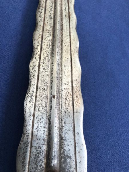

That's why I had relied on the information provided by the seller. this Katar is 80 cm. long with a very heavy and powerful blade of 50 cm. length and 8 cm width in front of the handle.
the weight is almost 2000gr. very high. actually much too heavy for the fight!
the pictures i received before the sale looked very good in any case, it was shown in quite acceptable condition, that's why i finally bought it. I would first like to hear the opinions of our forum members who are familiar with Indian weapons before I post any more pictures of this Katar.

Hi Dralin. To me I would have to agree with the first attribution you were provided. This katar looks like it is maybe a late 18th or early 19th century reproduction of the famous "hooded katar" that hails from south india, most famously used by the vijayanagar empire. Because it lacks much of the intricate decoration found on actual hooded katar, I would guess it was made somewhere in north india instead of in the south. The beaded edges on your katar, to my eyes, look very similar to the way beading was done on late 18th/early 19th century rajput hilts. The fact that the langets also end in an abstract, idiosyncratic, palmette-esque design cements the idea to me that this katar is a unique one-off piece, probably made by someone unfamiliar with traditional southern styles, instead of being created in any of the numerous regional production centers in the south.

Thanks for your consideration, yes I would agree with that too. it differs significantly from the early forms from south india. there were many fine details to be found on these katars, such as the makara heads on the grip ends. these suggested strings of pearls on the edge of the handle were actually a sign of katars or swords from the decan. as far as I know.
I definitely can't imagine what this katar was made for at all, with this heavy weight I think it's absolutely unsuitable for every fight.. although in the jaipur collection or is it in udaipur( I'm not sure where I had seen it) there is a personal fighting sword of a rajas and it has the proud weight of 3.5 kg.... it must have been a very strong man.....
