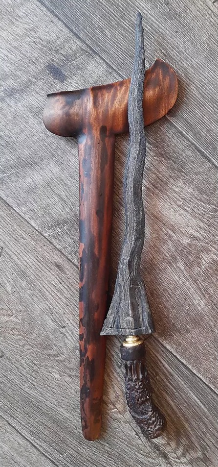

Hello all, I recently acquired this keris but I can't find what dapur it is. Any ideas?

Posts: 7,229
If it did not have luk, what might it be?
Without luk, I'd say dhapur brojol.

Gandhik?

Gandhik?
Hm yeah I didn't pay enough attention to this.
Looking at it again, I am not sure if you are prompting the question because an opinion of "brojol" doesn't hold water based on something to do with the gandhik of this keris such as
  • its gandhik is long
  • there is no gandhik
I'm leaning towards the former due to the differences in angles marked with red, and the gandhik marked with yellow.
If I'm to refer to the Keraton Surakarta pakem as published by Yayasan Damartaji, I don't know what dhapur this keris would be if it didn't have luk. If this keris can be said to have no gandhik then intuitively and perhaps wrongly I would say dhapur sepang.

Any keris with a longish gandhik has either "kebo" or "mahisa" (maesa) as a part of the name, both words (there are spelling variations) mean "kerbau", "water buffalo", just different language levels.
Have a look at drawing #4 in the pakem.
Incidentally, although this book is probably the best guide we have, there is not universal agreement on everything between its covers.

Thanks Alan, I see now.
So if I'm following correctly, it seems that we can use the kebo or mahesa description for this keris. But it isn't strictly dhapur kebo lajer because it has luk.
Would this mean that this keris is "diluar pakem"* and doesn't have a dhapur designation, if we're going by the Surakarta dhapur manuscript?
*Diluar means "outside of".
I'm unsure of how to translate pakem as its Javanese, but the usage in this context would say that a pakem is something that is used as a source or reference - akin to a rulebook or a style guide.

This blade would certainly work as kebo lajer luk 7.
If I remember the gist of an earlier thread correctly, luk could be added to some (even all?) straight dhapur and designated a s such. (If adding luk does not change the blades into another, more specific designation, I assume.)
Some of the dhapur with luk may have different numbers of luk. If I recall correctly, some may be open to non-standard numbers, too. I haven't been able to fathom though when this might be considered legit and when not...

Thanks everyone for your input. Another relation of my suggested that it could be dapur sempanah kalentang with an extremely long gandik.
All versions of what people are calling Sempana Kalentang seem to have BOTH kembang kacang and greneng, so i don't think this keris can qualify for that dhapur. It is a kebo with luk 7.
