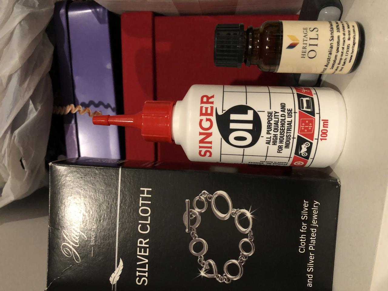

Hi Ganapati,
I've used these two oils: Singer oil and Western Australia Sandalwood (Santalum Spicatum 100% pure). So far it is still reasonable since my collection is small (less than 10) and I've only used 10-12 drops to be mixed with the Singer oil.
Best Regards,
YS
