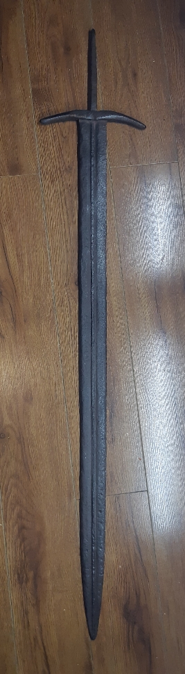

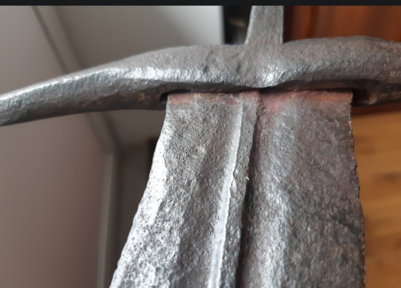

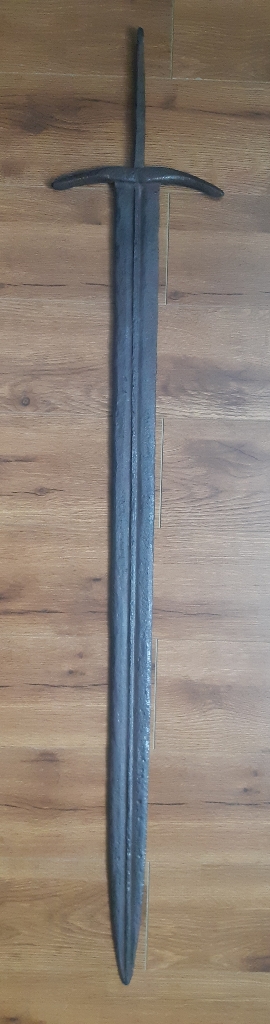

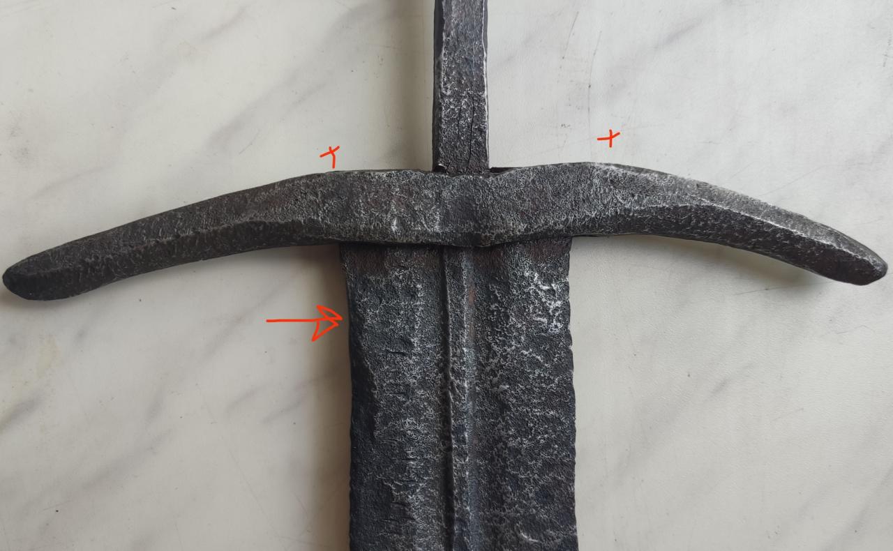

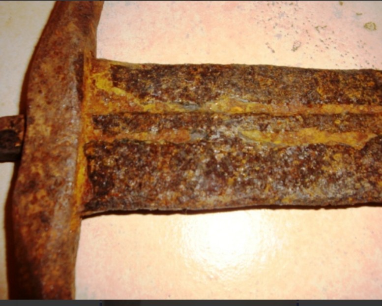

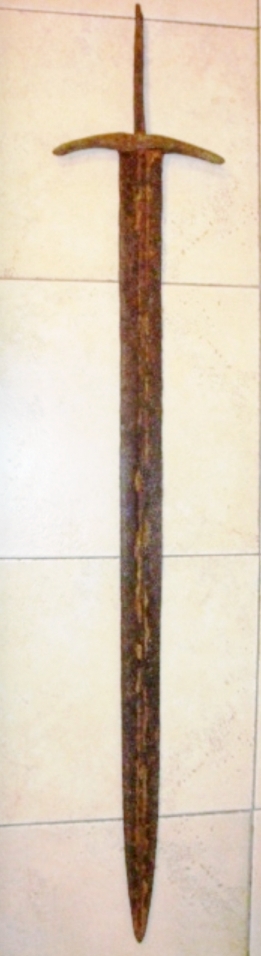

good afternoon, please help in attributing the sword, length 107 cm width at the guard 5.3 cm. guard 19 cm, shank 1.0 / 1.3 cm. here are old photos that I wanted to show.
grateful for your opinions,
sorry for my google english
with respect .

Can you please post better quality photos?
Also some details of the tip would be nice.

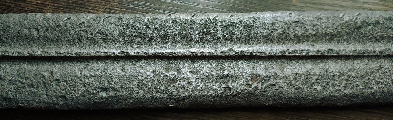

Thank you for your interest,
of course, at the beginning of the topic there are old photos, almost 20 years have passed since that time,
I just wanted to show the first photos, the subject is almost cleared, now I will post a series of photos in different lighting,.
I got a few unusual items for my region that I want to show here,
Look here please .

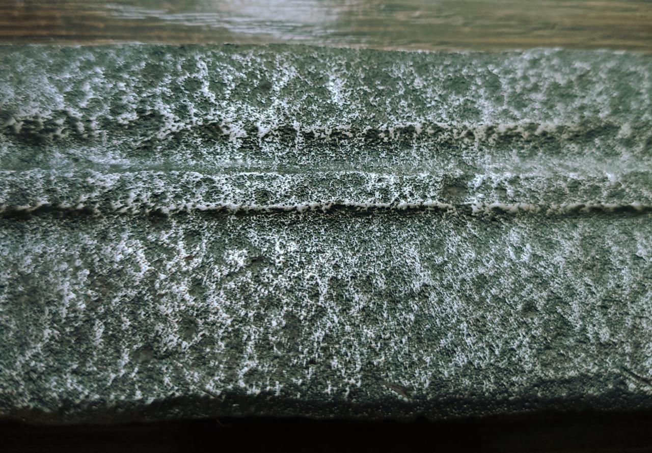

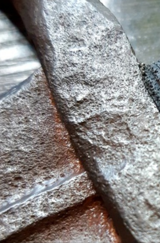

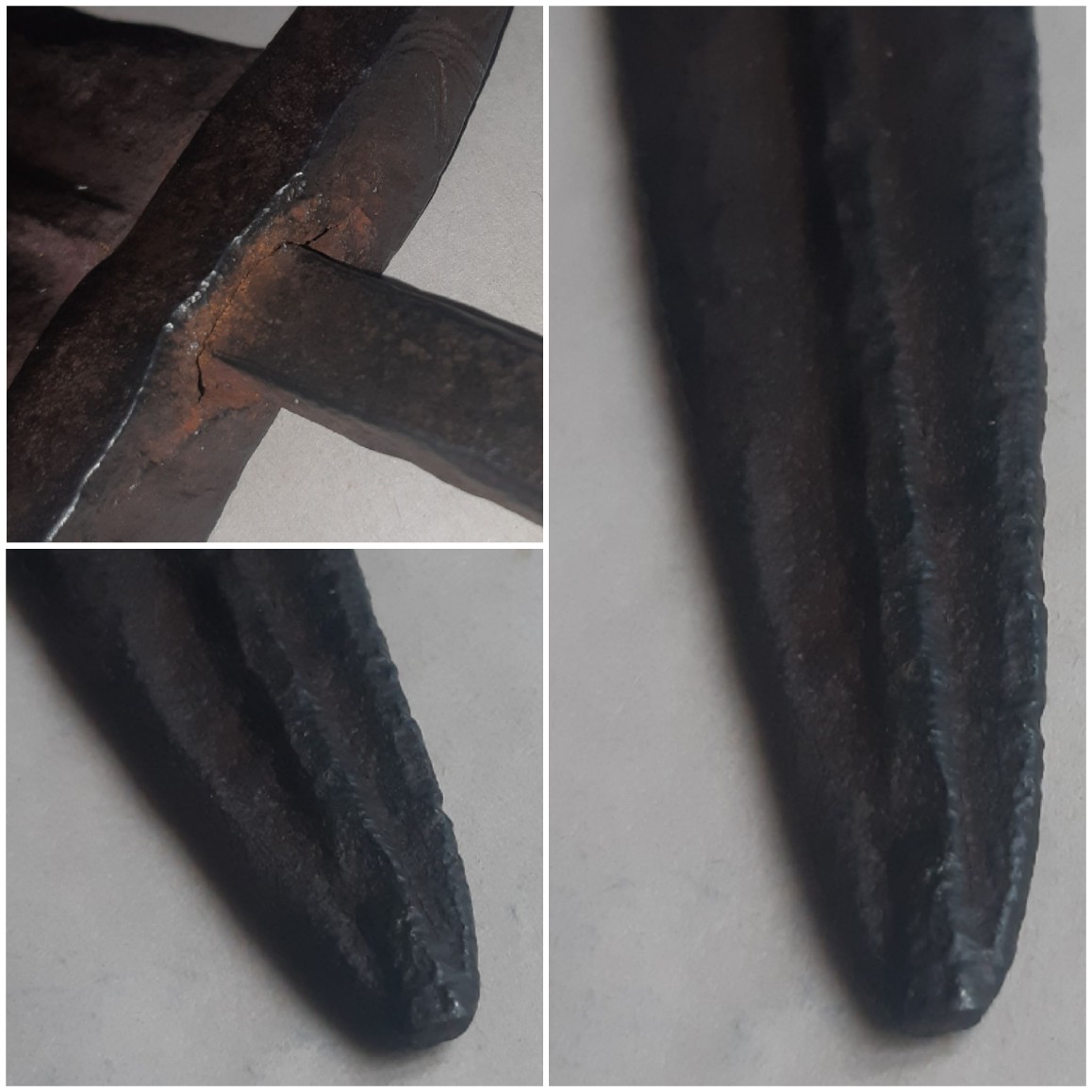

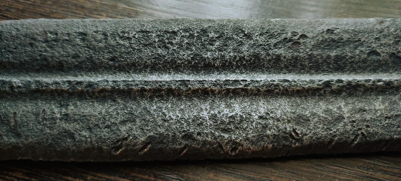

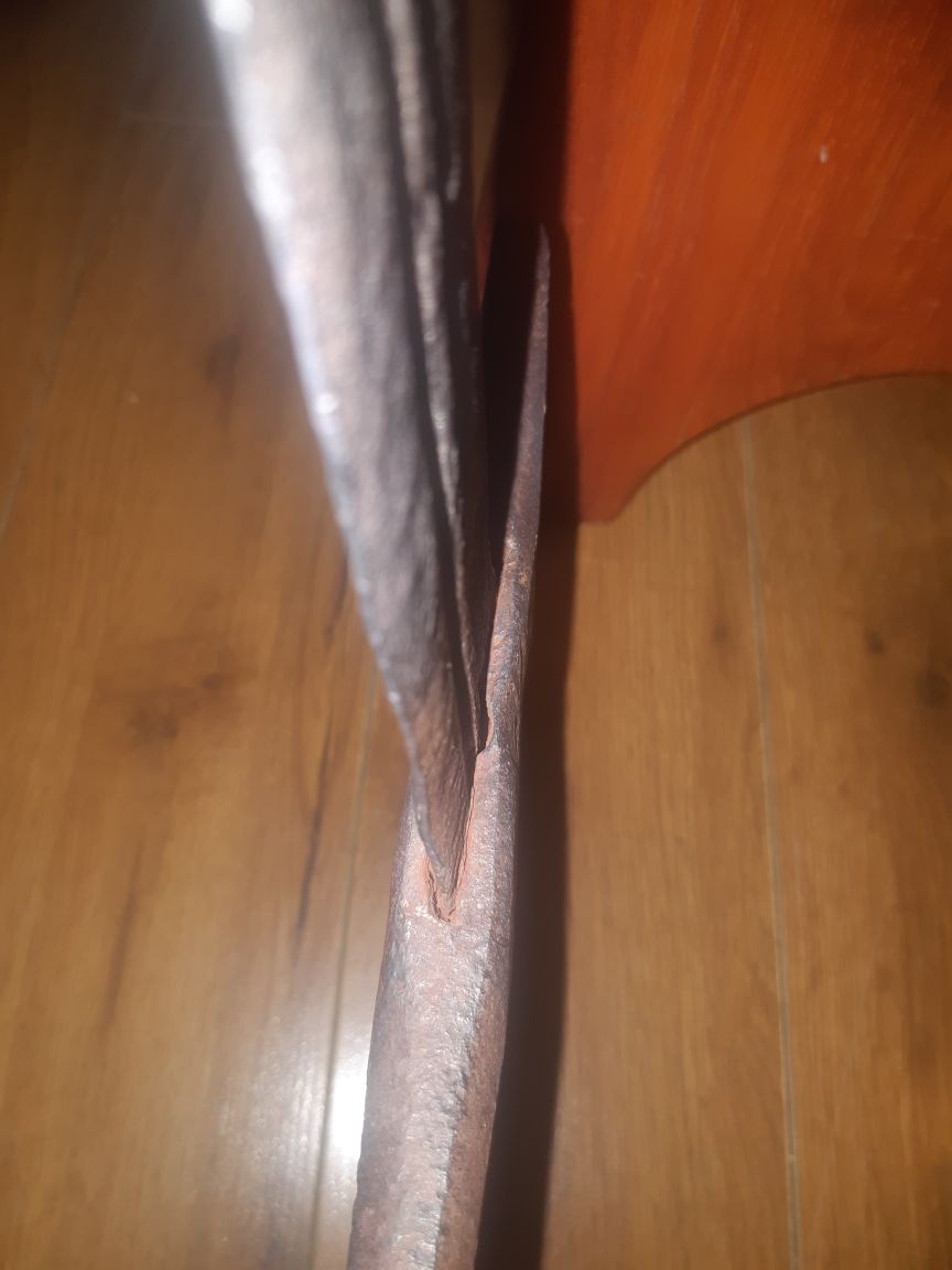

some more details

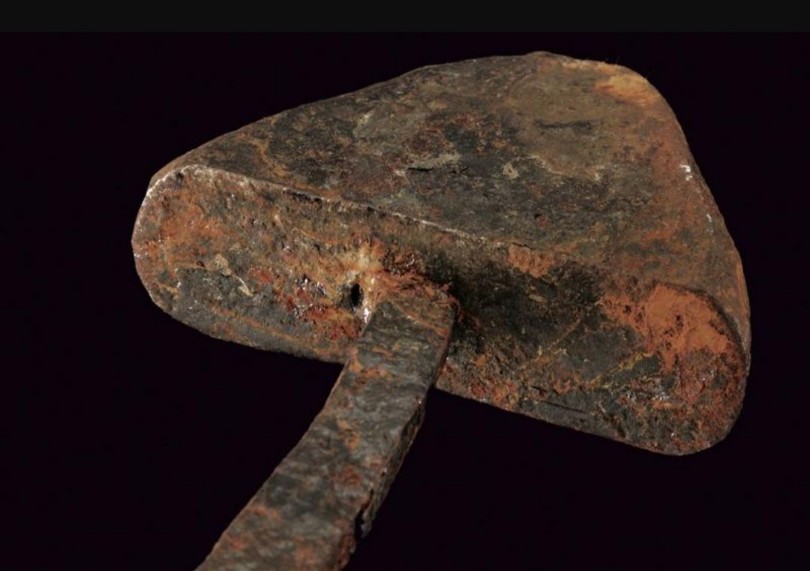

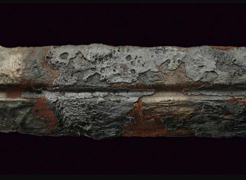

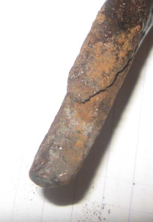

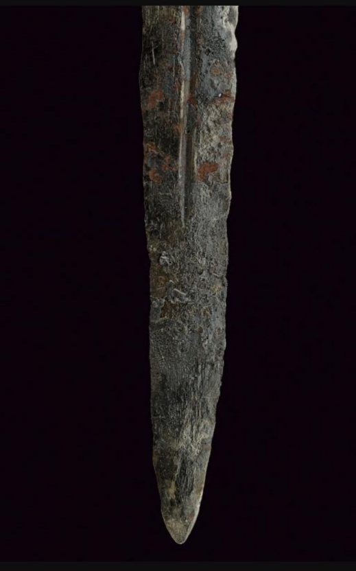

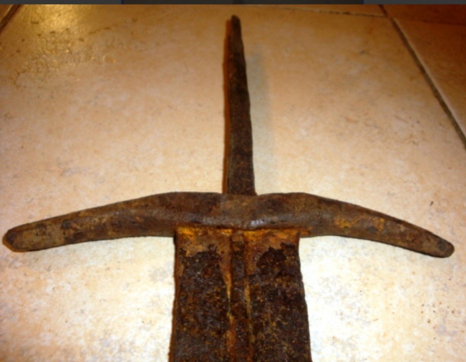

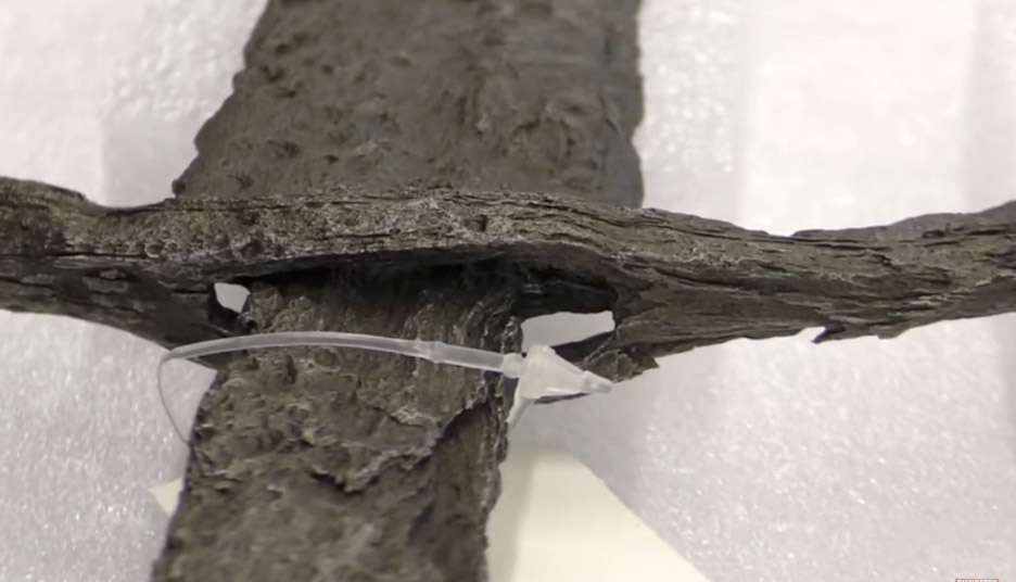

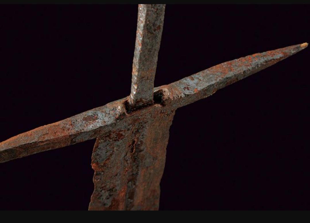

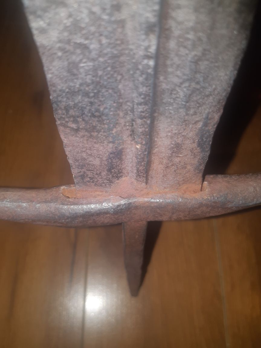

This is what one might expect to see on a 13/14 century sword in excavated condition. Note the way the corrosion has etched the steel revealing the pattern of the origional forging caused by impurities in the steel and resulting delamination. Also the characteristic poor fit of the cross guard. I dont see this in this example

Good afternoon, good example, thanks.
earlier I myself had to clean it from rust and it is equally difficult for me to recognize it as not real, as it is to be completely sure that it is ancient, so I am grateful for any opinions.

There are more issues wrong with this sword, beginning with the initial corrosion...
So I would say it may be a 19tc century historicism piece but I am more inclined to say that it is a modern fake artificially aged.
I agree. The OP's sword looks like a fake made to look like a relic. There's a lot of that coming from the Eastern Europe these days. I wonder where he acquired the sword.

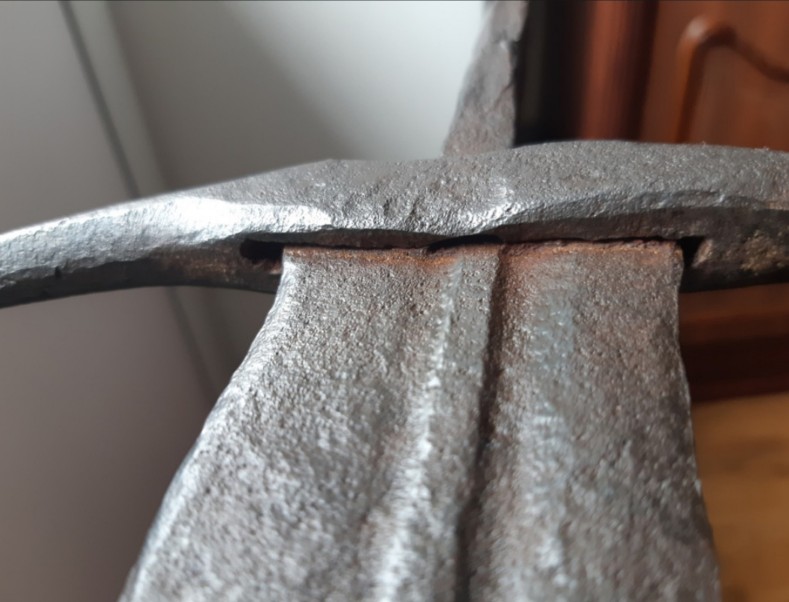

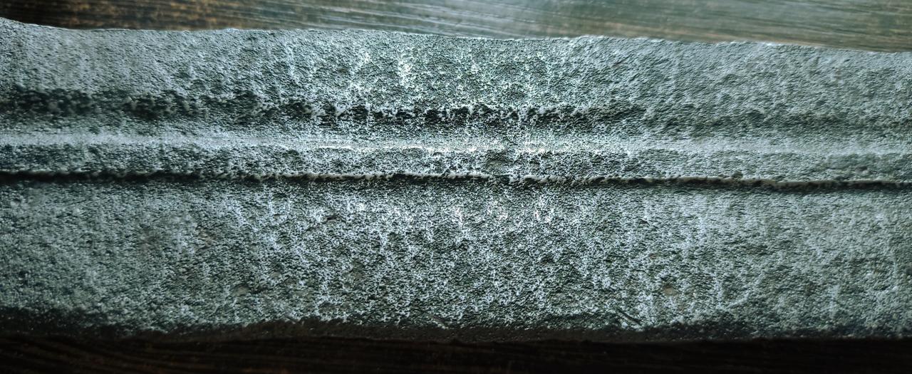

however, there is something that makes you want to figure it out to the end,
At first ; the rust on it was a real, thick, strong crust, as in the first photos, and it was removed on its own.
Secondly; the blades on both sides are clogged, dull, but inside the cross-pieces they remain (seen in the photo).
third; I had previously thought that it was shortened, the longitudinal rib could not initially reach the tip.
fourthly; it is not completely cleaned, it must probably be soaked, different things can be seen at different angles of illumination, but they are partially still under a layer of unfinished substance,.
,,, But in general, yes, it does not look right, I agree.

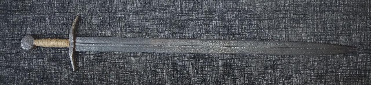

You have posted four swords all of which look like ground finds. It would be good if you could say something about the context in which they were discovered.

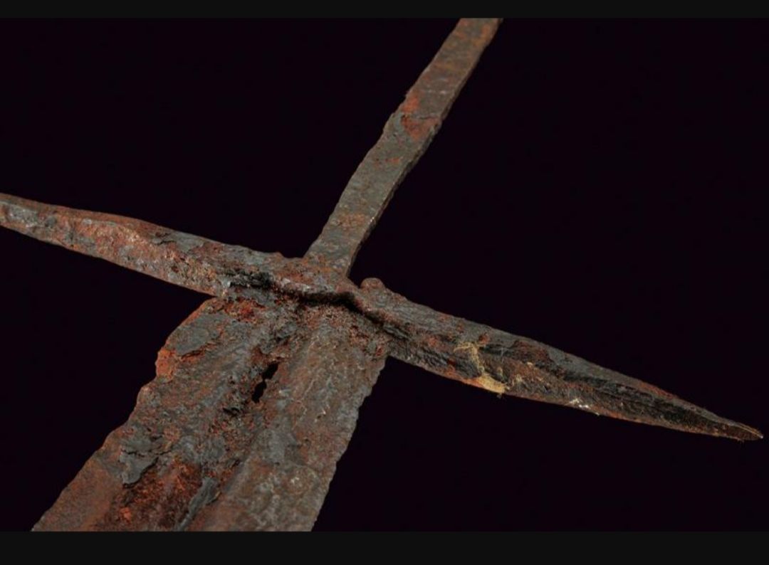

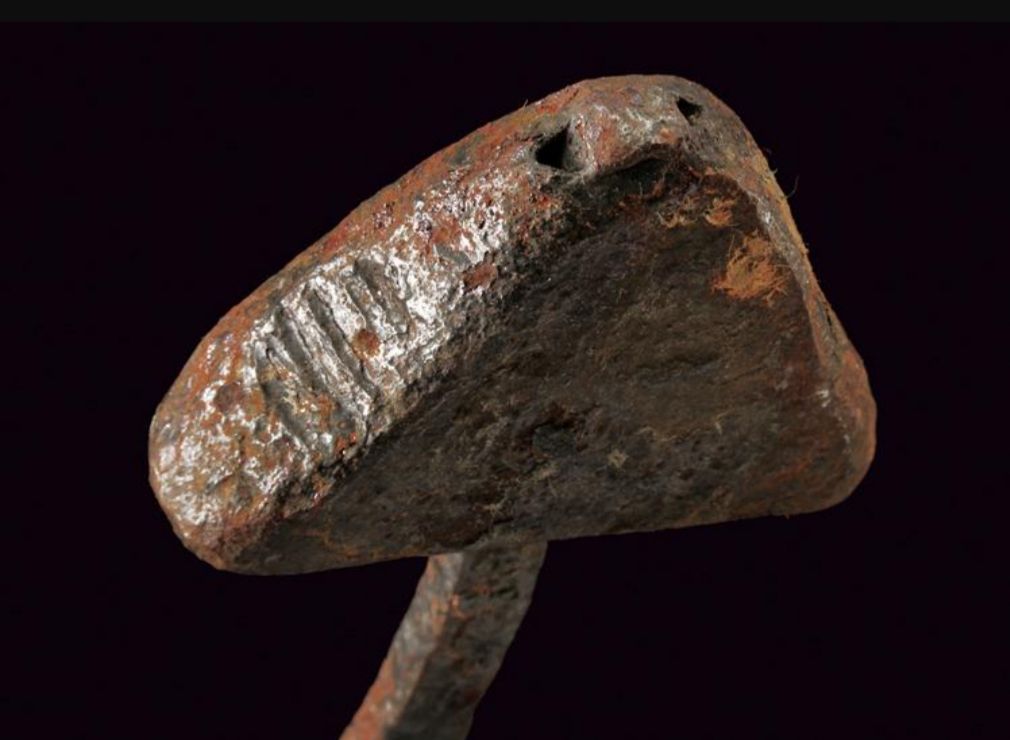

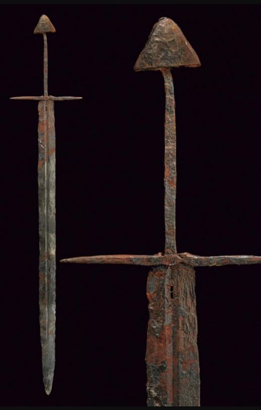

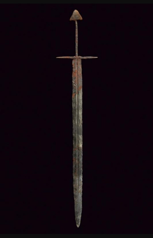

In addition, from today's time such a thing may look rough and absurdly "barbaric" even, but only in comparison with exquisitely beautiful counterparts from developed centers.
But take a closer look at this (not ordinary / not correct at first glance) Scandinavian sword of the 13th century.
photo taken from the site
CZERNY'S INTERNATIONAL AUKTION HOUSE S.r. 1.
(in the context of the post).
with respect

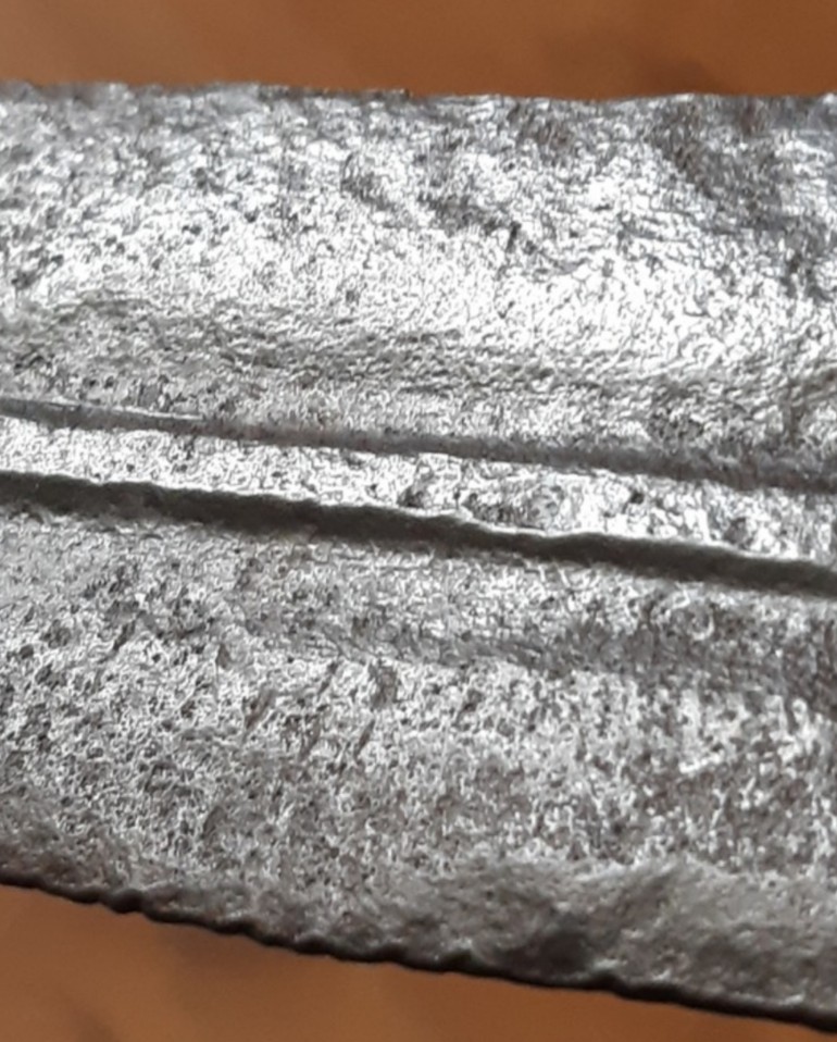

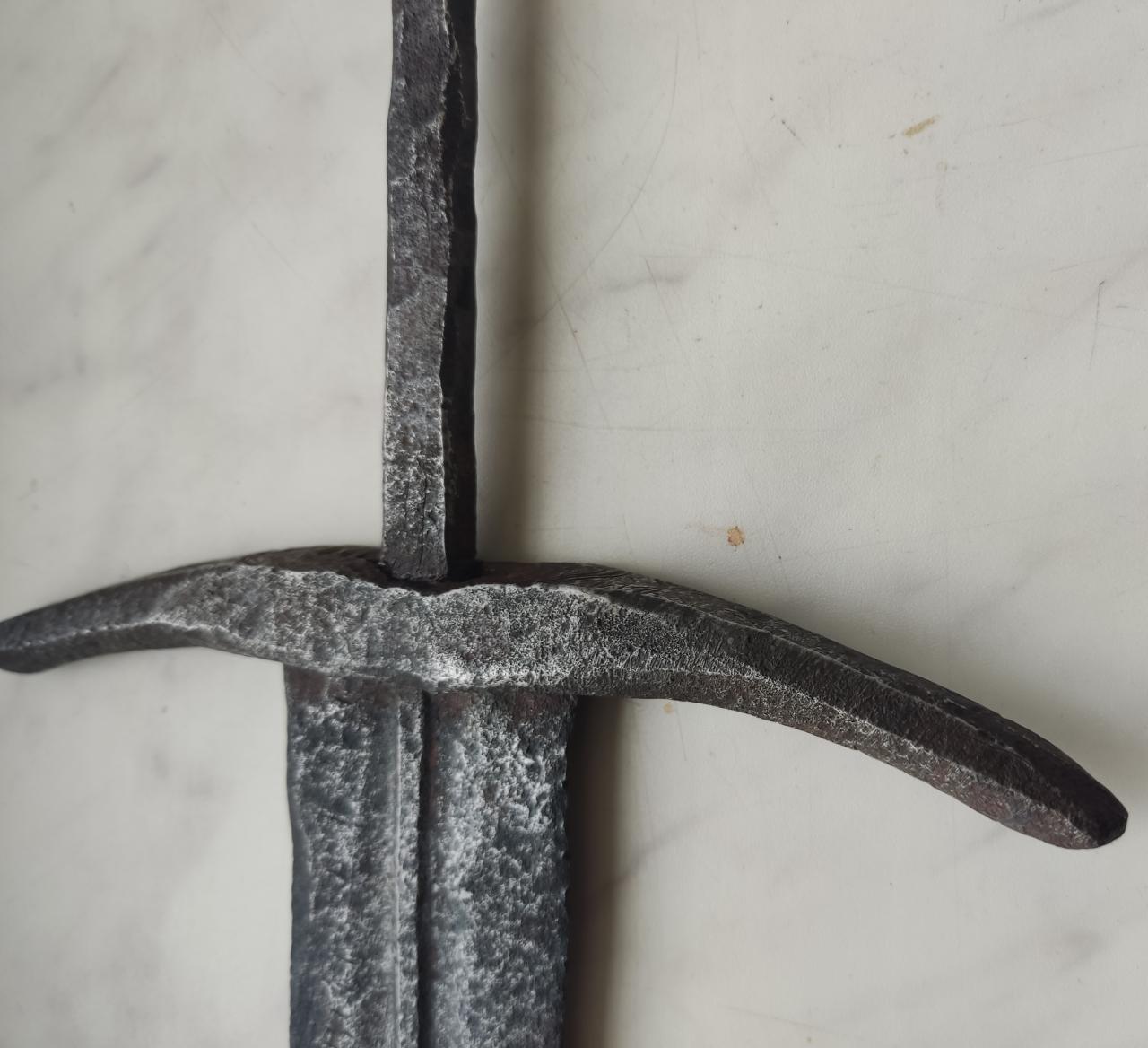

I want to share in the continuation of this topic, the result of what eventually turned out after clearing, the surface has rather deep traces of damage and therefore it is rather difficult to choose the right angle of illumination, but in my opinion if you look closely you can see the remains of old letters, there are four such places,
Elmereya is offline   Reply With Quote
Old 21st July 2022, 07:08 PM   #20
Elmereya
Elmereya's Avatar
Join Date: Mar 2021
Posts: 70

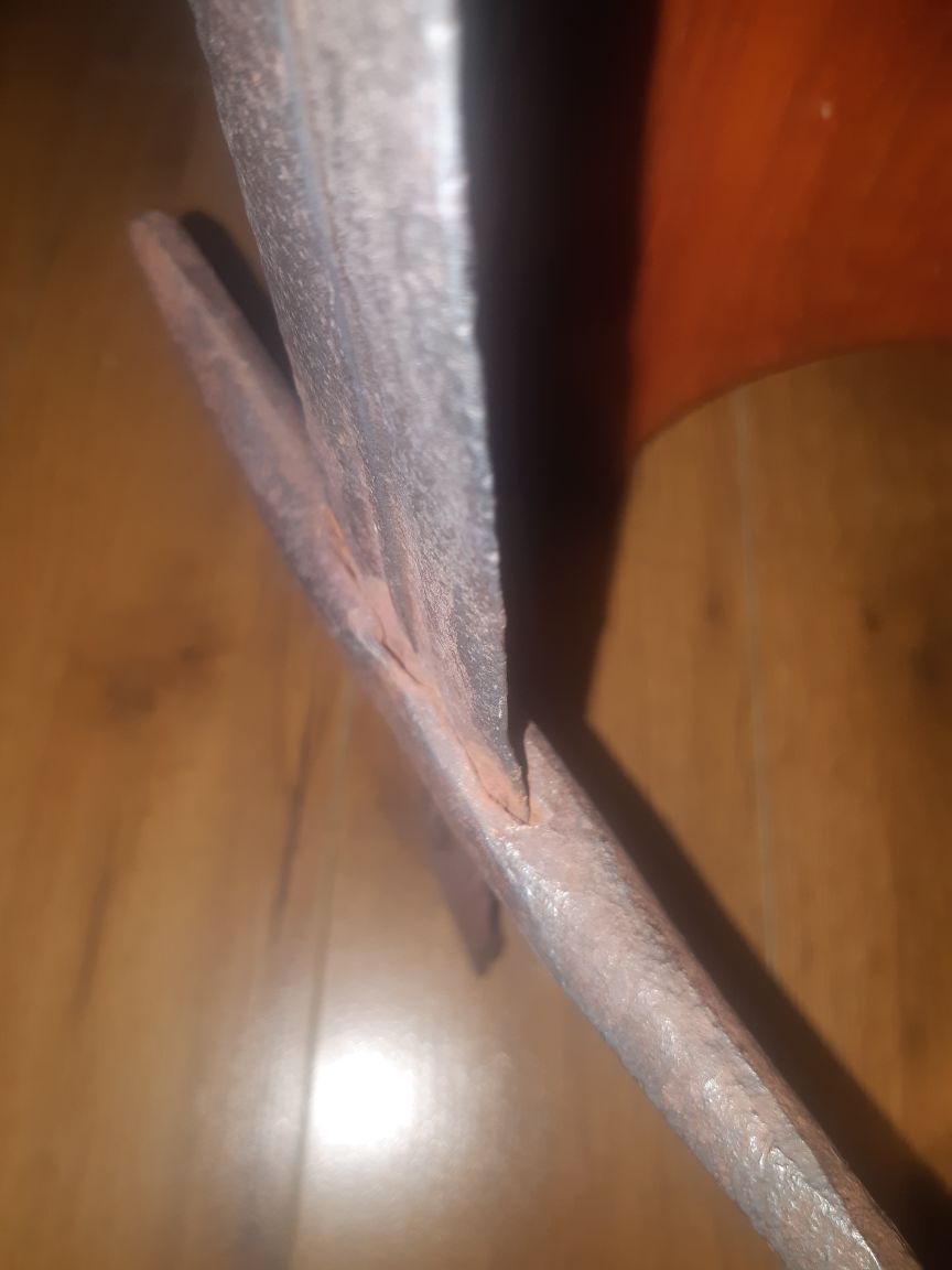

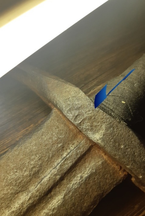

the remnants of a long inscription are visible, the central part of which is specially damaged.

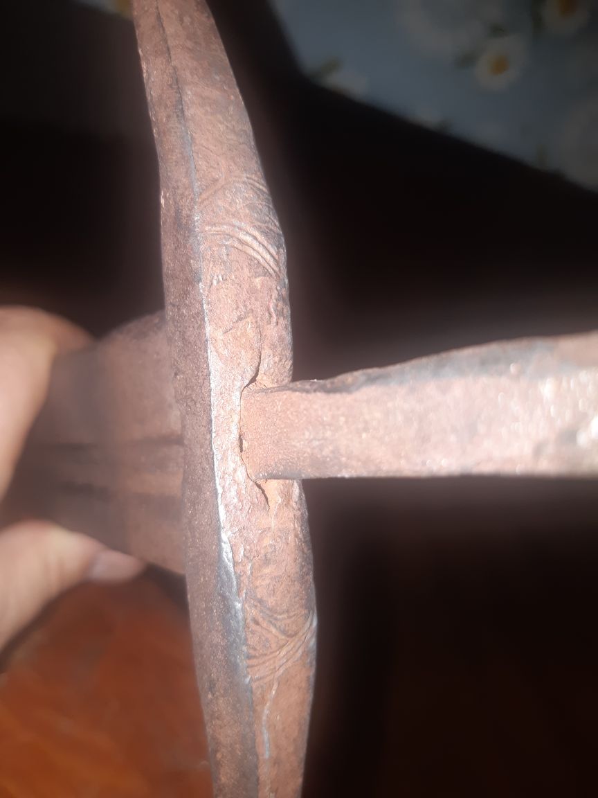

and I want to show another crosshair, judging by the remnants of what is visible in the photo, it was probably clad in a notch, with floral ornaments, in the photo there may be remnants of the stigma at the base of the blade,

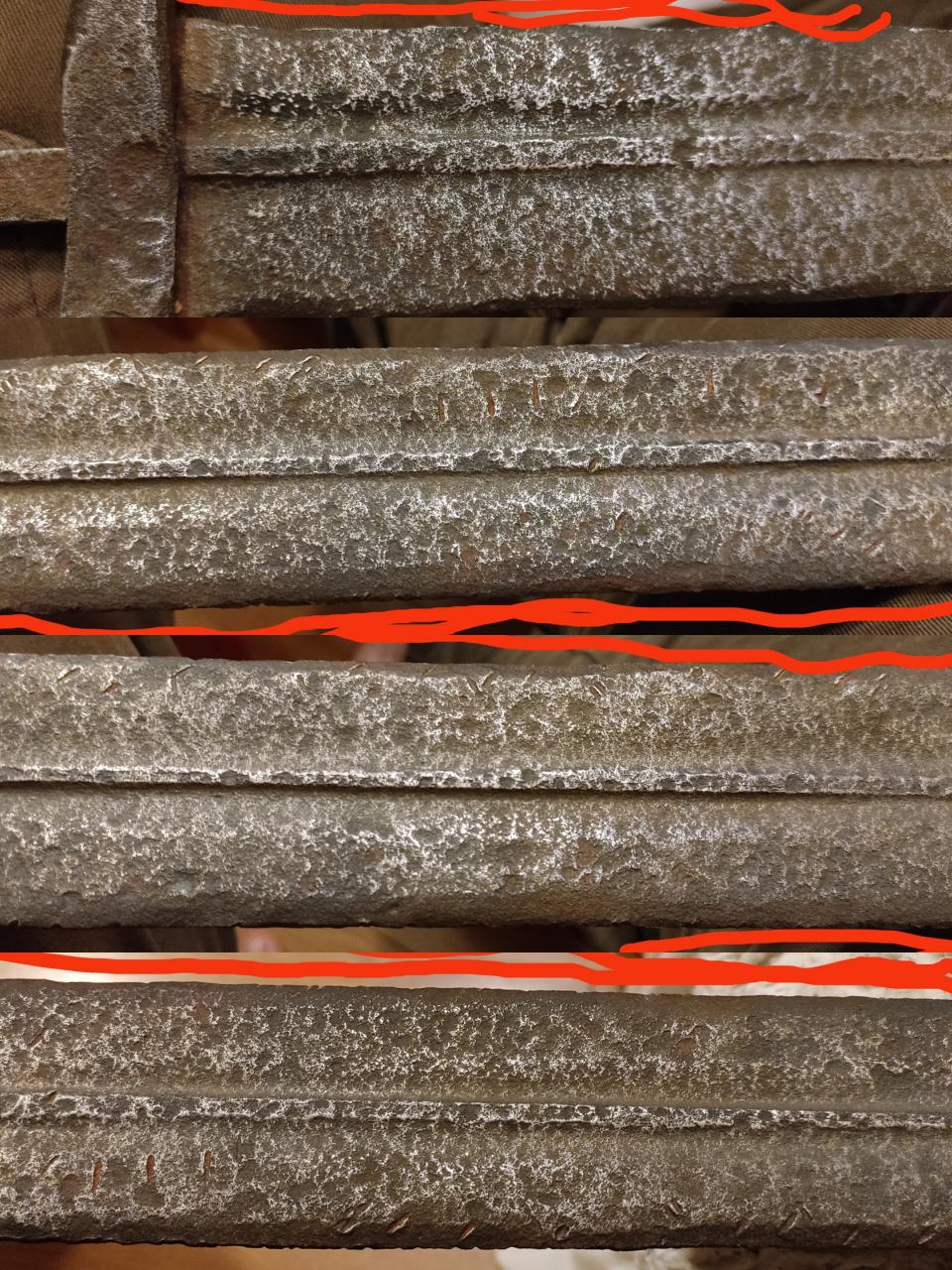

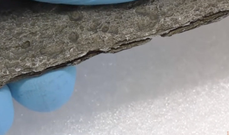

These are very interesting pictures. The corrosion on the guard, in particular.
Normally, I am very sceptical of "clean" pitting, and the guard also has an unusual shape. But that doesnt necessarily make it bad.
The corrosion on the guard, in particular, with the "lines" makes me believe more in the object, and also the corrosion near the blade edge seems legit.
I'm 80/20 that its good, from the material shown.
It needs further examination though.

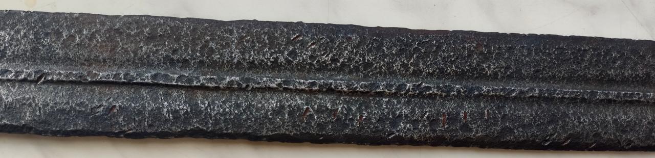

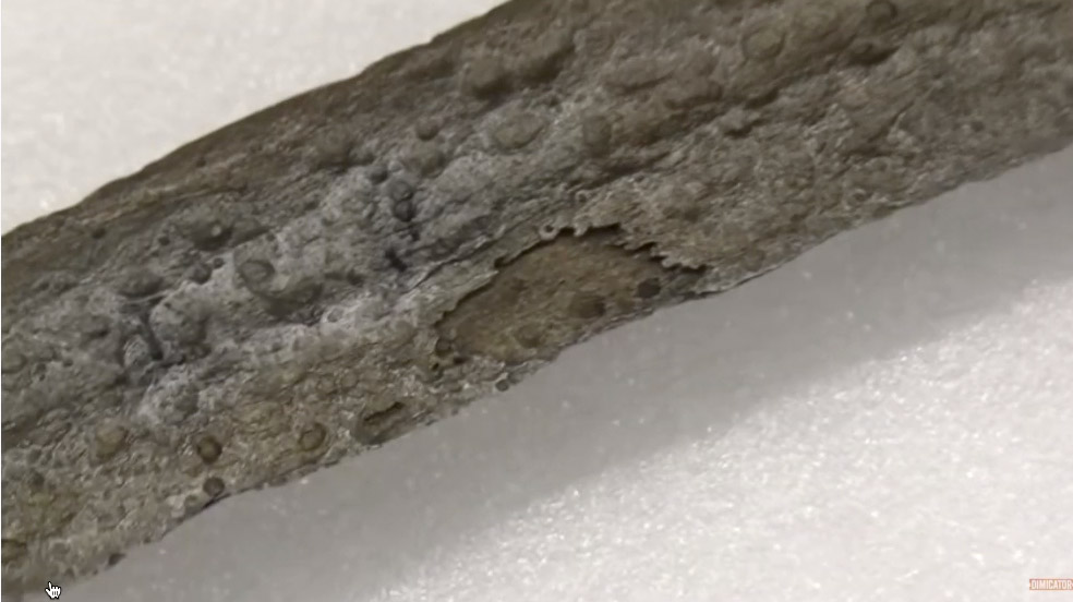

It seems to me that the material that I could then show, its quality is simple and itself, not quite correct, the presentation of the subject on my part, and there is a reason ..
it’s just that the item was being prepared for one exhibition, and since I did the initial clearing myself, I only had a question about the unusualness of the sword itself, the protection, the tip of the blade and the black, in general, in general, in type and appearance, and in the photo that turned out then he was so all flat and uncomplicated. therefore, so, but in general it was postponed, but I opened it gradually,
in the general photo, of course, it is not visible, but in fact it is all in caverns, there are still photos of places that attract attention

unfortunately, if something happened, then only a "shadow" trace remained, but even so
