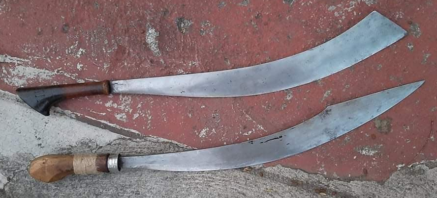

My friend's glot vs my pira.

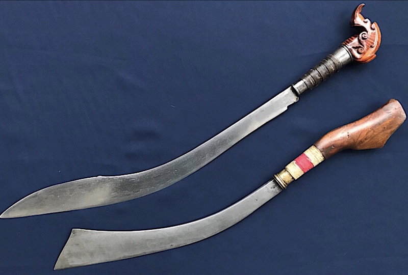

Here’s another sword that could be classified as a Glot with a plain wooden hilt.

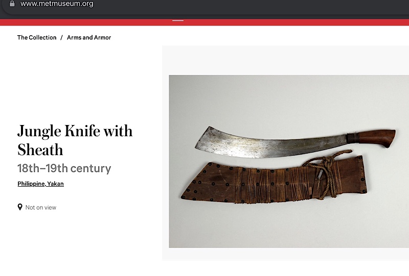

Here’s another Glot. Courtesy of the Met

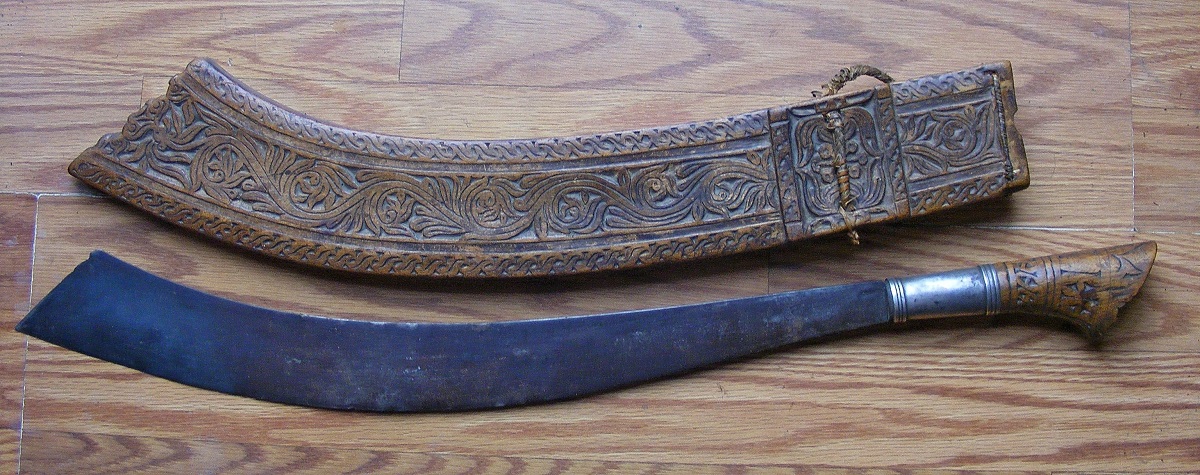

Default Here's mine
This is a similar item from my collection, which I have always assumed as being from Borneo (happy to have my opinion challenged). Discussed here: http://www.vikingsword.com/vb/showthread.php?t=22048
Russel
Lovely.
I’m recalling reading this thread years ago. I just remembered the resto work on the blade. That scabbard engraving is to die for.
Thanks for posting.
