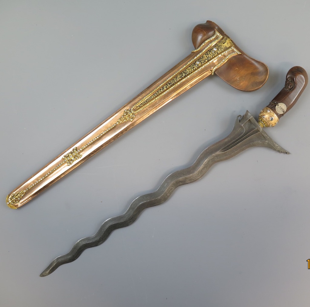

Originally Posted by jagabuwana View Post

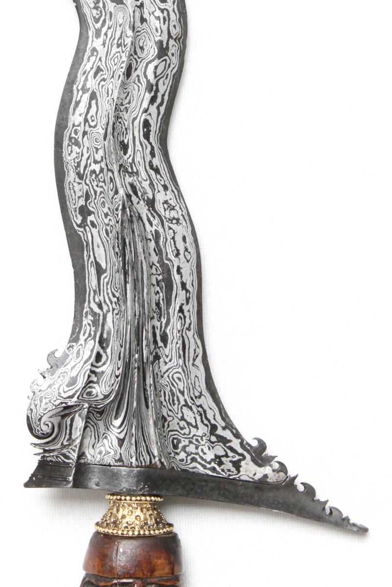

Wowzer that last one is just about as long as I've seen any keris. Can you tell us anything more about it?
Interesting handle too - what's the material?
Hullo jagabuwana,
This may help:
Desc: Doehoeng Soember (bangkinang variant)
Char: Oepih-rai moentir, djanoer mentjar
Blade: LxOALxWxT=56x67x7.15x1.49cm.
Handle: Green-horn malati-motif w/ white-metal seloet
Wt: 462g.
Sheath: Wood majang w/ green-horn toe
Last edited by Amuk Murugul; 14th June 2021 at 10:26 PM. Reason: spelling correction
According to Amuk's specs that keris panjang seems to be 56 cm. Pretty long, but not unheard of. Thought you might want another look at mine. It's blade is 58 cm, though i would not be surprised to find an even longer one.
http://vikingsword.com/vb/showthread...hlight=panjang

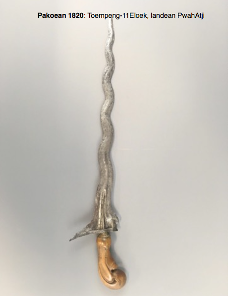

Default Tinggalan Karoehoen (heritage)
Hullo everybody!
Doing some 'spring-cleaning'. Thought the following may be of interest.

Thank you Amuk, I guess that "landean" designates the hilt (landeyan in Madura), what does PwahAtji mean?
Old 17th October 2021, 10:27 AM   #65
Amuk Murugul
Amuk Murugul's Avatar
Join Date: Feb 2007
Posts: 472
Hullo Jean,
- landean/landéan/landeyan/landaian are the same, just different spelling/accent (c.f. apotheek/apotek/apoték/ apotik =apothecary/pharmacy); means handle.
- PwahAtji literally means “celestial and inconceivable/unimaginable” i.e. the ultimate essence beyond our ken.
. ..... This type of hilt is .....
. This style of pendok overlapping on the atasan is fequently seen these days .....
Hullo Jean,
I've changed the hilt for a 'more appropriate' one. Hope it's pleasing.
I've also attached pics of similar oversheaths from 18thC-early19thC. One was a present from Hamengkoeboewono.

Hello Amuk,
Beautiful pieces, thank you!
The silver hilt on the first pic is in coteng style from Patani (Thailand) so not very suitable with this Cirebon kris IMO?
Old 20th October 2021, 12:43 PM   #68
Amuk Murugul
Join Date: Feb 2007
Posts: 472

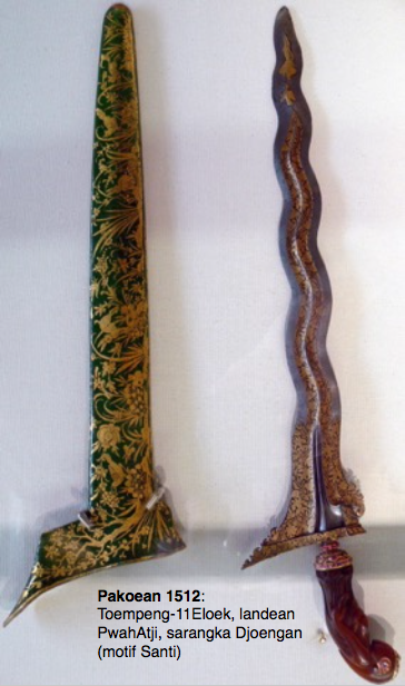

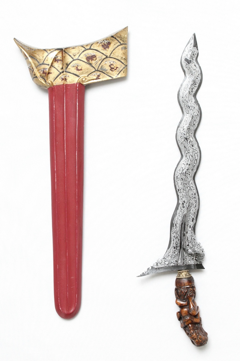

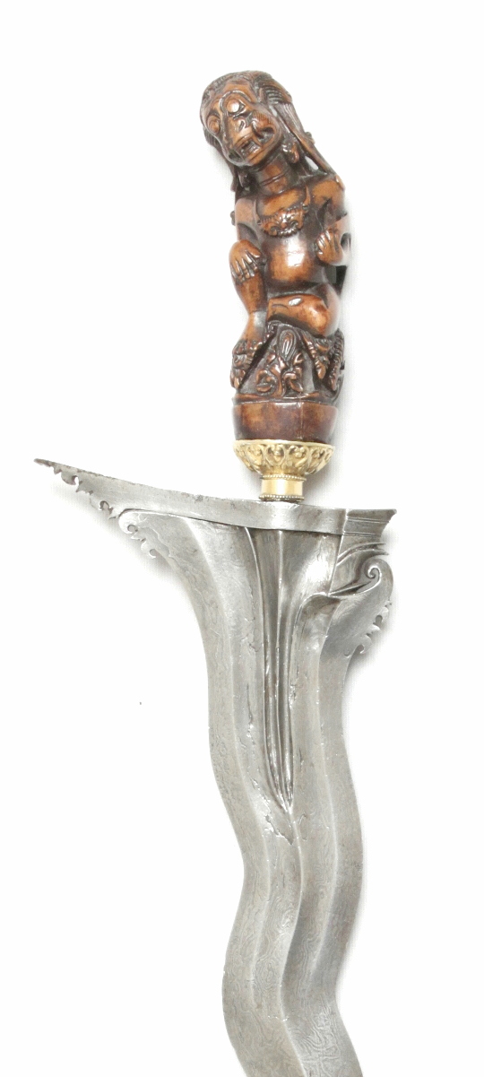

Default DOEHOENG SANG WANGSADITIA
Hullo everybody!
Just thought I’d post about this familiar item. It feels the appropriate place. I’m sure better and more detailed pictures are available elsewhere in this room.
blade: Mahisah Toempeng 11Eloek
hilt: Wood Sang Manarah
meas.: 44x54x9cm.
sheath: Wood Djoengan Lemah Pakwan Radjapoetra
vintage: 1512

No better or more detailed pictures in my part of the room i'm afraid. If you or some else has larger files i believe posting them would be appreciated.
Haha, this kris is described in detail in the Krisdisk from Jensen (a precious picture reference for antique krisses) but subject to copyright.... You may see it upon your next trip to Vienna

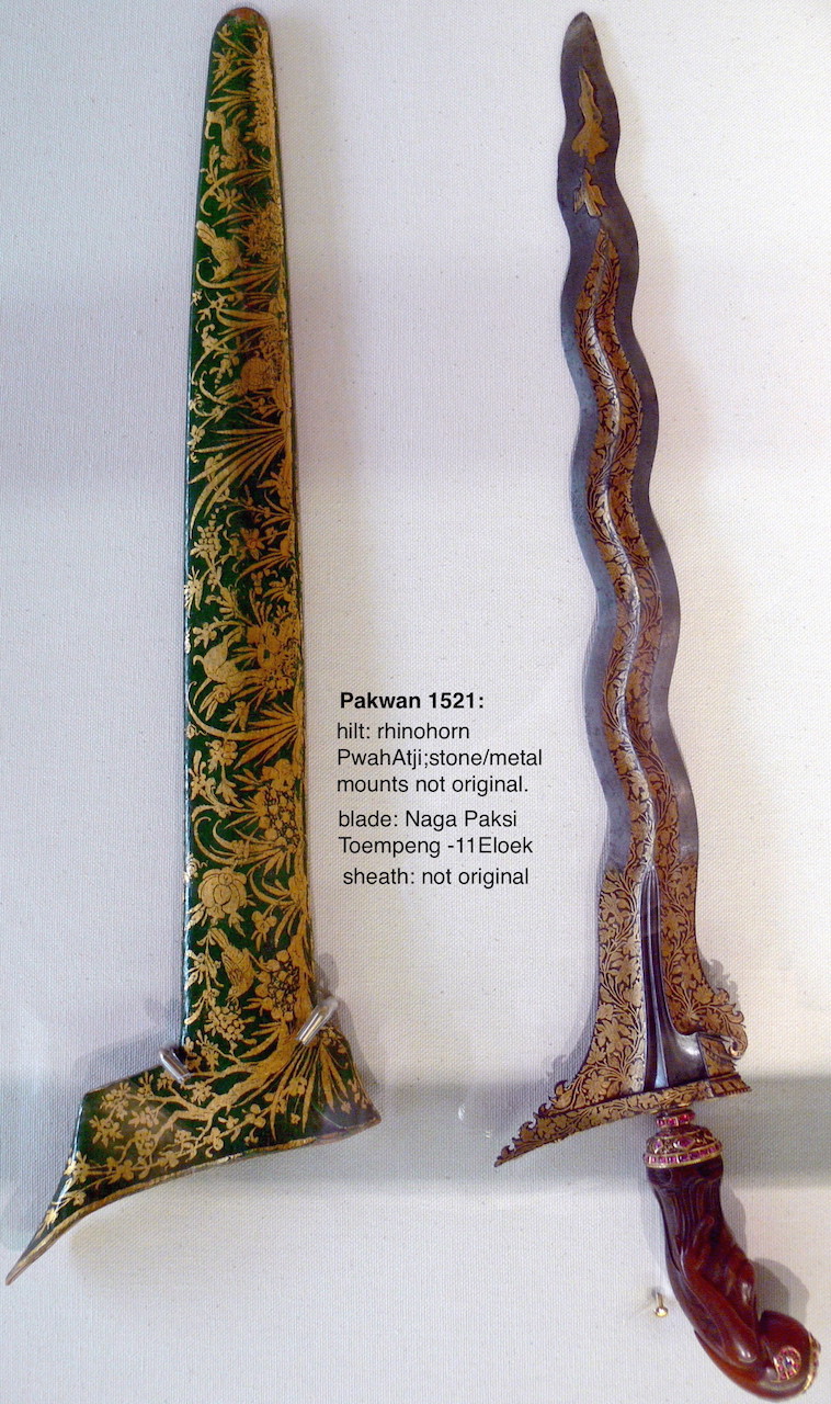

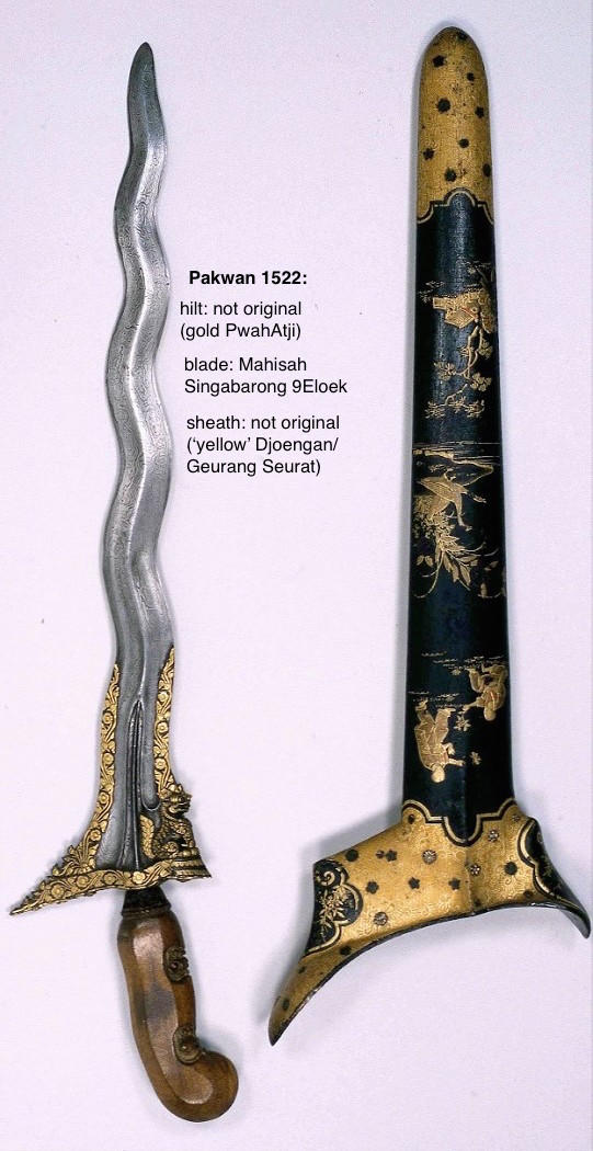

Default DOEHOENG SANG NALÉNDRAPOETRA PREMANA
Hullo everybody!
Update for 1st picture of post #63 above.
Old 24th December 2021, 09:00 PM   #80
Gustav
Join Date: Jun 2009
Posts: 1,280
As the sheath is a perfect fit for the blade, we can consider it to have been made for the Keris and thus original.
Old 24th December 2021, 09:49 PM   #81
Amuk Murugul
Join Date: Feb 2007
Posts: 472
Hullo Gustav,
As you well know, during the life of a blade, it may undergo various changes of dress. When undergone properly, of course they should always fit ‘perfectly’.
By 'original', I mean as at the time it left the ‘original owner’. So I guess what you’re saying is that THAT particular sheath came with the blade when handed over by the then owner, back in 1521.
Thank you for your input.

Hello Amuk Murugul,
of course this Keris did have at least one stopover in workshops run by portuguese in ther trading facilities or colonies, where the stones in the hilt were in set in a Ceilonese fashion, and possibly the Mendak was made. The style of overpainting of the sheath is associated with a Cochin workshop.
You surely were aware of this thread with more details on this:
http://www.vikingsword.com/vb/showth...chordens+keris
But yes, I think the possibility this Keris originally came out of Java with this sheath is very high.
Old 25th December 2021, 09:15 PM   #83

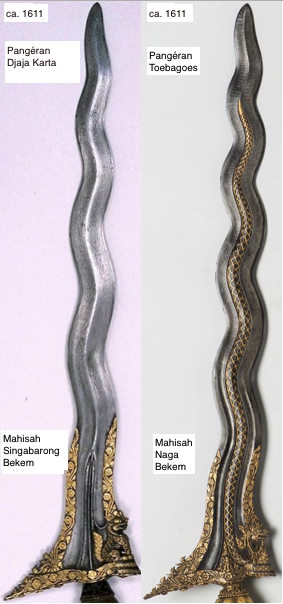

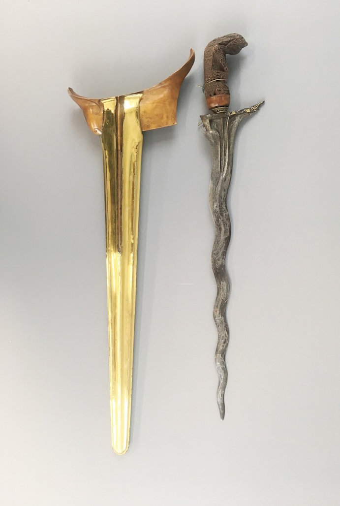

Posts: 472
Hullo everybody!
Just thought I'd drop this one in. My take on these prevously-discussed objects. (Pardon the crypticism.)
May be of use to somebody.

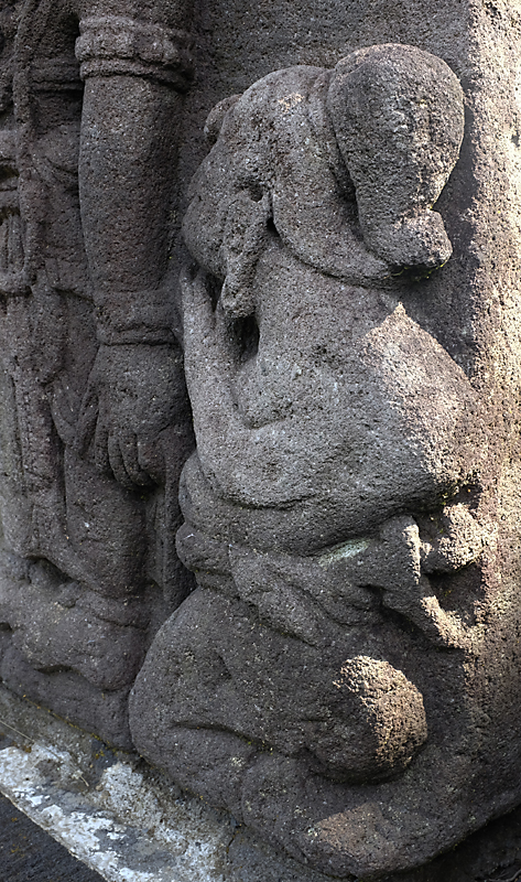

Posts: 7,015
Candi Sukuh, Jawa Tengah, Circa 1440CE

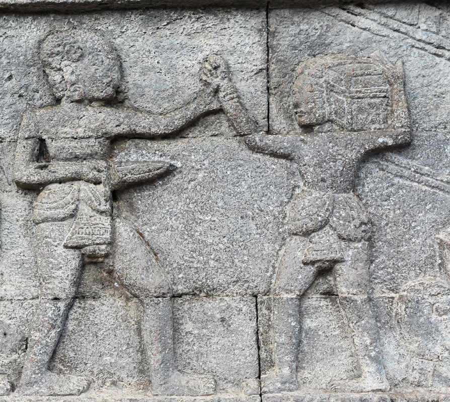

Alan - I'd like to confirm that what I'm seeing is correct because it's not so clear to my eyes.
Does the relief show a sheath that looks like a sandang walikat wrongko, and a pistol grip-shaped handle?
Old 5th April 2022, 08:12 AM   #89
Posts: 7,015
Absolutely correct JB.
There is another relief carving in the same location and with same time & place of origin that shows this style of wrongko too, but the carving is not as clear as this one.
Across in East Jawa at Candi Panataran (Penataran), near Blitar, state temple of Majapahit, we can find a representation of a wrongko that is 100% Bugis.
When we get to digging a bit and looking at the old, original evidence we do sometimes find a few unusual things.

Posts: 7,015
Candi Panataran, State temple of Majapahit, about 1200AD to 1450AD
