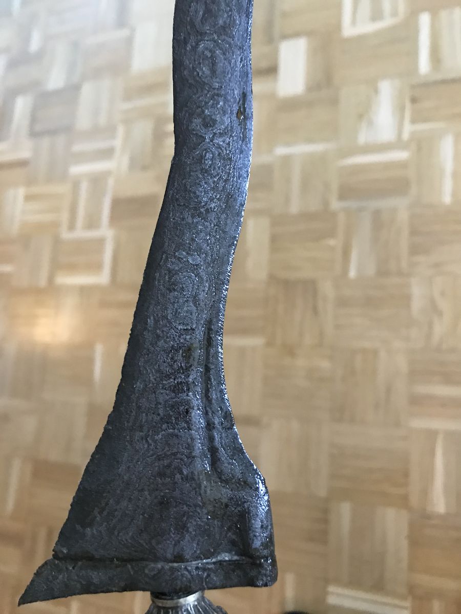

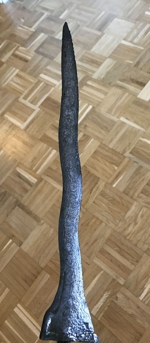

During my experiments and etchperiments in finishing polished blades I randomly found out a way to improve the contrast of old Pamor-steel.

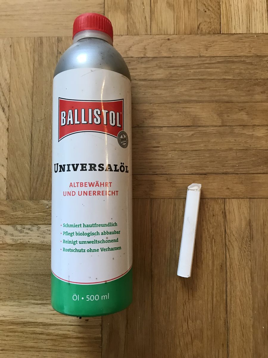

Simply by adding a plenty amount of oil and gently rubbing with white chalc. The stuff from old school.
This will not remove anything and also leave no scratches but it will significantly improve the Pamor after a while.

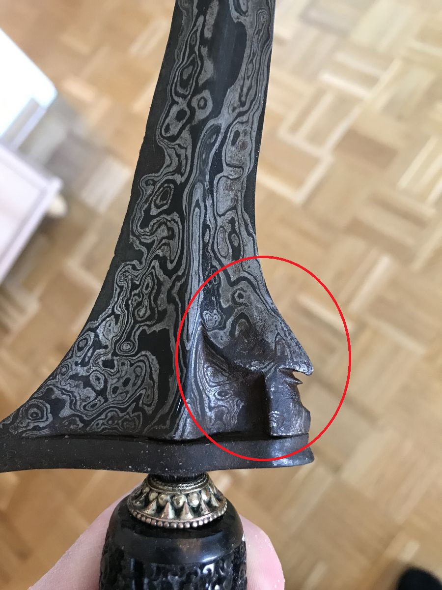

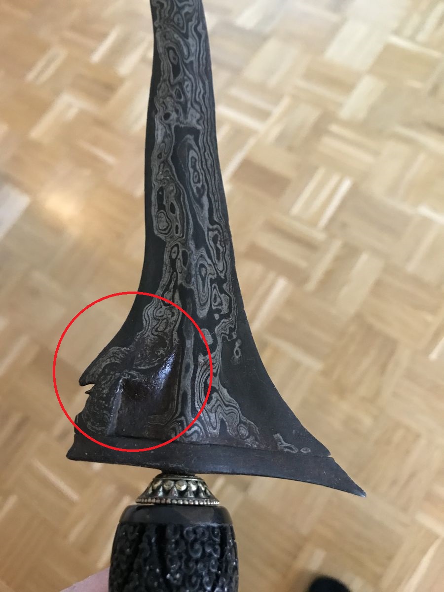

Picture 1 and 2 shows an old Keris, probably from Java. The blade was in awful condition, the pattern was neraly invisible. After two hours of polishing with Ballistol and white chalc, the pattern is clearly visible and totally unexpected, the black color came back a little bit.
The second blade is my personal Keris, so there is no location connected to this Keris, it is a Keris Roland or Keris Saxony, with a nice modern a bit mystical background (this Keris found me!). This blade had heavy corrosion in the highlighted areas, it is still far from being perfect but much better than before and the active rust is stopped, without touching the staining.
I only used the Ballistol in the last picture for that. This type of Ballistol got a strong smell, I cannot quantify the influence of this particular oil to my technique. Watch out, that the blade never becomes dry during the process!
The technique is easy enough for everybody and just a question of time and stamina, no chemicals are required.

What is "white chalc"?
Old 9th March 2022, 07:11 PM   #4
drdavid
Join Date: Aug 2005
Location: Australia
Posts: 374
Possibly 'Chalk'
Old 9th March 2022, 07:50 PM   #5
Posts: 7,218
Thank you David.
Yes, I'm sure it is old fashioned blackboard chalk.
Chalk used to be made mostly of calcium carbonate held together with other ingredients.
The reason that even old Balinese blades have a smooth surface is that Balinese keris are routinely cleaned with powdered limestone, which is comprised mostly of calcium carbonate.
Calcium carbonate is a very mild abrasive and has a number of applications where it is used to polish away surface stains and dirt.
I do not know what modern chalk is made of but I suspect it might be something other than the old recipe.

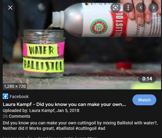

Water soluble? I am not doubting it , I am just curious and genuinely interested...but how is it possible if this is a oil?
Maybe a better word is miscible.
From the Ballistol website:
Can you mix Ballistol with water?
Since Ballistol emulsifies with water, mix one part Ballistol and two parts water to make one of the best black powder solvents available.
It's called the Ouzo Effect <-Wiki Link
When used on damp steel. the oil penetrates the water, coats the steel and the water lifts off the surface, where it evaporates.
