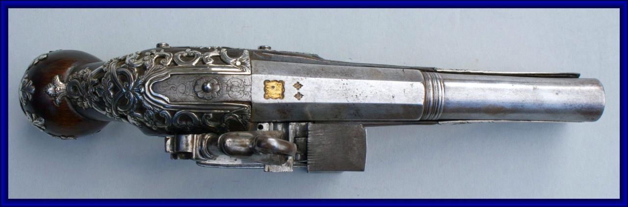

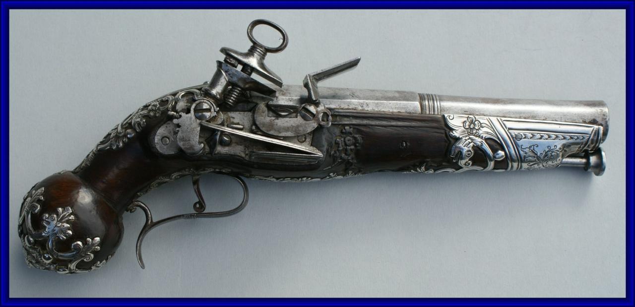

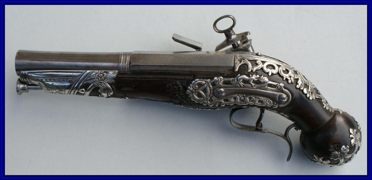

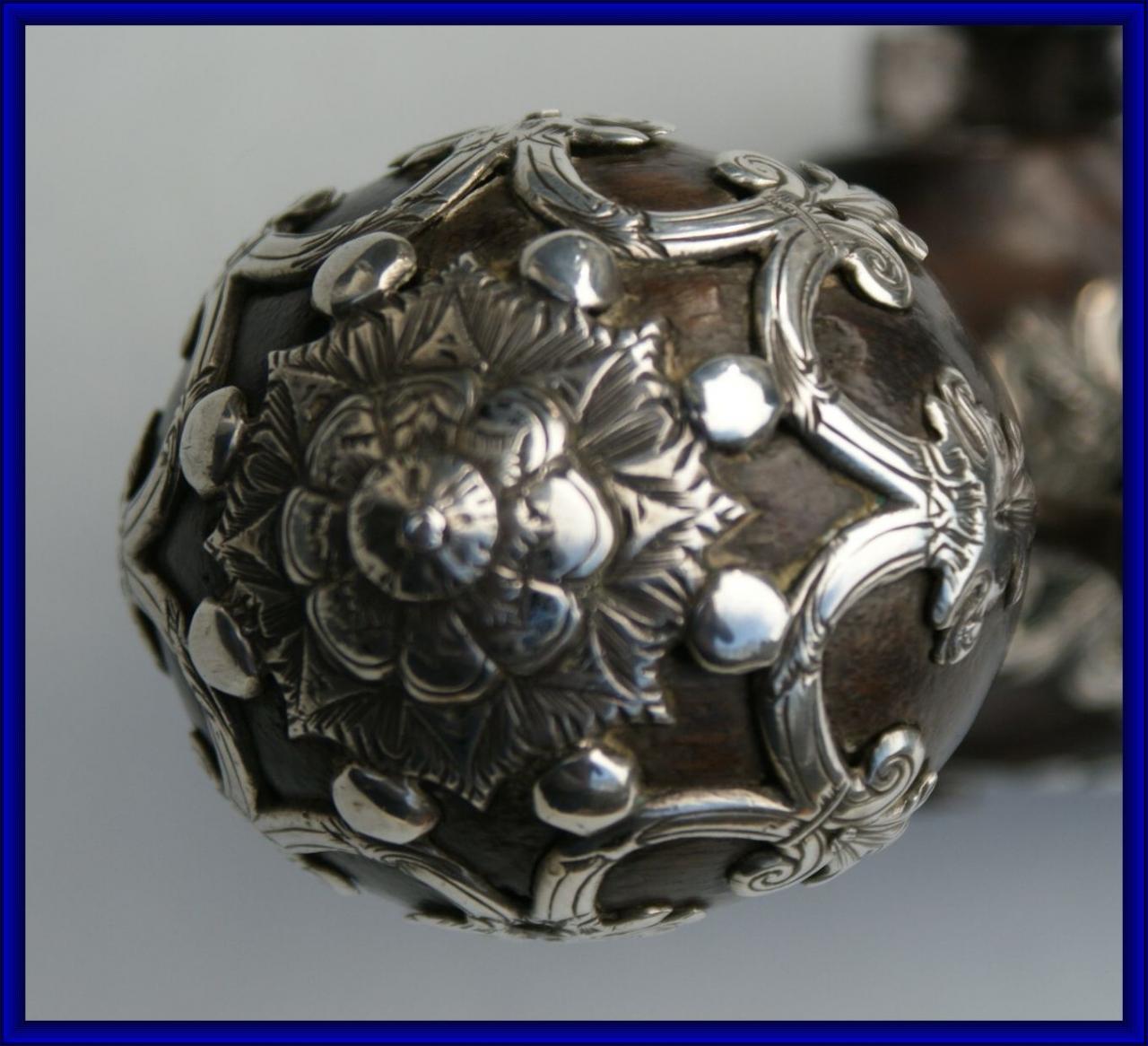

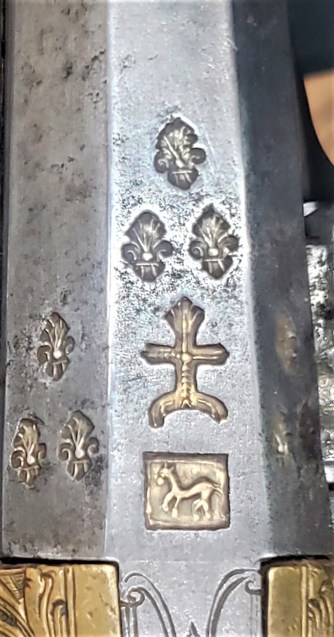

This pistol just came to light, wanted to share it with the forum.
Larger than most I've seen at 33 cm long. Approximately 80 cal.
The engraving is fine, and the motifs are very unusual. Dated 1798 on the lockplate. Ramrod appears to be replaced.
Interested in thoughts about what inspired the decoration of the mounts? I will reserve my own opinions pending member responses.

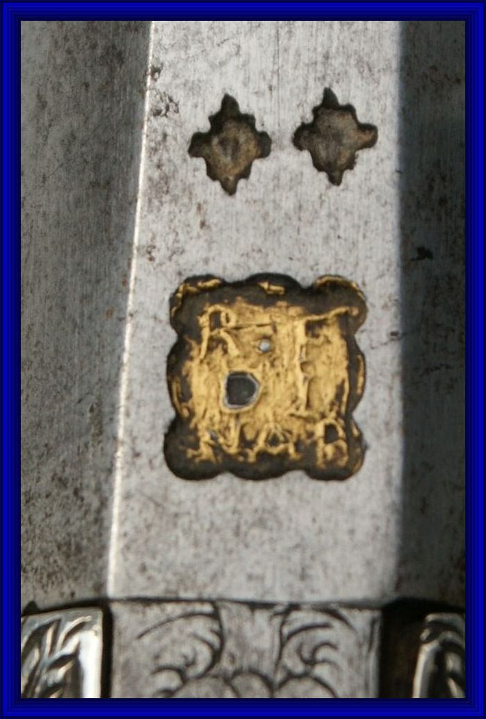

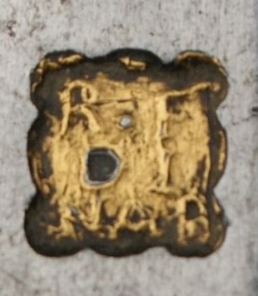

The marks are inlaid silver and brass

Hello
Indeed, it is a pistol produced in Naples, in the style and decoration of Ripoll's "ball" pistols. Let us remember that at that time Spain dominated southern Italy. The fleur de lis punches and the Madrid cross and the punch with the horse are intended to imitate the Spanish punches. I do not find any relationship between the sculpted figures, only that it is more elaborate than what Spanish weapons usually have

A very interesting piece. I was thinking of Spain with the typical Miquelet lock. The decoration reminds me of the Spanish colonies, such as native inhabitants from the Americas.
Similar figures can be seen on Tobacco jars from this period and before. The rocaille decoration relates to the fashion of the mid to late 18th century.
Great find!

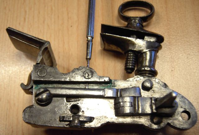

As a help to compare here are photos of a genuine Naples made pistol from the Real Fabbrica di Napoli. I think the pistol in question was made either in Spain or in America

Thanks, Fernando K, Udo and Peter.
I have been unable to find other metal work
with such motifs. What could be the connection
between the two, European heraldic and
New World indigenes?

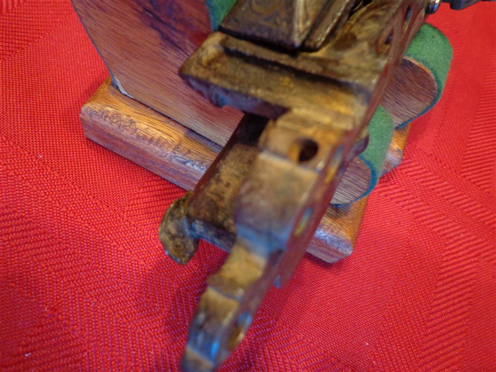

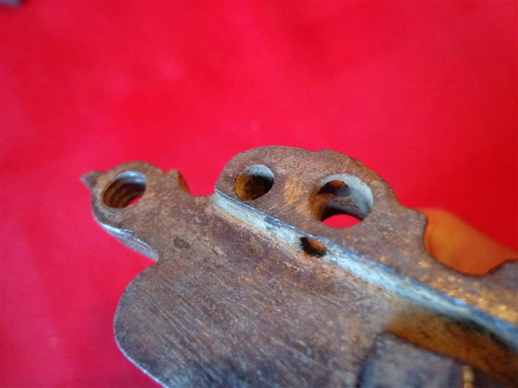

I do not understand what you mean with a "Faithful". I added photos which show the hole in which I stuck a screwdriver to show that the hole is going through. I do not know for which purpose this has been made and can see no sense in it, sorry.

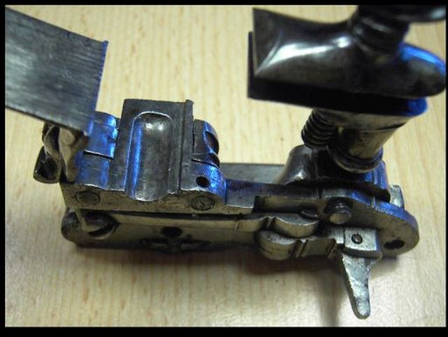

HELLO
I attach a photograph. The Ottoman keys continued to use this method. Here you can see that the piece that acts as a screw has been removed from the frizzen and the faithful one, slightly conical, has also been removed so that it sits and does not move.

Oh, what is described in the thread as a "faithful" is what is known in Spanish as a fiel which is a pin drilled transversely through a screw and its threaded hold to keep it from backing out or loosening with use. James D Lavin in his A History of Spanish Firearms pp 164-65 explains this quite well, it was a common feature of early locks (before the mid-17th cent) probably because screw-threading techniques were in that era not as precise as later on. By the 1640s, only the frizzen and cock pivot screws still used them. According to sources cited by Dr Lavin, the frizzen pivot screw was the last application for the fiel and this feature generally disappeared by the 18th century.
I have handled numerous examples of miquelet locks in my collection and restoration practice and find all this to be the case.

I do not find any relationship with the figures A lion appears, an unknown animal in America. The human figure is idealized (is it a man, a woman, an Indian?) They are only decorative figures. Besides, there are few copies produced in America

Lions may not be part of the native fauna of the Americas, but would have certainly been known to the human inhabitants of these continents after the arrival of Europeans via trans-Atlantic cultural influences -- such as art, literary references, and Biblical imagery.
This hole looks like it held a crosspin that retains the tenon that projects from the rear portion of the priming pan cover plate / bridle. This tenon fits into a corresponding hole or mortise in the lockplate, and the perpendicular crosspin helps anchor it. As Fernando correctly points out, this tenon cannot be a threaded bolt because there is no way that the plate/bridle can be rotated into place under the pan.
Whether this pin, for this particular application, can be regarded as a fiel in light of the rather precise definition of same in old texts is a subject for another post. However, at this point we can be clear that the mounting of the priming pan bridle / cover plate is a separate issue from the frizzen pivot (mounted just ahead of the pan).
And what do you think about a cat called "Puma" or "Silverlion" or maybe a Jaguar? Both cats are well known in North-and Latin America.

The American "puma" and "jaguar" have no mane, like the animal depicted on Oliver Pichot's gun

To me, this looks like a Spanish colonial piece rather than made in Spain or Italy, the decorative work is just that little bit crude or naive.
Spain's colonies were very widespread, including North Africa as well as the Americas, the Philippines and even in some parts of Asia.
I am discounting the Spanish Netherlands here because they had their own style, and no lack of extremely skilled craftsmen.
