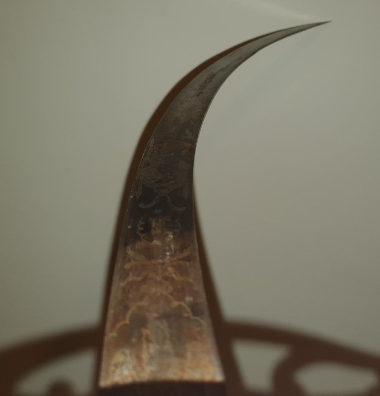

I have one of these with the usual conventional blade, but also owned one with a narrower and very much more curved blue & gilt blade (see pic) - so there were a number of variations.
