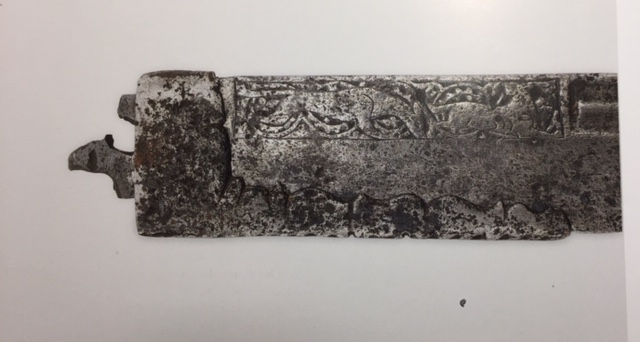

Hi,
First of all as I know next to nothing about 'samurai swords' I always stay away from the rarified minefield of Japanese steel but I unintentionally picked up this odd Japanese type sword as nobody else seemed very interested in it. A crudely mounted 59.6 cm Wakizashi length blade with an overall length of 82.3 cm and a scabbard length of 68.8 cm. Everything is tight and the hilt peg hole aligns perfectly with the most forward one in the tang. The blade fits snugly in the scabbard and firm thumb pressure eases it out of the scabbard ready for drawing. The tip as you can see is swollen akin to armour piercing type points on some Indo-Persian weapons. The blade has been bent at some point and straightened and there are mild ripples in the blade as a consequence it also has numerous nicks on the edge. There is in hand what appears to be a hardened edge but I'm having difficulty capturing it on film. This sword does not pretend to be what it is not but I am curious as to why what I think might have been a reasonable blade in its youth has such crude fittings. Of course it may not be Japanese at all. The obvious other choice is Chinese fakery.
A forumite has kindly given me some suggestions but I am keen to hear some other observations.
Norman.
P.S. I have added a close up of the tang which appears to show file marks and the peg holes are not drilled but look to have been made using a punch/drift.

From the way the handle is wrapped and the quality of fittings, I believe this is a Satsuma Rebellion sword. Low quality, but real
Japanese sword. Can't tell much from blade pics, but seems (?) to have some sort hamon (temper line). Tsuba(guard) is likely cast, not "crafted". Best I can do. Hope you can find more. Try Googling Satsuma Rebellion swords.

Certain elements remind me of what I've seen on a number of Korean swords of the latter Joseon period (18th -19th cent),
1, The style of grip wrapping, sometimes with even wider braid.
2. Simple sleeve-like ferrule and pommel of rather thin metal
3. Radiused edge at the tip without the yokote or perpendicular delineation at the the apex of the typical angular kissaki on a shinogizukuri configuration blade.
4. The very narrow spine created by a marked taper of the blade cross-section above the shinogi ridge. Perhaps coincidentally, I've seen an identical cross-section in a Bukharan saber in the Moser Collection, in profile the blade looked almost double edged in that extreme example. 'Don't know if it's a continental affectation, although a couple of Chinese examples have come to my attention over the years; they are not common and the Bukhara manifestation is the only instance of that type I've seen so far from that region.

I don't believe this is a Japanese sword.
The shape and tip of the nakago, the not perfectly straight filing marks, as well as the rust covering them are giveaways.
However, I am not very knowledgeable about Japanese swords and would advise you to post it on Nihonto Message Board forum.

Unfortunately this isn't Japanese and is probably a Chinese fake. Nothing about the tsuka (handle) is Japanese, the tsuba is crudely cast, the nakago is very crudely finished, blade geometry all wrong and the notches where the habaki fits don't line up. I don't know anything about Korean swords, but most likely a Chinese wall hanger.

Regarding the misalignment of the notches, just have a look at the photo.
In Japanese swords they are perfectly aligned.

I see what you mean. The 'habaki' on this blade has been manufactured
to take account of this difference.

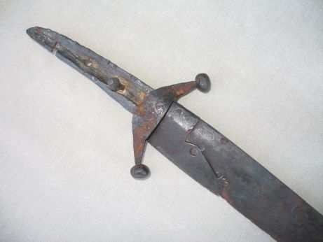

Hi,
Another Korean sword with a discernible 'offset habaki' but with the more common 'rivet' through the hilt which also doubles as a hole for a tassled cord.

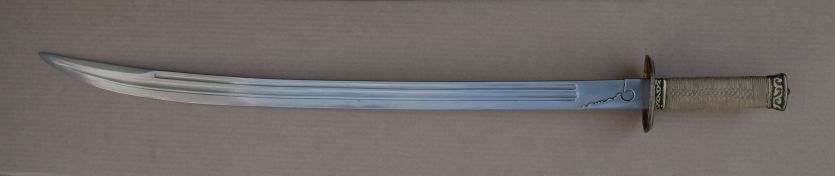

A modern Korean sword made for martial arts. Note the offset 'habaki'.
I'm beginning to come to the conclusion that my sword is a distinctly Korean construct and probably has nothing to do with Japan. I will continue to seek more information and post as and when. If anybody has any more thoughts on the subject please let me know.
