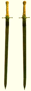

There is an interesting thread on SFI about a sword in the Armenian Church in Venice allegedly belonging to the last King of Cilicia (Lesser Armenia) Leon (Levan)V from mid-14th century. With Andrew's permission, I am posting the entire thread here for our discussion.
http://forums.swordforum.com/showthr...threadid=67095
If true, this is a major cultural find and a great source of information for all the sword-loving nations and, especially, individuals
I already formed my opinion, but would like to hear from other people what do they think.
Not often are we given an opportunity to discuss something of that magnitude. Let's not miss it!

If you honestly believe that that sword is earlier than 17th century, you really should read a history book

Old 30th May 2006, 07:28 PM   #5
Aaa-h, somebody agrees with me!
My feelings exactly!
First, the style of the inlay: this is a typical Turkish Ottoman technique with gold wire hammered into incised design and protruding above the surface. The earliest examples are from the 17th century.The intactness of the inlay is astounding: no way it could have been made in the 14th century: only museum exponates survive that well, but the older swords were put to use.
Second, the ornament of flags and halberds is very European , at the earliest 17th, more likely 18-19th century.
The figure of sitting Mary with baby Jesus in her lap is very Western: first, it has uncovered hair that was unacceptable to the Eastern Orthodox Church and, second, the Cherub above her head is also Western: head with two wings. The "all-seeing eye in a triangle" in the uppermost cartouche looks suspiciouly as a Masonic symbol that came into popular use in the second half of the 18th century.
The blade also looks Turkish, typical early Kilic 17-18th century.
The handle looks Persian (iron crossguard and 90 deg. pommel) but it could have been remounted. Remounted and broken handle and perfectly intact blade???
My overall assessment: this is a very nice and valuable sword made in Turkey, likely Istanbul in the 18th century at the earliest under significant Western influence. It resembles mightily the series of similar swords shown in the Astvatsaturyan's book "Turkish Weapons" and bearing Greek, Latin, Slavic or Arabic inscriptions. Probably, there was a fashion of the times.
As to the attribution of this sword to Leon V.... Not every "Indiana Jones" knife was actually owned by Harrison Ford
My opinion exactly on swordforum, though manouchehr says he believes that its something different. He says that in his upcoming book, he found out that these hilts and blade styles go much older than 15th century.

i agree with all (except the 14thC date of course).
i think the blade could go as early as the 17thC, and the hilt can so as late as 19thC, so ariels 18thC is a safe bet. i do feel a strong possibility that the blade is earlier than the hilt, so a possibility the inscription was put on during this refit.
there are many claims on SFI, many of which are unfounded unfortunately. i look forward to any new book on oriental arms as my library is as important as my collection, but i fear the 'expertise' there is on history and language, and definately not on arms. it seems the presence of inscriptions and placement in a museum seems to be 'proof' in some opinions.

A short quote from the original description of the monastery where this sword is exhibited:
"There is the one that is belived to be the sword of the very last
King of Armenia. The golden inlay on it says it belonged to Leone
V, dated 1366, but the monks said it is slightly historically
inaccurate"
Well, slightly....Rivkin is absolutely correct: the dates do not agree. How could one overlook this glaring discrepancy ans still accept the " 14th century Persian" origin of ths sword, is beyond belief!
First thing I did when I read the story, was to google Leon V: it all went downhill from there on....
ariel is offline

The pictures taken in Venice are mine. As a quiet good NihonTo expert I would suggest that using such poorly made pictures for a Kantei (sword judgment in japanese terms) is a very bad idea no matter how great is the knowledge. On SFI it has been clearly stated in the topics that he date is mismatching by 25 years, and this is notorious to the monks too.
Calendars changed during the time and documents about the swords are not available for consultation, YET.
Me an Manouchehr aren't searching for an Indiana Jones cheap notoriety but only to find what is really in the Sancta Sanctorum of San Lazzaro degli Armeni. I've personally got in touch with the father superior rev. Elia (surname omitted for privacy, makes your own research...) in order to handle and measure the blade directly, as well as to have a translation of the inlaids that are mainly Psalms. CHRISTIAN Psalms. If we're allowed to make it, stay sure we'll post results and EVIDENCIES here too, no matter about the results.
The blade is armenian. PERIOD. If it has been made in XVII c. by an iranian bladesmith with iranian or indian wootz, and in the classical iranian shape, it is treasured by the Mechitarist as the sword of the last Armenian King in the site that holds most of the whole cultural heritage of Armenian people. Till to evidencies of the contrary will be given by someone here with a too big mouth and possibly with some problem with Manouchehr, it still retain the title of the sword of the last armenian king, for respect to the Mechitarist word.
We all know the myth and swords walks together but to find out truth
needs ability, time, knowledge and ACTION. Manouchehr is trying to go to Venice in order to find out the truth. As a NihonTo collector and amateur I'm very little interested in the matter but I feel hurted the way it is managed here just to have a support that is not found on SFI, might be with a good reason.
More respect is due to the blade, the Mechitarists and Manouchehr.
BTW the sword is freely available (with a thick glass in between...) to everybody by decades. Get a ticket to Venice and prove Manouchehr is wrong before he proves he's right...

Beautiful first post Tsubame1, very friendly. I said, and still stick to my claim, that this is a Turkish made, 17th century blade, with later Persian fittings, and probably much later gold inlay. This isnt out of pure speculation, but according to Anthony C. Tirri's* great book, "Islamic Weapons, Maghrib to Moghul" (see page 130). The claim that it belonged to a 14th century Armenian King is still unproven, and never be proven, I believe.
*Anthony C. Tirri is a scholar of Islamic arms and history, who has handled more pieces than anyone I know probably, and his collection contains hundreds of beautiful pieces.

A bit of history: Mechitarists are Armenian Roman Catholics. The order was established in 1701 in Istanbul, by one Mechitar Petrosian whose life mission was to convert Orthodox Armenians into Roman Catholicism. For that he was expelled by the Armenian community and the Venetians gave him the St. Lazzarro in 1717. Mechitarists collect Armenian artifacts and provide education to Armenian boys who are willing to convert.
This, in my opinion, is yet another piece of the puzzle: the connection with the Western, Catholic sources and the bias to prove that ancient Armenian kings were Catholics. The fact that Mechitarists accept the Leon V/14th century attribution of this sword proves nothing about it's true provenance. They wanted it to be Leon's! How many times all of us bought embarrassing junk on e-bay because we wanted it to be our Dream Blade?
I am sure that they did, and continue to do it, out of good intentions and not for any nepharious purposes or perpetration of a hoax. Blind faith, however, is not a good councelor. They could have brought an experienced museum curator who would have given them the facts. But... what religious faith had ever tried to puncture it's own balloon?
IMHO, the claim that this sword is Armenian is incorrect: there is nothing Armenian about it except the inscription. The claim that it is Persian is even more problematic: it ignores it's Kilic-like form and the astounding similarity with other Istanbul-made pieces of the same time period. To form conclusions on the basis of Damascus assumes that only Persians were capable of making it. The claim that it is 14th century is embarrassing, to say the least
Still, I admire Tsubame1 for his true Bushido spirit of loyalty to his master.
