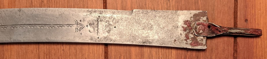

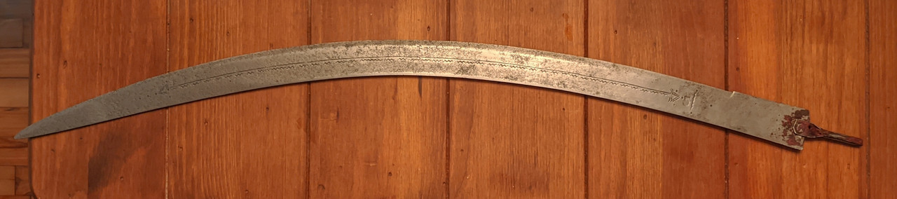

Thanks Nihl, here are some pictures:

Oh! Hmm, that's quite interesting. I think very clearly this is just some kind of haphazard makeshift tang. To me the likely story here is that, at some point, the original tang on that blade broke off, and then perhaps many years later someone found the blade and gave it this improvised tang so they could attach it to a hilt and sell it! To me the whole assemblage looks quite modern, so I bet this was intended to be sold to tourists, just tourists that wouldn't disassemble the sword heh

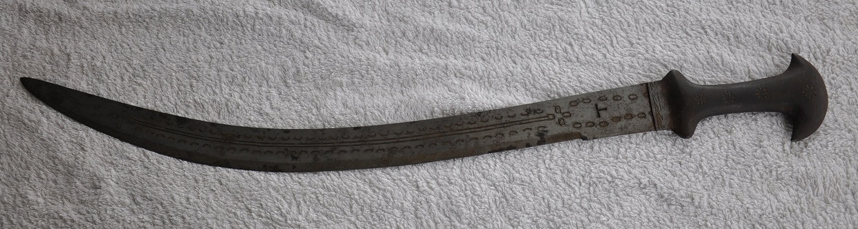

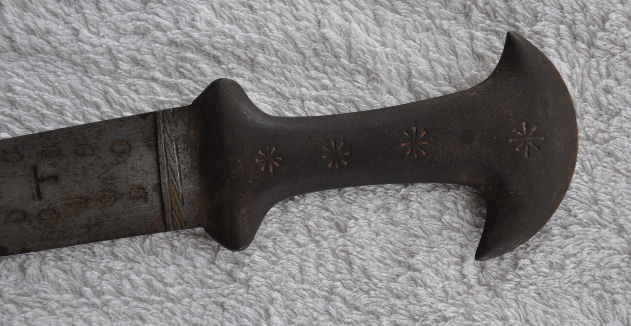

I think Philip is right.
It is not a touristic sword, and a replaced tang is not a problem especially associated with a sandwich hilt or sandwich ricasso.
Look at mine with a very similar blade...

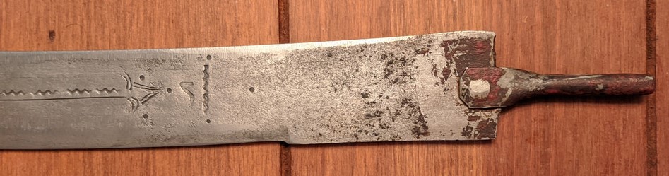

Hi guys, sorry for the slow reply, I have a concurrent thread over at myarmoury from which I will share an update:

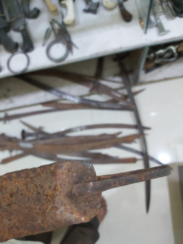

So, I asked the smith, he immediately told me it's a repair. The blade he thinks is late 19th century, the repair could have been done any time, but he hazards 20th century. He said it's not unusual to see either welded or riveted repairs based on the ability or resources of the person doing the repair. Attached is a photo of a similarly repaired blade in his inventory.
