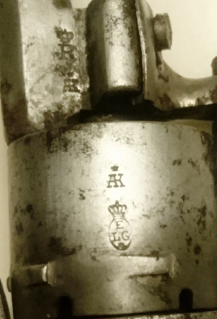

Dear Fernando,
The proof marks are as you show in the catatlog, but this does not mean that the earlier mark disappeared, it was merely retained for muzzle -loading arms, up to at least 1981.
The one you show in the photo is interesting, as it has the Crowned ELG mark, for military arms, Plus, the Crowned R for Rifled arms.
V good to see them both !
Kind regards,
Richard.
