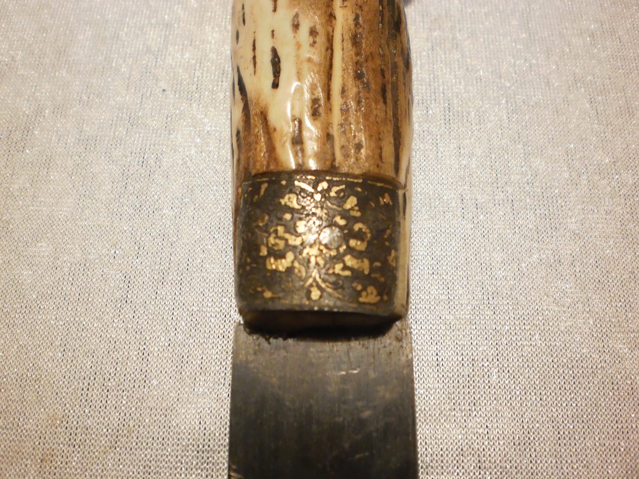

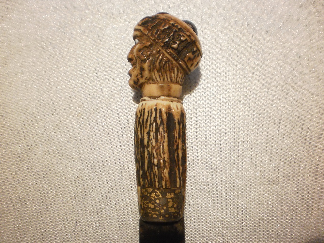

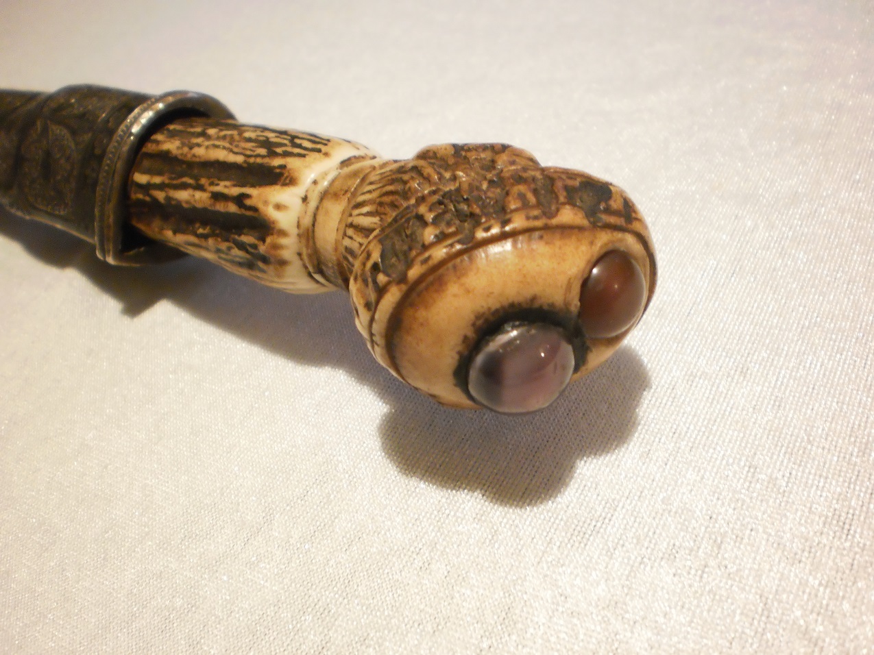

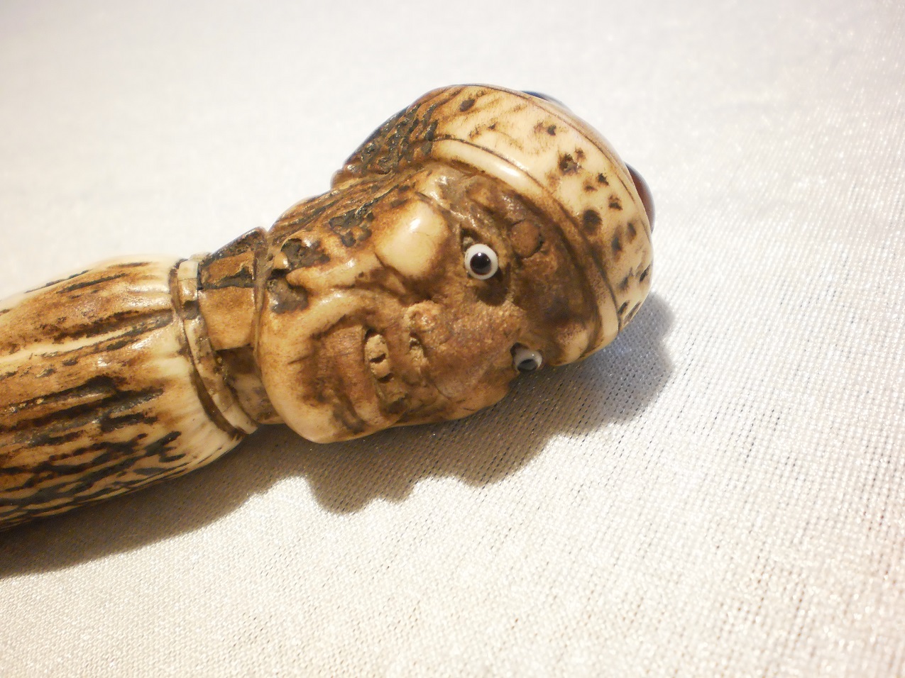

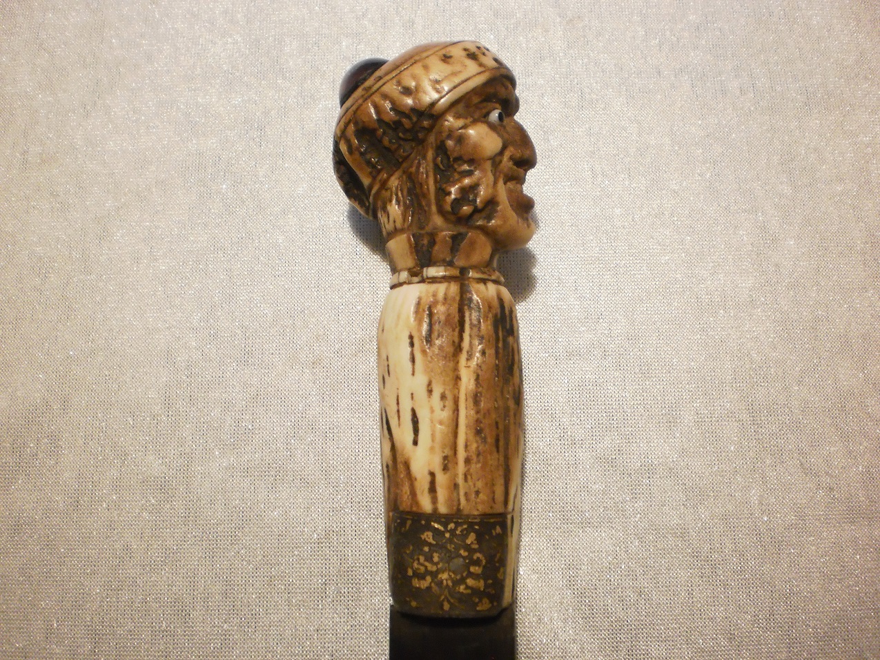

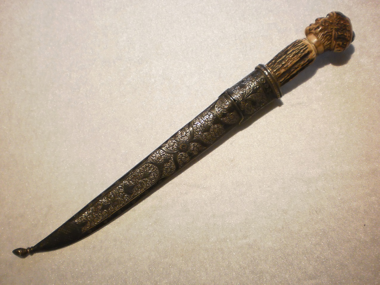

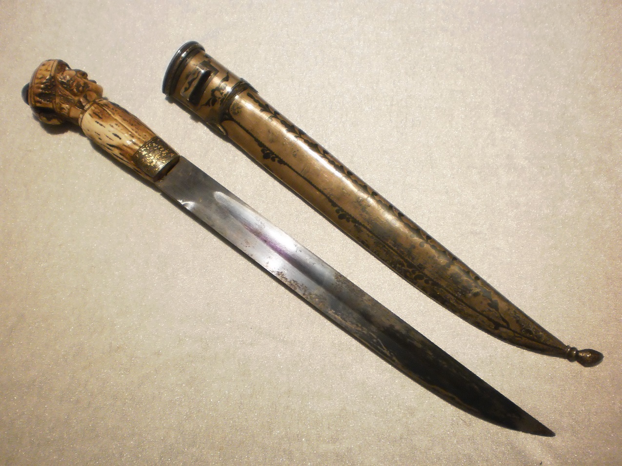

I got this dagger recently which I would refer as a Kard.
Maybe it was made in the early 20th or late 19th century.
I want to ask you if anyone has seen something similar before?
Where this dagger could been made?

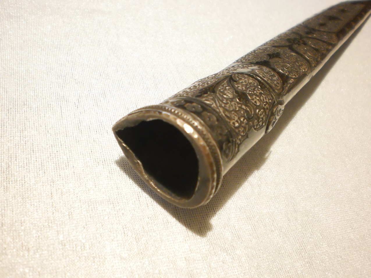

The silver scabbard has typical caucasian decoration elements, but a central asian origin seems to me possible, too.
Which daggers have normally such a scabbard? Has anyone an example?
I think of Kards from Bukhara but that could be wrong.
The blade is from a shortened european or russian sabre and was blued before the remounting.

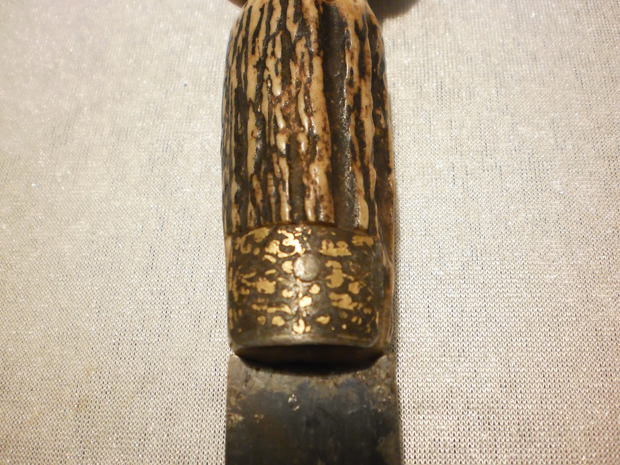

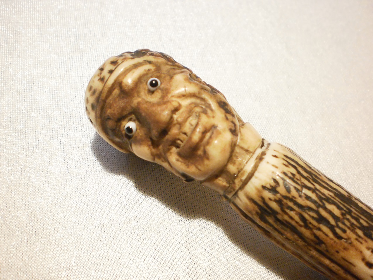

The stack hilt has the shape of a man with a hat which reminds me of a caucasian papakha. It is decorated with glass stones.
There are also iron mountings with gold Koftgari. The decor looks caucasian, too.
Length overall: 40cm
Without scabbard: 37cm
Blade: 26cm
Comments are welcome

More pictures:
Gonzoadler is offline   Reply With Quote

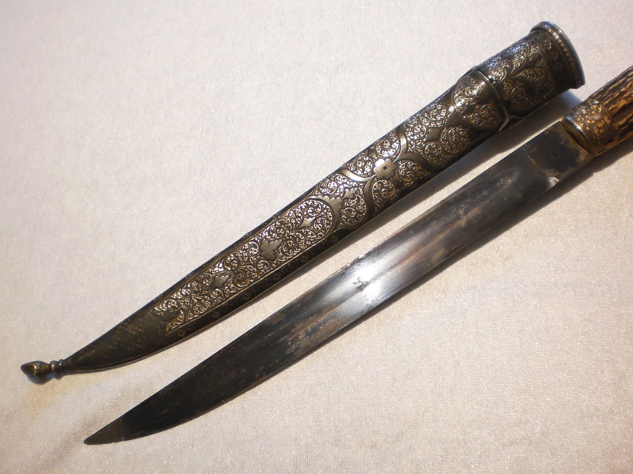

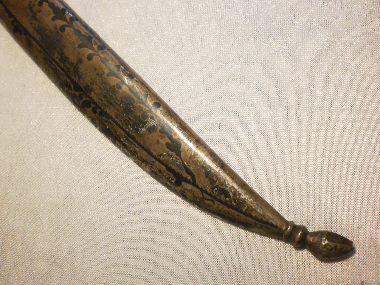

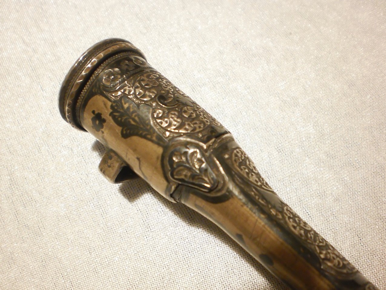

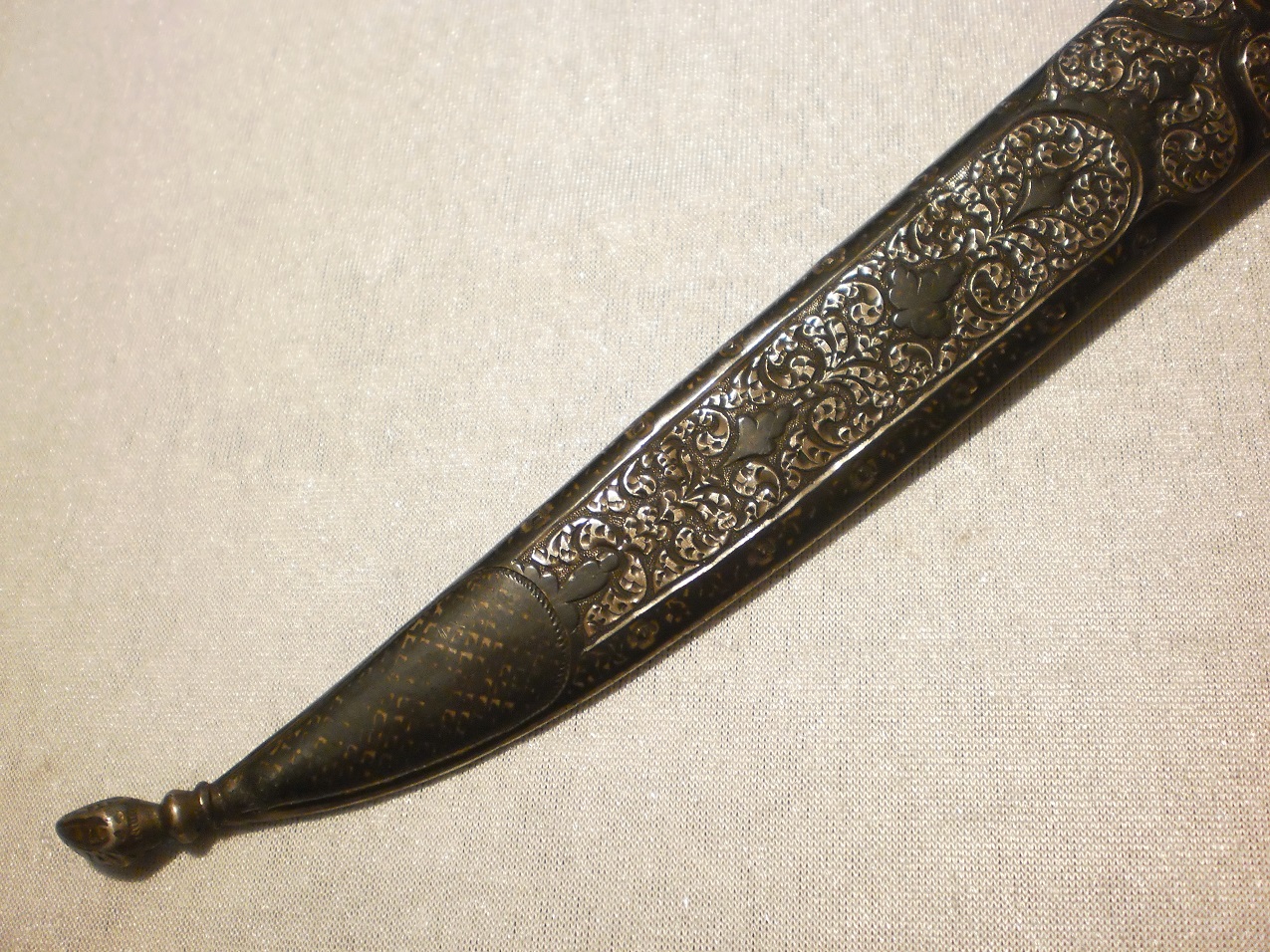

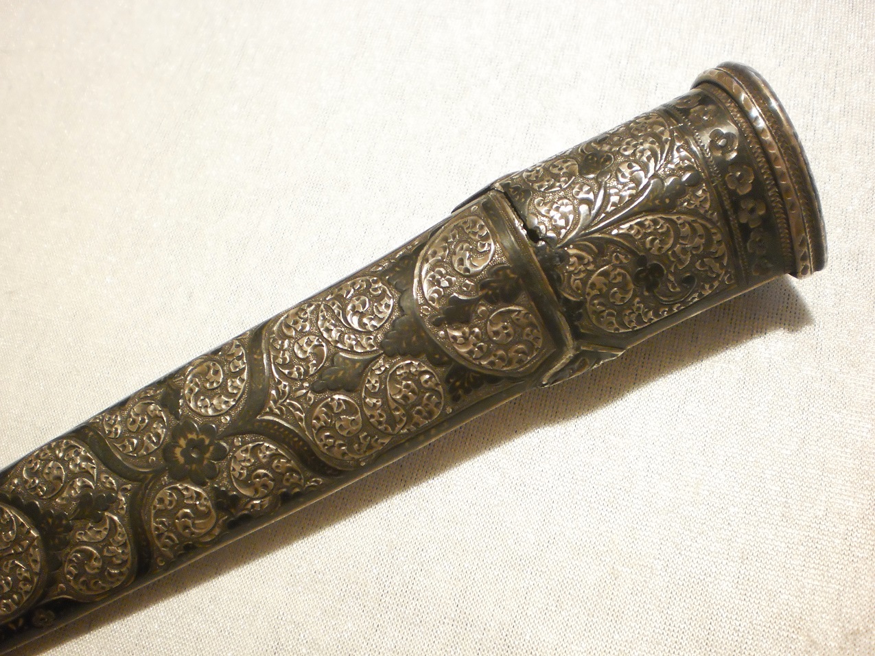

And some from the scabbard.
That's it.

The blade and scabbard are very nice, but the hilt is probably a walking stick handle.

This is Central Asia. End of the 19th century. By this time, Central Asia was annexed to the Russian Empire. Many people who lived in the Russian Empire moved to Central Asia. Including master jewelers from the Caucasus. In Bukhara and other cities, these master jewelers from the Caucasus began to make silver sheaths in the Caucasian style for the traditional knives of Central Asia: kard, bichaq and pesh-kabz.
Judging by the shape of the scabbard, they were made for the bichaq.

Thanks for your helpful comments. There are a lot of similar but not equal pieces from Central Asia, so I was'nt completely sure about that origin.
That the scabbard was made for a Bichaq could be more likely than for a Kard, but the examples from the old thread looking really plausible, too.
I think it is possible that the handle was made for a walking stick, don't know if such sticks were common in that region.
It would be great if anyone can show pieces which are partly similar.

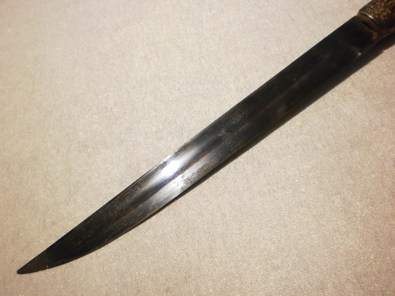

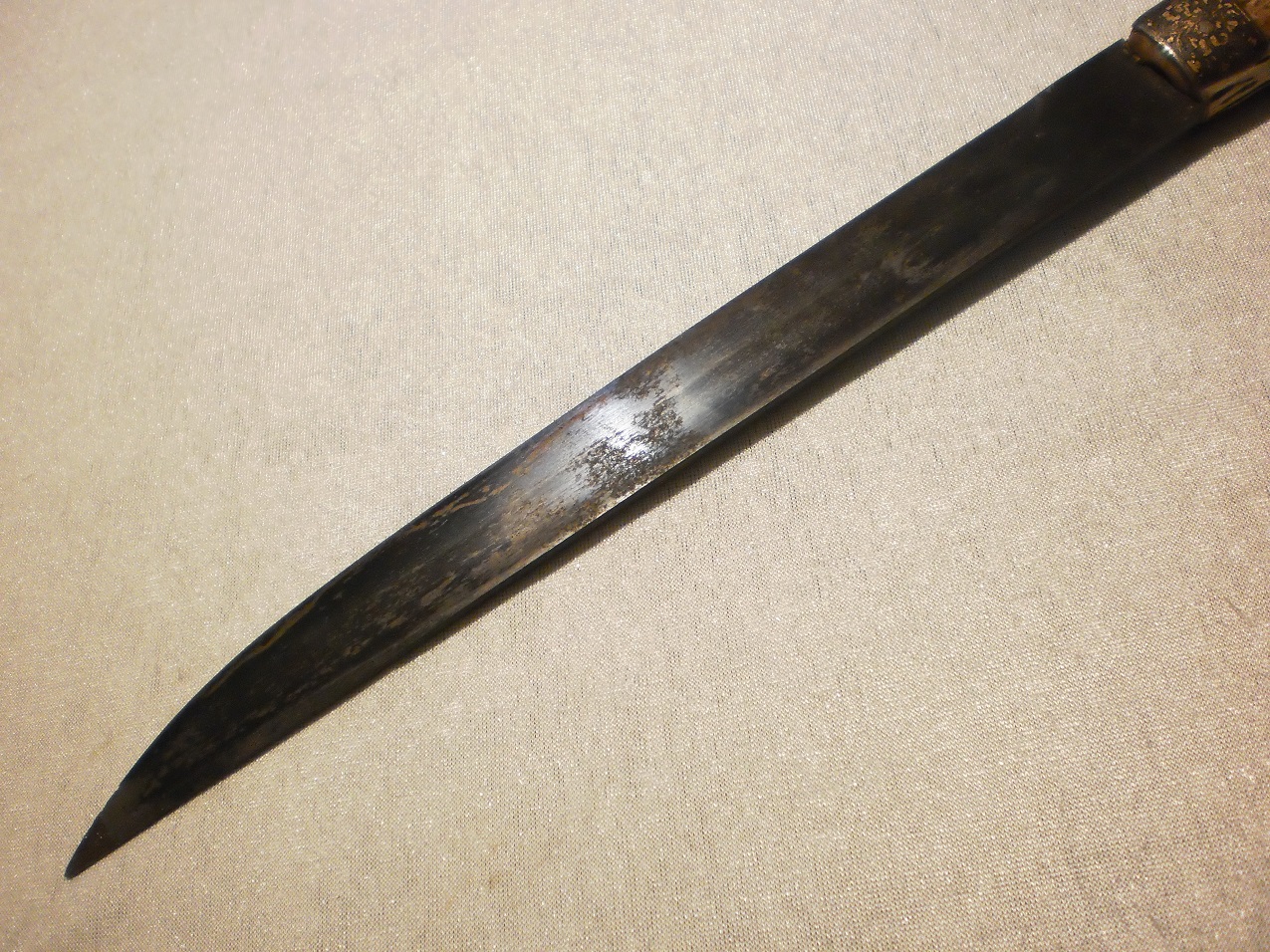

Either my eyes betray me, or there is something strange with the blade.
It has a blunt ricasso, so it could not have been shortened from that end.
But the fuller is very short and does not seem to run into the point, so even that end is original. Either it was indeed a saber blade ( Western, not Oriental), with a very short fuller ( in which case colleagues from the European section might be of help), or a bayonet(???).
You are correct, the chasing motifs are Caucasian, and the niello seems to point that way, but the end of the scabbard is tilted up ( Turkish?).
If the handle is from a walking stick, that would hint at other " foreign" parts.
I cannot find any traces of anything Central Asian.

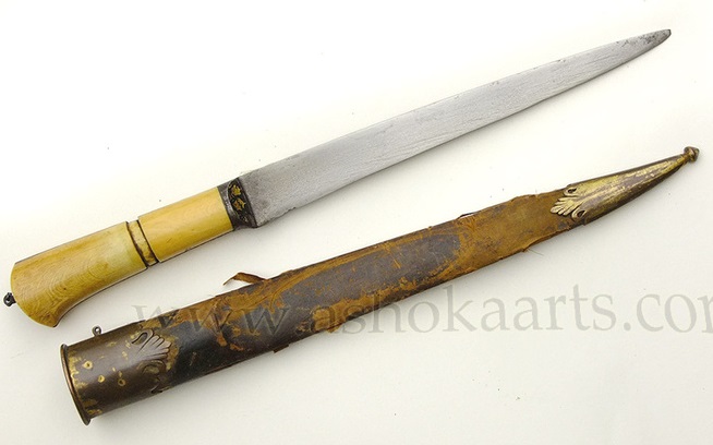

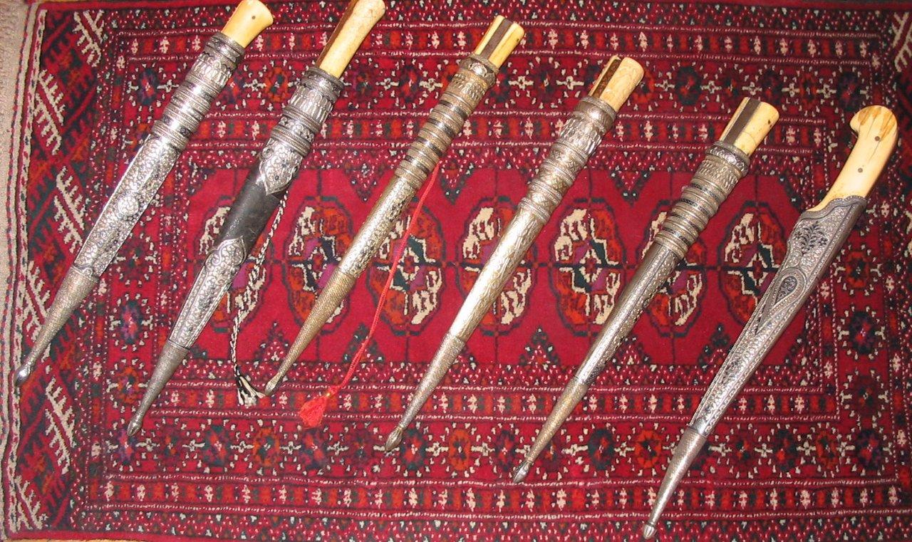

A few more knives from Central Asia in a similar scabard^
I cannot find a single one with a similar scabbard. Well, maybe the one on the left, but only because of the nielo.
Anyhow, this is a true "chimera" to me.
The scabbard looks Caucasian... I guess...
the blade looks European... I guess again...
and the hilt looks... I am out of guesses...
Correctly. Because there is not a single pchak in the photo. Only kards and karud.
But, in Caucasus, I cannot remember knives of such a shape that would fit this scabbard ... But in Central Asia there are such knives
By the way, I think from the knives that I showed in the photo against the background of the carpet, there is no question that their scabbard is from Central Asia?

I have a strange feeling about it.
The face is peculiar, Central Asia was and still is Islamic. Even drawings of human faces are frown upon, but this is a 3-dimensional sculpture. Usually ( Hungarian, Philippine, Mughal etc) face is turned toward the edge. Here it faces the spine. There is a rivet through golden koft decorations.
And why on Earth would anybody put a fragment of European regulation blade into a Caucasian / Turkish kard scabbard?
I usually try to find positive things to say. Here I find one strange feature after another.
Could it be a composition of unrelated parts?

I agree with ariel. My opinion is that the item is assembled from three parts (quite possibly a long time ago). The scabbard is undoubtedly made in Central Asia. The hilt and blade have nothing to do with Central Asia. I think аriel is right in suggesting that the handle could be part of the cane.
It would be ideal to match this very good sheath with an old Central Asian pichak knife.

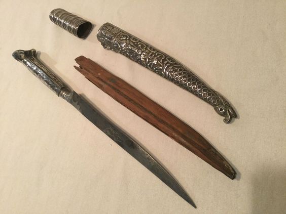

For me, this is an absolutely Ottoman scabbard made by a master from Dagestan. After the annexation of the territories of the North Caucasus to the Russian Empire in 1865 and before the start of the First World War, the Islamic population of the North Caucasus actively migrated to the Ottoman Empire. This migration was much more massive and prolonged than the migration to Central Asia and received the name "Caucasian muhajirism".
The narrow form of the scabbard and, especially, the absolutely Ottoman form of the end of the scabbard tell me that the Ottoman bichaq lived in them, and not the Central Asian pchak.
Saracen is offline   Reply With Quote
Old 8th March 2021, 01:05 AM   #25
Saracen
Saracen's Avatar
Join Date: Oct 2015
Posts: 147

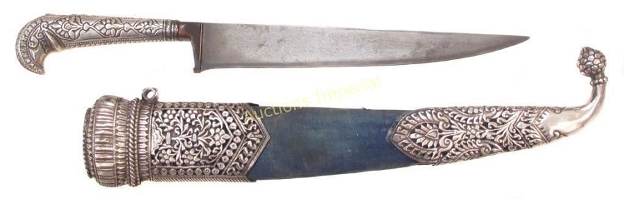

... or Ottoman Kard

It would be interesting to see a Ottoman knife in a scabbard of the same decor. Unfortunately, I am not aware of such samples. But, probably, Ariel and Saracen will demonstrate such items.
In the 1940s, in the republics of Soviet Central Asia did not make knives in silver sheaths. The tradition of making elements of national knives in Central Asia from silver ended at the end of the 1920s.
Of course the inscription is "strangely Caucasian". As I wrote earlier, similar scabbards in Central Asia were made by masters who moved from the Caucasus to Bukhara and Khiva.
I don't understand why these fantasies about the Meskhetian Turks are needed? Information that Caucasian jewelers worked in the late 19th - early 20th centuries in the khanates of Central Asia is in scientific sources. Information about the mythical "jewelers of the Meskhetian Turks" - Mr. Ariel's fantasies, which are not confirmed by any facts.

I wonder whether the origins of the peculiar throat of the scabbard might be found in the construction of local knives.
In the construction of the solid silver scabbards yataghan, Ottoman kard and bichaq. A removable the peculiar throat of the scabbard is needed to install wooden inserts in the scabbard.
It is not clear why post a photo of this Ottoman knife in the subject. His scabbard has no resemblance to the scabbard of the item in question ...
Old 9th March 2021, 07:14 AM   #30
I understand very well what Saracen has in mind.

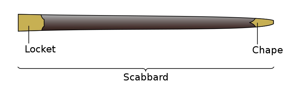

Saracen, the throat is called the locket and it is common in most of scabbards in the world.
These two Indian karuds have the same system and a curved tip/chape.
Problem, they are not Ottoman daggers!
