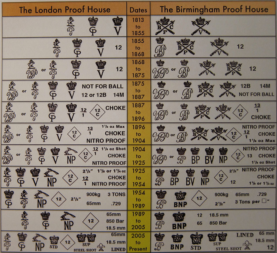

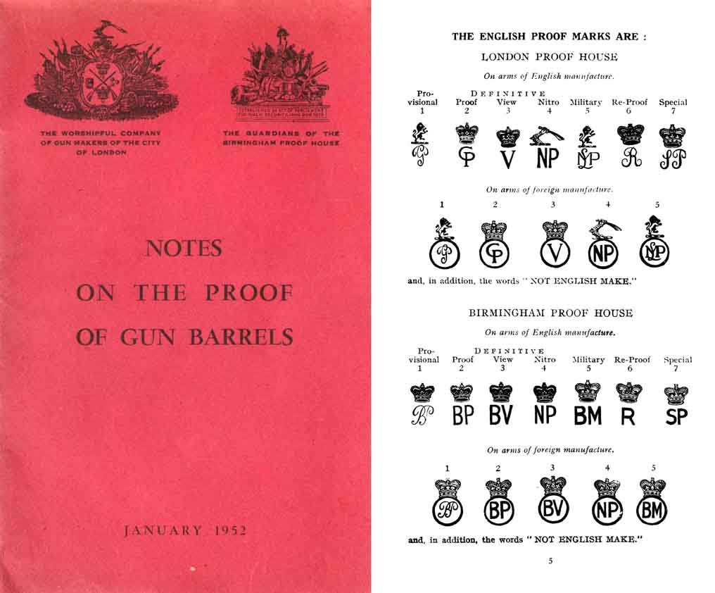

According to my British books of proofs, this Liege proof marks is still in use for black powder muzzle -loaders.
The book says "used since 1968" But!.. of course that does not mean it wasn't in use Prior to 1968!... just that it Continued in use later than..
If it has English view marks, it should also have an English proof mark.

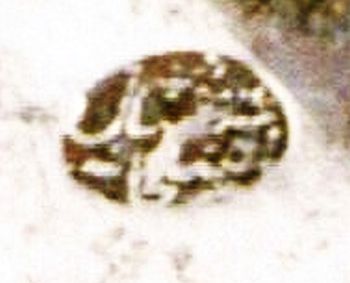

I ask if it is a V crowned, or a W crowned, because I have seen Belgian weapons with the W crowned, in the same place, the lock plate

Which brings us to Fernando K's question as to whether it is a V or W? The stamp isn't very clear. I guess it could be a W, meaning strictly a Belgian mark.

...I had a look at that mark and I'm almost 100% positive that it is a V and not a W under the crown. British private purchase, I'm assuming.

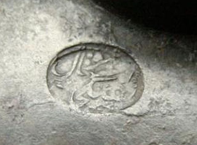

The second one I believe to have been manufactured by local tribesmen most probably in Afghanistan. The lock has a date 264 (1264) equating to 1848. The workmanship is not as precise as the Belgian example e.g. half cock will not hold but all in all a serviceable pistol.
Norman.

On my Liege pistol there is a crowned H and according to the proof mark list I attached a crowned letter was an inspection mark initiated in 1853.
As far as still producing flintlocks when better alternatives were available see http://www.vikingsword.com/vb/showth...ght=birmingham I would suggest there was still a market for basic firearms in many parts of the world in the second half of the 19thc.

In regards to private purchase, I have seen all manner of strange, one-off marks for these. I used to own a cutlass of the standard m1840 Brit pattern marked 'RN". The seller told me "Royal Navy"...don't think so! No other marking. I've seen a lot of m1803's with no marking whatsoever and listed as 'after-market' for private purchase frigates.
Thanks for those great pics of your pistols, Norman! The Arabic example was particularly interesting! Corrado's example was another fascinating piece from a Leige maker.

Old 6th February 2021, 05:06 AM   #28
Posts: 10,802
From Blackmore, "British Military Firearms", 1962,
"...but with the end of the war the demand for arms dropped dramatically. The Birmingham branch was the first to suffer. In 1814 the staff was halved and in the following year Miller, the Inspector of Small Arms returned to London. Finally in 1818, the premises at Birmingham were closed".
p.272
In Appendix D, p.280, the marks of private Birmingham proof houses are shwn 25-30.
#27 is a crowned V.
In the detail on Marks pistol (OP) the Liege mark is shown as an oval ELG over star. This was the mark used from 1810-1853 in Liege.
In 1812 England was not only at war with France on the Continent, but with the American colonies in the war of 1812. The demand for arms was considerable and delays with contractors caused issues for makers. As the navy, according to Blackmore, often got the run of the mill weapons,it would not be surprising that imported pistols from Liege might have been brought n viewed at the Birmingham location.
The barrel mark was in use at Liege in 1812. The crowned V was in use at Birmingham in that year and at least until 1814.
The markings on this pistol would seem to correspond to the period of its use being contemporary to the suggestions of use in War of 1812, as well as Napoleonic campaigns. It seems quite possible these might have found use on privateers, if not on ships of the line.

Old 6th February 2021, 01:07 PM   #30
Norman McCormick
Norman McCormick's Avatar
Posts: 1,653
Hi Jim,
The ELG and star in a cartouche was used from 1810 until the present. I have attached a copy of London and Birmingham proof marks from The Worshipful Company of Gunmakers of the City of London and The Guardians of the Birmingham Proof House. This shows that a crowned V is a London proof and not Birmingham and if the gun was foreign made the V would be circled with the crown on top. All the charts I can find relating to Liege state that a crowned letter is the inspection mark from 1853 to 1877. I have also attached another chart with more specific dating.
Hope you are keeping well in this time of uncertainty.
