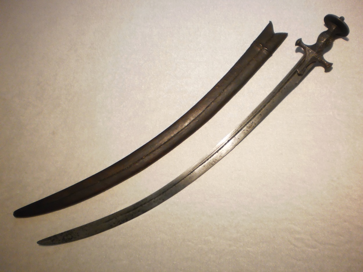

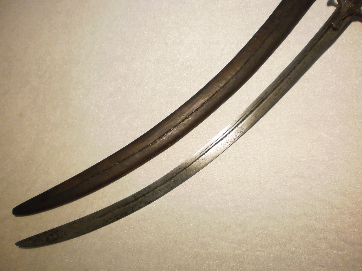

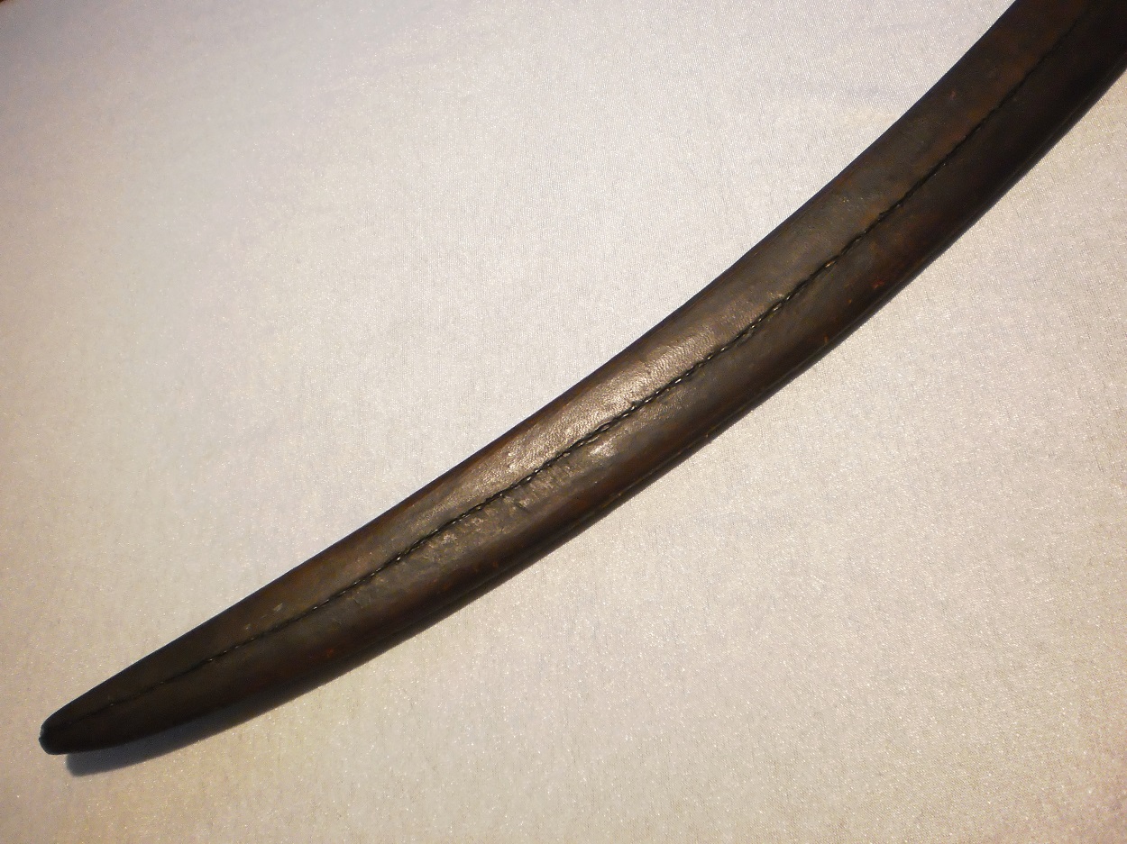

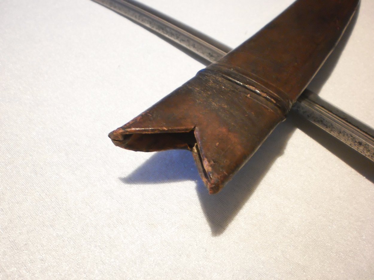

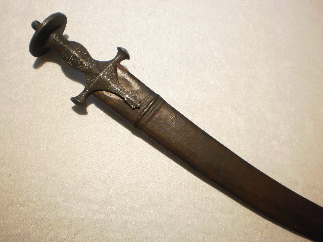

I have received this Tulwar. It has an iron handle, a blade made of normal steel and a leather coated wooden scabbard. On the handle you can see remains of a silver koftgari.
dimensions: total 86cm; without scabbard 84cm; blade 73cm
My knowledge about Indian art is not very extensive, so it is difficult for me to estimate the age. The scabbard is looking younger than the saber, blade and handle maybe belong together but were refixed later. But I think the handle could be also older than the blade, I'm not sure.
Now, I'm very interested in your opinions how old this Tulwar or it's parts could be. 18th, 19th or early 20th century?
complete with scabbard:

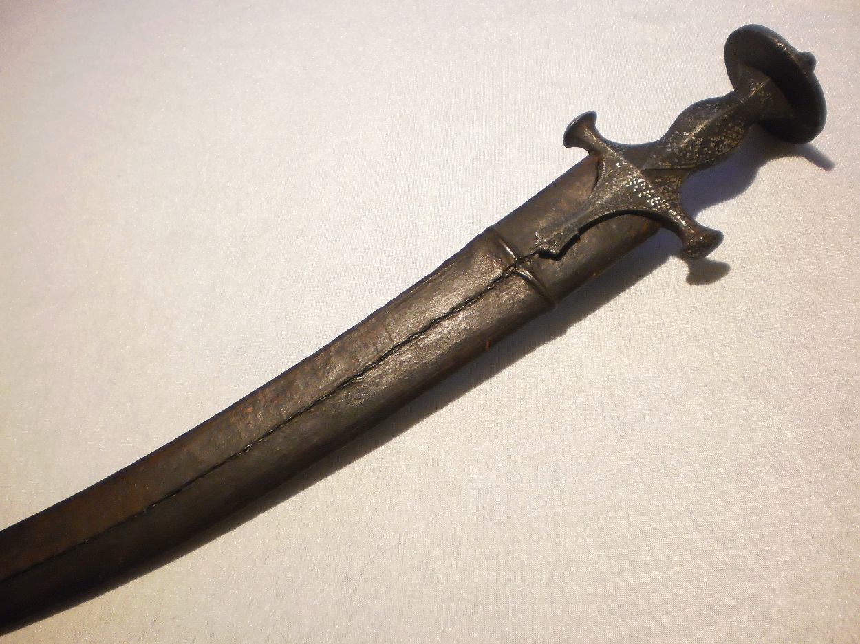

Old 29th January 2021, 08:00 AM   #2
Gonzoadler
Gonzoadler's Avatar
Join Date: Jun 2020
Location: Germany

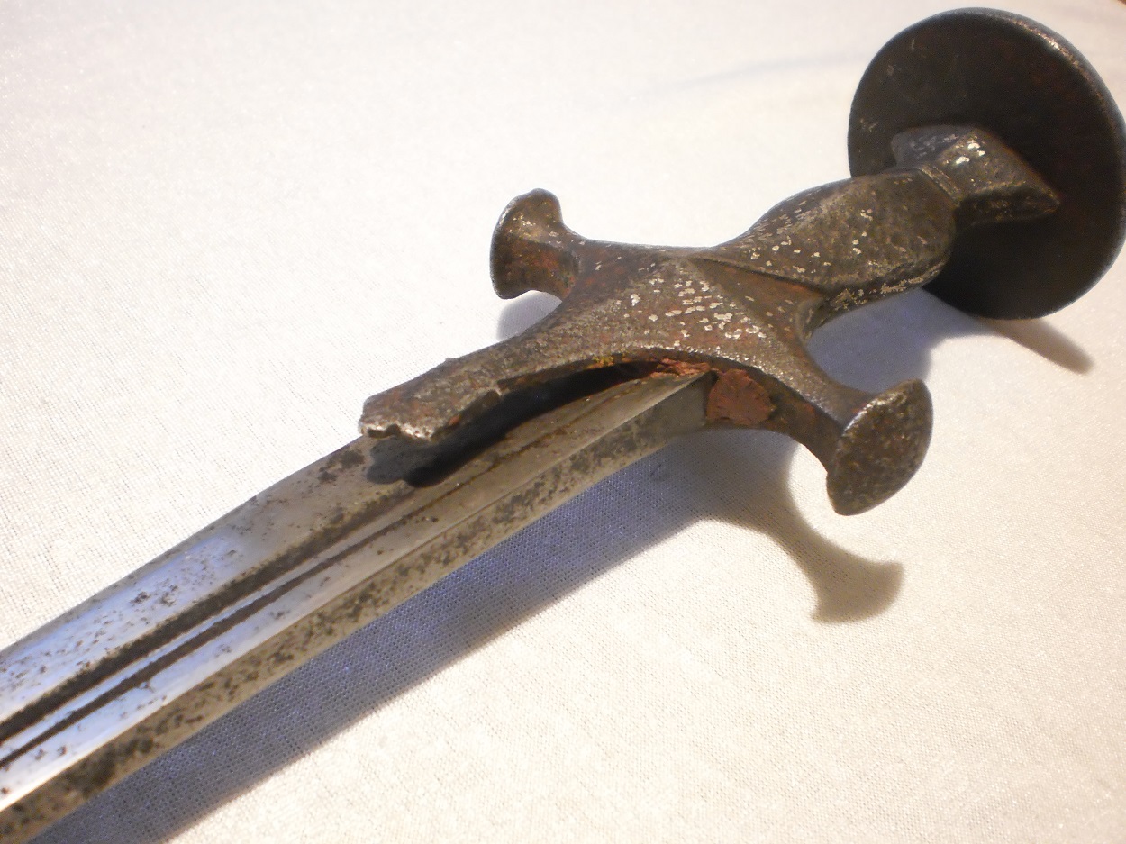

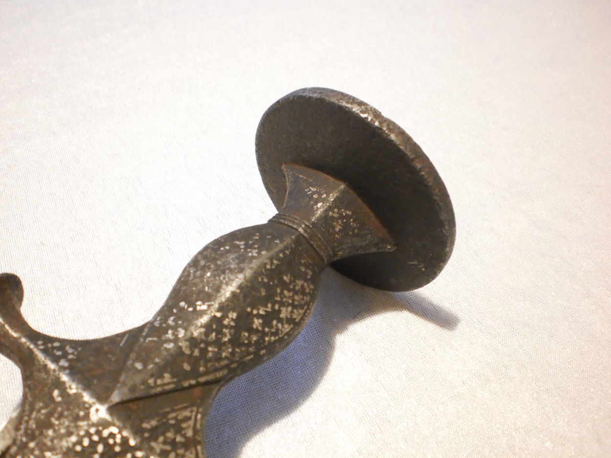

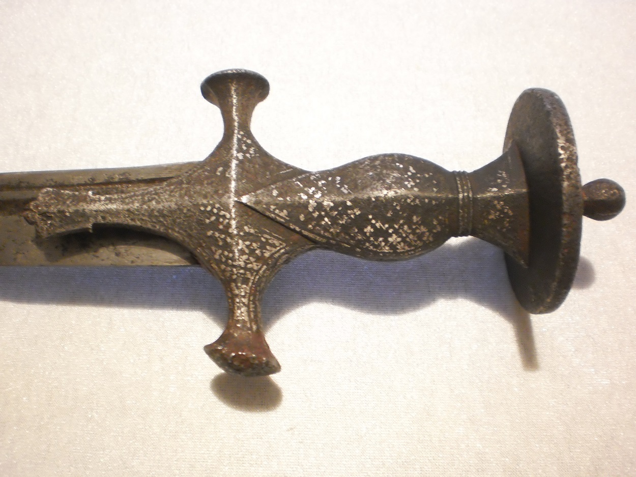

Posts: 274

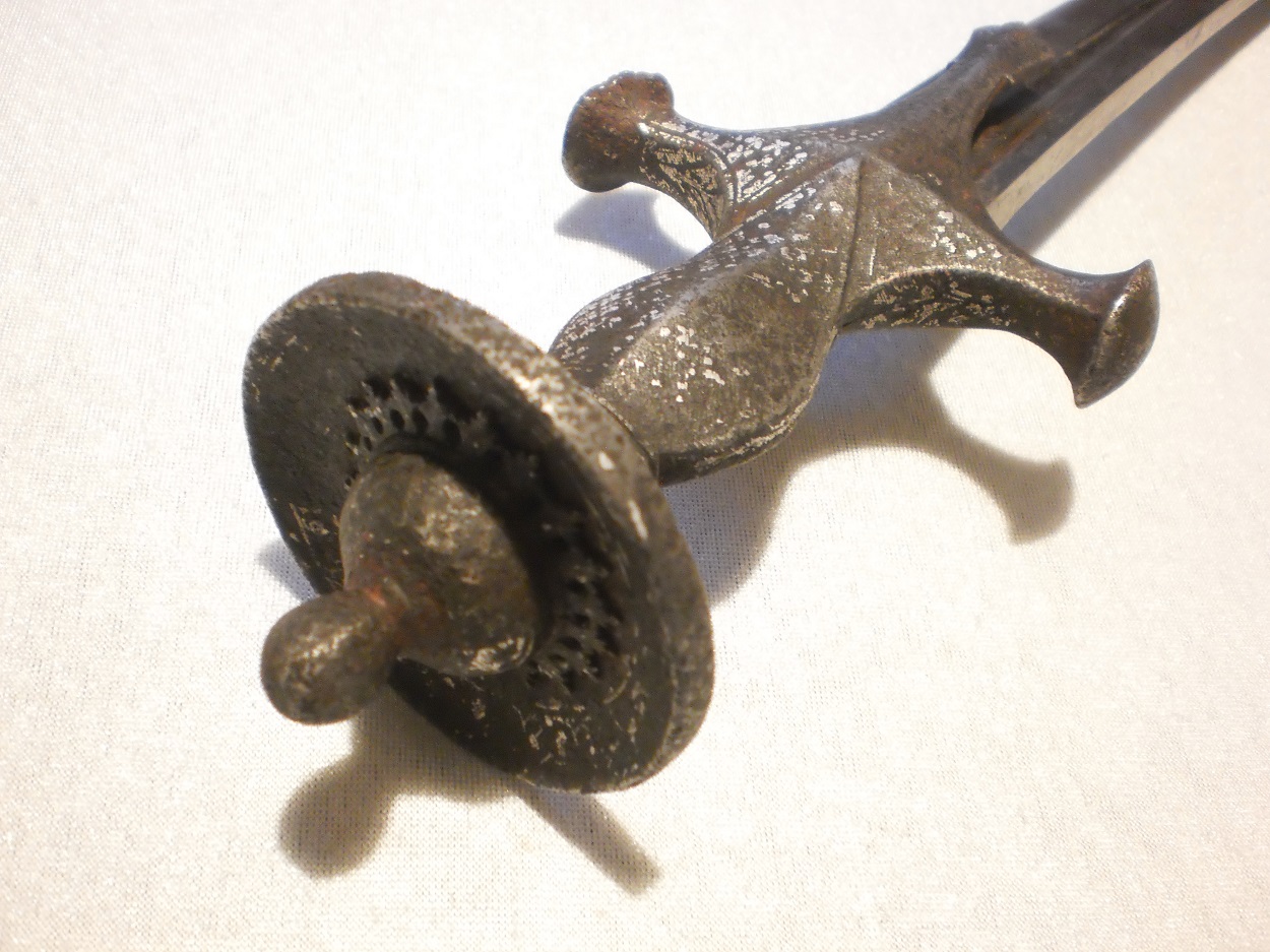

handle:
Gonzoadler is offline   Reply With Quote

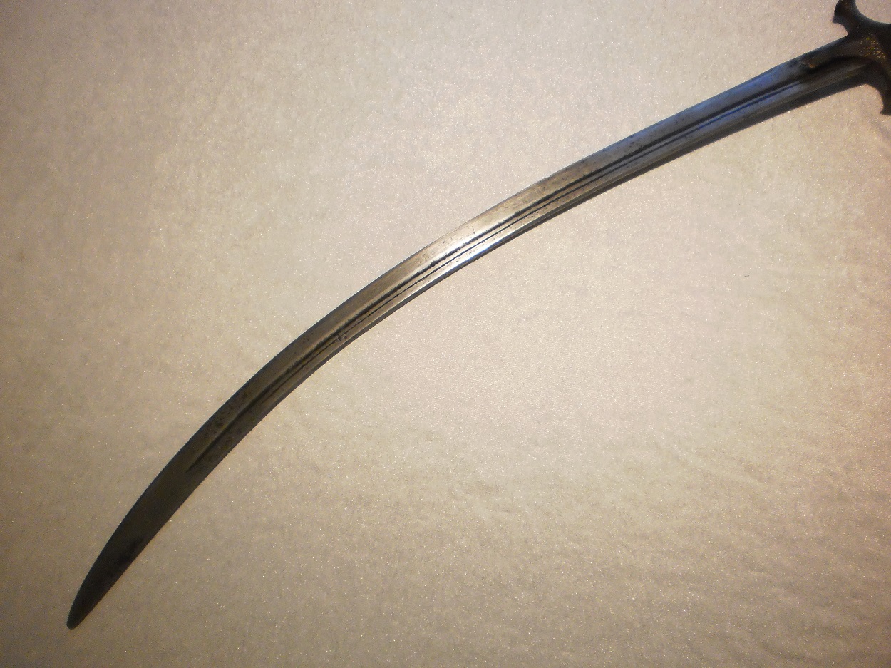

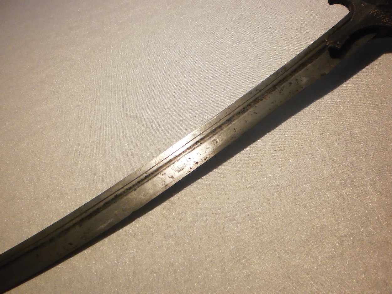

Old 29th January 2021, 08:02 AM   #3
Gonzoadler
Gonzoadler's Avatar
Join Date: Jun 2020
Location: Germany

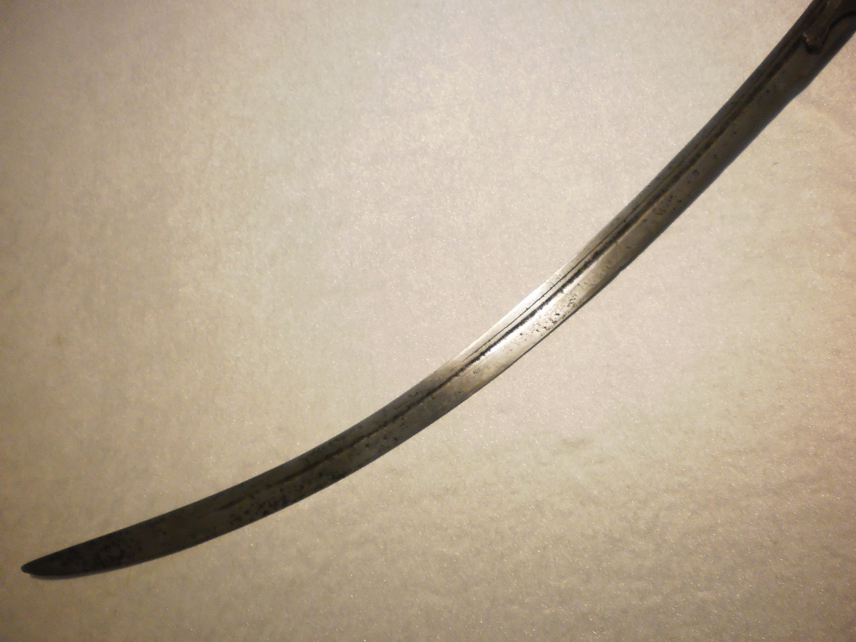

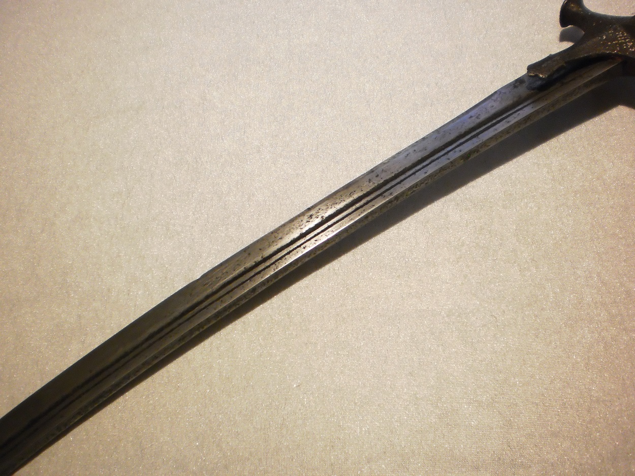

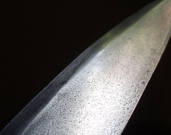

Posts: 274

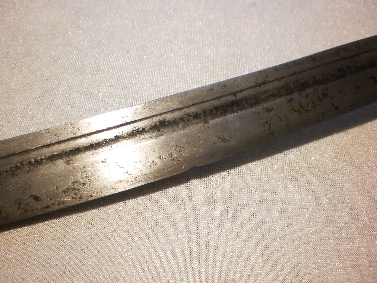

blade:
Old 29th January 2021, 10:06 AM   #4
mariusgmioc
mariusgmioc's Avatar
Location: Austria
Posts: 1,917
My guess would be around 1900.
Old 29th January 2021, 01:26 PM   #5
Come on Marius, this is a very good 19th c. tulwar!
Maybe the scabbard is from the 20th c.
I have no idea if the thick blade is from the 18th or the 19th...
But I wont be surprised if the blade is older, if you read Elgood you can see that 95% of the tulwars have replacement hilts.
The blade looks Indian but I might be wrong.
Old 29th January 2021, 02:14 PM   #6
mariusgmioc
Location: Austria
Posts: 1,917
18th century or earlier tulwars generally have thinner plain blades with no fullers.
This blade appears to be Indian but emulating the European blades.
Thus, I stand by my estimation of around 1900... or later.
Old 29th January 2021, 03:13 PM   #7
Pukka Bundook
Join Date: Jan 2007
Posts: 803
Marius,
We cannot generalise in this manner.
Tulwars have been made with fullered blades for centuries.
Also blade thickness has nothing to do with age, as tulwar blades were made wide and flat, and narrow and thick for centuries and each type has its own name.
A Halab is still a tulwar, but has the narrower but thicker blade, and was used throughout the 18th and 19th centuries.
In a country as large and diverse as India, there are vast variations in styles and shapes.
I know Nothing of tulwars compared to Jens, and others here, and my time is always So limited I have not done half the research I would like to, but this V nice tulwar appears to me Rajasthan, ...and the diaper pattern koftgari , I'd put it in the middle of the 19th century, or maybe a bit earlier.
I may be wrong :-)
Does Jens still post here?
In his beautiful book showing his collection, you can see Very many fullered and multi-fullered blades from the 17th 18th century....And multi-fullered katar blades from the 16th century.
Gonzo,
I would suggest you do a search on this forum;
Something like "19th century Tulwar, ( talwar) and see what shows up similar to yours.
All best to all!
Richard.
Old 29th January 2021, 03:19 PM   #8
Pukka Bundook
Join Date: Jan 2007
Posts: 803
Apologies, double post!
Old 29th January 2021, 05:14 PM   #9
Posts: 10,833
VERY well said Richard!
Trying to itemize swords of India, especially the tulwar, is pretty much futile and really does require a great deal of research and knowledge of India's history to attempt specific classifications with any degree of viability.
As pointed out, there were many variations and options which existed contemporarily and also as well noted, swords were almost consistently remounted, as common with many ethnographic swords.
The replacement of scabbards is pretty much standard, as the materials were generally less durable of course and did not last through the longer working lives of the blades.
Rajasthan is sort of like the 'Texas' of India, it is huge, and the many centers of sword making were in these regions of India. Here were typically the shops producing hilts as well, and these often went to other locations, where they were decorated in the locally favored fashion, for example to Lucknow where enameling was prevalent etc.
With this tulwar, it is of course safe to say it is 19th century as this is the time when these examples became popularly known through the British Raj.
There was still much activity in hilt making, as well as blade making along with importing of them.
The blade here appears to be Indian, most likely from Rajasthan, and I would say safely mid to latter 19th c. It is not of the styling of European saber blades earlier nor of contemporary 19th c. European forms, though it reflects influence.
The hilt is of a number of Rajasthani types but I think these open hilt with close in quillons were typically Mughal (though here I am probably generalizing). The reason I say that is that the Rajput and Sikh examples seem to have more substantial elements (knuckleguard, larger pommel dish) and less 'decoration' (again generalizng).
Obviously those comments are subject to the countless exceptions which exist in tulwars, which were diversely used over much of India for centuries.
PS
Gonzo I am inclined to agree with your excellent observation on the hilt, I think it is older than the blade (or at least not original to it) and seems to be more of the type I have usually regarded as 'court' or official type which typically have less substantial blades.
Old 29th January 2021, 05:42 PM   #10
Norman McCormick
Norman McCormick's Avatar
Posts: 1,655
The blades I have seen of this kind have been curved a bit more or less, but never to an extreme. The yelman can be more or less pronounced. They have no fuller or only a broad single one. They are all broad and heavy blades, and they are 17th or early 18th century blades.
Jens
Hi,
The above is a comment on the particular blade in these photographs. I have another late 18thC Tulwar which also has a thick and heavy blade without fullers.
Norman.

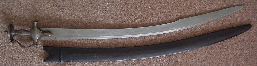

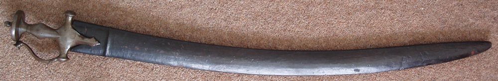

Old 29th January 2021, 06:15 PM   #11
mahratt
mahratt's Avatar
Join Date: Nov 2009
Location: Russia
Posts: 1,042
Late 19th century ordinary tulwar
Scabbard - early 20th century

The silver inlay which appears to remain on this hilt suggests a style of inlay which was created in the Bidri regions of Rajasthan. The style was widely copied and diffused to the point some arms were classified 'Bidri'.
