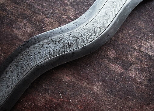

When I etch for pattern with FECL I keep the solution moving constantly with a brush .
Oxygenation makes the stuff work better I have found .
Also if you're trying to bring up a particular area such as the midline pattern on a kris using a Q tip will keep the etchant pretty much confined to where you want it to go .
That is how I enhanced the center pattern on this blade .

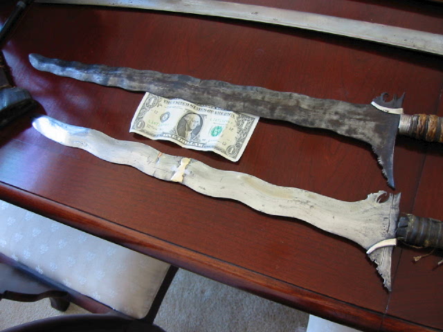

Here are some before and after pics of my kris and what a few days of MAAS and some elbow grease do. It's not a true before and after becase it's the other side, but the sides were in similar condition. Actually the "after" side looked worse before I started on it.
This is the "before" side:

And here is the "after" side. You can see not only is there the brazing that left the scorch marks, but there was another, smaller, "repair" done above that with copper rather than brass.
donutsrule is offline   Reply With Quote

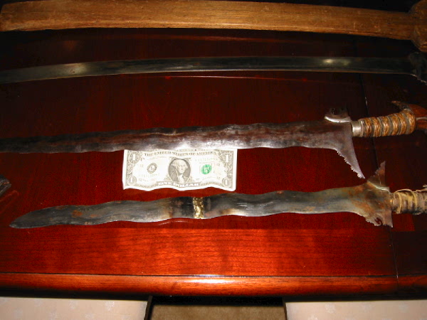

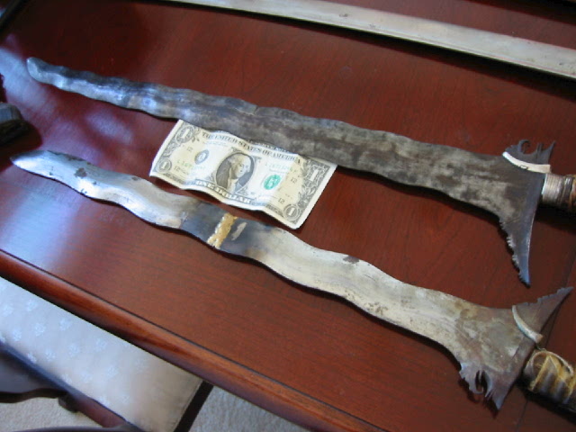

Absolutely not. It was [afaik] a WWII bring-back I purchased off Ebay like that. I don't know when it was ... "repaired."
Edit: here's another pic that shows the pretty nasty condition it was/is in when I got it.

There is the possibility that the braze job was done by locals. It is not unheard of, for kris and other Moro swords to be damaged and then repaired with a metal with a lower melt point, such as brass or copper. If it were an American braze job, I would expect to see a more common welding rod for steel used, rather than brass.
Anyways, one of the after effects that is visible of the before and after of using Maas is the loss of pattern. It is visible in the before pic, but by the after it becomes faint. Realistically, this happens whenever one sands a blade, but if one is not planning on re-etching it can be a loss that will never return. However, one note about etching, it can remove rust. I tend to use an initial lemon juice etch to remove any cached on rust, and get a good look at what Im dealing with before taking further action. So if you plan on etching, I would go ahead do one cleaning etch, before sanding away. You may be surprised how well it turns out after just one etch.
