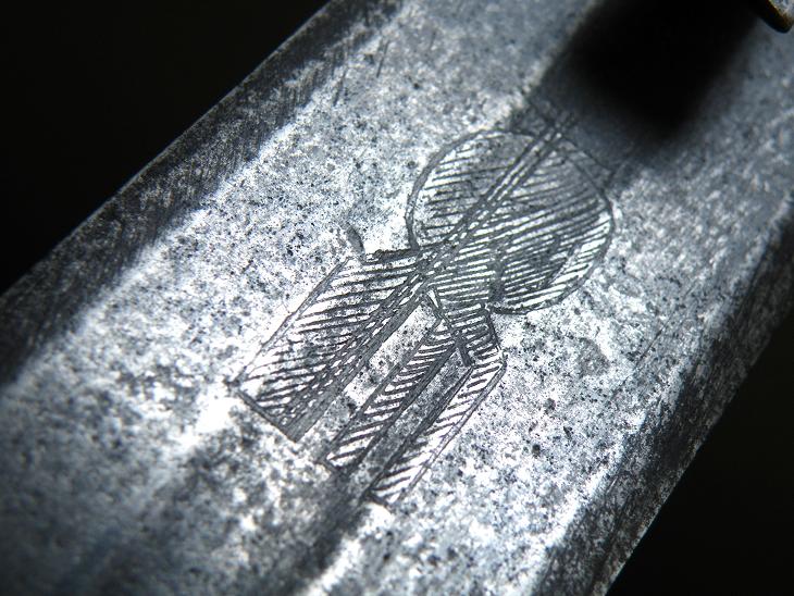

There is the same worn engraving on both sides of the blade. Does anyone have any idea what the engraving means??

Please refer to page 11 of Dr. Edward Hunley's kaskara monograph to see a similar engraved mark. As to whether this came with a European-made trade blade centuries ago or suggests a previous 'life' for this blade as a kaskara I am fearful.
Old 30th October 2020, 02:54 AM   #3
Posts: 10,862
I am totally in accord with Lee's observations.
This marking is one that seems to be appropriately called 'the enigma' and is described in Briggs (1965) as having been found on Tuareg swords during the Kaocen revolt in N. Niger 1916-17 .
It has remained unclear whether these were imitating certain European makers marks seen on trade blades, or whether it had some symbolic value in the tribal folk religions.
Regardless, it seems to have occurred as well on kaskara of the period as well in some degree.

Cross hatching on the engraving has been used to give gilt something more to adhere to.

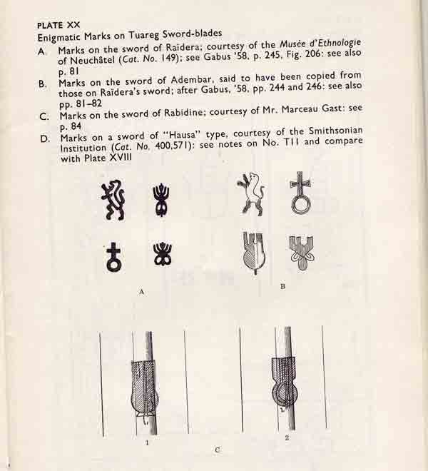

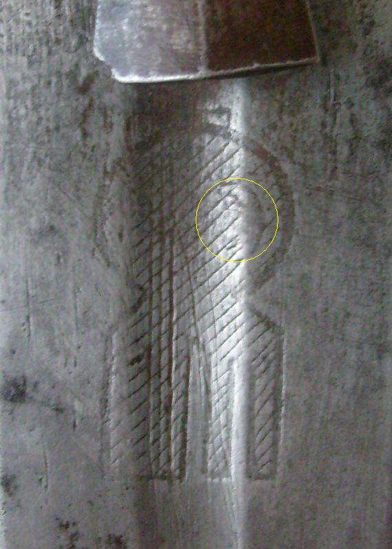

This engraved mark is just that, an engraved design which back in 2009, an effort was made to associate this with a comet in Sudanese religious lore.
The mark was never meant to be 'gilt', in which cross hatching (as in the application of precious metal was pounded into the furrows) was termed koftgari.
These marks seem consistent with the 'shaded' sections of the device.
Attached are photos of kaskara blades with the mark, and Briggs' analysis from "European blades in Tuareg swords and Daggers" (JAAS, 1965).

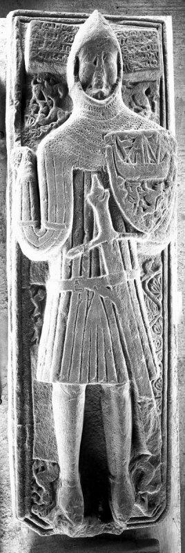

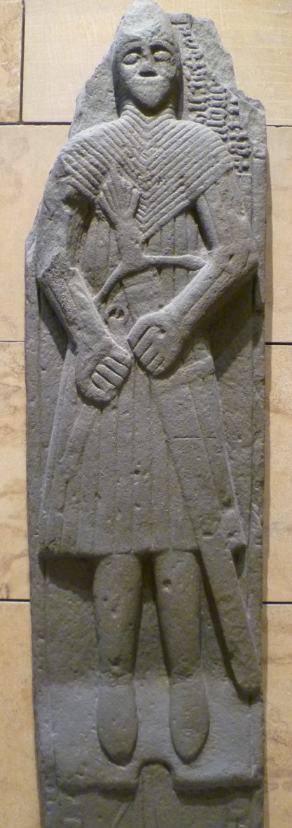

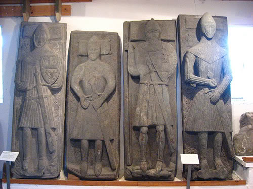

I can't say anything about the blade, but I am afraid the hilt is definitely replica, or to be more blunt, fake. The pommel is a brazil-nut shape, used in the 12th century in Germany and N. Europe but not in Scotland. The guard is of a 14th-15th century style very common in Scotland at this period. Exact representations can be seen on the famous West Highland gravestones, both in situ around the village churches in Argyll and the islands and also in museums. I dare say that is where the maker of your sword got his inspiration from.

Good call Neil!
That is the hilt style I was thinking of, and occurred on the Scottish broadsword seen on the tomb effigies as well as on the large two hander 'claymores' as well.
The 'brazil nut' was as you point out , not part of this hilt form in Scottish context of these periods.
