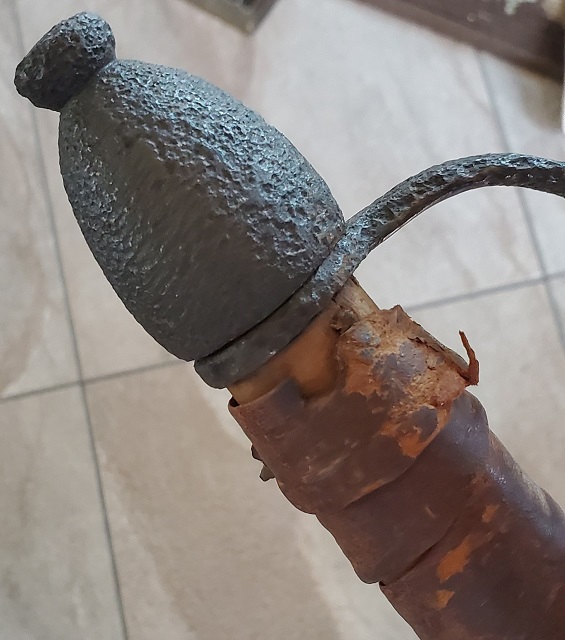

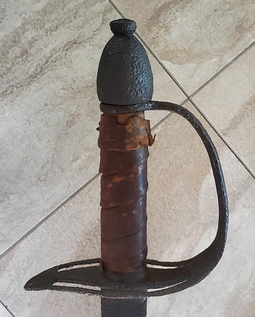

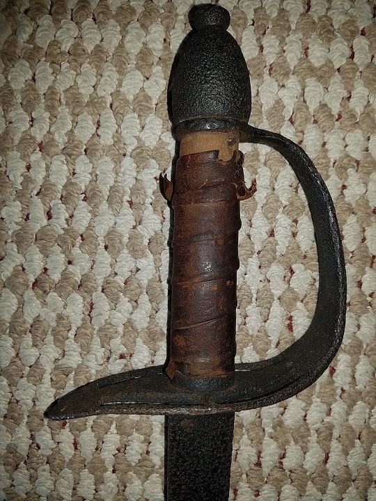

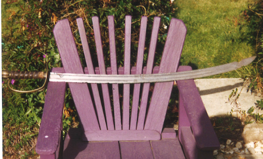

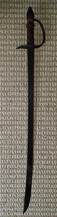

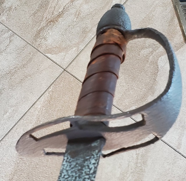

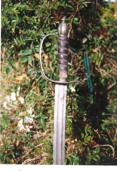

This sword is a 'dragoon' sword of mid 18th century in intact but heavily pitted and patinated condition. It is unusual to see leather grip wrap still intact but then it has been static since 1970s at least.
The straight blade with slight curve has clipped point popular on German blades of the time. The hilt is of the 'four slot' type which seems to have begun around 1760 and lasted into 1780s.
From research I believe this type sword with straight (or nominally so) blade was a type favored by 15th Light Dragoons. Typically British dragoon units were more 'heavy cavalry' and favored heavier basket type hilts, so this was quite unusual as noted, for light dragoons.
Cavalry of the 18th century was going through changes, and while the dragoons typically dismounted and fought as infantry on foot, these became known as heavy cavalry as combat called for remaining mounted with the light dragoon.

Wayne, thank you so much for responding! I can always count on you, and thank you for linking that apparently French slotted guard brass hilt of Revolutionary War period. Naturally the French were keenly involved as our allies so the presence of French weapons was quite notable.
There was a tremendous push for ersatz weaponry in which very much a remarkable spectrum of arms from many European countries was present.

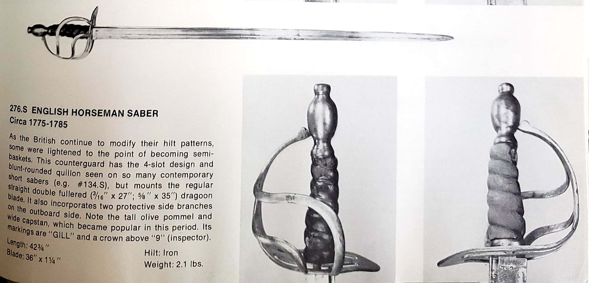

This is why "Swords and Blades of the American Revolution" (Neumann, 1973) is such an important 'general' reference for all types of swords of this period.
I got this sword in London about 1978 (I think), and have always admired its profoundly aged appearance, old and solid. I must confess I am very much more historian than collector, so my perspectives of appearance and condition are quite different. One of the reasons I was able to find and acquire examples which were historically important is that they were in condition scoffed at by most collectors, and I could get them despite my meager budget.
For me, I knew that these pieces had not been tampered with, so the 'history' remained in situ without compromise.
What I liked most on this sword is that through the years I discovered how unique a style it was, and as noted, one of the earliest units of 'light dragoons' favored the style, which I believe was sort of a prototype of the four slot guard. I would presume this sword to have come from Birmingham in about late 1750s into 1760s, and German blades were prevalent then to the sword furbishers active. There were remarkably few British blade makers at this time so that was common practice.
While the appearance of my sword will not be changing, I am hoping to get my notes together to regain some of the material regarding the use of similar forms by the 15th Light Dragoons (it seems like Robson, 1975 might have had some).
In the meantime would really like to hear if anyone has seen similar examples of four slot guards with straight clipped point blades.

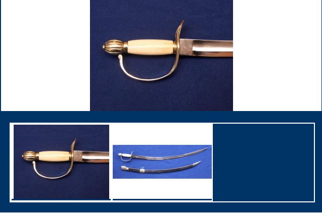

Jim if you haven't seen this sword MDL has it currently listed but it's not a slotted hilt but is a 15 LD sword
https://www.michaeldlong.com/product...-sword-c-1763/

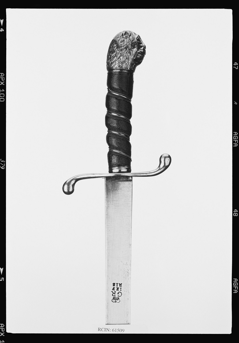

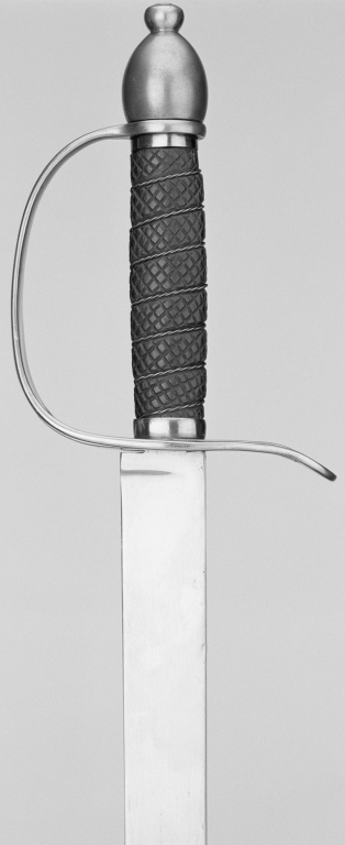

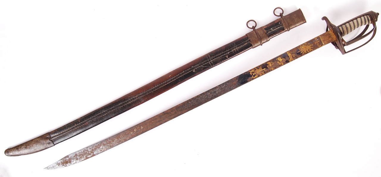

Here is a photo of the "Elliot's Dragoons" officer's lion headed sword from the Royal Collection Trust you mentioned and a copy of the entry in the Carlton House Catalogue where it is described.

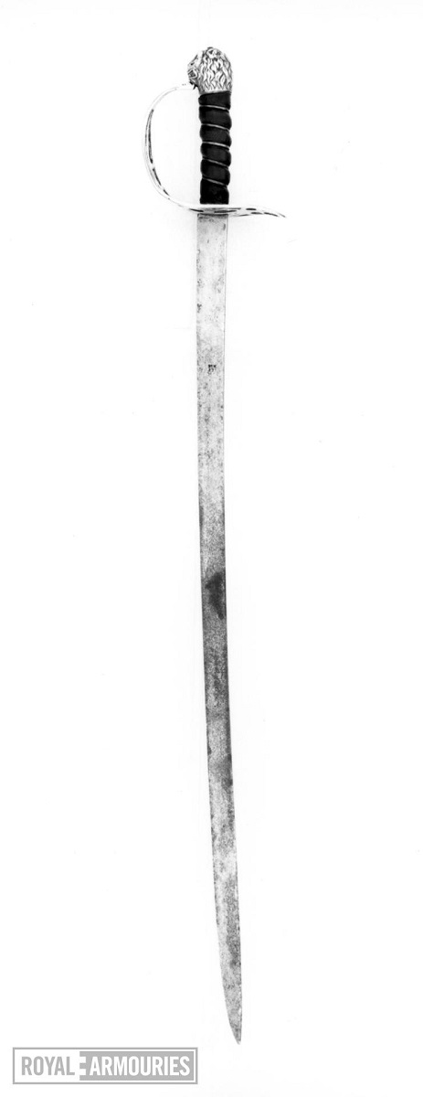

Here is another from the Royal Armouries collection, which by repute belonged to an officer of the 16th LD.
Cheers,
Bryce

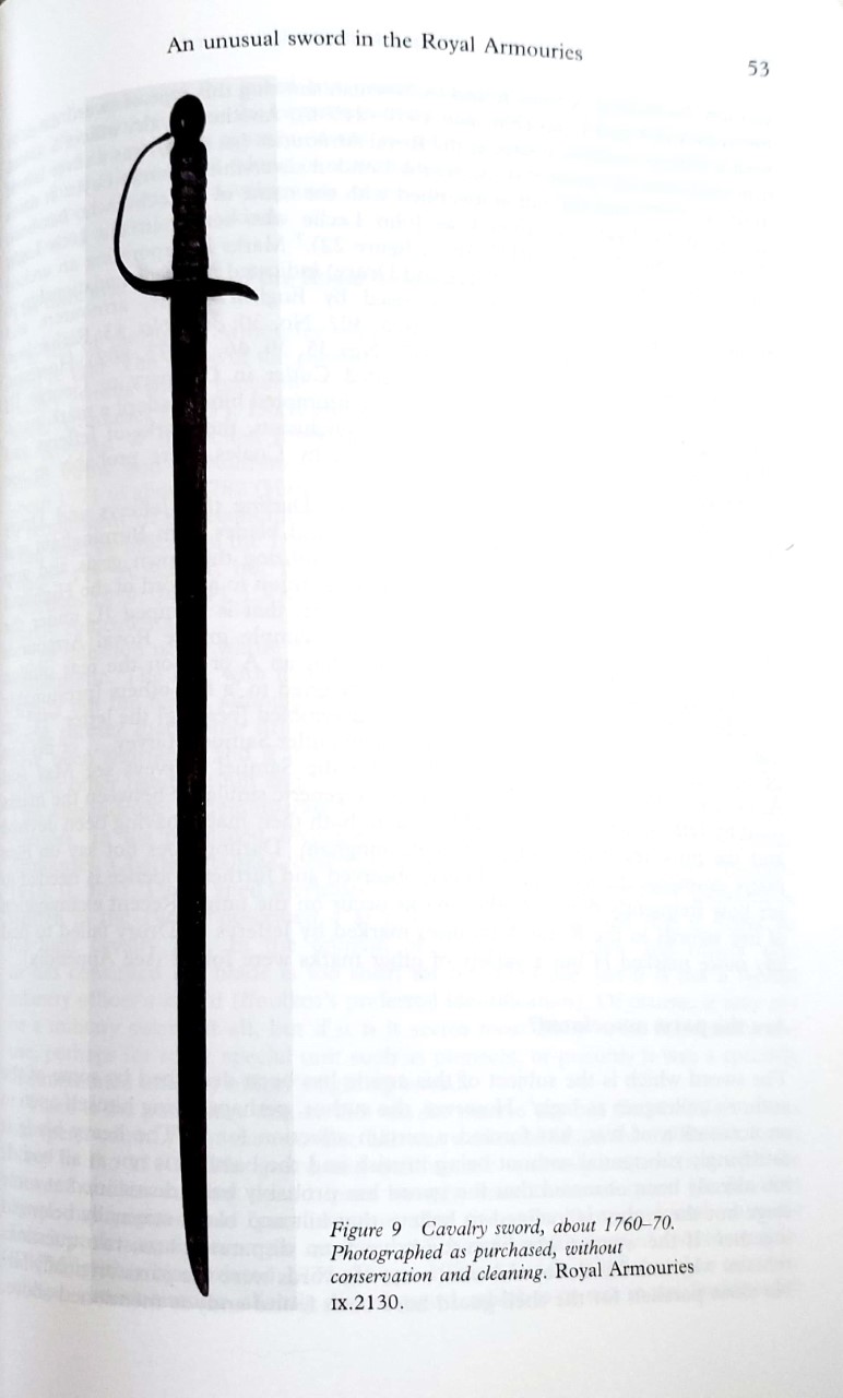

In the article by Philip Lankester (Royal Armouries, op. cit.2004) he notes the sword which is virtually the same as my example (OP) in fig. 9, p.53.
It is noted that Jeffries supplied 3500 broad swords with iron basket hilts to the Board of Ordnance and discusses his characteristic markings IEF/RIS under GR and crown.
It is noted that this same mark was used on cavalry swords for 'other ranks' .
Here it says that 140 of a single 'pattern' are displayed at 'Guardroom' at Belvoir Castle, Leicesatershire and that the Royal Armouries has a single example of the same 'pattern'(ix2130) puchased in 1981.
"...the blade is 36.5" long and almost straight and the iron hilts have a knuckle-guard which widens slightly to form a slotted guard in front of the hand".
Further, '..it is not known which regiment or regiments used this 'pattern'."

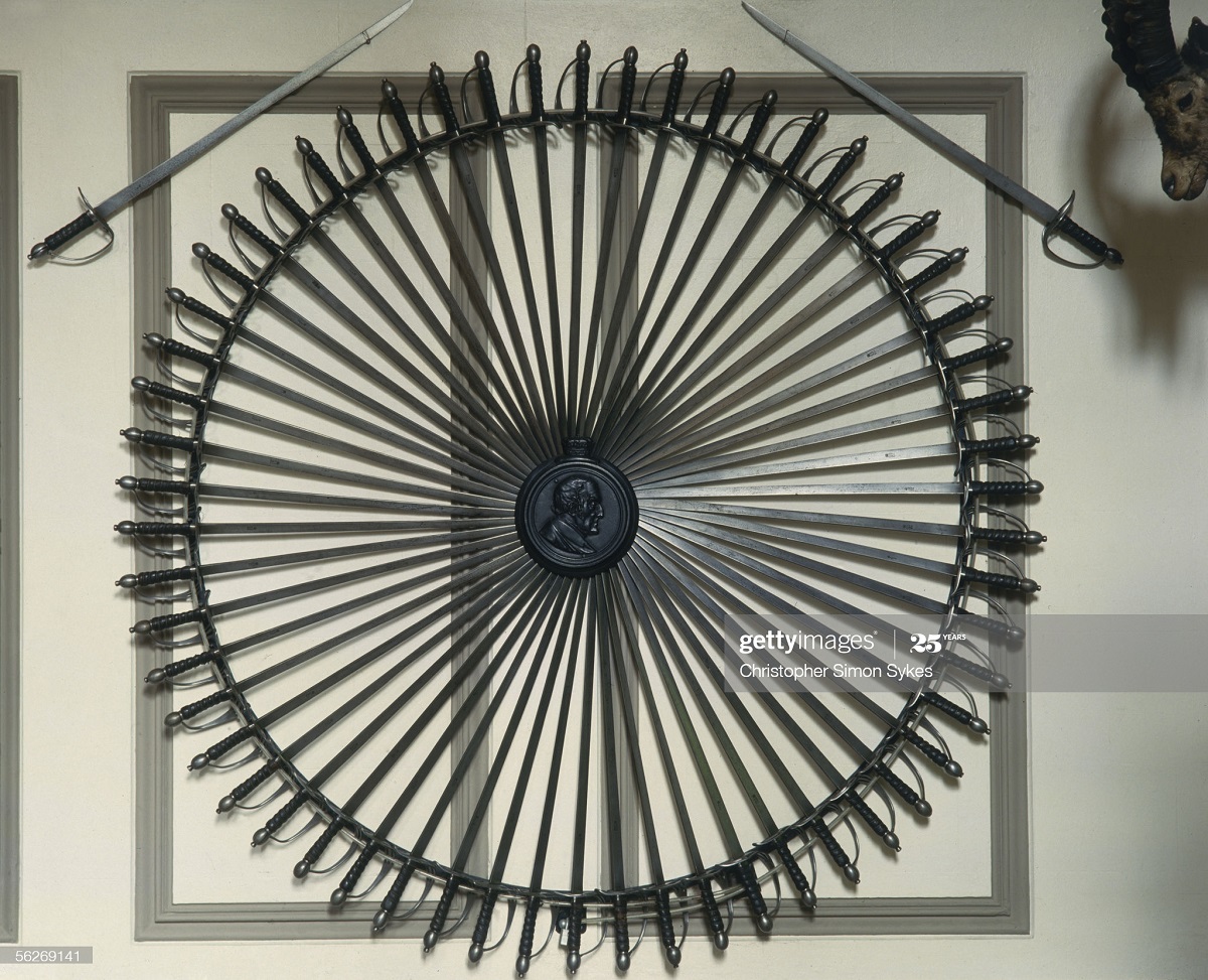

I came across a photo of the swords displayed at Belvoir Castle. Given that it is the ancestral home of the Dukes of Rutland and that this family raised the 21st Light Dragoons in 1760, it is likely that these swords were for that regiment. The 21st LD's were disbanded in 1763 and this may explain why there are so many still present in the castle. These swords all have straight blades that taper down to an asymmetrical point, unlike your own clipped point example.
Cheers,
Bryce
PS I just noticed the difference in pommel and guard attachment between these swords and your own. As you said this may mean yours is later than 1760.
Bryce is offline   Reply With Quote

Wow Bryce, I had not noticed this..........mine has the ring around base of pommel......kinda looks Scottish? Is that not like placed on basket hilts?
The others all seem to go into aperture in pommel.
What pushes me toward post 1760 is the pommel shape, and the slotted guard with this clipped point blade. That pommel ring just threw me a curve.

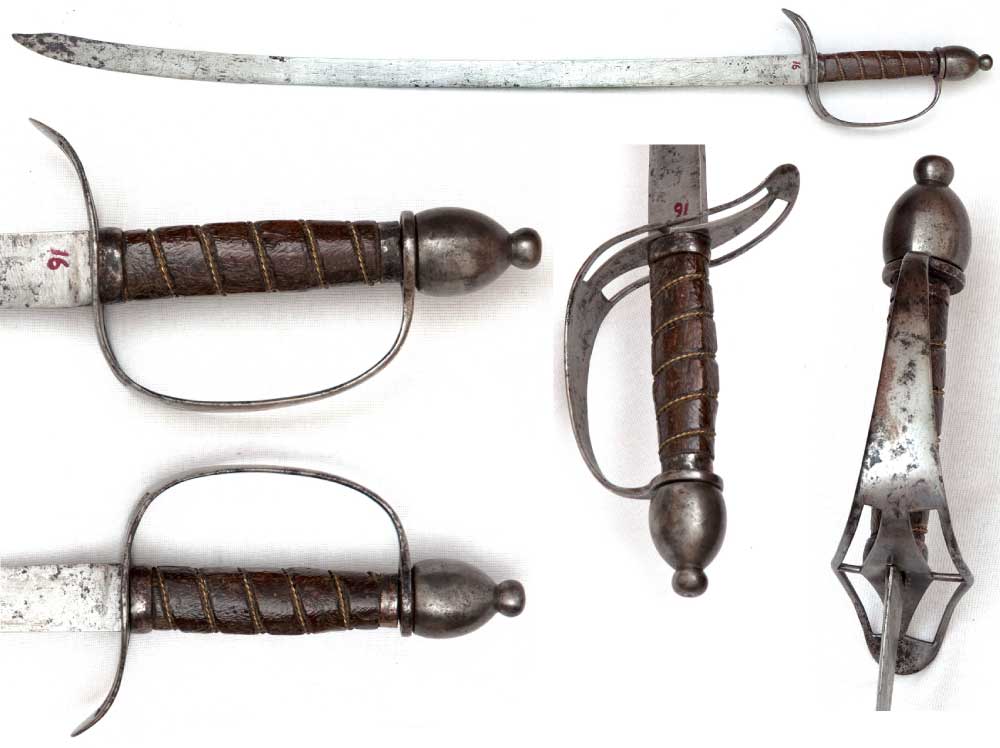

Here is another like yours I found on the web.

This looks almost identical! Is it identified?

Here is one in the Royal Collection. Unfortunately it isn't marked and hasn't been further identified. We need to find one marked with a British maker to clear this up.
Cheers,
Bryce

I thought it would be helpful to add some illustrations from Neumann, "Swords and Blades of the American Revolution" , 1973.
We now are reasonably certain that the 15th light dragoons, the first of the new regiments begun in 1759 were using a unique type of sword, the recurved guard form previously discussed.
The next two regiments were the 16th and 17th.
The 18th, 19th, 20th and 21st were in place by 1760.
It seems that a simple hilt, with 'four slot' guard was used by some of these units, with the 16th and 17th most likely and the tall olive pommel appears regularly associated with these hilts. The blades were essentially straight, slight curve, and 34" to 37". (279.S).
Note 282.S , the lionhead with recurved quillon , the blade is notably with clipped tip, the date noted suggests as early as 1759, the origin of the light dragoon units.
Note 280.S another light dragoon sword included in the mysterious 1759 to 1770 grouping, but this one has the pommel 'ring' feature as seen on my example.
The 'test' in 1756 for light dragoons used a brass, heart shape hilt (sim. to 1751 hangers) ...and this sword appears to have heart shape (also with quillon) but openwork rather than solid, two branches added and above all...note the pommel ring.
Post #16 shows a light dragoon like mine, with pommel ring, but is not identified. There appears to be a 16 on the blade at forte.
Is it possible this was a light dragoon to 16th (perhaps 17th) as with the swords produced 1759-into 60s for these units ?
The ring pommel as I had mentioned earlier, was of form used in basket hilts (1750s) as well as the dragoon sword (280.S).
So this put my example in the early forms of light dragoon, 1760s?
The clipped point seems around earlier as well (the lionhead, 15th? 282.S)
By the 1770s, the 16th still using the clipped point, four slot..........see image of a trooper where clipped point visible (these paintings are keen on detail).
So Nathaniel Potter in New York City in 1778 is making his famed 'POTTER' swords , BASED on British light dragoon swords in use.
It looks remarkably like my example but with globular pommel, no ring guard and much heavier.

My example of OP,
The blade is 33" with clipped point.
The hilt is 7" from guard to top of capstan
Four slot guard, tall olive pommel and the pommel ring holding guard.

Found some photos of a dragoon in my collection that fits this thread.
Brass hilt, slotted guard, the knucklebow engraved with a rack(?) number. Original sharkskin grip bound with a single wire rope. Some damage to the grip right above the lower ferrule.
In the overall photo this looks proportioned like a hanger, but it's no hanger! The blade is 34" long, about 1.5" wide, and the hilt is 8" from grip base to capstan.

By coincidence, the film 'The Patriot' was playing the other day, I looked carefully at the bad guy's sword. Col. Tavington and his dragoons were loosely based on Col. Banastre Tarllton, who was NOT the demon portrayed in the film (the murder of civilans in the church, etc. never happened). Hard to believe it was released 20 years ago.
If you look carefully at Tavington's sword you can see it is indeed a 4 slot cylindrical grip curved sabre like the one being discussed here, though presumably an officers model as the grip is ivory*. I managed to track down the company that made the sword, royal swordsmiths here in the UK, photo attached. Oil painting of the real Col. - later General - Tarlton as below. The film's historical accuracy is questionable at best, but someone got the swords fairly accurately.
*- You can see the ivory grip in the scene at Cornwallis' HQ as Mel was accosted by Tavington as Mel departed.
Thanks Eljay,
This is useful info as to the clear disparities with hanger hilts or their types found with obviously much larger dragoon blades. Blades were a highly trafficked commodity, while hilts with favored designs were not as readily handy. Clearly there are cases of either heirloom or presently owned swords which were either exchanged or times when someone entered another unit where type of sword might be different.
As in when a cavalryman went to infantry or flank unit or vise versa.
Also, while the colonists were 'American' colonists, they were still British. Hilt components were often a commodity produced by vendors abroad as much as in the colonies, and especially pommels were often acquired in lots by cutlers. It seems reasonable that cutlers would also mount either hanger blades or dragoon blades as specified by clients.
