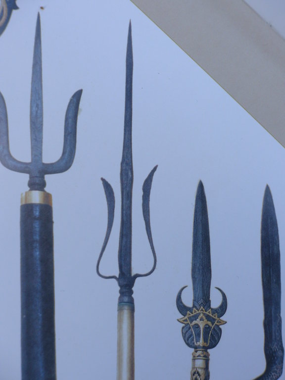

There are even more tripartite elements - the central blade appears to be triangular (we see it clearly on Michael's Trisula), it has three swellings.
Of importance is also the symbol at the base of blade. On bronze Trisula we possibly see the motif of Trisula beeing repeated three times, every time augmented, and the first time the central element is in a shape of Gunungan.
There is one more Trisula, roughly of the same kind but even simpler then Michael's, in the "Kraton Jogja" book, page 148 (chapter "Heirlooms"). It lacks the tripartite Methuk, the last swelling at the point (blade perhaps shortened), and in that picture we see the backside of Trisula, so we dont know if there is a symbol on front side at the base of blade.
In any case the indentation (as transition from base of blade/Methuk to the middle edge) recalls the shape of Gungungan, as perhaps does also the shape of the swelling in the middle of central blade (Michael's blade is different in this very last aspect).

Old 27th August 2020, 12:48 PM   #34
Hello Gustav,
It certainly looks like the iron may have lost quite a bit of substance - not unreasonable to assume that the tip got lost.
BTW, this is a besi lima rather than a trisula. This might also had affected the construction/style of the central spike.

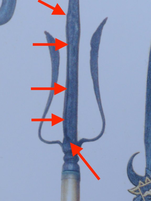

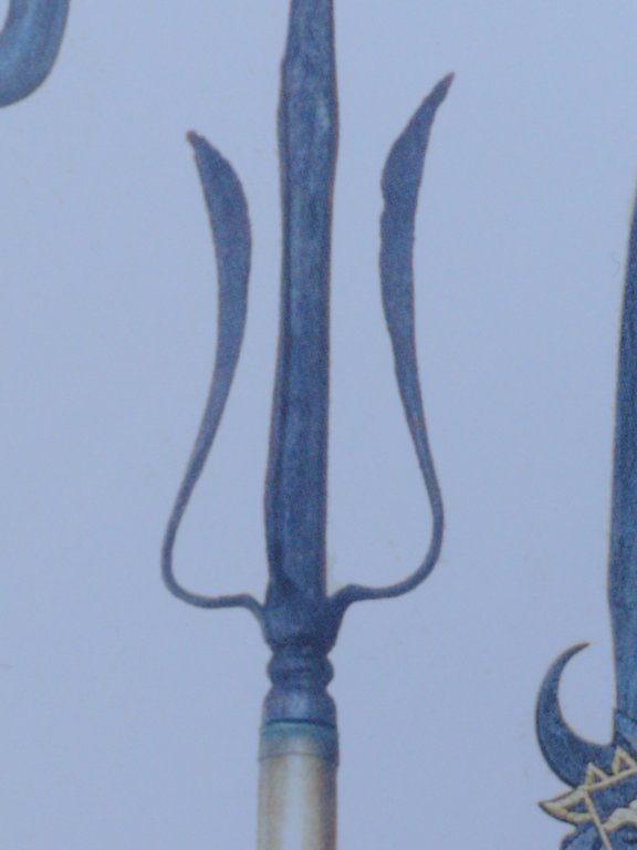

Old 31st August 2020, 09:20 AM   #36
Posts: 7,229
Kai, when I read your post #34 I was a bit confused as to which item you considered to be a "wesi lima". I could not find my Jogja Kraton book to check the original photo in the book, but I have found it now, and I'm still confused.
Could you please tell us exactly which item you consider to be a "wesi lima", and why?
Thank you.
Old 31st August 2020, 06:06 PM   #37
Wink
Hello Alan,
The central spike seems to have a weird, asymmetrical shape.
I believe I see another lateral spike curving out from the base - not easy to see since its back (cp. my red arrows) points towards the camera; the fourth spike would be hidden behind the central spike in my opinion.
Old 31st August 2020, 09:49 PM   #38
Posts: 7,229
Thanks Kai.
Yes, I see what you mean, you might be right.
I have the original photo in the book in front of me, and looking at that, the possibility does not seem to be as clear as it is in your photo. But still, there does seem to be the possibility we're looking at a central blade with four surrounding blades.
You know, that "wesi lima" name has always seemed a bit odd to me, I doubt that this was a formal name for it way-back-when. Sounds more like a pasar name, a dealers name.
Still, I guess we'll never know what else it might have been known as, they're not common.
Very good eye Kai! Agree with you, by the provided picture it looks indeed like this. Agree with Alan about the name, besi/wesi lima is weird.
