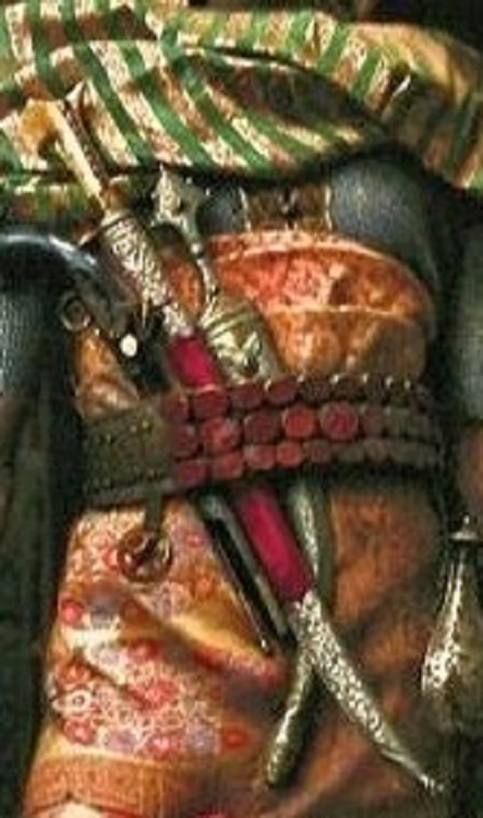

I can not comment on the Yataghan but the item worn beside it in the first 2 pics, is definitely a Dharia dagger from Hijaz region of modern day Saudi Arabia. I have no idea on the lance/spear he is carrying. The right hand pic is not the same as the other 2 as the knife by the Yataghan is different and the clothing colour is also not the same. Also the pistol has a ball butt whereas the ones in the other pics do not.
It would appear to me that there is quite a regional mixture of weapons here and some editing of the pics also.
