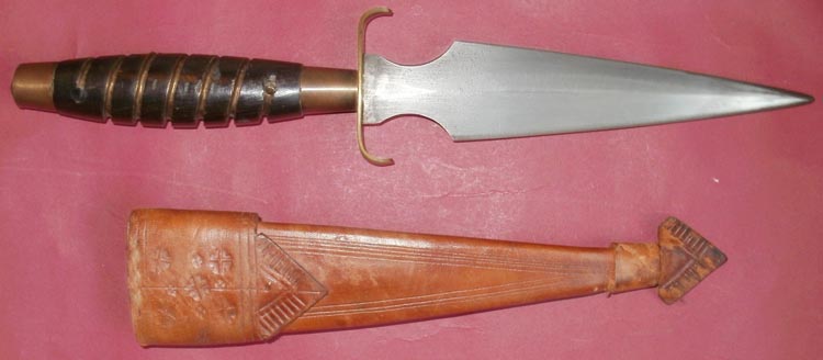

It's too narrow to be a remounted N.Philippine spear blade.
Here’s a dagger from the Philippines that has a similar blade profile. Like Shayde78’s dagger, the scalloped edges are unsharpened.

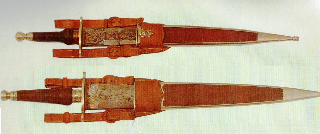

Yes, I don't dispute that going from pugio to this is a very far reach. But I figured it might be worth throwing out there anyway.
Having looked at the other contributions, showing certain analogies to Thai dagger, Philippine knives, and guards on Thai lances, those are intriguing and history shows that those cultural areas were, over time, affected by influences from Europe (think Portugal, Spain, and the Netherlands). So we can't definitely rule out anything. After all, we see Sri Lankan polearms with heads clearly patterned after European partizans of the 16th cent., and French bush knives of the 19th cent. with falchion-like blades (douk-douk) shaped just like those on Vietnamese weapons (dao truong)
In particular, I can't but help notice that the barrel-shaped form of the grip, with ferrules, is one of those elements: lots of central and northern Philippine knives seem to have it, as well as those plug-bayonet-like hunting knives popular in 16th-17th cent. southern Europe. But what about the WORKMANSHIP AND DECORATION of the hilt of the dagger that is the subject of this thread -- the longitudinal ribbing with applied metal inlays?
A very similar style appears on the hilt of the Spanish knife illustrated in the image out of the book which was posted earlier. Just out of curiosity, has anyone seen this decorative technique on the hilt of one of those Philippine or Thai daggers which otherwise have a strong resemblance?

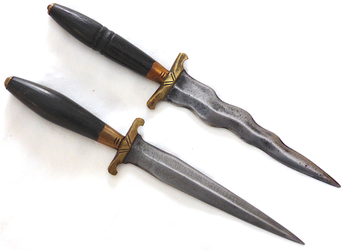

Default Philippine Dagger For Consideration
Hi All,
Here is a dagger from my collection which also features dual concave rebates at the forte. The sides of the blade at the concavities are flat (about 1/8" [3.175mm] thick). Given the style of the sheath and the engraved decoration on the blade at the forte, I had always considered the piece to be from the Philippines. The blade measures about 12.875" (327.025mm) long and is of flattened diamond cross section until the engraved design. The iron cross guard is octagonal and measures about 1.5" high x .875" wide (38.1 x 22.225mm). The hilt (with pommel) measures about 4.25" (107.95mm) and is, save for the brass spiral wrap, iron. The pommel is a roughly circular, incised disk. It is surmounted by a flat iron washer which holds the peened over tang.

Default Another Philippines dagger
This one is similar to the one shown by RobT although more recent in manufacture. I believe this one is from northern or central Luzon and is missing the braided wire on the hilt. No sheath.
