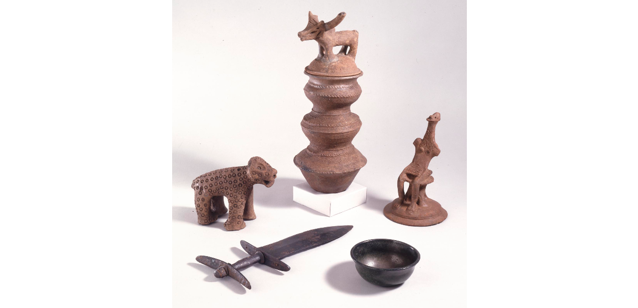

Default South Indian Dagger, 2nd-6th Century AD
https://www.britishmuseum.org/collec.../A_1868-0401-1
Source for the 2nd-6th Century AD dagger.

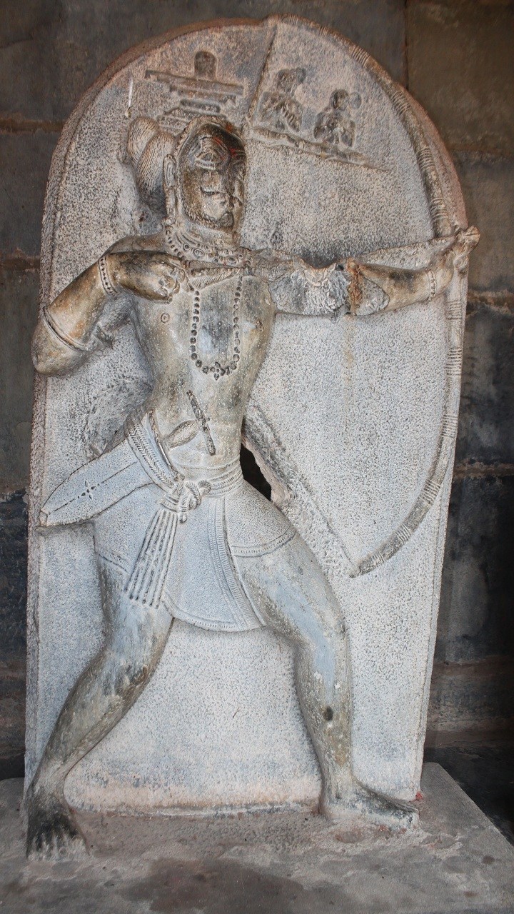

The image of the statue is a archer from the Southern Chola Empire, 11th Century AD. Which has a dagger of a similar design.
You can see the form factor bulge, almond grip that is popular developing.

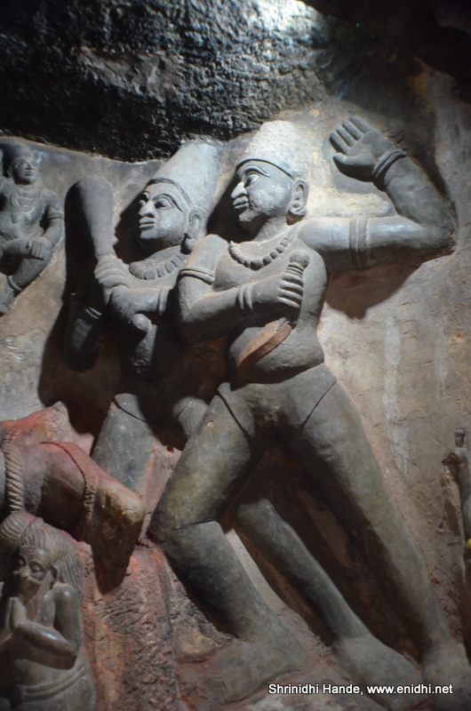

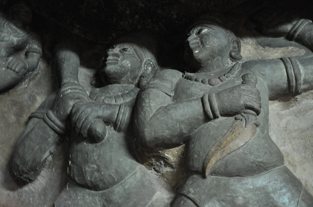

Speaking of Chillanum --
Deccan, Undavalli Caves, 6th-7th Century AD
Interesting right? Earliest example of the similar langet design you'd see later on. Though the ones on Talwar were from early Islamic models.
