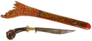

It is a balinese wedung. I've seen these before with such a long blade.
This how the scabbard looks like.

Hello Henk,
Wedung is a Javanese name.
While the hilt may be related, I also doubt that Sevérin's blade is of primarily ceremonial function...
Could you post one of the long blades with fitting scabbard that you mentioned, please?

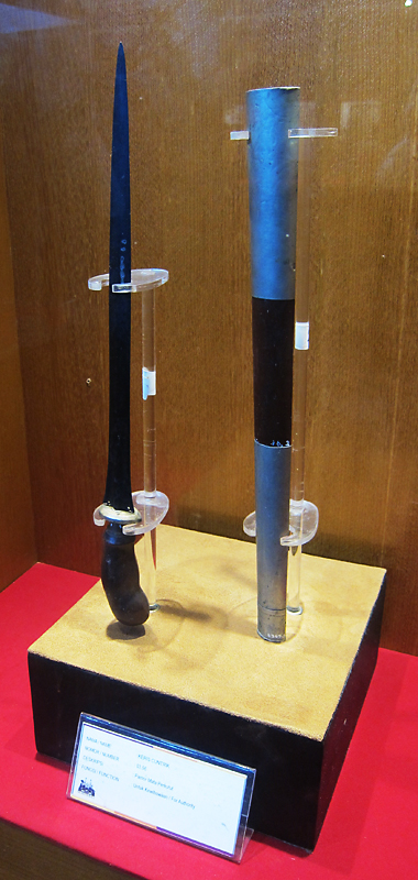

I just remembered this one in the Neka in Ubud.
This is "Ki Pedang Nagaraja". The text about this pedang refers to it as a "keris" with the dhapur pedang. We must remember that the text of "Keris Bali" is written in Bahasa Indonesia by a Javanese gentleman.

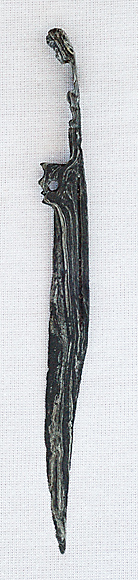

Looking at your picture of the item labeled "keris cuntrik" in the Den Pasar Museum, is this item from Lew's collection essentially of the same type?
Additional images and description
I bought it for my replica Hanuman keris holder to hold and also because I had acquired a very nice spear with similar sleeves (that I shall share on the general forum once I have pictures ready).

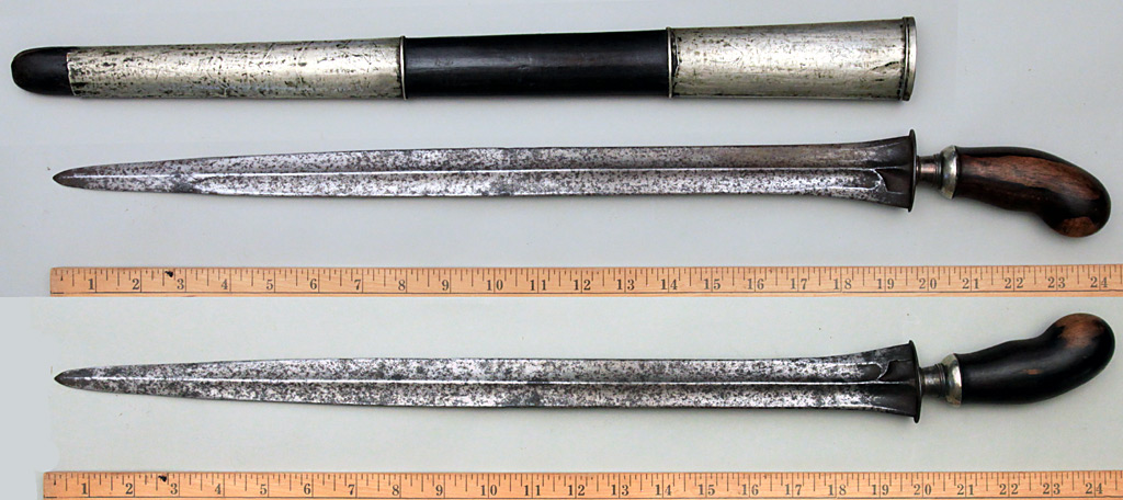

These swords have been discussed on this Forum over the last decade or more. One of the early discussions was here, and there are several more examples shown in that thread. Most of the threads relating to this sword have used the term cundrik, and they have often been attributed to Lombok.
Ian.
