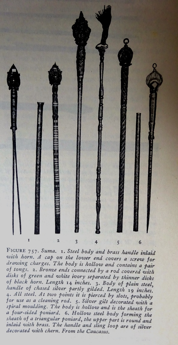

Why descarding the ramrod possibility, guys ?
In some cultures the ramrod is a separate device, often intrincate and highly decorated. You take the Turkish "Suma", for one (Stone page 587).
Say Andreas, which is the thickness of that rod you are showing us?

The flask looks to be a late 16th to early 17th Century staghorn type poeder flask. Although the metal parts are missing and the engraving seems a bit crude. Possibly done by an amature/hobbist on their first attempt. Here is a Forum Link from about 8 years ago that will give you a better idea of it's origins with comment from Matchlock. I was very fortunate to receive his comments.
http://www.vikingsword.com/vb/showthread.php?t=14271
The length of that rod would be about correct for many pistols. So it could be a Suma as Fernando mentions - with a spike end to double as a stabbing point in a back-up situation. Just my guess.

thanks for the link to the very interesting thread. Great to see the variety of examples of this staghorn flasks. Well, the artist of my one wasnīt the gifted one. That poor chap also has a broken sword
I am still not sure about the "ramrod". Suma might be a possibility, but browsing the web I donīt have the feeling that it is one. But it is absolutely not my field...

The Suma approach was only a manner to expand on the (any) ram rod possibility.
