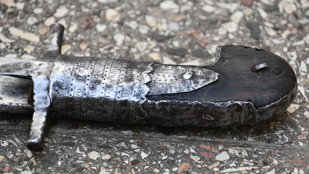

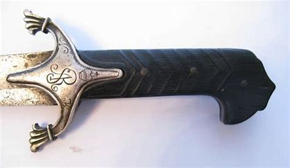

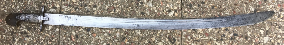

Hello.
I am just posting a few pictures for pleasure (and any comment is warm welcome). The saber was bought in Djibouti, but it is of Yemeni origin for sure. It was used a lot ...,
Length: 88 cms, width 3.8 cms, thickness at the base 0.5 cms. There probably was something written on the blade. The blady is made if a good steel, I think (it is flexible and straight).

Nice to see. I do like these type of swords, made for use rather than display.

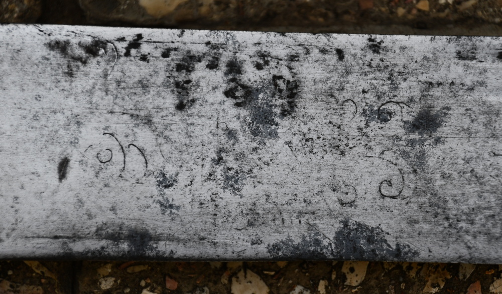

Martin
Very nice Yemeni sword, good catch!
Mmmm to me, i's not writting but drawing, probably clouds and wind like on some European blades...

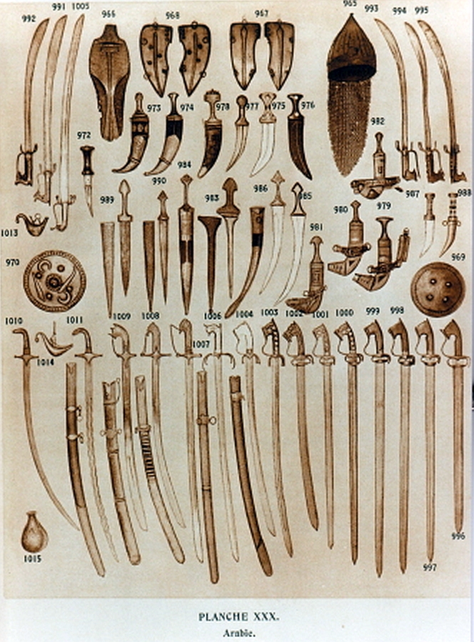

Reference.
A. http://www.vikingsword.com/vb/showth...light=karabela
B. THE AMAZING PICTURE AT #1 OF A KARABELA AT http://www.vikingsword.com/vb/showth...5&page=1&pp=30
We normally view this form as Karabela.. These are quite common appearing from Yemen centres like Sanaa with blades probably from Solingen. I wonder what you mean by straight...? These blades are slightly curved usually and this one appears to be such. Flexible to what degree...? I would think it bends to a few degrees but is quite rigid with a thick back blade. They are often found around Yemen; in neighboring countries and often in Oman and The Zanj...as well as into The Gulf. Often hilts were stripped off weapons and the expensive items re cycled onto Jambia etc... and less expensive hilts matched onto these blades and pushed across the middle Easts souks especially since about 1970 where they were often seen in souks like Muttrah and Salalah..who purchased them from Sanaa....and on and on... where you will still find loads of these still... and in souks up the Gulf like Sharjah et etc...

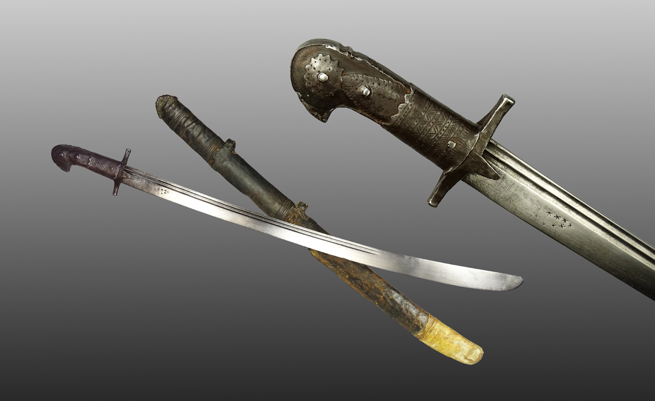

Here is another which I have. Very similar but this has original scabbard.
I just noticed that this was the subject of Ibrahiim's "A" link above. It has obviously traveled a bit since the original post by wodimi.
Stu

Thank you all for comments. Ibrahiim, I ment the blade was not bent to the sides (and maybe except of the first 25 cms it is also springy ...).

Stu, your saber is nearly identical, maybe the same workshop ! But in much better condition.

Before I forget … I was considering Butins Charts on Nimcha swords and noted the potential re jigging of hilts from the standard Saudia Type Nimcha to Karbela form . This type already had a crossguard and sufficient material in the pommel region of the hilt to change it to a Karabela hilt...Thus is there not a potential overlap here from these weapons otherwise known as Nimcha to a type of Karabela...or subspecies of...
See 1007 and 1008 below.
