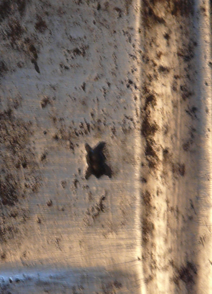

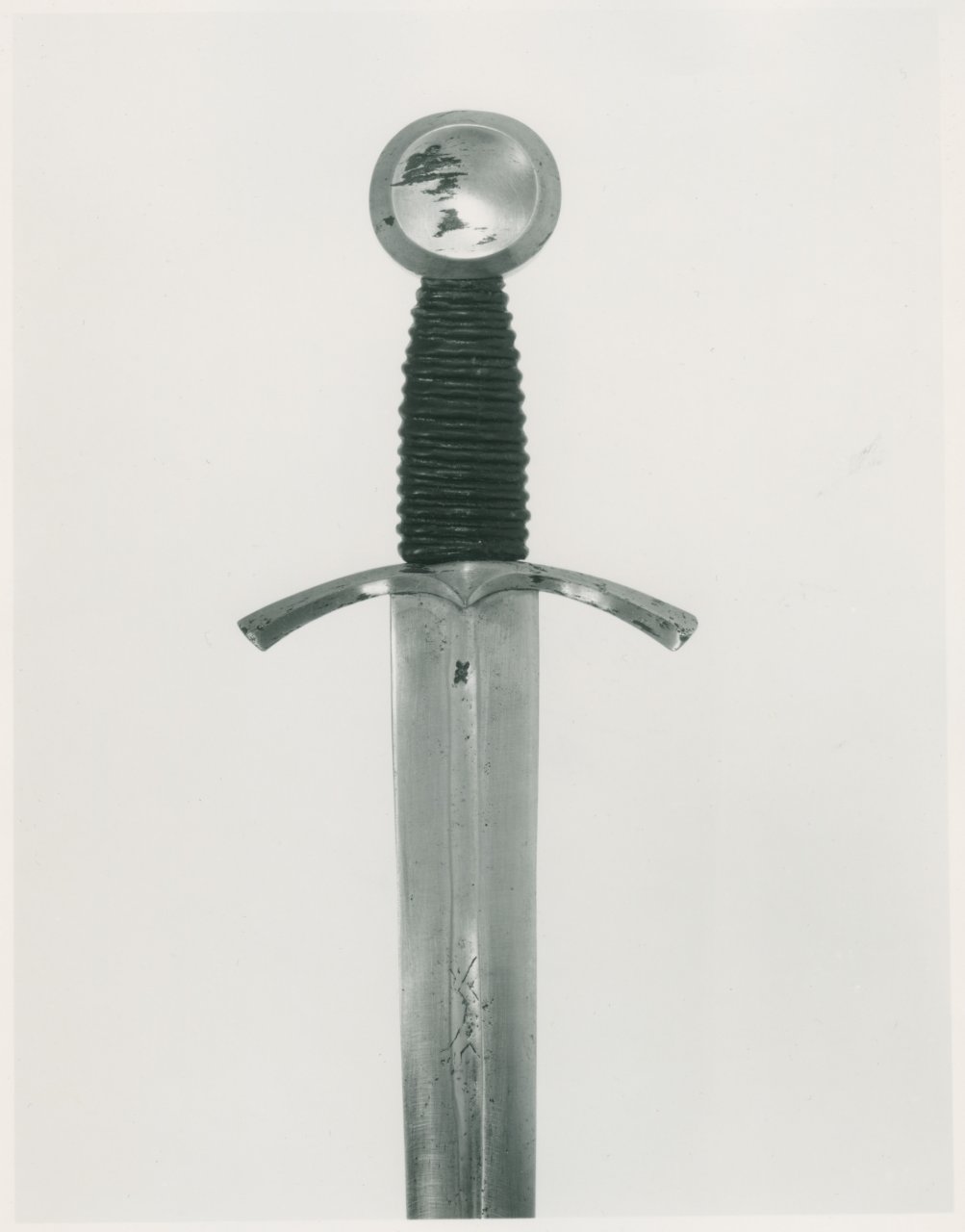

Here is an interesting example of the single millrind mark - on the same blade appears the "Passau wolf". The sword is suggested to be Italian, being exceptionally similar to one in a well known painting... So should we suppose this is an example of a contemporary faked Passau mark? Or perhaps the millrind is indeed not a personal maker's mark, as I think was suggested above...
https://www.metmuseum.org/art/collec...=80&pos=41
Old 8th October 2019, 03:42 PM   #63
Posts: 10,862
Excellent example Reventlov! and the sword illustrated is of course compellingly similar to that in the painting.
I do not believe the 'mill rind' stamp is confined to any single maker, or it would appear just as with other marks (as the 'Passau wolf' noted) that it was to a particular center in any of the countries well known for blade and arms making.
I have often wondered if Italy ever used the Passau wolf, and in my perception it seems doubtful, however the use of the mill rind of course did occur in German context. It seems feasible that a German blade could have ended up in Italy as blades were typically sent to hilting locations there, and a blade from Passau may have easily been used just as the blades from Italian makers.
From reading some time ago (I believe in Wagner) it was said that Solingen often produced blades for Passau makers, and applied the wolf in accord with those 'contracts' (?). Such are the conundrums of specific classifications in these clearly diversified circumstances.

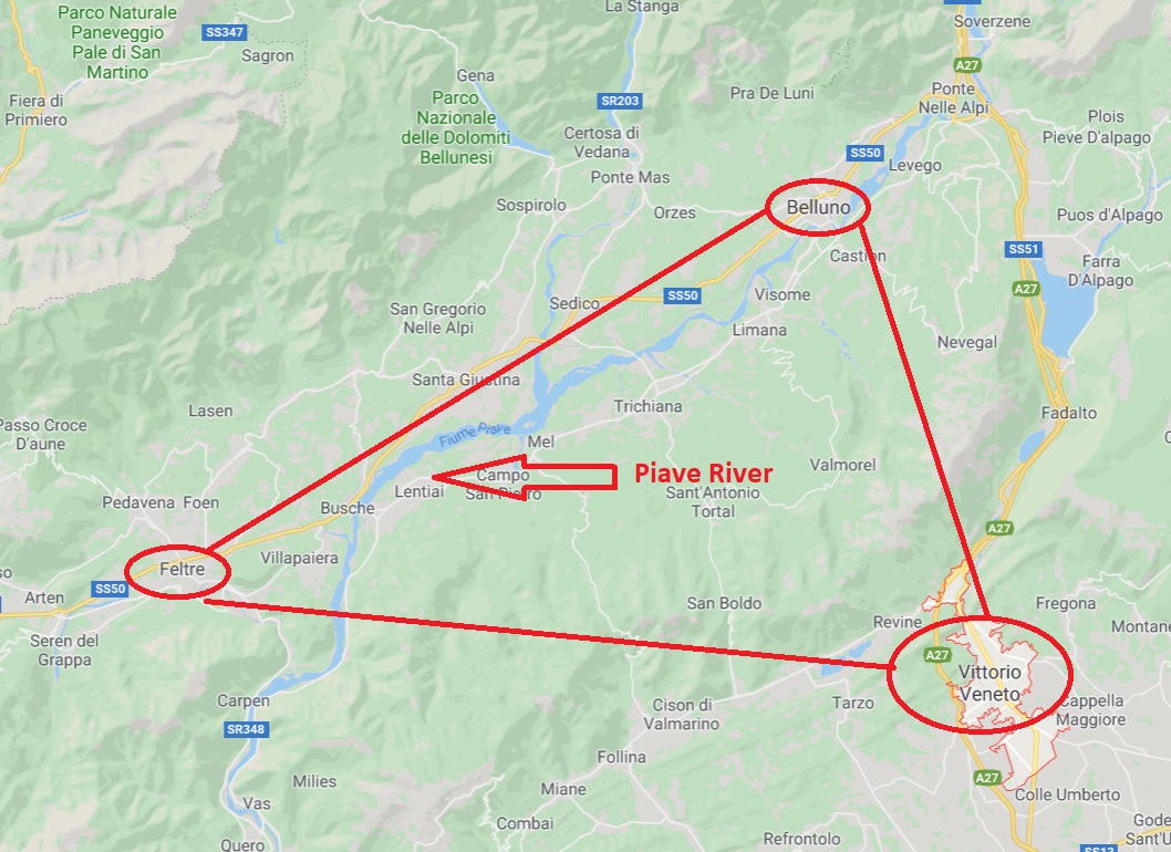

The "Belluno Flyes" or "Belluno Knots" (I use second term) are marks mainly used in the area that I call swordmakers "triangle".
This area develops around 3 main towns: Belluno, Feltre and Vittorio Veneto (before IWW his divided is Serravalle and Ceneda 2 little villages along the turrent Meschio).
The reasons of such a great development of swordmaking art here are mainly 3:
-the nearness with mines of Fursil and Colle Santa Lucia that provides, since roman times, a superio quality of ore. Manganese rich siderite is a ore relatively poor of iron content (around 40%) but fre from phosphor and sulphur that are the worst elements to have in the steel. On other hand manganese is an element that gives great mechanical propreties to the steel made (we can discuss later about this point)
-the nearness with 2 big rivers (Brenta and Piave), that are crucial to transport goods from production centers to Venice lagoon, where is the bigger market of renaissance Europe. Do you know Stradivari Violins? very good... same rivers where used to bring wood to make that violins from Val di Fiemme forests.
-the presence of the main "driving force" before invention of steam engine: the hydraulic power. This area is full of water and we are in the very first part of dolomitic area (alps) so become easier to use the force of the falling water.

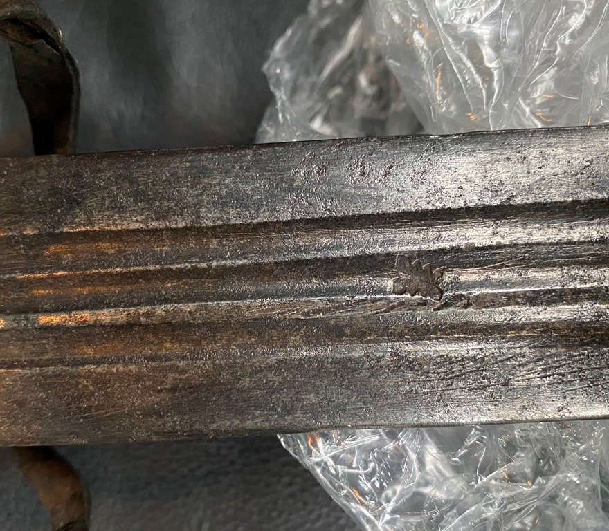

I dont collect European swords and daggers, but I do have a Firangi with a blade from Belluno.

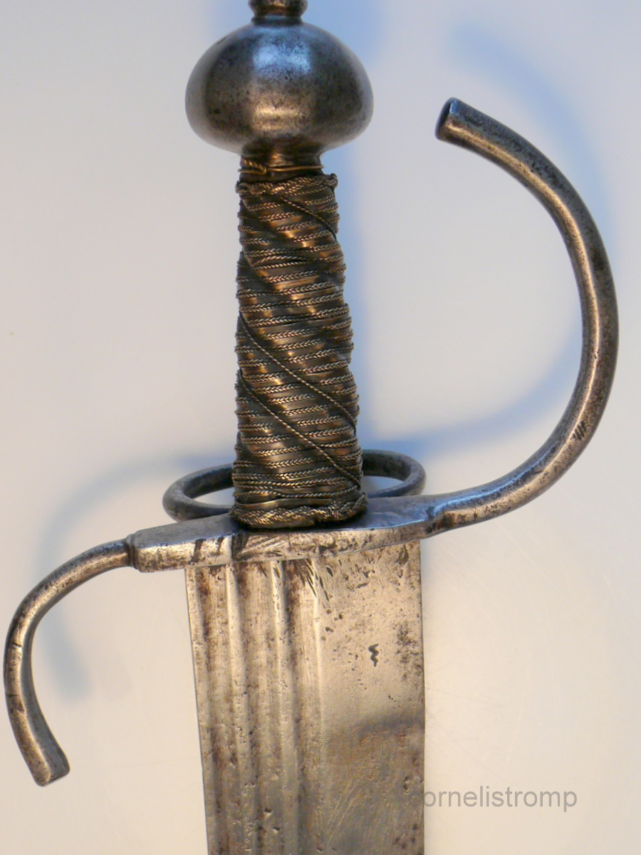

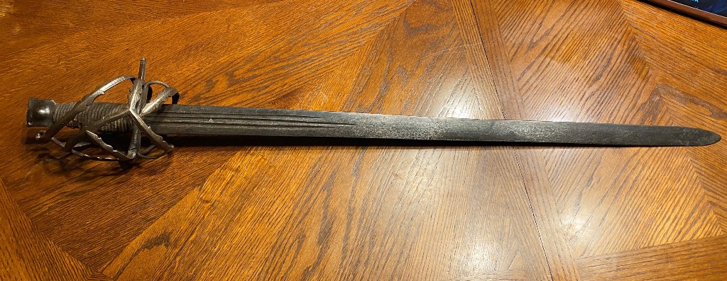

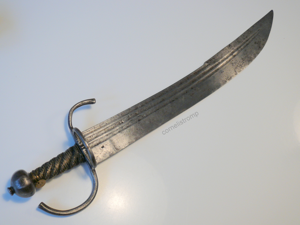

italian storta last quarter of of 16thc.
Old 11th January 2020, 09:13 AM   #69
Outstanding example ... of both sword and marks !

Thank you to all for the warm welcome! @Fernando
Ok a lot to discuss here
@Jens Nordlunde for sure your is such a rare find!
CIVIDAL DE BELUN is a mark that proves the sword has been made in Belluno.

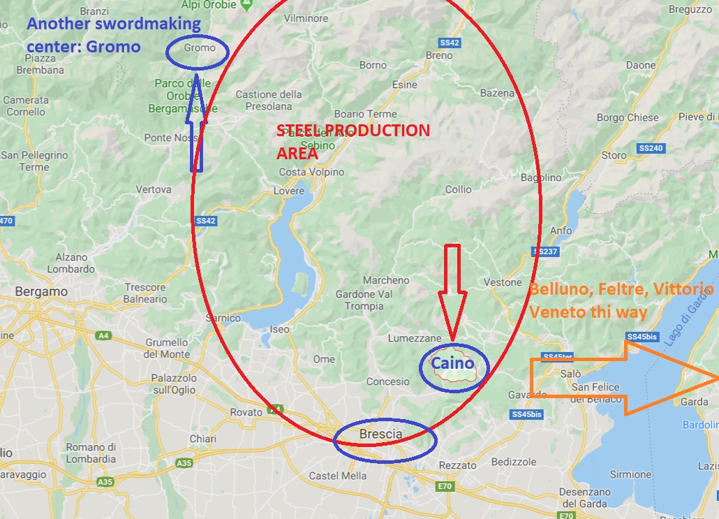

Caino is a little village in the Garza Valley, on the Alps section closer to Brescia, this little valley is closer to the bigger Val Trompia valley famous for firearms makers (Beretta the most famous).
From the XV century Brescia has been part of the Venice Republic and with his valleys (Val Camonica and Val Trompia) ha become the bigger siderurgic compartment of Italy.
So the two big centers of steel production in Venice Republic have been two: -Brescia Valleys with theyr big manganese rich siderite mines (same quality as near Belluno)
-Mines of Colle Santa Lucia and Fursil near Belluno, blast furnaces were in Zoldo, where a big community of furnace masters from Brescia has been established to run furnaces and fineries in the "brescian way".
The only difference has been the quantity of ore extracted between the two areas and so the quantity of steel produced. Mines in Brescian area are much more rich and bigger than the Belluno mines.
In the XIII century, in that valleys has been developed a new smelting process, called the "brescian method" that is a way to convert cast iron from blast furnaces to steel or iron with a finery (this is called indirect process).
Probably the earliest blast furnaces has been built here, making possible the production of enormous quantities of iron and steel.
The development of the "indirect process" of steel making has been an enormous technological revolution, to see another siderurgical revolution like this we will must wait for the industrial revolution in XVIII century.
Compared to the "old" technology of bloomery furnace (direct method) the brescian process has imporved not only quantity but also quality of steel produced.
Making possible that great development of arms and armour production in northern Italy from XIV century.
Caino has the great advantage to be into that area, where was possible to find great quantity of hight quality steel to make blades.
The problem is that before XVI century there was no swordsmithing tradition here like in Belluno area, so the owners of the workshops (keep in mind that in medieval time owner of the workshop rarely match with master that work in it) decide to convert theyr production (mainly agricultural tools, and papermaking mills) into swordmaking.
To do this they ask to some Belluno area masters to come in Caino and to start to run activity making swords in theyr workshops.
So Caino, has become a swordmakin center in XVI for the fact that some masters moved there from Feltre, Belluno, Vittorio Veneto and other places closer to the triangle.
@cornelistromp beautiful example of storta! There is a very similar blade in Poldi Pezzoli collection in Milan. I will post the photo later.

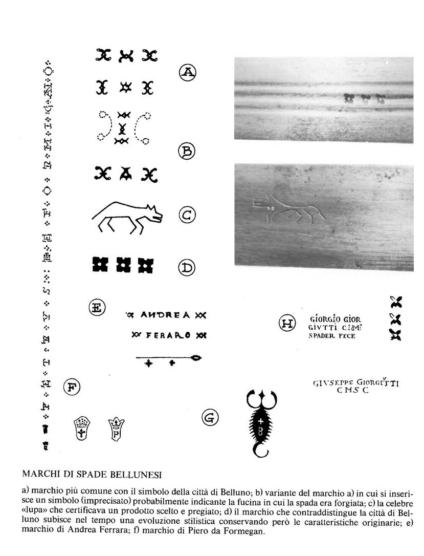

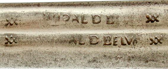

Some Belluno area marks!
Cheers
Giovanni
AndreaFeraro89 is offline   Reply With Quote
Old 22nd January 2020, 11:15 AM   #72
Most interesting info... and useful, Giovani.
Post copied to the EARLY " MAKERS TRADE MARKS" page, situated in the "Classic Threads" front page sticky.

Thank you Giovani, this is most interesting. I too have a firangi blade with some of these stamps. The problem is, that the Indian smiths were very good at copying both blades and stamps.
Is there any indication of, how far down the blades there stamps would be - was there a standard measure from the hilt?
This could, maybe, help us to point out the copied blades/stamps.

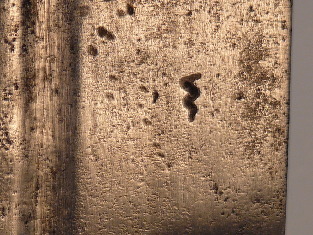

Dear colleagues,
Looking for your help with this mark on the schiavona's blade which looks similar, but not the same.
Evgeny_K is offline   Reply With Quote

It looks like this one:

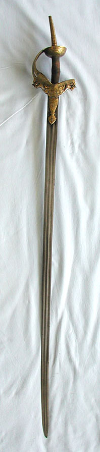

Giovanni, thank you for your opinion!
Here is a photo of the whole item. I am not sure whether the blade was replaced or not, because there are signs of disassembling of the sword. It is also likely the blade slightly shortened.
BR,
Evgeny

Oh Mamma Mia! (sorry but others Italian sentences I have in my mind are not as kind as this).
I have made a goo choice to ask you photos!
This is an ancestral schiavona type, the blade is still large and the basket is not fully developed, is much more uncommon than later examples.
In my opinion we are around 1570-80 about datation and I am 99% sure is a Belunese model, not for sure German.
The blade belongs with hilt and pommel and the handle seems orginal too.
Beautiful piece, a joy for my soul.
Thank you for sharing
Giovanni
She's a simple beauty! Looks like the hilt is engraved? Maybe start a thread on it with more detailed pictures?

I found this old post about Fly Markings. I showed the sword to Tony North at an Arms and Armour Society meeting and he said..."Venice".
The proto Kaskara remains an enigma.
http://www.vikingsword.com/vb/showthread.php?t=11920
