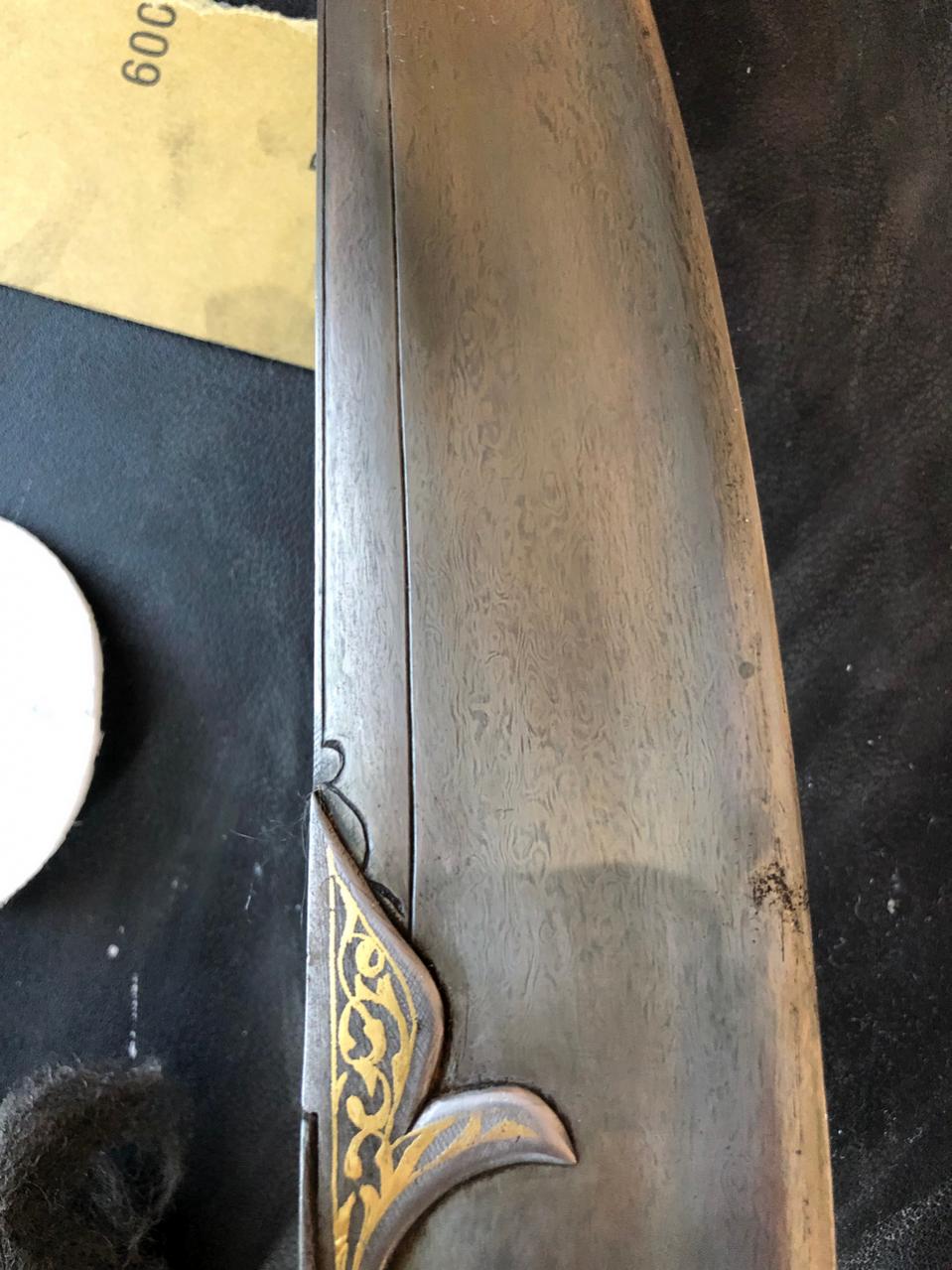

Sorry to revive this thread but I have been attempting to etch an old Turkish Pala and have had a couple of issues that maybe you guys can answer.
I have now tried both 2% nital and ferric chloride. The nital seems superior as it does not rust as quickly, but as others have pointed out it is very non-uniform in its etch. I apply with a paintbrush. I've also tried applying with cotton pads but it doesn't seem to work as well.
Ferric chloride mixed 5:1 almost immediately rusts the blade, prior to even bringing out any pattern. So it has been retired from use.
I have been mixing a large amount of baking soda with water but it seems ineffective in neutralizing the acid. Though from what I have read it seems you guys are rinsing the blade and rubbing baking soda directly onto the blade if I read that correctly? So not mixing it prior.
Finally, I'd like some more info on the instant coffee method, are you simply leaving the blade in water mixed with instant coffee for many hours? Seems like there is good feedback on this method and I'd like to give it a go.
Jack

JT88, it sounds as though your ferric chloride solution is too strong. I would suggest a 1:20 solution of FeCl3 in water and see how that works for you. It may take several minutes to bring out a pattern but you should be less likely to go straight to rust. Warming the blade can accelerate the process when using milder solutions.
A lot of this is trial and error. Fortunately the blade can always be repolished and one can start over.
Thanks for the response after reviving a long dead thread.
I did dilute it more last night and give it another go, looks pretty decent now. Still a bit of a brown tinge overall, but not too much. Wondering if stop now or keep trying to go darker.
I am still very curious about trying instant coffee, one of the other posters said they would do it after using ferric chloride. Hope they will respond with a process for it.
Has been an exhaustive process, many re-starts. I think the pattern looks better now than when I got it, but less uniform overall.

i think it looks good. It is hard to get good results with ferric. As for the instant coffe. I had som good results etching pattern welded, but never wootz.
You could try vineger, or a lemon. Takes a long time but I find it easier to use then ferric. Every blade is unique so you never know what will get you the best result.
