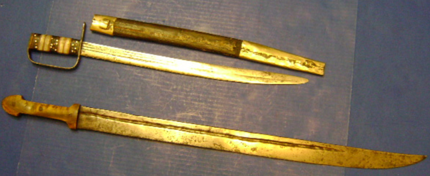

The upper one: Gurian kindlal is massive, wide, and has pretty rounded tip. Its blade is hollow-ground. It is a slashing weapon.

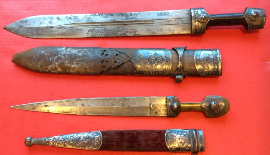

The lower one, Megrelian is rather small, narrow, having a very sharp tip, flat panel at the ricasso and a central rib for strengthening the blade : a stabber.

Their decorations are also very different: Gurian has scabbard with monstrous iron chapee and square pommel; Megrelian has elegant silver decorations.
These differences were preserved for as long as we know these weapons; these are firm tradition peculiar to the same people occupying the area size of Long Island.

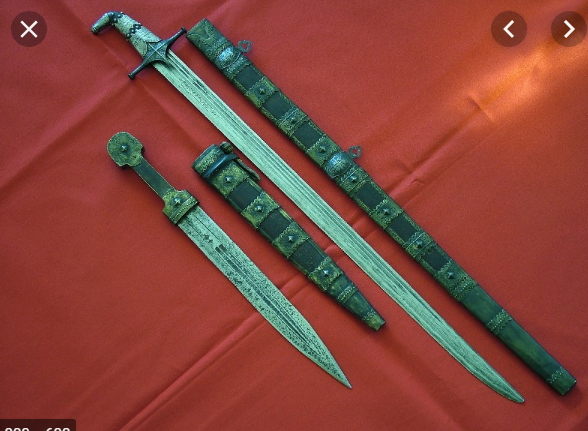

"In that part of the world wars were an uninterrupted chain of events. Weapons were consumed rapidly, and there was no sufficient capacity to renew their supply. People had to rely on "re-purposing" broken parts, blades in particular.
The upper one is Khevsurian Dashna. Pay attention to the blade: typical Khevsurian low quality job, and pretty old and worn to boot. The word "dashna" was mentioned in the Georgian dictionary of Sulhan Saba Orbeliani in the 17th century.
Classical examples had kindjal-like handles and plenty of brass on the handle and the scabbard.
The one I show is a much later example, mid 20 century: D-guard, handle materials.
Believe it or not, those were in active use even then, despite all the restrictions imposed by the Soviet regime. Khevsurs never paid much attention to any government:-)
The second one ( quaddara-like) is even more interesting.
I got information about it from Vakhtang Kiziria, a Georgian researcher, who wrote several articles about these short improvised weapons.
He consulted with 2 more Georgian weapons researchers and...
This is a weapon that originated in Eastern Georgia, Kakheti, and is locally known as Sabarkali.They were known there since the end of the 18th century till ~ 1820 ( when the Russians came). After that , beginning ~1850 they penetrated to the neighboring Armenia and Azerbaijan, where they were called Quaddara and widely used in the religious ceremonies of Ashura. Azeris expanded its presence to Persia.
My example has a village-made Georgian palash blade of unexpectedly high quality: no caverns at all and in more than 20 years since I got it, I did not oil it even once, and there is not a trace of rust, just thin beautiful patina. Ian was astute: the fuller goes ~2.5 inches inside the handle, indicating that the current blade is just a remainder of a broken old one. Taking into account chronology of Sabarkali ( beginning of 19th century at the latest), the blade must be even older."

BTW: Ariel, forgive me if I missed a point, but why do you think the second one is Megrelian, for I would bet it is a Circassian one, according to the decoration, of course, "as far as I can see"
kamachate is offline   Reply With Quote
Old 5th February 2020, 06:50 PM   #14
Yes, the motives of decoration are Circassian but this is expected: Meghrelians belonged to the Circassian “group” in the esthetic sense. Please see Rivkin’s book with multiple examples of it. The distinctive feature of Meghrelian blades is the flat panel at the base of it.
I see your point re. “ flatlanders” vs. “ mountaineers”. But at least 2 independent papers ( one by a Georgian arms researcher Vakhtang Kiziria, another by a Russian museum worker from the staff of the Hermitage museum, if I am nor mistaken) carefully discuss the ethical dimensions: slashing or cutting wounds were not life-threatening whereas a stabbing one was. The use of the latter was frowned upon in the majority of Caucasian traditions and was limited against animals but was used very grudgingly against humans and only in extreme circumstances ( mortal enemies, horse thieves etc.)
Why were Meghrelians so very liberal with stabbing ? I do not understand it and could not find any decent explanation.
