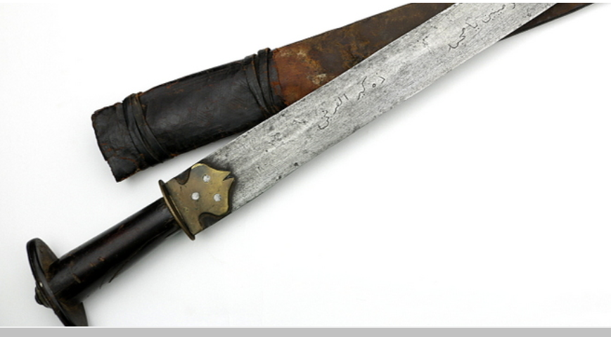

Sold on E-Bay.
This is an Ethiopian sword with straight blade 27 1/4" long, total 32".
Was advertised as Mamluk blade.
I was intrigued by the inscriptions and asked several colleagues , native Arabic, Farsi and Urdu speakers to translate the inscriptions.
First " Arabic" person told me that it was not in Arabic.
Farsi and Urdu were similarly rejected.
But then, one of those colleagues sent pics to her friend, a Saudi Arabian guy, who told her that the only thing he could translate was "Oh Muhammed", and the rest was " blasphemous". That piqued my interest even more.
Apologize for the pic of the entire sword: that was taken when it was already sold and the pics could not be adjusted.
Asking general opinions and Kwiatek's help with translation.
Many thanks.

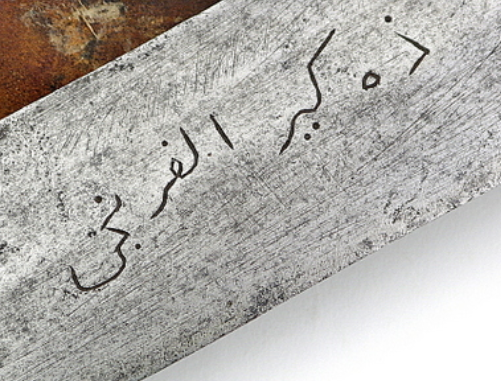

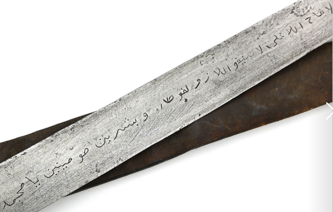

It’s Arabic with lots of mistakes and done probably by a non-native speaker or by someone semi-literate.
“There’s no hero but ‘Ali, no sword but Dhu’l-Fiqar. ‘And tell the good tidings to the believers (Qur’an 61:13, in part).’ O Muhammad!”
The interesting bit is the difficult bit, of course. The last words are probably the maker’s or owner’s name. It’s spelled:
“Dhah-Kir al-Faranji”
Al-Faranji means “the European”. The first name is not an Arabic name. I can scout around to see if I can come up with anything
Your translations are really cool, thanks!
Only one point, I think al faranji means the foreigner.
Of course most of the time Europeans.
The word comes from the Crusades, Franks, Faranj.
Also used Roumi, the foreigners and Christians, from the Byzantine or Easterm Roman Empire... Roumi=Romans...
So the foreigner might be an Ethiopian - Christian - but it's just my opinion...

Thank you Ariel for your explanation. I agree with you for the basics, Ali was considered as a great fighter and a hero. The same is true for the sword zulfiqar given by the Prophet to Ali.
Inscriptions mentionning Ali and Zulfiqar were talismanic symbols used to protect the owner of the weapon and to give him some strength or even supernatural powers.
لا فتى إلا علي لا سيف إلا ذو الفقار‎
lā fatā ʾillā ʿAlī; lā sayf ʾillā Ḏū l-Fiqār.
"There is no hero like Ali; There is no sword like Dhu-l-Fiqar"
Why Ali is popular in the Sunni world?
In fact it's more complicated than simply Ali the perfect warrior and shinny knight of Islam.
Ali and Zulfiqar are parts of the symbols used in many sufi sects, including dervishes in Iran and Sudan but also Bektasi janissaries in the Ottoman army and since at least the 13th c.
THis is the deep meaning of Ali and Zulfiqar in the Sunni world.

I don't see anything blasphemous in the text. There are misspellings of course, seems like whoever inscribed it did so in phonetic way.
Ali ibn Abitaleb was the cousin of Mohammad (pbuh), not a direct descedant of him. His children with Fatima (as) and their lineage are considered direct descendants of The Prophet. He is respected greatly by both shia and sunny, revered more so by the shia. During the Umayaid dynasty it was standard practice to curse his name or speak ill of him due to political reasons, this practice was abolished towards the end of that dynasty. This of course was not supported by mainstream scholars of that time, many of whom were murdered because they refused to follow that practice. Also, this is the reason the shias tried to counter this by speaking more highly of him.
He was great warrior among other virtues, and was gifted Zulfiqar by The Prophet, a sword that was given to The Prophet by angel Gabriel. Thus goes the saying carved on many swords in Muslim lands.
In the Indian subcontinent the term Firangi (G pronounced like gulf) is another way Firanji is used, pretty much same meaning.
On another note, Zulfiqar is spelled with ذ which sounds like Z, not with ض which could sound like Dh.
