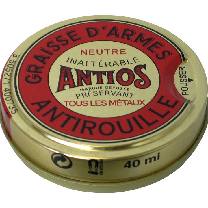

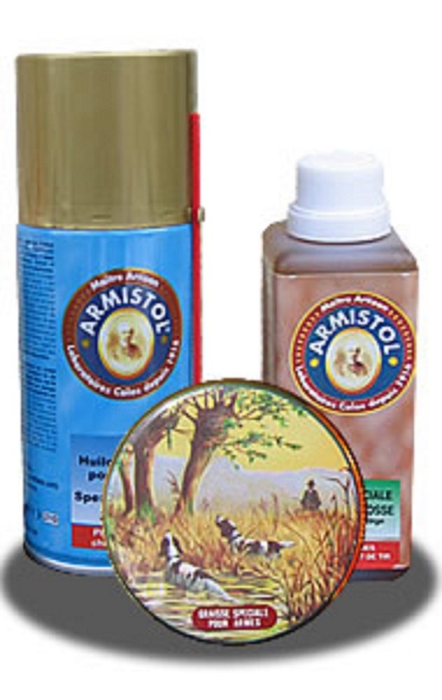

I use arms grease. Antios or Armistol. It is there a year later.
Armistol has a nice kit with a dressing for wood.

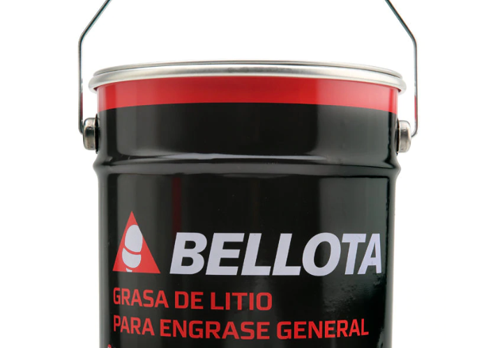

I want to try lithium grease with some irrelevant blades.
