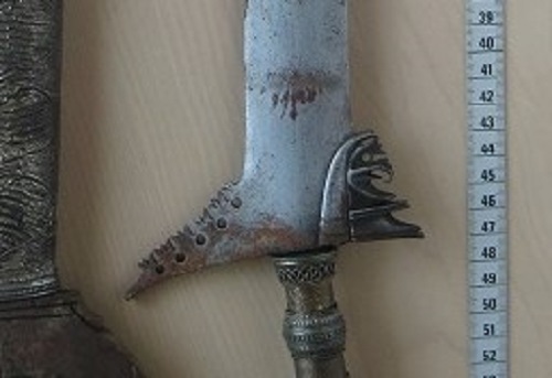

I should really appreciate opinions about this Gunong....
I can understand it is hard because I only have these two pictures for the moment but any opinions at all should b very much appreciated.

I'm going to defer until you have better pictures. In particular, I would like to see close-ups of the hilt and guard.
However, my best guess with these inadequate pictures is that this gunong is not very old.

I would also like to see better photos. But the pommel gives the impression that it might be Tridnaca (giant clam shell).
Can you tell what the metal is on the sheath. Aluminum would place this as Post WWII i think. Regardless, it is an attractive gunong no matter the age.

The blade doesn't look too bad IMVHO...
And possibly the pommel if David is onto something: Tridacna. (Just make sure it's not plastic! )

Like everyone else I would like to see a few better quality photos of your new gunong. To me the fittings do not look to be made from aluminum because of the oxidation shown in the first photo you posted, but could possibly be nickel silver or white brass instead. The hilt does however appear to be made of Tridacna shell as suggested by both David and Kai. The groove down the center of the blade I have only seen on blades dating from the 1920's and upward. If I had to guess on the age of this piece I would say second quarter of the 20th century. Better photos will help you to get more precise information from those more knowledgeable on these daggers than I am.

I'm looking at this gunong and the other blade that you posted here at the same time, the Espada Maranao, and it looks to me that these were probably made in the same place and at roughly the same time. Both seem to have the same very white material for the hilts (which David has identified as probably coming from a giant clam), and the scabbards appear to be constructed similarly from what looks to me to be mango wood. The white metal is probably white brass or similar alloy IMHO.
If so, then your gunong would be a recent Maranao product. Hilts made from this very white material (from the giant clam, Tridacna) seem to have appeared in the last 20–30 years, and may be a replacement for ivory, which has become more expensive and harder to obtain with the implementation of international treaties banning ivory use. Mango wood is an inexpensive hardwood that seems to be used more frequently in sheaths during the last 30 or so years.

Nice cache of Maranao weapons that you came across. They are all of the same general vintage, second half of the 20th C, which fits with the time the original collector was in the Philippines. Do you happen to know where that individual purchased them? I would not be surprised if they came from Zamboanga, although recent Maranao weapons can be found in Manila's antique shops as well.

While I agree with you in general I have to disagree when it comes to the kris blade, the overall style and the separate gangya I personally would place at the end of 19th to very early 20th century. I guess that an antique blade with rotted fittings get a new dress at the time of the mid to second half of the 20th, the current hilt and scabbard are typical for this time.
I know this practise from Indonesia, for example you can find very old blades in rather new tourist fittings (Bali).
I am nearly sure that we see an antique blade here.

Oh I agree that the blade is old and around the time you suggest, Sajen. I'm with Ian when it comes to everything else about the kris. And yes you are also right in that several of these old blades have new "clothes" on them.

I agree that the kris blade is older and rehilted with a new scabbard, something we see quite a lot with Moro blades. I was really referring to when the present pieces were assembled. The dress on these is very much late 20th C. and in a distinctive style.

From what I can see of the pictures, I still say recent work is from Marawi in Maranao country.
I'll admit though, better pictures would help make a better determination.

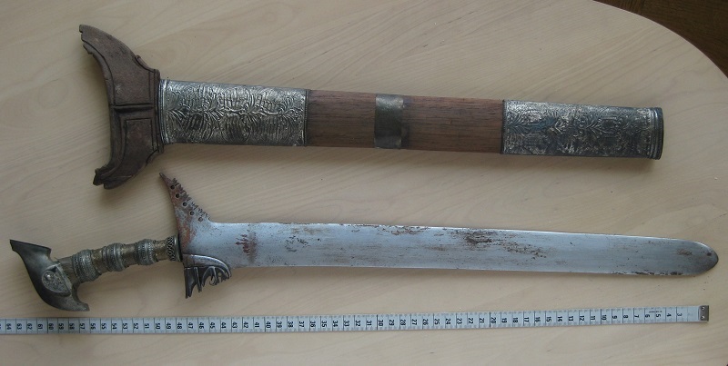

Here are some more pictures of the Gunong....

This now looks to me to be of the 1940s era and the metal might be silver alloy (please polish the silver).
