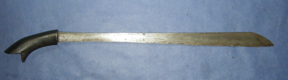

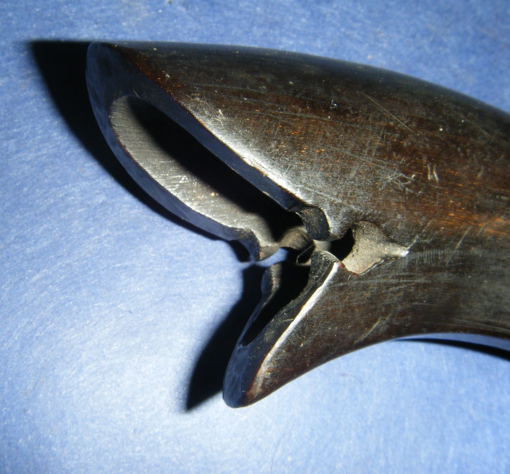

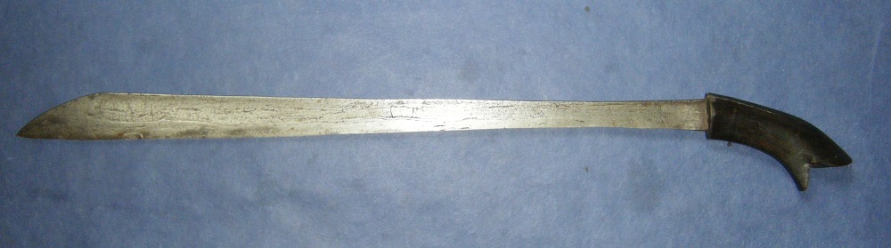

I've recently purchased an Indonesian pedang which seems to have a great age. It has a black horn handle, sadly with an age crack, blade is of laminated construction. The blade has a concave cross section with a prominent spine. It is not a very fancy sword but I am curious to know from where exact this sword coming.
The sword is 63 cm long overall, blade alone 51,5 cm, spine is 8,5 mm thick behind the handle. All comments are very welcome! |

#4 |
Hello Detlef,
Good one! (Let me know... ![]() I'm fairly sure this one is from Sulawesi. Would be good to see the blade stained - this might help to narrow things down. Regards, Kai |

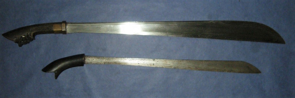

Here the promised comparison with a co jang from my collection. Please excuse the quality but I think that the different is visible.

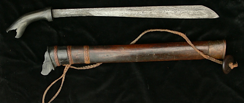

Hello Detlef,
Thanks for the reminder! Here's a pic (courtesy of mandaukudi). BTW, the belt with toggle seems to be Dayak - old but possibly added later (may well indicate an ensemble that traveled to another culture and experienced continued use). Regards, Kai |
