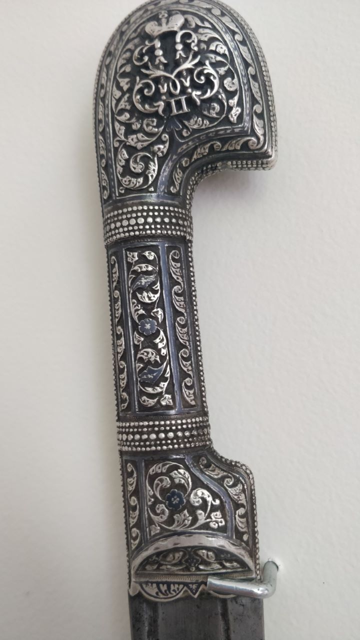

Hi, Erik!
According to the submitted photos with a confidence of 98%, I can say that this is a high-quality fake. Made probably in Georgia.
At present, a lot of good fakes are being made in Russia and Georgia. Masters have original things before their eyes, therefore it is difficult to distinguish.
On the hilt of your shashka there is a monogram of the last Russian Emperor Nicholas II. If it were original, this would mean that the item belonged to the emperor personally or was personally presented to someone as a sign of special merit. But such items have been preserved very, very few and their fate is known.

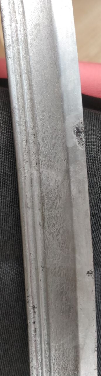

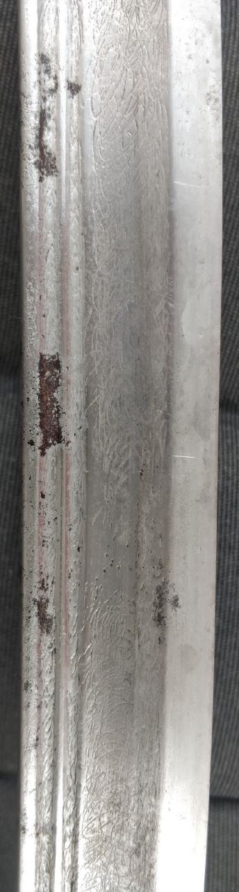

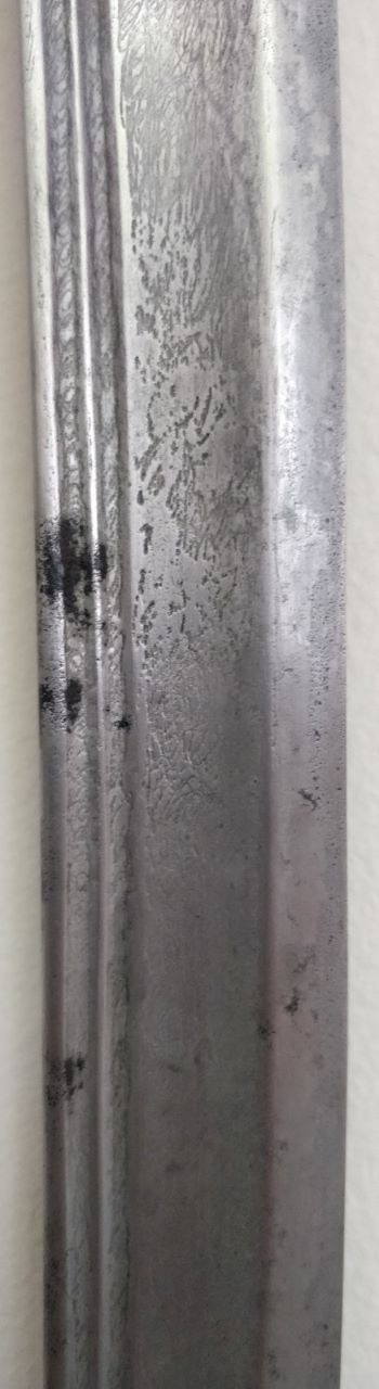

Hmm very interesting, if it's fake it sure looks old. Check out the pictures of the blade. It's in pretty rough shape with lots of rust/pitting. Can that be reproduced? Does this change your opinion?
Thanks

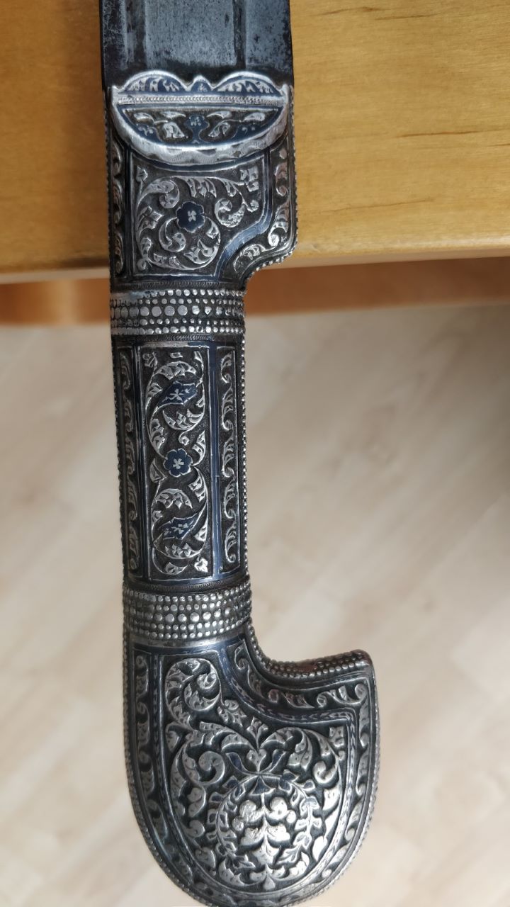

Here is a close up of the hilt...
erikmarko is offline   Reply With Quote
Good work. But it was made yesterday.
The blade may have been taken old, but greatly "supplemented and improved." It is advisable to make a general photo of the subject.

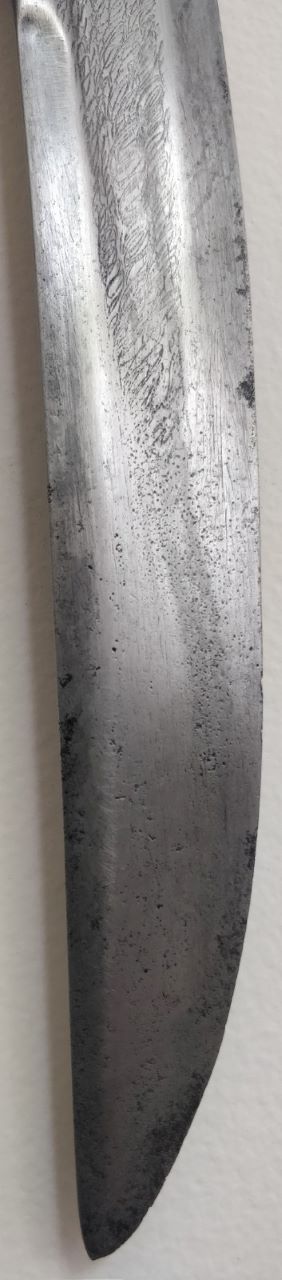

Originally Posted by David R
A good point about the need to see it in hand to be certain. To me the clincher is the quality of the silver-work, repousse and niello rather than poor filigree.... Do my eyes deceive me, or is that a pattern welded blade?
I looked at the photo again more carefully. I think this is an imitation of a pattern welded blade. By the way, this, in my opinion, once again may indicate that this is an authentic shashka.
I agree, this is an imitation of a welded pattern.

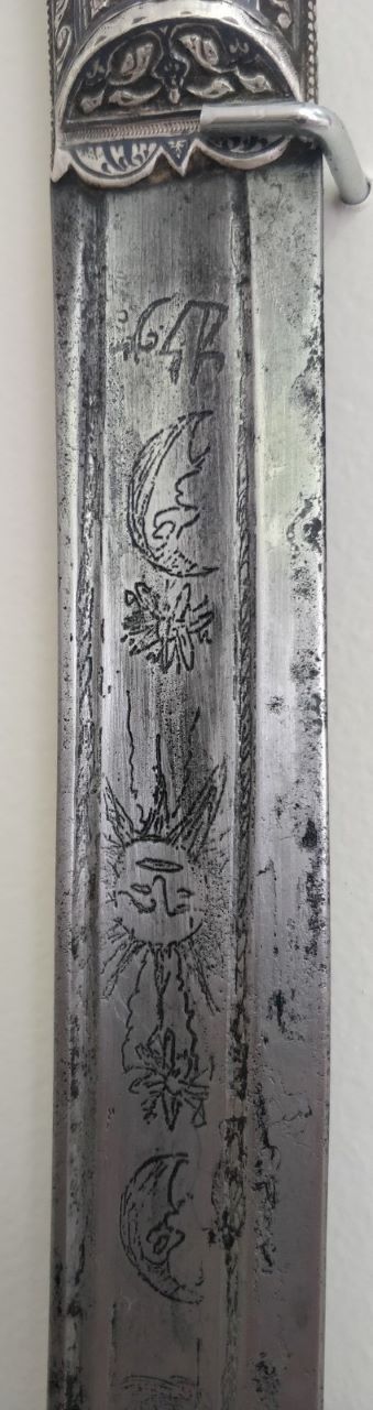

I am by no means very knowledgeable about Caucasian weapons but the blade shows very clear signs of pitting and the engravings are pretty worn out. It is like the sword was rusty and then cleaned, with remaining patches of pitting where the rust got deeper.
To me this points into the direction of a genuine blade.
As with regards to the hilt, it appears to be quality work that displays deep black patination with some wear of the protruding decorative elements.
So, the hilt looks to be equally original and authentic.
However, what bothers me is the continuity of the edge.
The cutting edge is the thinest, thus the most sensitive to corrosion, part of the blade. So normally, in a blade that was rusty then cleaned, you would find small nicks in the edge where rust has bitten into the edge from both sides.
I do not see any such nicks in the edge of this blade.
Moreover, judging from the photos, the edge appears somehow rounded. This may be because
1. the blade never had a real cutting edge, being a replica all along, or,
2. the edge was dulled during the cleaning process.
In the second case, the loss of the edge would mean a reduction in the width of the blade, but I cannot discern any such kind of reduction.
So, in the end I am quite confused with mixed oppinions about the sword.
A strong point would be the quality of the steel of the blade. If the blade is stiff/elastic enough to be used for fighting, it would point again into the direction of an authentic blade.

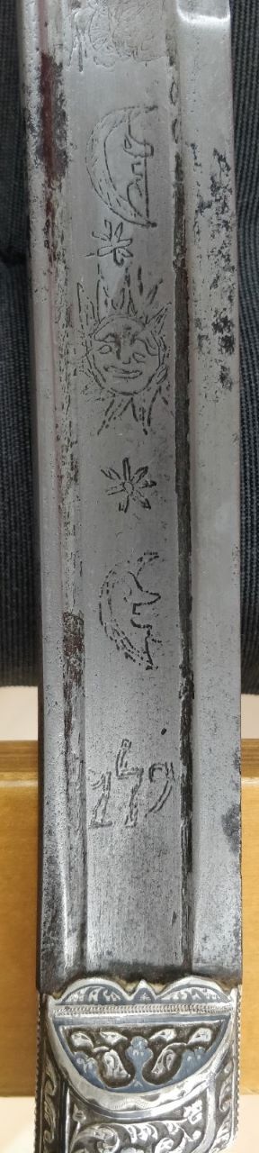

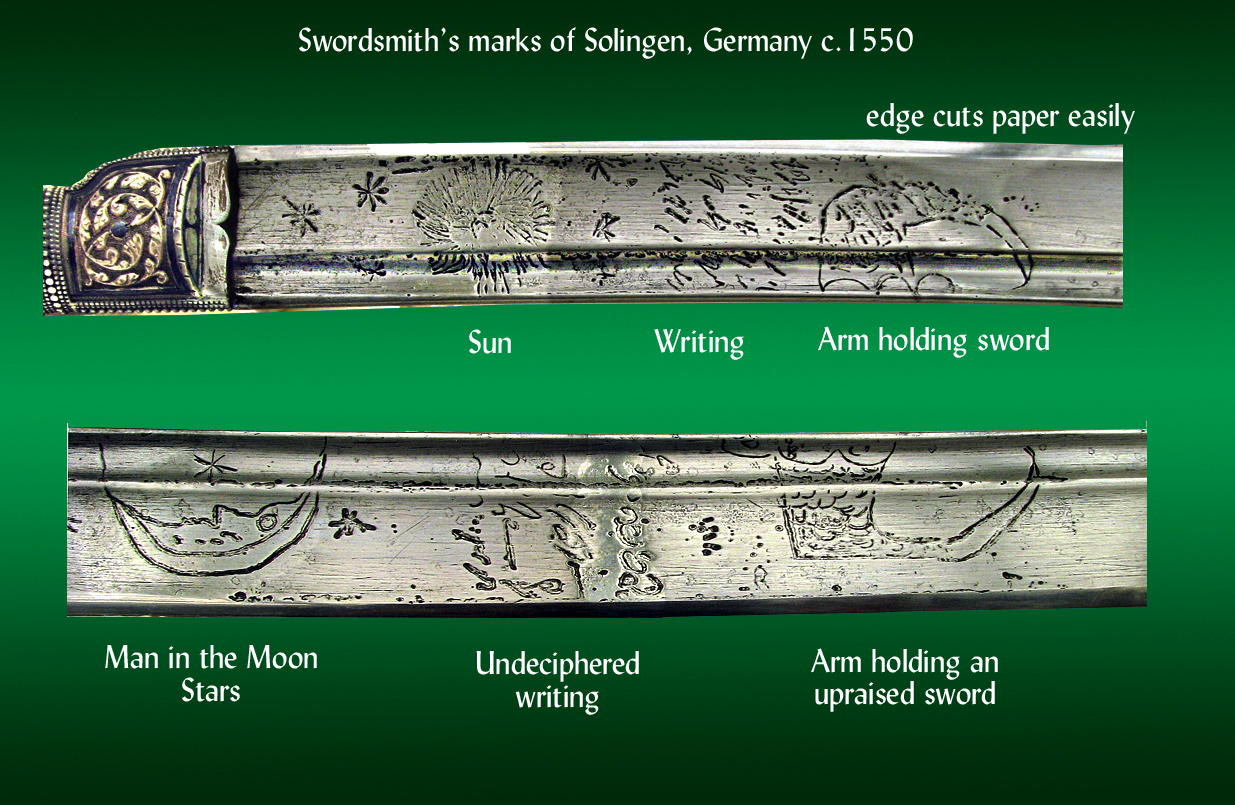

Can someone tell me what the meaning of the moon/sun/stars and the clouds I suppose running along the blade is? And what does the number 149 mean?
Thanks
These symbols mean that the blade is a rough Caucasian copy of the Hungarian and German blades of the XVII - early XVIII centuries Such blades were highly valued and actively copied by local craftsmen in the late XIX - early XX centuries.

In my guesstimate there is a great contrast between a high quality of the handle and an atrocious blade.
Caucasian masters often imitated classic decorations of the highly valued German blades, and necessarily left some clues indicating the forgery.
But this one beats them all! It is beyond poor, it is childish.
I have a great difficulty to believe that a high-class master of the handle chose such a low-quality blade for a whole ensemble. I am also not sure about another point: even though we cannot see the entire shashka, it seems to me that the axis of the handle does not coincide with the axis of the blade. At least in Indian swords this suggests that the blade was remounted.
Overall, I would rather entertain a notion that it was a recent shotgun marriage of convenience. And would not exclude the possibility that the blade was made recently and aged artificially.
I might be wrong, but the opinion of a Russian expert is also only 90%, which is not reassuring: it is safely within the 2SD range:-)))))
In short, I would not buy it . If the Russian expert wishes to acquire it, my inclination would be to get rid of it.
