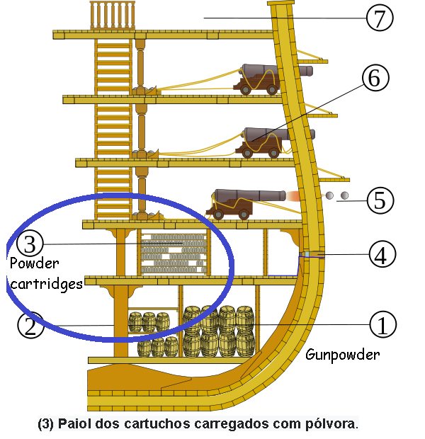

... One of the references I found noted that the hold for powder was enclosed with 'curtains' which were kept damp to prevent accidental spark, as well as men covering feet with cloth or material to also prevent same.
"Just as i previously said and, and having now found the specific words:
Sob a coberta, junto ao paiol estava o capitão de fogo a distribuir a pólvora que tirava às gamelas ou ensacada dos caldeirões defendidos do lume por colchas e cobertores molhados".
"Under the deck, next to the (powder) magazine, was the fire captain distributing the gunpowder he took from the troughs or bagged from the cauldrons defended from the fire by wet bedspreads and blankets".
(Dieter Dellinger, Portuguese Ex-Journalist, advisor for the Navy Magazine, ex-Law maker, etc)

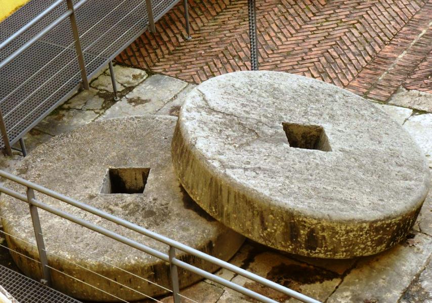

So true. In the Barcarena mill workers were required to wear shoes of calf skin over their own shoes, once these could have nails.

... I have not read descriptions of the detail on the 'cartridge' sacks of powder but it does seem familiar, as I say this is not an area I often study...
Then let me fill you in:
" O cartucho de pólvora foi uma ideia de Vicente Sodré, tio de Afonso de Albuquerque, que para aumentar a cadência da artilharia resolveu ensacar previamente a pólvora para ser colocada logo que a alma do canhão tivesse sido arrefecida e limpa de restos de pólvora com escovilhões adequados, em vez de a lançar a granel como se fazia então. Claro está que os ingleses e holandeses têm a mania que inventaram isso tudo, revelando a mais inconcebível ignorância e refiro-me a alguns historiadores de prestígio que são um exemplo de incompetência total, mesmo perante simples amadores de boa fé sempre que se trata da historiografia portuguesa ".
"The gunpowder cartridge was the brainchild of Vicente Sodré, the uncle of Afonso de Albuquerque who, in order to increase the rate of artillery, decided to pre-bag the gunpowder to be placed as soon as the cannon core had been cooled and cleaned of gunpowder remnants with suitable brushes, instead of throwing it in bulk as it used to be done. Of course the English and Dutch have the craze that invented it all, revealing the most inconceivable ignorance, and i refer to some prestigious historians who are an example of utter incompetence, even in the face of simple bona fide amateurs when it comes to Portuguese historiography".
(Dieter Dellinger )
