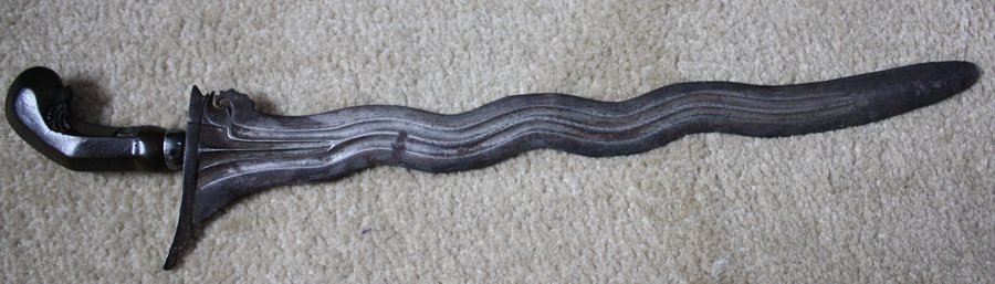

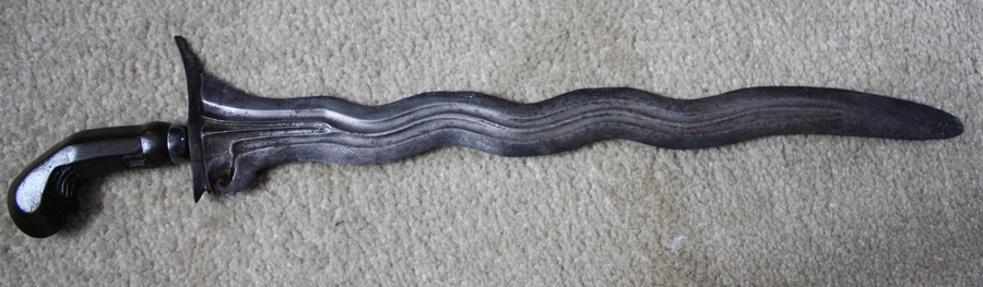

Hi everyone , this is another recent purchase , a nice moro blade but sadly missing its original hilt and instead someone has given this one ! , i have given it just a quick clean and etch just to see if it showed the core and wow a lovely pattern twist core, i will give the blade a proper clean soon and etch ,
now im in the market to find a decent hilt , if anyone has or knows where i could purchase a good hilt of the same age as the blade please contact me ,
im not ssure of the age but i guess its quite early ? blade length is
45cm

Wow, you seem to be on a lucky shopping spree!
While this has the looks of being an old blade, it does exhibit unusual features. I‘d need closeups of the base of the blade for a better appraisal!
Old 23rd August 2019, 02:04 AM   #3
Posts: 7,399
I agree with Kai - close ups of the base of the hilt would be helpful.
That being said, it is a nice Sulu blade, perhaps early 1800s, with great twist core. It would be good to get a good polish and etch, and a proper hilt and clamp on it too.
The present hilt looks to be a modern add on.

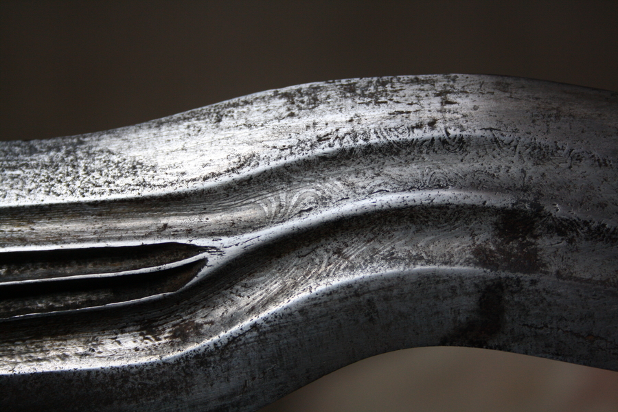

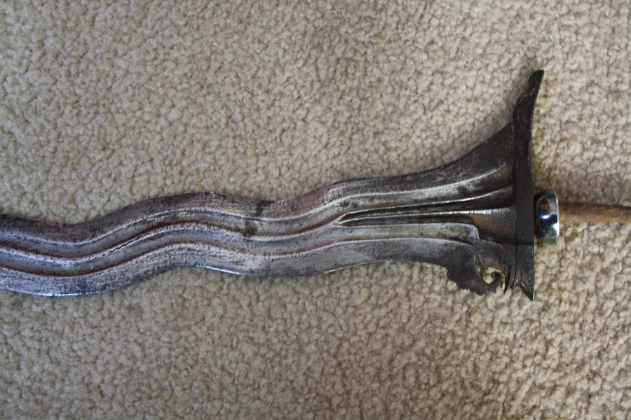

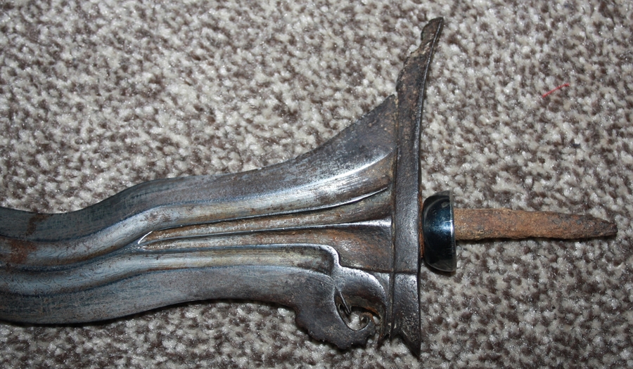

Thanks all , here is a closer pic
chiefheadknocker is offline   Reply With Quote
Old 23rd August 2019, 01:17 PM   #6
Gustav
Join Date: Jun 2009
Posts: 1,331

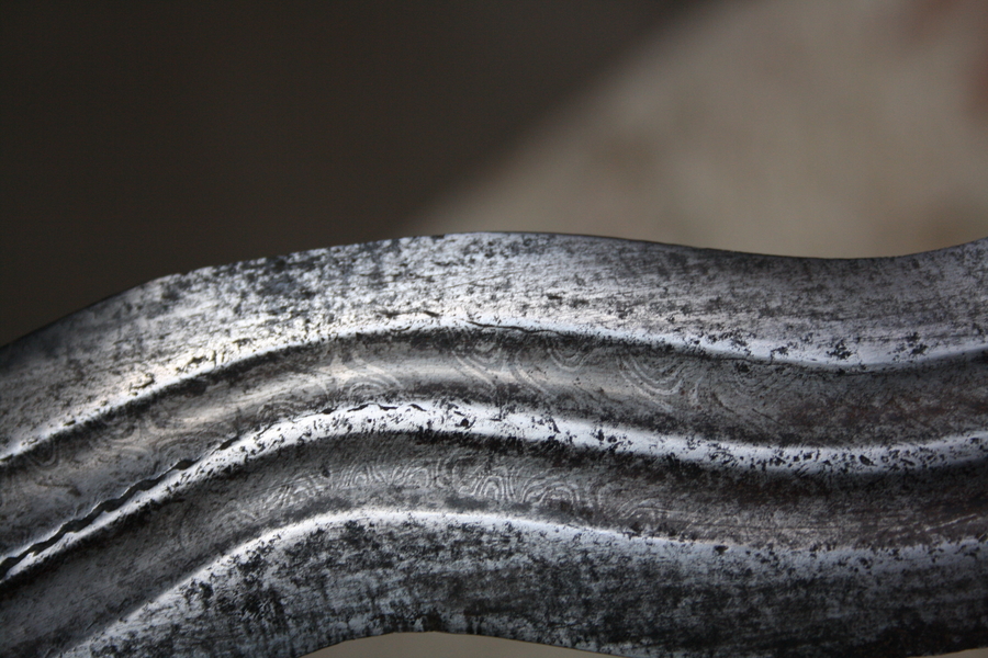

Actually it could possibly be one of the earliest Kris I have seen so far.
Looks like twistcore Pamor was never topographically etched, like this is the case with later blades.
It's very close to the few very big Kerisses from Java from 16th century.
A fantastic blade indeed.

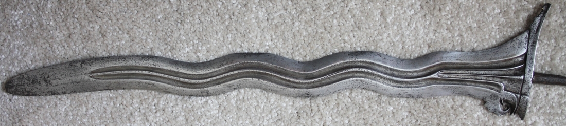

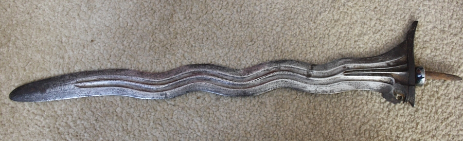

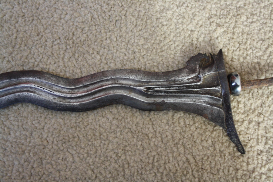

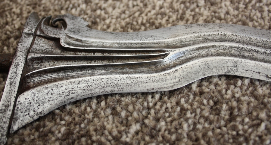

Here are a few more pictures , i will clean the blade up a little soon but how far do you go , is it ok and wise to clean the blade up , i can sand it down untill its shining or should i leave it in its antique state ?

All of the quality examples I have seen in collections or museums have had a well polished blade. In the original culture, an antique and important blade such as this would have been polished well and most likely etched.
At the very least you need to remove the active rust, such as present on the tang. Your latest pics suggest to me that this sword did not have any asang asang during its life (at least, I see no evidence of such) which might also argue for an older transitional piece.
Congrats on another fine addition to your collection.

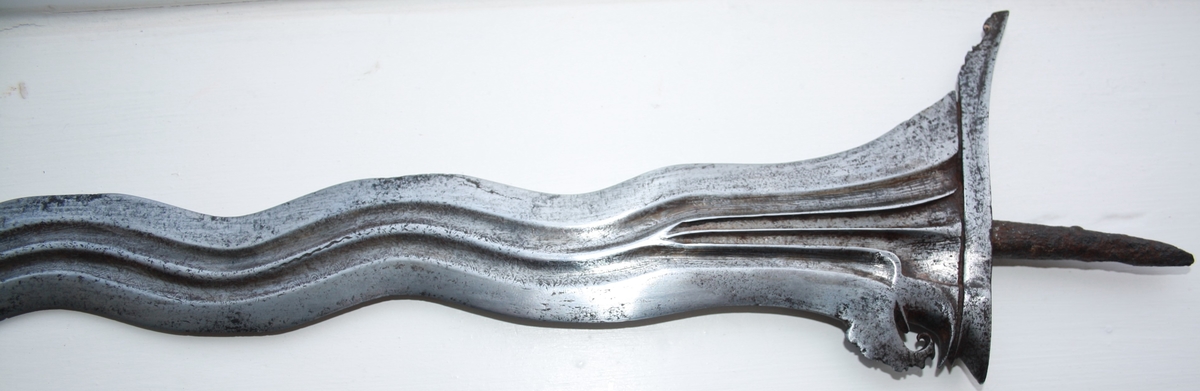

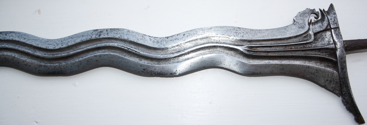

Hi yes the chiseling is very sharp and deep , i have cleaned the blade which makes it show up a little better

Just to point out the obvious: The selut does not fit the hilt. Thus, this ensemble has certainly been fiddled with and we only have the blade to go by. (Since keris fittings can be easily exchanged, being cautious if not paranoid is standard practise when appraising these blades, anyway.)
Even larger closeups from both of the assymetrical sides of the blade would be great! (Please make sure to take them directly from above and with lighting to avoid shadows as much as possible!)

Kai,
topographical etch is described by Newbold in 1839 an is absolutely common thing for Bugis influenced or genuinely Buginese blades with pamor. I would say, on most Moro Kris with twistcore pattern the center panel displaying twistcore will be more or less strongly topographically etched.
To polish a topographically etched twistcore panel until it's absolutely even is a hell of a work even for GI's and collectors obsessed with blade polishing, and after that procedure most of the twistcore will be gone, or you are gone through to other side of the (twisted) bar and that results in quite strange patterns.
A Moro blade with absolutely smooth twistcore pattern is something quite rare and probably will be from a period in which the Pamor wasn't commonly topographically etched. There are even a lot of archaic blades with straight Gonjo, which will be topographically etched, see the pic.
Here a thread with a topographically etched archaic Moro blade:
http://www.vikingsword.com/vb/showthread.php?t=17894
(If I remember correctly, Ron's example here with smooth twistcore also has a round tang.)
That would possibly place the CHK's blade even earlier as those.

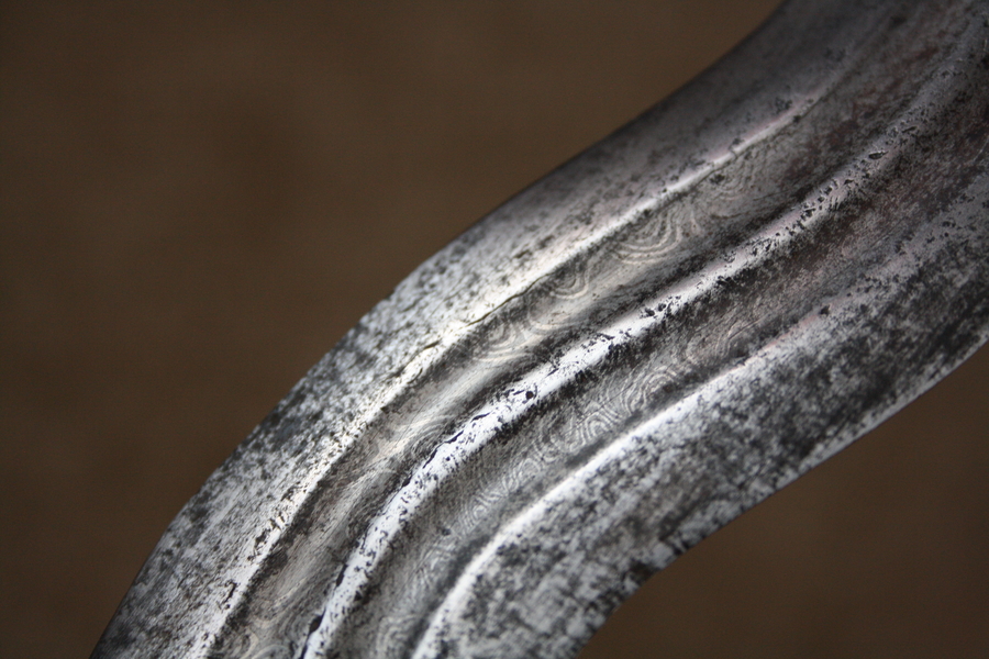

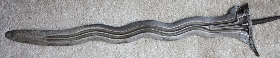

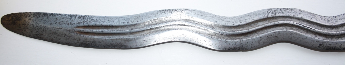

Hi Kai
i have taken a couple more pictures , it very difficult to get a good clear one ,
heres my attempt,
Thanks for evryones comments and input regarding this blade , im learning alot !

Many very early kris had round tangs. I agree with Gavin - not Javanese/Bali but Moro, and perhaps one of the earliest I've seen. Thank you again for posting this. Looks better than before.
It is also possible that if it has twist core, the pattern might be subtle and not so distinct. I have one from around 1800 (my estimate) that fits this catagory.

Just my final comment on this one. I agree with the sentiment that this is an early form of the Moro kris, resembling a Balinese keris but more likely Moro in origin. The dimensions are also very similar to known archaic examples of the Moro kris.
I mentioned the word "transitional" above in reference to the style, and the absence of the stirrup feature is an important observation IMHO. This is how I would imagine the early Moro adaptations, but of course we don't know if this is exactly how they looked or when this sword was made. Could it be from the 16th or 17th C? Perhaps, although I also think it could be a later piece made in an earlier style. Either way, it is an important reference point for future discussion of how the Moro kris may have evolved from its keris cousins.
