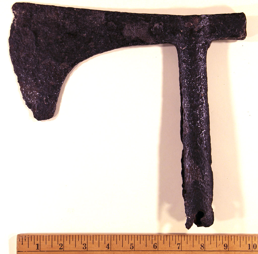

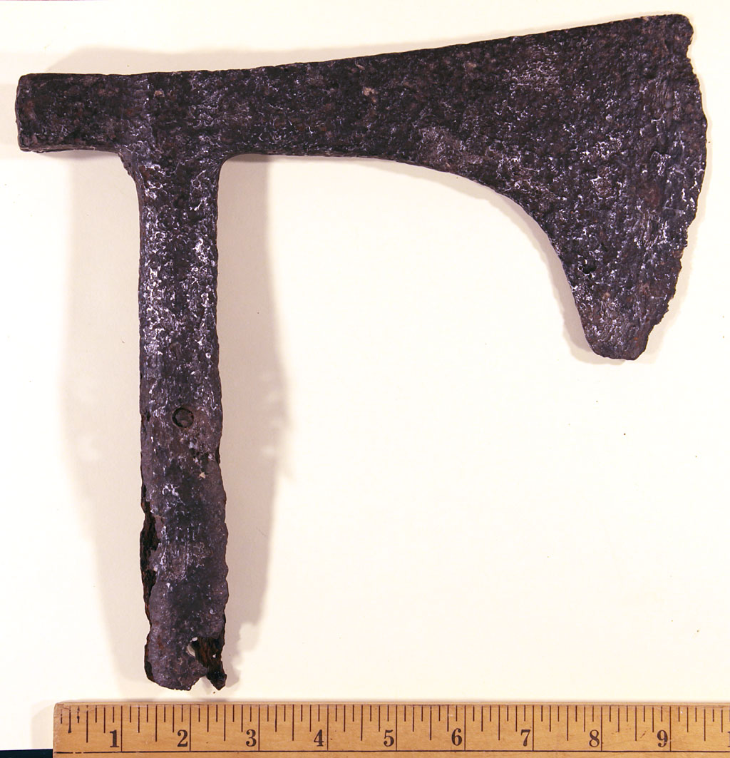

Question Excavated Battleaxe with Integral Langets
I believe that this was made as a battleaxe on the basis that the blade seems too thin for a wood working tool (2.9 mm at 1 cm from edge, 3.95 mm where 'beard' of blade expands and 11.6 mm at neck nearest haft). The ruler in the photos is in inches and in its present state the object weighs 807 grams.
Any idea of a more specific region of origin than Europe and what century this is most suggestive of are welcomed.

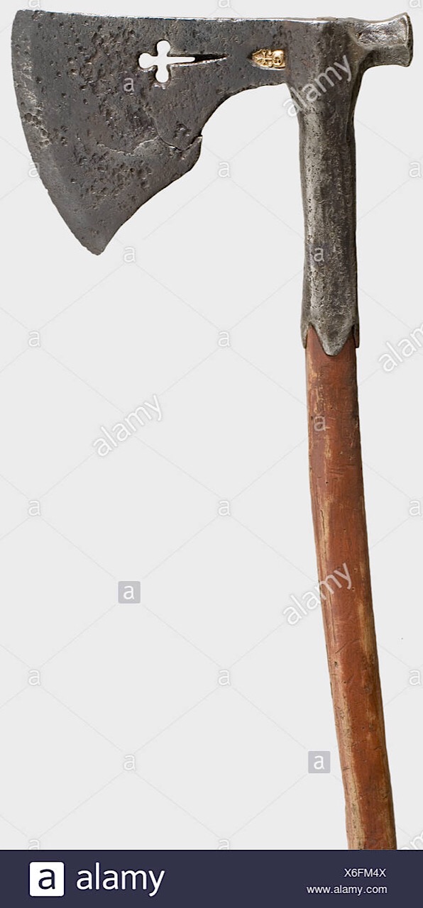

The enlarged, conical socket was used on axes to some degree from the Bronze Age to the 19th century, as was combining an axe with a hammer.
However, separate and distinct langets plus holes for securing nails would suggest more of a weapon than a tool (could be used for both, of course), and the size and design leads me to think 14th-15th century, based on the nearly flat upper plane and extended beard. Previously sold, similar blades with perfectly flat tops were usually described as “Gothic axe” blades.
Any of these style blades with large proportions inevitably get marketed as “executioners axes,” so buyer beware on those.
I’ve attached a stock photo of a 15th-16th c. example with similar proportions.
I couldn’t begin to guess as to what European region it could be from.

Excellent find, Lee! Is it yours? Not much to add other than that many folks misunderstand the 'hammer' end and assume only tools had these. They could, of course, be used as such, but it is my understanding that the hammer end added weight and balance to the swing (and could also leave a nice dimple in a helmet, if swung with significant force!)

BUCC_Guy, I think your illustration is surely of the same type of object, but of a clearly higher quality with the maker's mark and cut-out. I could not identify any markings on the one I presented at the top of this thread.
M Eley, Yes, I recently 're-discovered' it in the sticky (hard to open) bottom drawer of my armoury closet. I am embarassed to admit that I do not remember where or when I acquired it. I expect that it will have been at a 'gun show' in the US over 15 years ago.

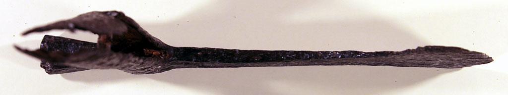

Question Perhaps mostly for balance?
Though the hammer head is small (2.26 x 2.79 cm. in maximum cross section), I imagine that it does move the center of gravity further back towards the haft (see photo below) and that the presence of the haft might well pull the center of gravity very nearly in line with the haft. Also, even if the purpose of the axe was primarily as a weapon, in the field a small hammer would occasionally prove useful.
