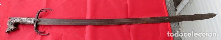

I wanted to share this lovely nimcha with my forum "peeps". It has become one of my very favorite swords even though it far more "blingy" than I usually care for, and generally, I am no fan of enameling. Somehow this one "spoke" to me and I had been looking for this blade type for some time, just didn't expect it to be in so special a "package"
I believe the sword dates to at least the early 19th century, likely even earlier.
The sword features the older style nimcha "cutlass-like" short, curved blade. There is a maker's stamp to the forte. The hilt is heavy silver enameled in dark blue, light blue, and green. You'll note the enameling is considerably cruder than what we might expect to find with Persian and Indian enameled pieces. Every square inch is detailed in some manner. The heavy hilt gives the sword a very nice balance.
The scabbard mounts are en suite with intricate floral motifs highlighted by the enameling. There are four bands of Islamic script along the scabbard fittings.
The baldric is old, but not "born with" the sword, though their colors match perfectly and they look like a natural combination.
Nimchas of this blade type are the most difficult to come by and I dare say, mounted in this manner, even rarer.
Dimensions:
Overall length:32in.
Blade length:25in.
Blade width at the forte: just under one inch
Blade's widest point: 1.75in.

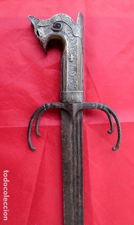

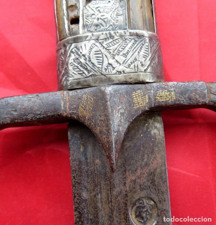

A super piece, Charles ... i'd say. Can you 'macro' that makers stamp ? ... just curious .

One of the best Algerian nimcha ever!
I guess the guys of the Maritime museum will be jealous too
https://collections.rmg.co.uk/collec...cts/78504.html
I think that you are righ, I would say 18th c. for sure if not 17thc...

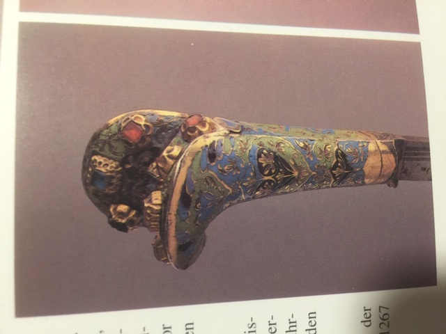

As far as dating goes, the earliest reliably dated nimcha is one in the Rijksmuseum which belonged to Michiel de Ruyter, which places it in the mid 1600s:
https://www.rijksmuseum.nl/en/collection/NG-NM-10412
Yours should not be much later than that, so perhaps late 17th or early 18th century, at least as far as the blade is concerned. The enameled mounts and the baldric could be later. There are examples of a 19th century enameled Moroccan saif scabbards in the sold section of Oriental Arms:

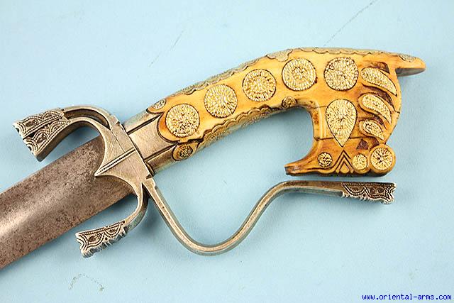

http://oriental-arms.com/photos.php?id=4522
http://oriental-arms.com/photos.php?id=3908
I do not know how early the enameling decorating technique made it to Morocco, but my guess is that you have an old 17th or 18th century sword remounted in the 19th century. Whoever did it, preserved the original form of the guard and the hilt. As you can see on the Rijksmueum sword, the original scabbards were made of cloth and leather and these materials tend to deteriorate unless stored in a perfect environment. Obviously it belonged to someone quite prominent, who loved this sword as much as you do. Most of the early nimchas we see are trophies taken during the conflicts between Habsburgs and Ottomans, and it is great tos ee one that appears to have remained in the Maghreb for a little while longer.

However, I do not think it is North African. IMHO, it is South Arabian, likely Omani. My main point is the configuration of the blade: widening toward the tip. Similar configuration is seen in Elgood’s book on weapons of Arabia ( Fig. 2.1 and by description 2.2). Seems to me it is quite short: thus a genuine “nimcha”:-), a naval cutlass, so popular with seafaring Omanis.
Also, the lavish decoration is very reminiscent of the luxurious Zanzibari nimchas with gold coins on the handle from Buttin’s catalogue ( plate XXX) and Hales’ catalogue ( Figs. 589-90). Similarly “segmented” decor of the scabbard is also seen in the same book ( 2.18 and2.21)
Also, you might recall Elgood’s comment about Bukharans in Oman. They brought enameling there.
I doubt there is an iron-clad provenance, so that’s only my gut feeling.

However, the Bukharan enamel connection is definetely a possibility as I've seen this blue and green enamel work on other Ottoman daggers, including on sold by us some years back over gold, see below:
http://armsandantiques.com/beautiful...r-dagger-id851
And also another found in the Wallace Collection. I think the enamelling is most likely early 18th C. Ottoman workmanship, likely on order depending on where in the Empire, or associated states, it went.

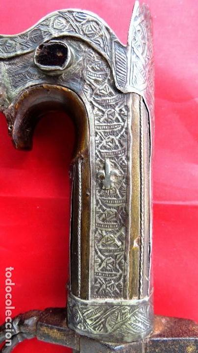

I wonder if a translation of the Arabic script on the bands might provide useful information.

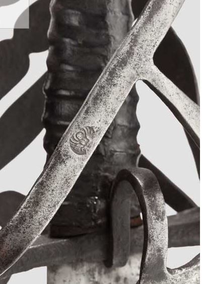

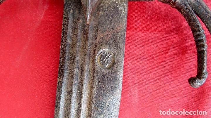

And the stamp on the blade ... remember, Charles ?

Here are a couple of pics, but they are very difficult to make out, though the stamp on one side is much clearer than the other.
Let me know if you are able to decipher anything from it.

Charles, my idea was more to show the stamp to members within this type of (Islamic) swords than attempting my self to identify it.
Marks (stamps) are a vital asset; they often open the doors to crack enigmas.
While inscriptions, for as important as they are for the item's record, may fall into 'generic' religious statements, smith (or arsenal) marks may drive you into the actual origin of the piece.
... Just saying .
It could be a Venetian arsenal winged lion?
What remembers me of this another ¿Nimcha? What do you make out of it?

The deeply stamped circular cartouche seems a convention which runs typical in Algerian context sabres (which is how Briggs. 1965, terms the probable nimshas in his collection then). In accord with the drawings in his article, "European Blades in Tuareg Swords and Daggers", JAAS, Vol. V, #2, 1965, p.37-92......on p.78, he describes two of these 'sabres' as having these as having circular marks containing Arabic characters in illegible combination, but while in this same blade location.....only on one side.
Though he suggests the blades, both with identical three fuller configuration, are either Italian or German and of 16th or 17th c. As one of the blades has ANDREA FERARA, this profoundly suggests Solingen, and likely end of 17th into 18thc. Briggs notes that these markings were probably stamped later, but prior to 'damascening' on the blade.
This further suggests some type of arsenal or acceptance (?) kind of stamp which was apparently placed on these blades (in this blade location) as the blades were received.
In Charles' example (OP) the flared tip blade in my opinion in unlikely to be German, quite likely Italian (as these are comparable to some storta blades I believe) and seems earlier. That suggests this application of these cartouches was in place much earlier than the blades noted in Briggs.
Perhaps it could be some sort of talismanic blessing (?) to the blade, otherwise I would presume the acceptance stamp. In that case there may be some kind of administrative purpose.

Is it possible that they are arsenal marks rather than maker's marks??? In other words, where they came from or belong vs. who made them. I realize, of course, that often the maker and the arsenal would be the same.
...just an idea.

I think we crossed posts Charles. As I indicated in my post just prior to yours, I believe these are likely 'arsenal' or more likely stamps having to do with administrative purpose such as already 'taxed' (?) or accounted for. The Ottomans were keen on these kinds of matters if I understand correctly.
These have nothing to do with makers marks or origins of the blades in my opinion. Makers stamps were at the forte (root) of the blade not in this location as seen on these Algerian received trade blades.

Dear Jim, may i extract a piece of your post to realize you are correcting my (more than) humble approach in that, arsenal marks are not makers marks; sure thing, as so i cared to mention both possibilities in my previous post. In any case, and playing positive, despite an arsenal stamp (stricto sensu) might not define the original blade provenance, it sure tracks the path it traversed to meet final assembly, a bit of info that helps building the sword history. On the other hand, i am perplex at the distinction you seem to make at the discussed stamps being, or not, located in the forte. I fear i don't follow you; both Charles's and Midelburgo's examples have them located in the blade forte; or do you define forte (first strong third) as a different location in the blade ?
All yours .

Yes you have maker marks, export / import marks and arsenals marks.
This one seems very deep for an arsenal mark, look at Irene arsenal marks they are just engravings... )II(

Fernando, I did not mean my comments, which I admit got a bit complicated, as any kind of correction but just as an observation on my own account.
Arsenal marks are not as you say, usually an origin for a blade, but where it 'arrived' at some point and was either held for and used in furbishing swords.
Very good point in these marks establishing a factor in the blade/sword history.
I think the forte thing is more a matter of my own perception, I always think of the forte as with makers marks, to be located near the center of the blade near the guard, sometimes even under the langet etc.
The block forte is often seen on European blades, and such marks are on this section of the blade.
These circular cartouches are situated unusually near the cutting edge of the blade but indeed in the upper section of the blade near the guard, which may broadly be regarded as part of the forte. Perhaps you are right, defining the forte might be regarded as the upper third of the blade...just always thought of it as the root near the guard.

I had never seen the Italian connection with the early Nimcha hilts being attributed to an older Italian form, however the example Midelburgo posts shows what is clearly a derivative form of the crabclaw style Italian hilt in it's crossguard. The hilt itself is a variant on the 17th C. or earlier form with the sharp pommel and the flattened sides.
However the crossguard is the first time I've seen this form, and to me proves, or goes some way in doing so, that the cross-pollination between the European forms also extended to other types of hilt shapes and forms,especially at what would have been an early date. However, that isn't surprising considering the many European captured slaves that were forced into service among the Corsairs and Ottoman empire, I can imagine some of them that were forced into combat, or went willingly, would have their favorite forms interpreted through local types.
Excellent find and an important addition to the nimcha formology pantheon.
Well noted, and goes again to the landmark article "A Late 15th Century Italian Sword" (1975) by the late Tony North. ….which clearly shows the type of hilts which indeed seems to have set the pace for these Arab hilts.
As also well noted, not only the Algerian corsairs et al, and essentially the Ottomans carried on a monumental commerce in slaving, and yes many did willingly go into their service. There were many cases, and notably some Dutch, along with others who even nominally converted to Islam and became corsairs themselves.
The complexity and scope of all these factors make it hard to determine just when and how these forms cross diffused, but in my view the early Italian forms profoundly influenced many ethnographic forms of edged weapons.
