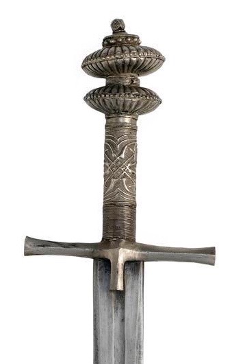

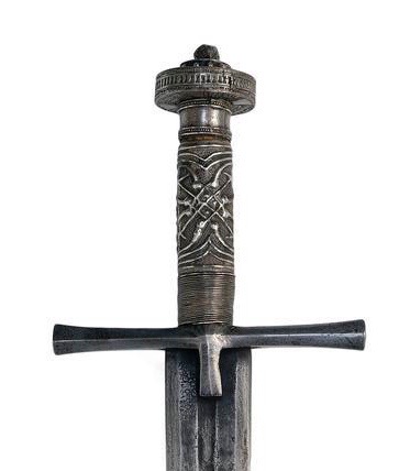

Here are three more Star & Comet covers. All in the same motif. They are not identical suggesting they were produced by different artisans.
1. Victoria and Albert Museum M.47-1953
2. Royal Armouries Collections, Leeds XXVIS.166. Note the double pommel. Its similar to the one posted above by Teodor.
3. Royal Armouries Collections, Leeds XXVIS.165. Wire wrapped at bottom just like #166.

Great images Ed, thank you for digging those up. I know the discussion is on the hilts, but the one you posted from the Victoria & Albert Museum has a really interesting blade, probably Persian and quite old.

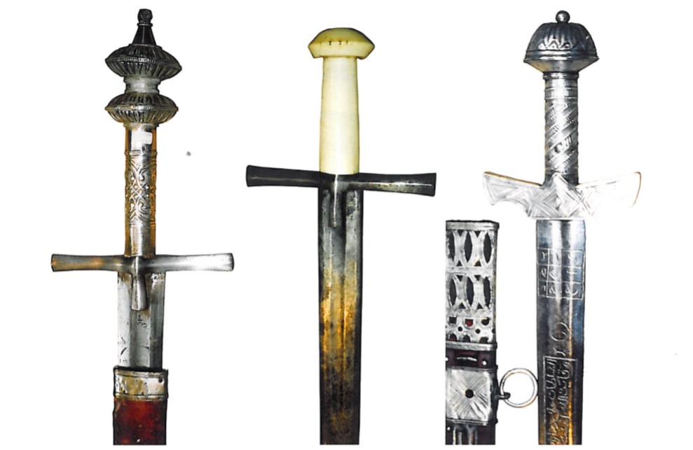

I'm fascinated by the sword on the right in this image. Its almost takouba like in guard construction, including the scabbard fittings. Anyone know where it ended up or have more images?

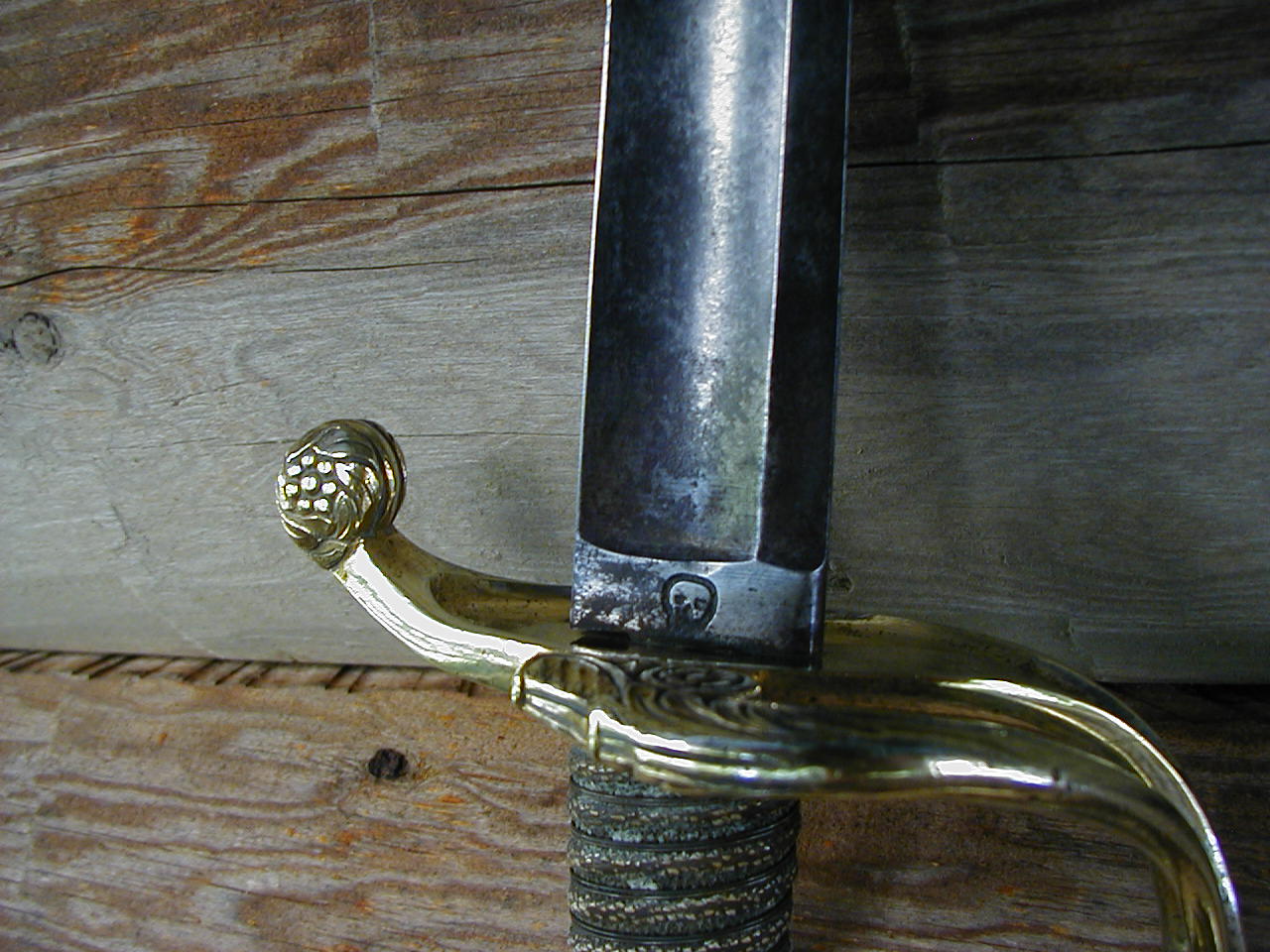

"Knell" seems to be a typo. It should read "Kull" as on this Cavalry Sabre. Curiously, I have not yet found a Kaskara with a blade by this maker.

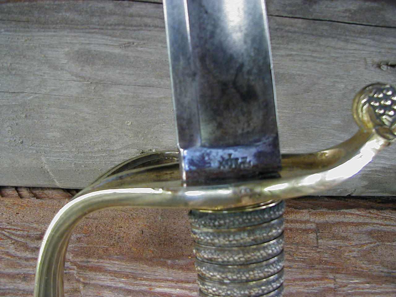

In the EAA forum, many examples of the full length Kar/Khor were thought to have been made in Ethiopia. Some with two fairly wide fullers with Amharic letters inside. Kassala makers apparently copied Ethiopian designs on this type.

Old 16th April 2019, 01:22 PM   #46
Bill M
Bill M's Avatar
Location: USA Georgia
Posts: 1,599
Please comment on this? I should take some better images.
http://www.vikingsword.com/vb/showth...hlight=Kaskara
Old 16th April 2019, 06:22 PM   #47
Edster
Join Date: Oct 2010
Posts: 415
Bill M,
That's a very nice Kaskara. The blade has a Kar/Khor type fuller and was likely forged in the Tigre (Muslim) region of what is now Eritrea. My informants in Kassala in 1984 attributed the Kar's likely origin to Ethiopia, although that type of fuller was done in Sudan as well. Actually, the larger Beja peoples roamed over the area between Kassala, Suwakin, Mussawa, Red Sea Hills for several hundred years. Lots of spill over in these low lands. Kassaka itself is just a few miles from the Ethiopian border.
Stephen Woods information from Post # 36, collected in Eritrea in 1905-06, above describes this blade/fuller "species" as:
"2. But if the Kar is carved with a broad line up to the
point, it is of little value; and it is the sword of the high-
waymen only."
The Arabic script engraving, lines along edges of the fuller and the silver grip cover would put it as above the "highwaymen only" quality. Translation of the text would enhance our understanding of its origin and possible date.
The etchings on the blade are interesting, but don't really tell me any tales.
The silver grip cover isn't like the two known styles: diamonds and stars & Comets/dotted cross and would likely originate outside Sudan. The cross-guard looks kaskara style, but I don't know how far into Eritrea/Ethiopia the style penetrated. Some may argue that the style even originated there as similar versions have appeared on ancient Ethiopian wall paintings.
Hopefully others will add their interpretations.
Ed
