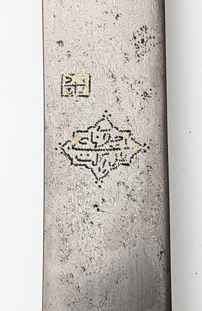

On the shamshir, the usual dual cartouches, the upper an ogival spheroid typically with ruler of the time or other information or other exhortations , while the lower typically had the makers name and date....are seen.
However to the left and above is a square with abjad letters in a grid, and known as a 'Beduh' square. These talismanic devices are often regarded as 'magic squares' and represent various number combinations which invoke the appropriate properties required.
I would like to look into these 'Beduh' squares further here, and determine more on how they are typically intended on sword blades; how widely were they used (if outside the Arab world and Mughal India) and examples of blades bearing them.
I would also like to learn more on the lozenge device and its significance in motif and designs on weapons in the Arab world.
Attached is the blade of the shamshir posted by William Fox with the typical cartouche configuration and the 'Beduh' square upper left. I am curious about the grid of only four squares, it seems most have nine.

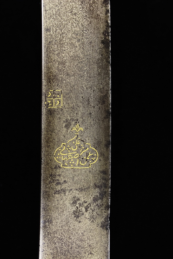

The inscriptions read as follows:
Upper cartouche: Abbas, Servant of the Ruler of the Nation
This is a very typical formula and is found on the preponderance of such blades.
Lower cartouche: Work of Zaman Isfahani
A known, but not common, maker. Zaman of Isfahan is often referred to as the "son of Assad Allah" but that, like most of the lore, should be taken as praise, rather than representing a literal relationship.
The lateral inscription: Victory from Allah and conquest nigh!
This is a popular Islamic phrase often found on weapons.
An above average blade, congratulations to its owner.
Oliver thank you so much for giving us this translation from the shamshir blade I posted, which is presently being discussed as well on the concurrent thread 'shamshir translation'. It is interesting to see the Buduh square along with these cartouches.

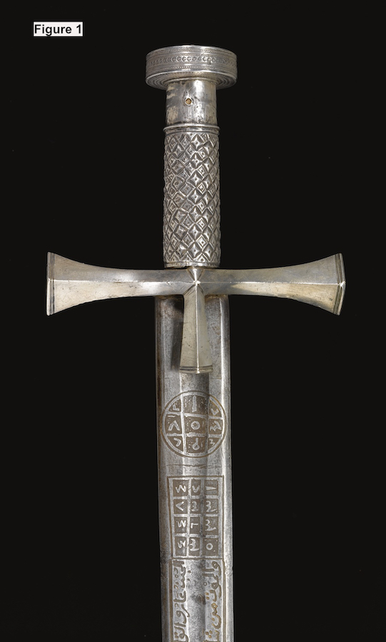

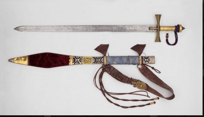

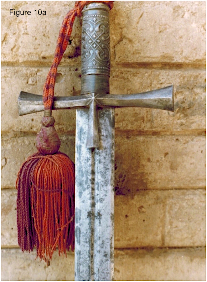

The Sotheby's image of an Ali Dinar sword (c.1916) from shows magic squares on the blade.
(Help. I cannot attach images (Figs. 10a, 8 & 1) from the Kaskara Silver Dress essay) to this reply. The Manage Attachments button does not open.)
Ed
ESSAY HERE

--- (Help. I cannot attach images (Figs. 10a, 8 & 1) from the Kaskara Silver Dress essay) to this reply. The Manage Attachments button does not open.)---
This should not happen; why don't you try again later, Ed ?

It still doesn't work, even on this post. Would you be so kind as to extract those three images from my essay and insert them in the post?

It still doesn't work, even on this post. Would you be so kind as to extract those three images from my essay and insert them in the post? ...
Done !
Ed
ESSAY HERE

Kubur,
Magnificent Ali Dinar style sword. That must be a great book you recommend. Unfortunately, it's too expensive for me to buy and isn't available free online or via my favorite pirate site, Lingen.io. Is there anything therein that might inform the basis of either the star & comet or dotted-cross motifs?

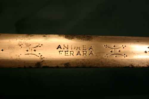

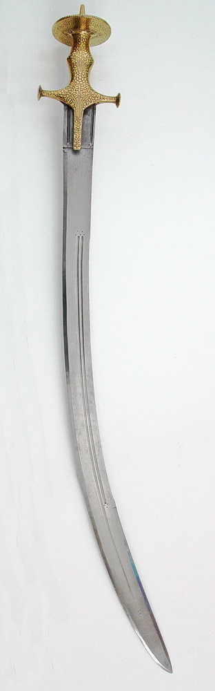

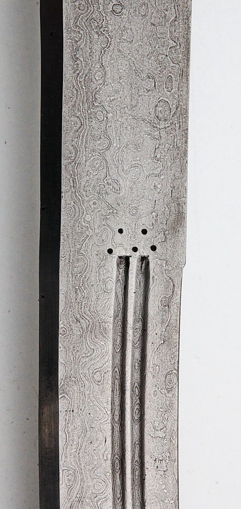

Here are two more Buduhs.

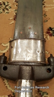

Hello William.. Indeed interesting as the 4 and 5 dotted cross are applied to the hilt. the budu square is excellent and clearly placed. I note the square is placed above and left of the main cartouche and this seems standard. It is interesting that the letters are related to a numerical progression which I think was first indicated after magic squares were transmitted to the Arabs from the Chinese and then relayed in the other direction back to China later.
Old 28th January 2019, 01:40 PM   #22
Ibrahiim al Balooshi
Ibrahiim al Balooshi's Avatar
Posts: 4,408

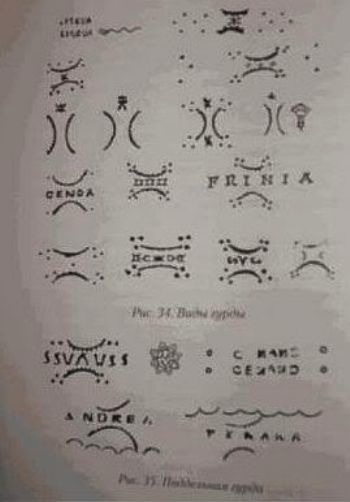

On the lower sword I note the inclusion of the three dots on the 4 points of the cartouche .
Three dots appear on all manner of blades and including Nepalese and Persian as well as Indian. These marks appear to indicate the Trimurti form yet evidence also points toward something else; Tamerlane.
On Islamic blades the geometry seems to be one of protection against evil spirits and in other regions the dots placed not only on blades but on hilts presumably blocking evil from entering the blade from either direction.
Tradition indicates that on a set of Islamic prayer beads there are often three beads included at the end of the string to stop the devil climbing up!
Below; Islamic beads plus 3 to ward off evil spirits and the Tamerlane three dots...

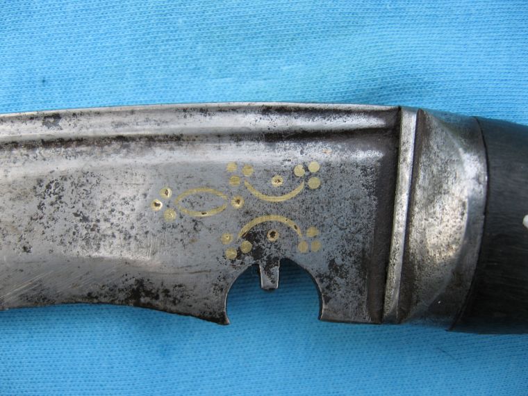

The great danger here is that members may consider the three dots as explained whereas these are only suggested since the variety of possibilities is vast>>>and covering an enormous timescale as well as all the main religions the world! many of these possibilities are unrelated while some are probably loosely connected and even connected to mysterious cult followings like Free Masons etc. What seems clear is the Talisman effect in protecting the blades although instances where other artifacts seem designed with # dots such as in ceramic wares from Iznic Turkish wares.
Below a few examples on blades and the chart of three dots and including the sawback or eyelash feature seen in many regions. The 3 dot form may also be a simple ruse to raise the price in indicating a high quality blade in the same way as placing important features on a blade such as ANDREA FERRERA or The name of a famous maker...or a Wolf or other inscription on a blade> Naturally the holy script of religion can be added as Talisman on blade hilt or accoutrements as in Mahdi shirts, allam battle banners and flags and unusual weaponry such as Mace.

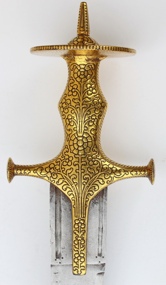

The sword shown below was owned by Shri Jodh Bahadur/Rao Jodh II of Salumbar/Udaipur/Mewar, and is dated VS 1927 - AD 1870-71. Born AD 1833 and ruled from 1863 to 1901(?).
The three dots have been used almost as if they were closing the fullers as it is often seen.

Jens Nordlunde's Avatar
Location: Europe
Posts: 2,718
Thank you Fernando,
You may be able to see that one, and only one of them at the end of the blade, is 'closed' with three dots as well.
It is interesting that the inscription under the disc, as well as the one at the back of the blade, gives the owners name and the place.
Rao Jodh II was the 24th ruler of Salumbar, and the history about how Salumbar was started is quite interesting - with a coconut and a misplaced joke.

Posts: 10,814
This is most interesting Jens, and as we have often noted, the 'three dots' have often been found on Indian blades in seemingly strategic locations, as if to add strength or power to that key point of the blade.
In this instance at the terminus of the flutes, this is often seen in European blades as in Spanish blades, the 'anchor' often was seen at end of fullers.
I would note here that these kinds of flutes in the forte of the blade were typical on 18th century Solingen blades as often seen on broadswords found on Scottish basket hilts. This suggests possible factors of European influence here.
On earlier European blades the Bishop's cross often 'enclosed' names, phrases or invocations in this manner, as if to augment or enhance the power or significance of what was being expressed.
It is often perplexing in trying to consider certain markings on blades such as the 'sickle' marks often copied on Indian blades (recalling of course the Genoan/Styrian forms)............were these to suggest quality as often assumed, or imbuements of power and strength ?
Could these three dots possibly have been in imitation of the three dots typically part of the sickle mark described, but taken singly in accord with the numeric value of the Trimurti....and placed to add such strength?
The grouping of dots at the top of the fuller is of configured as five rather than three, which of course seems unusual unless simply added in accord with the others in an aesthetic sense.

Jens Nordlunde
Location: Europe
Posts: 2,718
Jim,
The five dots are share one of the dots, have a look here.
This blade is quite unusual, as one side is wootz and the other side is pattern welded with only two fullers along the blade.
